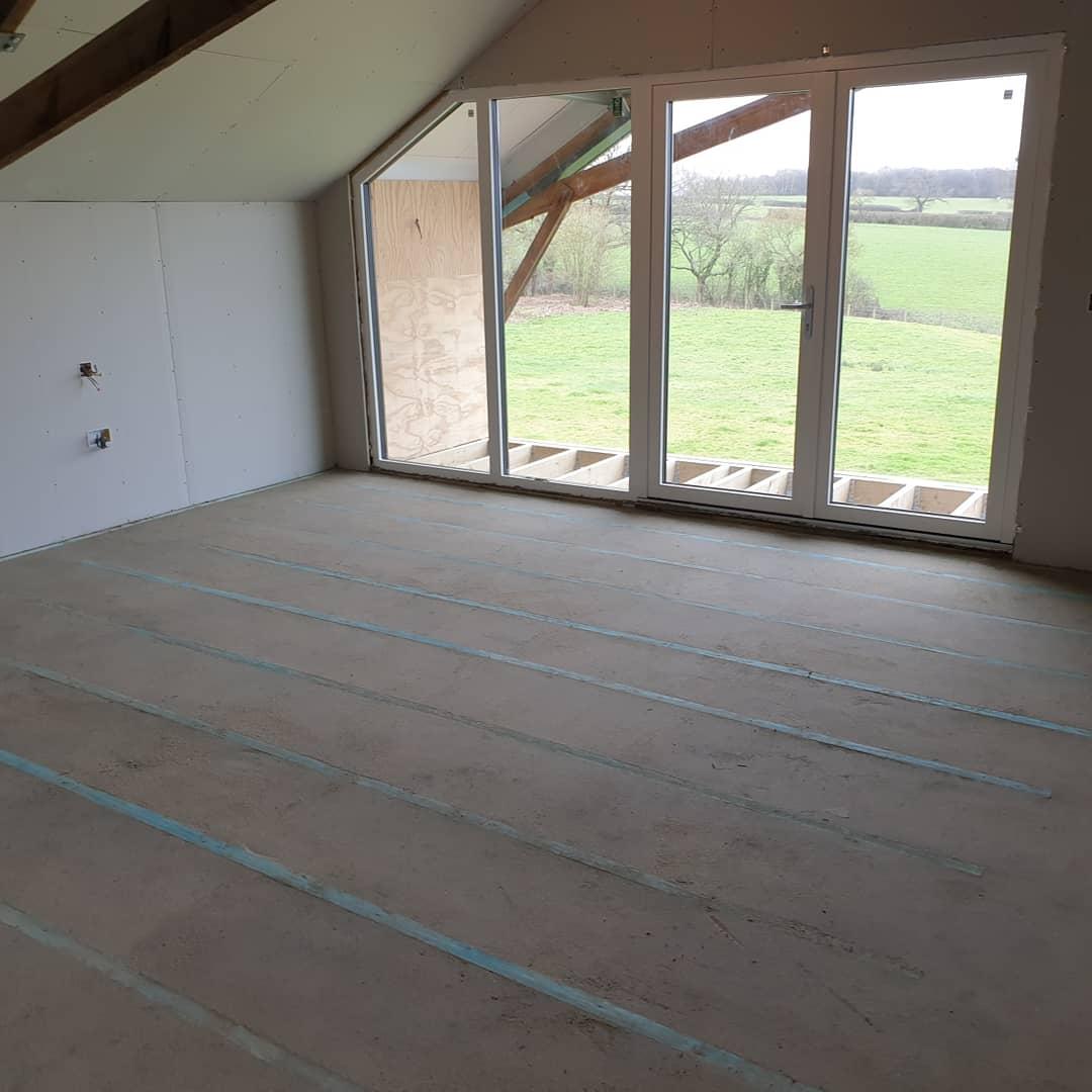

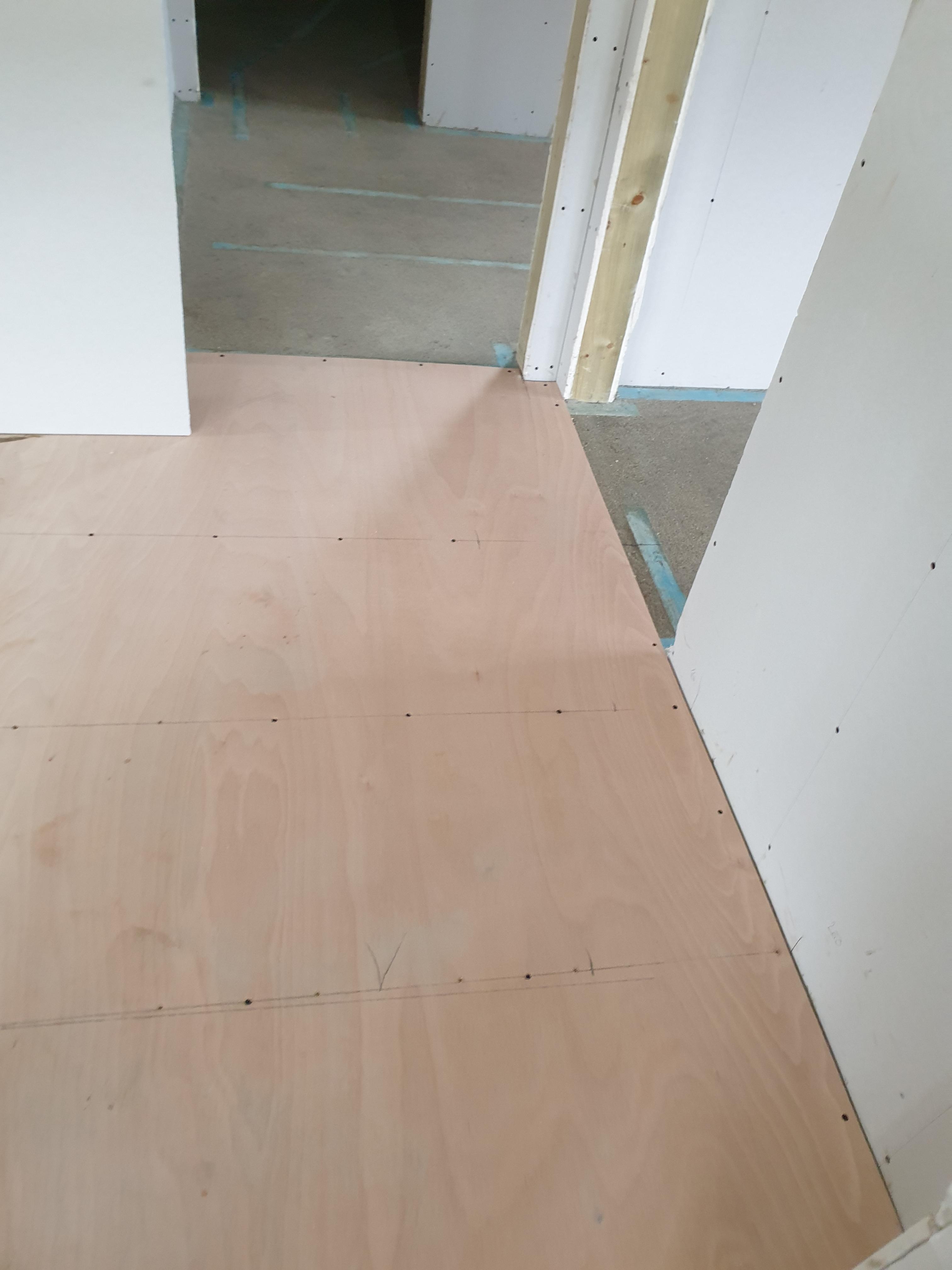

Thanks for your reply Dave. The screed is laid on 22mm chipboard on 600mm spaced easy joists (253mm depth) I guess the thinking was although the ply is only fixed to the battens, as they are flush with the screed I didn't expect the movement we are seeing. I have heard some people lay underlay then carpet straight on the dry screed. The positive thing is that we haven't laid the flooring yet, so worst case could rip the ply up before we do.
Morning everyone Our house build is progressing nicely and we have recently had the ufh installed both downstairs in the traditional way (stapled to insulation, screed on top) and also on the first floor, in 25mm in between batons etc. We then screwed and glued 6mm ply to the batons to protect the screed and provide a sound surface for tiling/flooring. Although the dry screed was swept and hoovered before the ply was laid The problem we are now finding is a 'crunching' noise when you walk around, between the ply and the screed. Has anyone who has used this system experienced similar problems? Does it go in time? I don't want to get to a position of getting carpets etc down and still hearing the annoying crunch. Any advice/experience gratefully received. Many thanks
