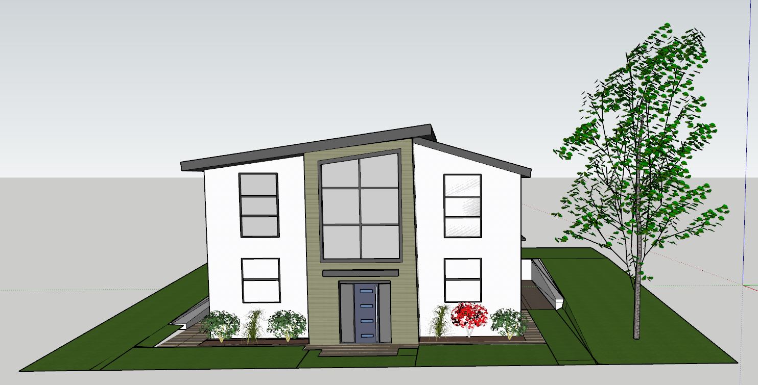

£1,300 /m2 would probably be impossible for us. We are West Midlands based and need to be much nearer £1,000 per m/sq. Its downstairs space thats important, we will probably end up sepending £200-£250k for a 1acre plot, leaving £200-£250 for the build. -

To be honest, Architects are not cheap. I've had some involvement in appointing one for a Commercial building (new Head Office) and I influenced most of the designs. I found them to be quite unimaginative, whereas we are more than capable of playing with designs ourselves. Finding concepts online that we like and reverse-engineering them. -

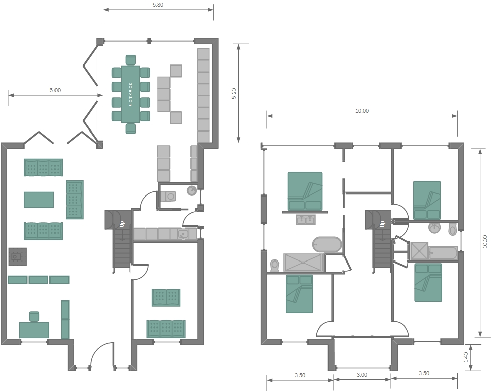

No, I think we totally get all of that. But I needed a model to cost up, I have now put together a complex spreadsheet based on this design, so I can cost up all of the bits required. With such a variation in building materials and finishes, we need an accurate idea of what the design features we like would cost. I need to understand if it will be £900/m/sq or £1,300. I have designed and built a large double storey house extension on a previous home. I had a local family builder build the shell (I was left with bare block walls and floor joists) and then completed all the internal work myself. It nearly killed me as I was going through a divorce in the middle of it too. But, it hasn't put me off the process and I now know which bit I would hapily do myself vs paying somebody. I already have a large pintrest site -

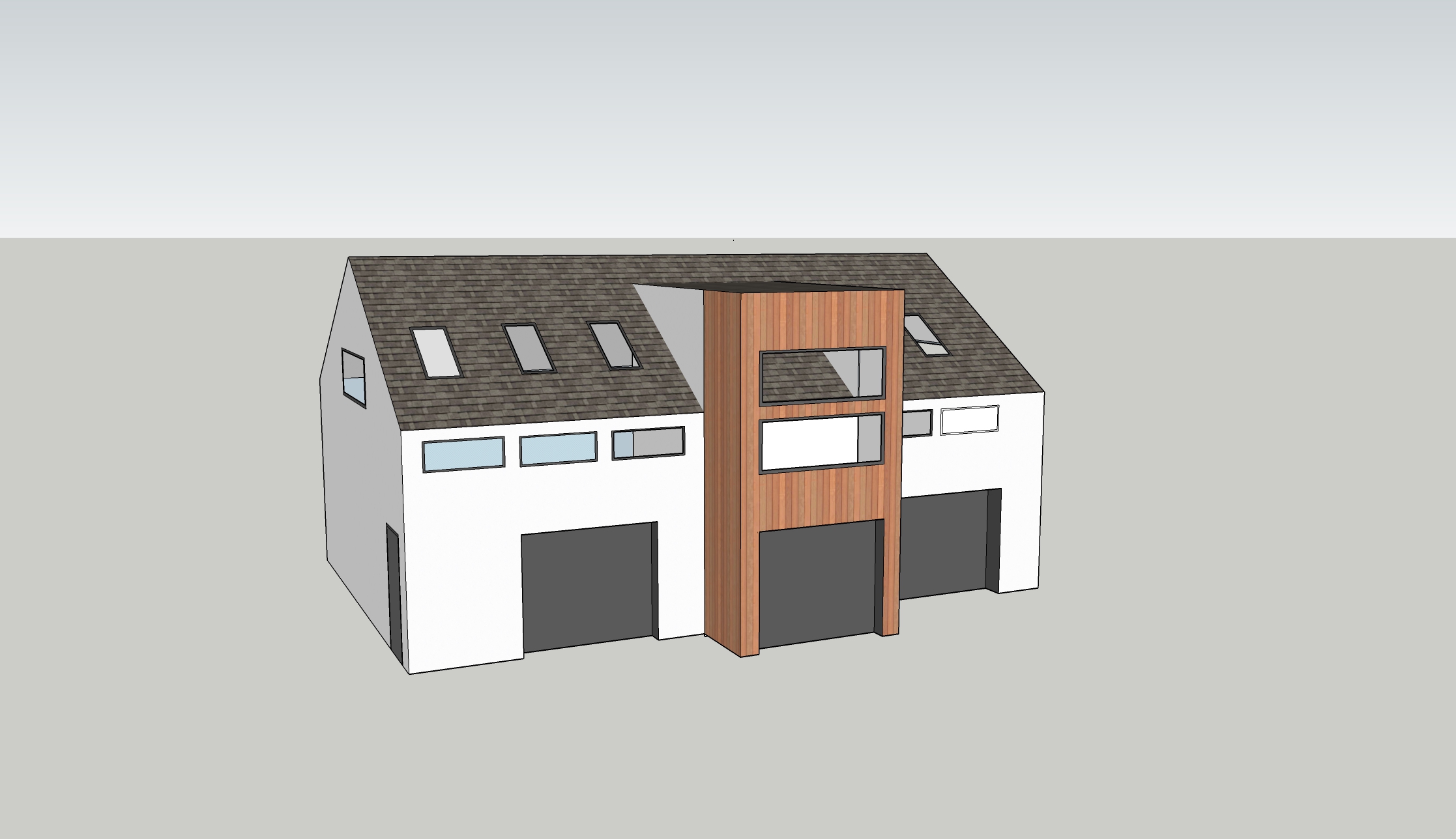

Hopuse concept shown below, location will be somewhere between Worcester and Stratford. (Hopefuly)
We are looking to build a contemporary house, white render, some cladding (probably one of the new cement composite ones) and a flat'ish roof. Downstairs entertaining space is important for us, we want open-plan. Concept:-
Agreed, but once we find a plot, its likely we will have to purchase it quickly, which means getting a self-build mortgage, which means having some idea of build cost. Unless I mis-understand the process?

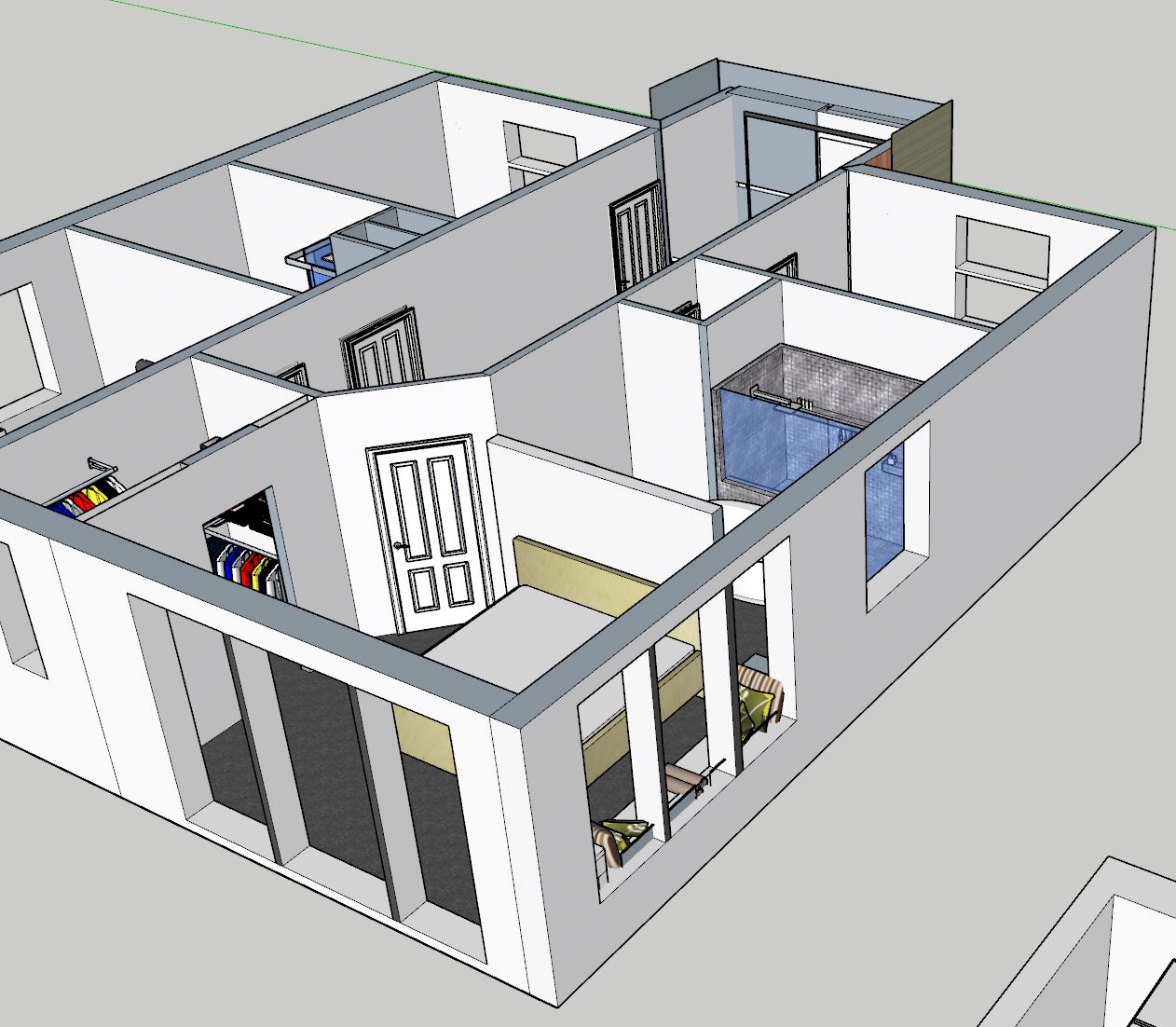

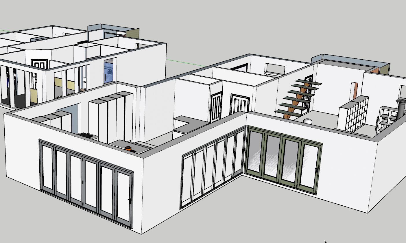

Very early days, haven't found a plot or sold my house yet, but trying to get concept plan more fully defined and decide on building materials so I can get accurate costs together. Fully appreciate that the plot will drive the design, but have to start somewhere and would need some figures to give for a mortgage when purchasing the land. I'm still getting used to sketchup, so appologies for the crudeness of the drawings. We would likely not use an architect, instead taking the time to design it ourselves. We do lots of entertaining, so the downstairs space is important to us. the 2d drawing is slightly different to the 3d, I haven't updated the sketchup with the latest ideas I was playing with. The plan would be for a house built to passive house recommendations, but not certified, primarily to ensure sensible running costs for the future. Construction materials is still up for discussion, it will be primarily based on achieving the look we want, with good insulation at the best price possible. Thanks in advance for any ideas and suggestions
