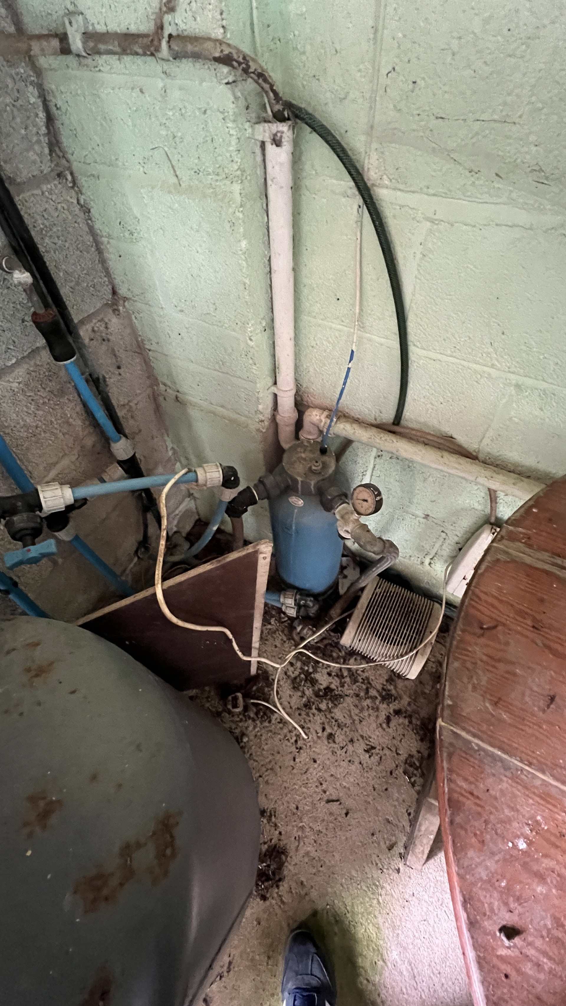

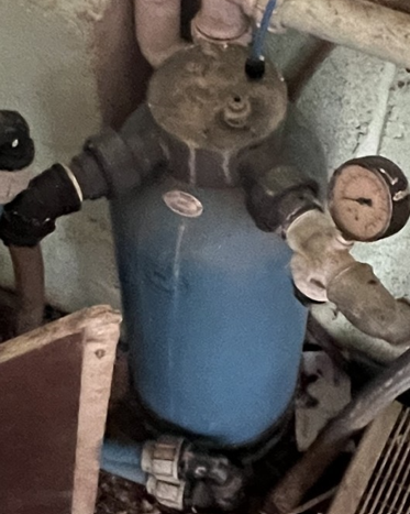

  9. The house we are purchasing has a borehole, which we have finaly located.😀 I will get a local Company to come and survey it, to ensure its still fit for purpose. However, I would like to understand for myself how these systems are supposed to work and how they should be plumbed together. There is a currently a Grundfoss 170lt accumulator, Ph tank with backflow, all supplied by a Lowara 0.75kW pump. A water quality test was done and recommendations were to change the Ph from 6.8 (I suspect the Ph unit needs simply needs recharging), to add a filter unit and UV. What order should these be connected together, starting form the incoming water from the borehole/pump? For things like washing the cars, watering the garden etc. is there any sense in taking a feed to a garden tap from further back in the connected systems? Therefore not wasting money filtering or cleaning water thats not for human consumption? I'm likely to undertake most day to day maintenance myself, so understanding how it all works, getting spare parts ready is going to help. Thanks in advance for advide and guidance, its a steep learning curve!

  16. Thanks, the engineer who did the water quality survey did get sight of a invoice, but I am strugling to get a copy (question is now with my Solicitors). He reckoned the grid coordinates put in 80m away in a field across a road, I have not found it there. Back in 1994 its likely to be handwritten invoice, so I wonder if he made a mistake reading the numbers. Its frustrating just how difficult this is proving to be. Understanding how a borehole is likely to have beem constructed back in 1994, may help me to find it. eg. whether its more likely to be a capped off pipe above ground, or a box above ground containing the pump wiring etc, or whether it was common proactice to build it all into a hole with a manhole cover. Would they have lined them with a plastic pipe back then? PS. We are also in South Devon

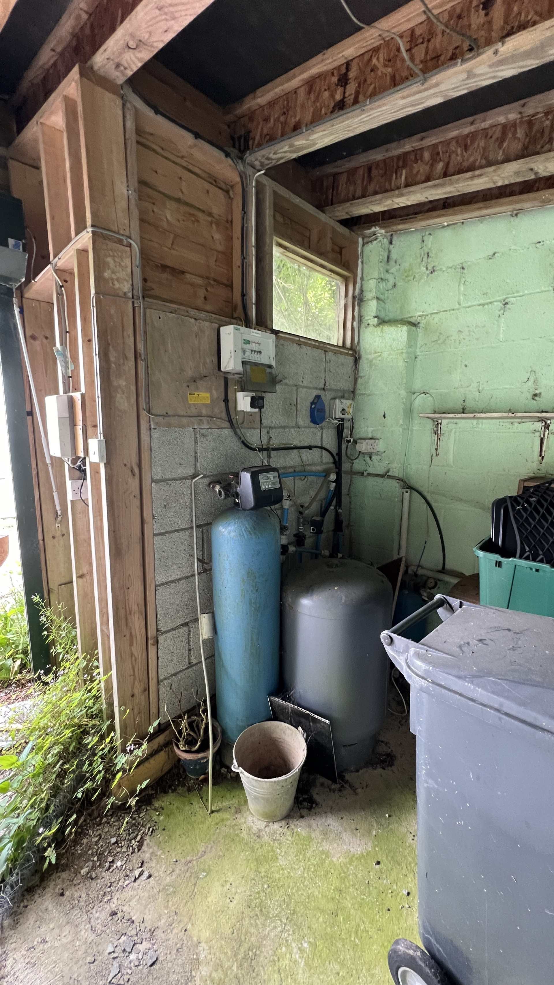

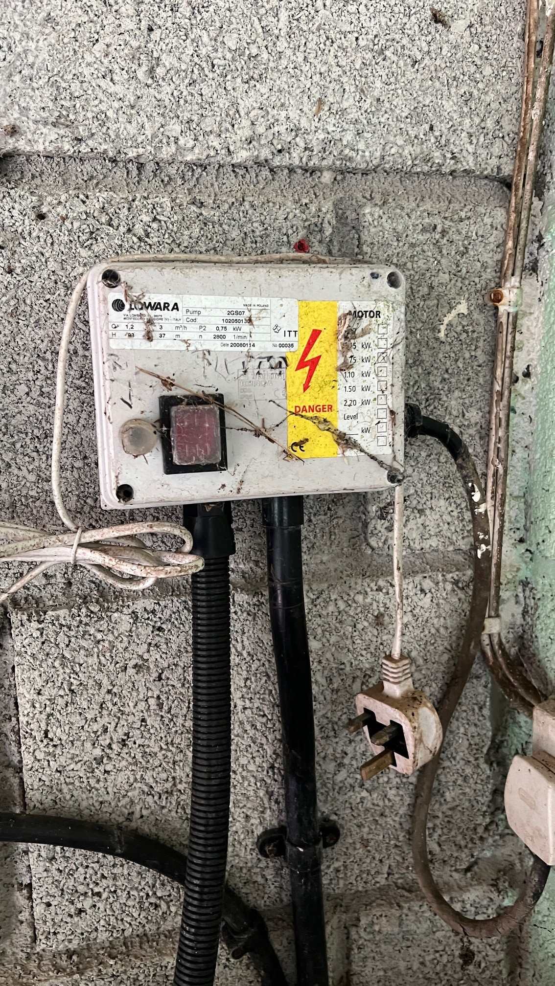

  18. We are in the process of completing on a house that is served by a private borehole. Unfortunately the owner is in a care home and an executor is dealing with the sale, paperwork is somewhat lacking. Nobody knows where the borehole is (Believed to have been installed around 1994) I've looked at the filtration system in the garage and can see the incoming water pipe and outgoing power for the pump, coming from a controller on the wall. It exits underground as it goes through the wall. The controller has a 2008 manufacturer date on it, so somebody is likely to have changed the pump back then. A couple of us have poked around the garden and have not been able to find any signs of a manhole or pipe head. Logically speaking its going to be some distance from the old septic tank that serves the house (It predates the borehole). Do any of you have any ideas about what sort of borehole would have been created back in 1994? Would it typically have something above ground, or perhaps under a manhole cover? (Photos would be great) The only idea I have right now, is for somebody to use one of those cable finders (like they use before digging up the road), to try and trace the pump power cable back to the borehole. Digging the pipe up seems like a lot of work, especialy in a well established, and overgrown, garden. Thanks in advance for ideas and suggestions
  19. Hi We are just in the proces of buying a new home, it has an existing private water supply but unfortunately the Vendor is in a home and their executor has little paperwork. While I do expect them to do undertake some survey's to provide correct information, the more I can understand for myself the better. They have already arranged a water test which came back ok for quality, PH needs adjusting from 6.8, recommendation for a filter and UV to be installed. The large blue clylinder is likely to be for softening the water, probably just needs a new salt refill to work properly. The grey cylinder is probably a storage vessel. The biggest issue, is that nobody knows where the borehole or well is located! Here are some photos I took on my last visit, they were just general shots. Not sure what this is, could it be the top of the bore hole? I may have to go back for another look myself. This looks to be the control panel for the submersible pump. If anybody can identify the smaller blue cylinder, that would be helpful. I am hoping its the top of the borehole, otherwise we care going to have to trace the wiring from the pump controller and corresponding inlet pipe. Thanks in advance for suggestions and help
