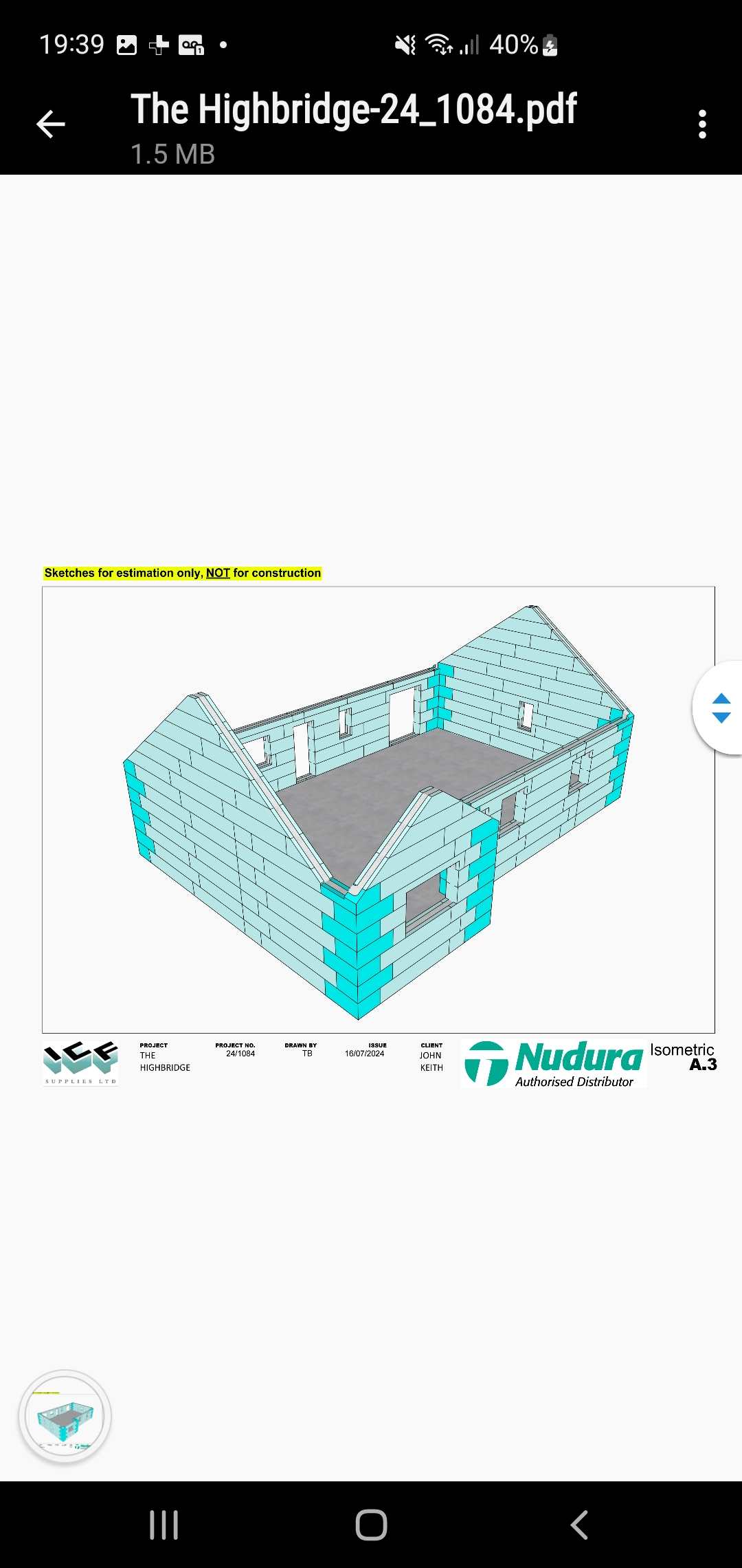

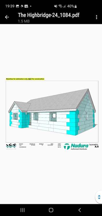

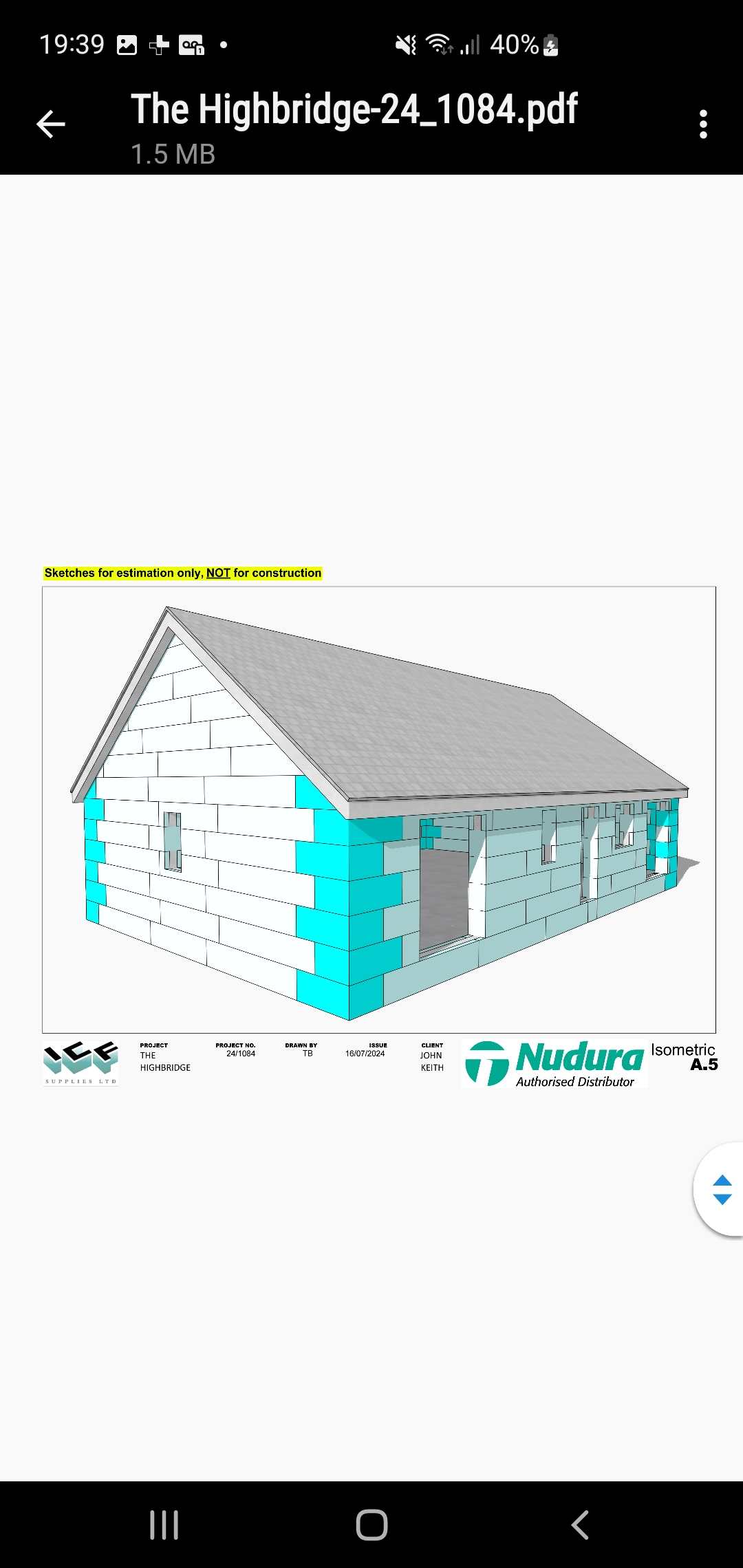

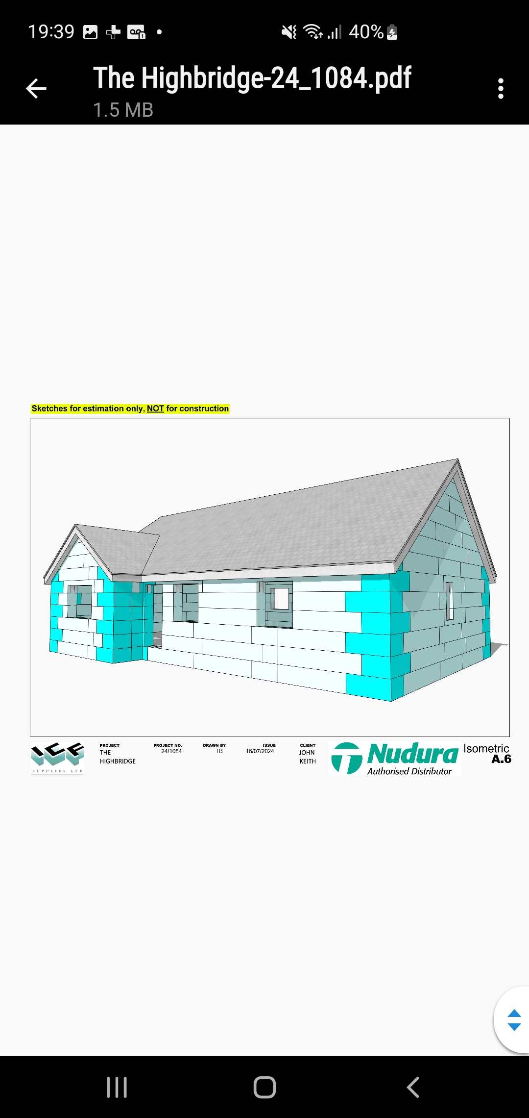

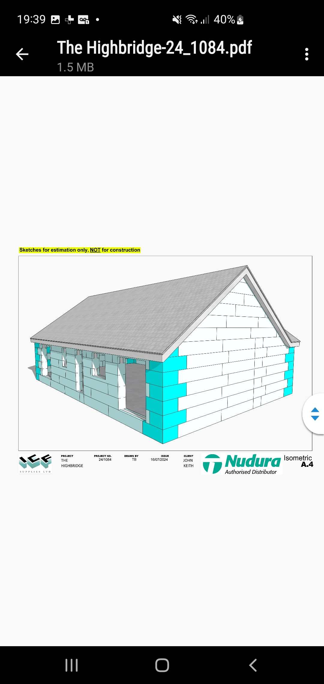

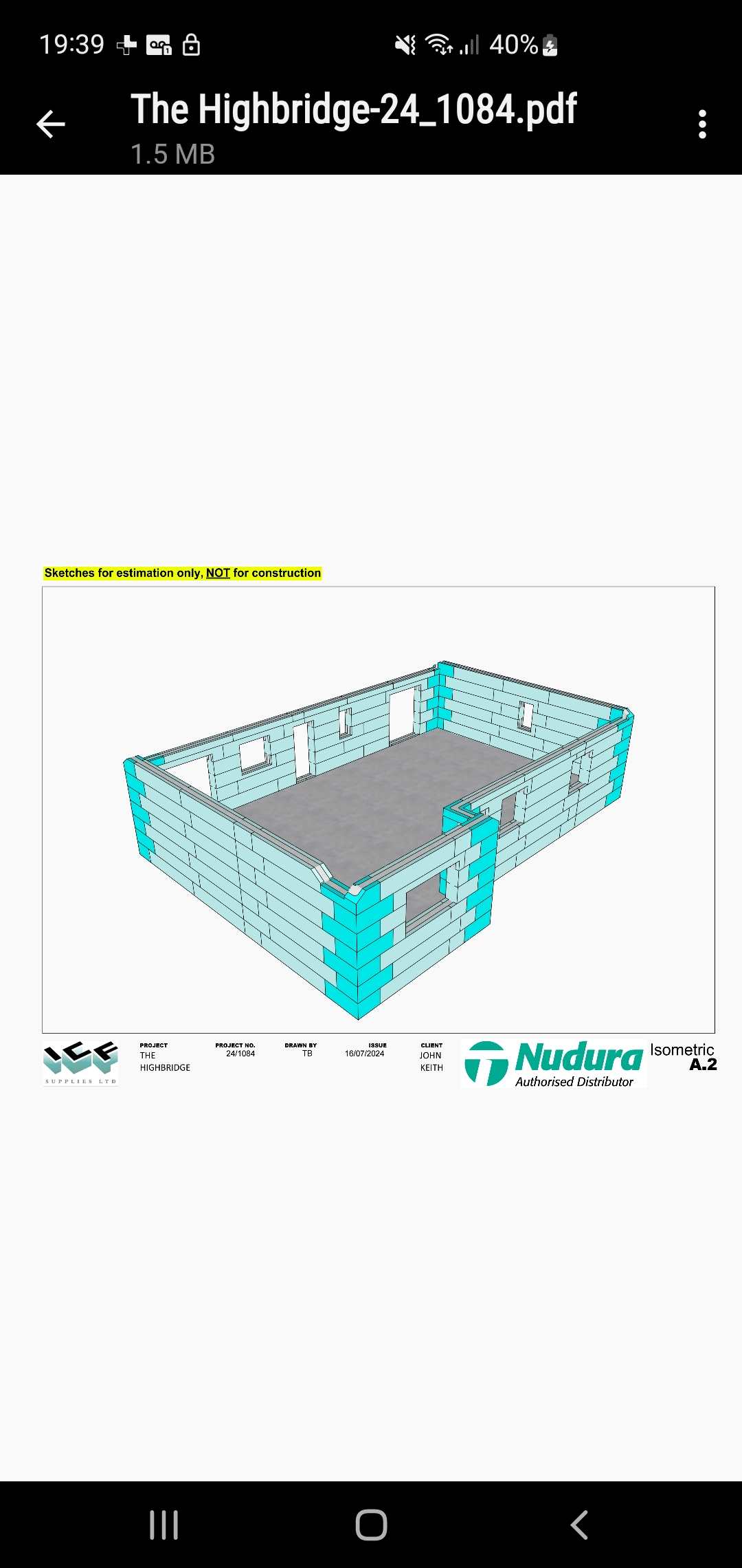

  6. XR35 blocks with 152mm concrete core. 0.16 u value
  7. https://www.mybuilder.com/electrical/price-guides/cost-to-rewire-a-house might be of interest?
  8. I haven't included the cost of 10 or 12mm rebar that is used as lintels but since it means no Catnic lintels, dpc or cavity trays, I'm pretty sure it's cheaper too

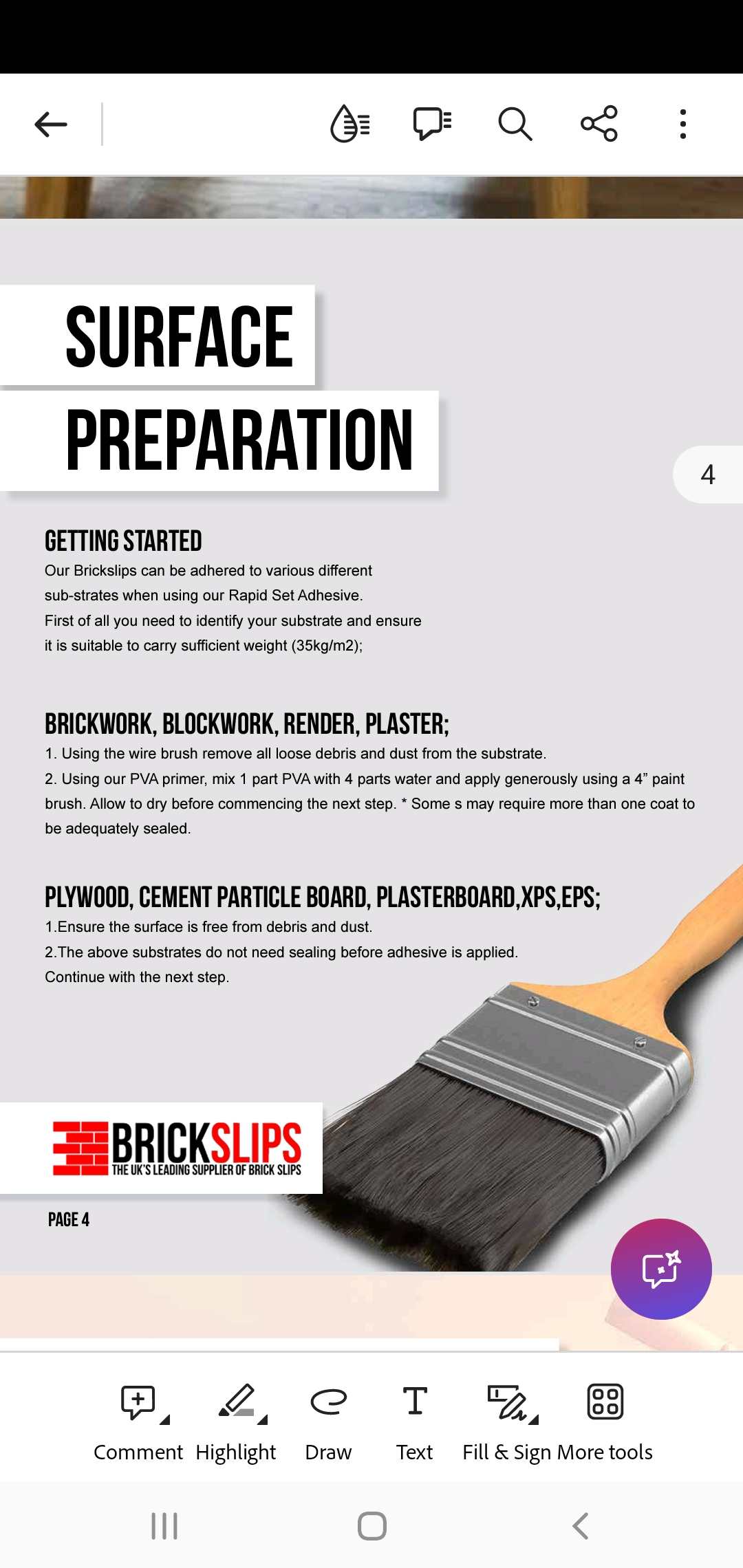

  9. Total cost of Nudura blocks is £14,900 C35 concrete is £675 C25 concrete is £2800 Plus pump truck £850 Call it £20,000. Add £9000 for the brick slips as described so that it allows for damage / waste. Then plasterboard the inside walls £700. That's finished wall construction inside and out which includes 102mm eps insulation inside and out with a u value of .016, no vapour barrier needed and it's £30,000.
