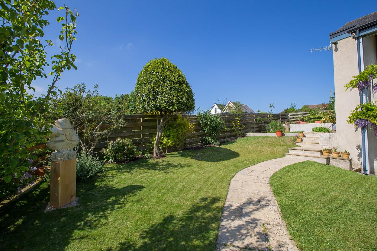

  1. Hi Kelvasco, I agree with Temp; using Type1 hard core is an unnecessary expense and not usually used to create a garden lawn. Additionally, as others have said, if you're wanting to make the most of the space, then a retaining wall is likely to be needed. Declan52's solution is the one I'd opt for, but would add that drainage behind it may be necessary - especially if you're using softwood sleepers - as opposed to oak. There's a good YouTube channel called 'The Restoration Couple' in which Tim (not me) covers pretty much all you'll need to know about building walls with sleepers. The title of this one speaks for itself: OAK vs SOFTWOOD for Garden Projects Additionally, there are lots of videos on installation. If you're not wanting to bother with a retaining wall, then another option might be to level off the ground and have a bank at one end. Visually, this can be quite pleasing, but it's pain to mow! The pic' below is of my last house where I did exactly this: I levelled the ground and banked up the spoil to the left of the steps at the end of the path and then laid turf. Tim.
