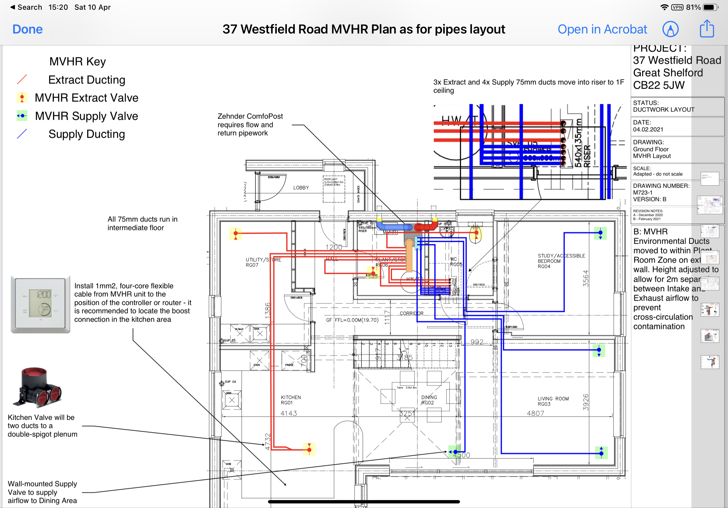

I have a comfo Q450 together with a ComfoPost CW8 for my MVHR AND ALL THE PIPESlies within the house envelope see attached design Do I need to insulate the blue inflow 76mm pipes to prevent condensation if I want to cool the inflow air? if I need to insulate them what should I use and what thickness thank you for your help
