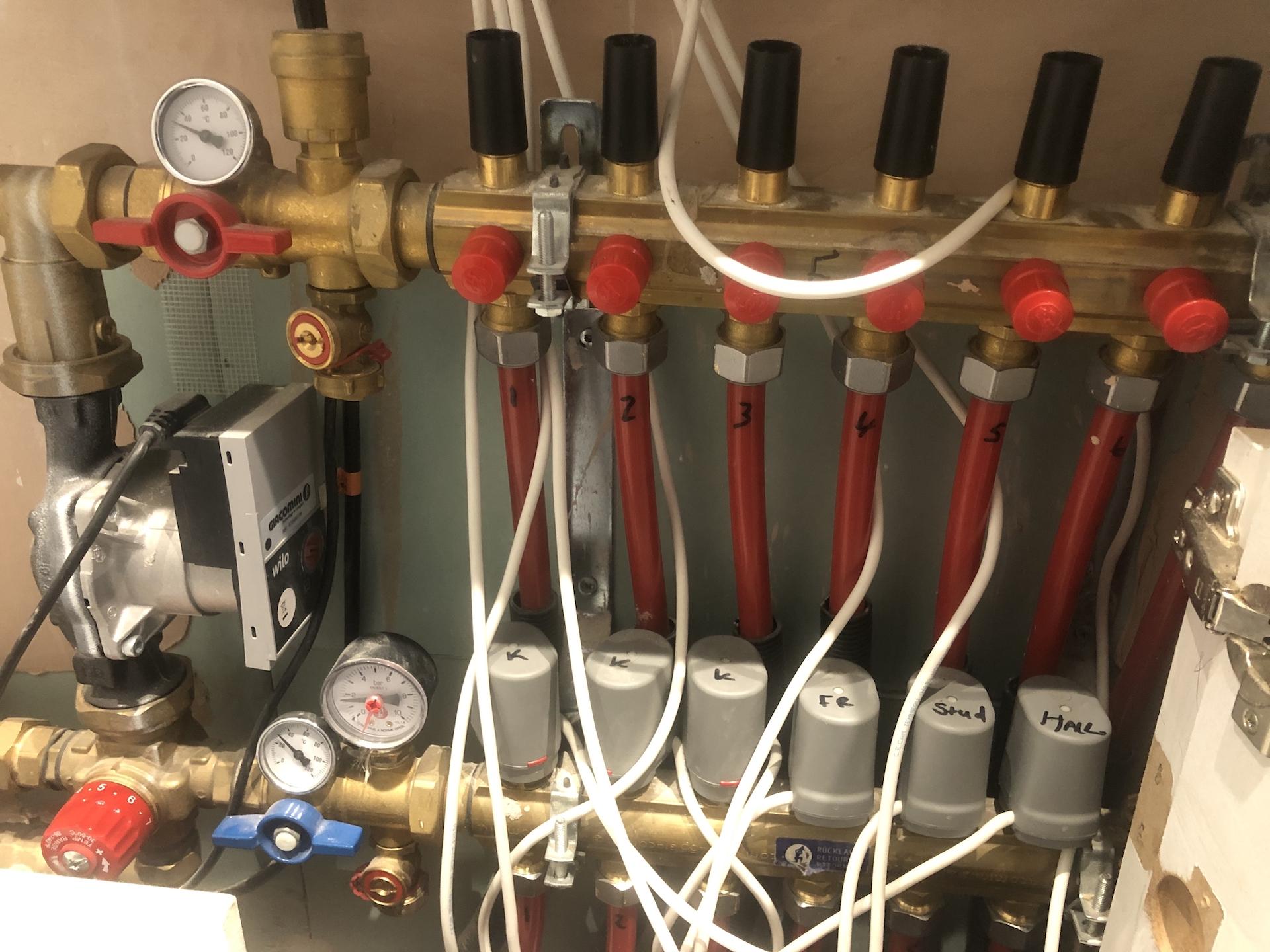

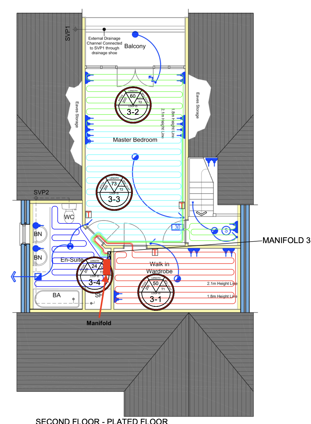

Hello everyone, I wasn't sure whether to post this in the UFH sub forum or here, so feel free to move this if you see fit. I currently have UFH installed through the house, on 3 floors. Ground floor (screed), first and second floors using aluminium spreader plates. The house was renovated 2018. The ground floor works pretty well and I don't really have an issue with the UFH per se, the system itself works as intended (especially after Nick on here fitted a buffer tank a while back). The upstairs floors however are a different matter - the spreader plates are fitted on joists, on top is 22mm wyrock, 2mm underlay and then 14mm engineered wood flooring. Beneath the spreader plates is rock wool. As you can imagine this doesn't it an ideal way to dissipate heat quickly into the rooms, whoever thought encasing the pipes in wood would ever work well (that would be my builder with me giving the gormless nod lol). It just doesn't let enough heat out to warm the bedrooms. I've nursed it through 3 winters and I think I now need to get this sorted one way or another. Here's the attic floor: Each room has its own thermostat and the attic floor being a new addition is pretty well insulated with 200mm celotex in the rafters. The idea I had in mind is to first work on the attic floor, which is devoid of furniture at the moment. I was thinking lift up the wood floor, then the 22mm deck. Remove the pipes and spreader plates. Then run pipes (barrier?) to connect radiators to the 4 port manifold: Before I waste anyone's time - Is this feasible? In an ideal world I'd like to have the radiators connected point to point rather than on a ring - I'm not fussed either way but I would like to retain the ability to heat the floor as one zone independently with it's own thermostat from the rest of the house. I'd also like to connect 5 small/medium size radiators (1 bathroom, 1 wardrobe, 2 bedroom, 1 landing). Having done the heat calcs using an online calculator this looks acceptable to provide enough heat in the winter. First issue I can see is that the manifold mixer valve only goes up to approx 65C - and I can't really oversize the radiators as I don't have that much wall space to hang the radiators on. I may need to replace the manifold with something else? Am I on a hiding to nothing (!) Penny for your collective thoughts, and thanks for your insight valmiki

Thank you Nick, I appreciate the help ? Do you need any other information?

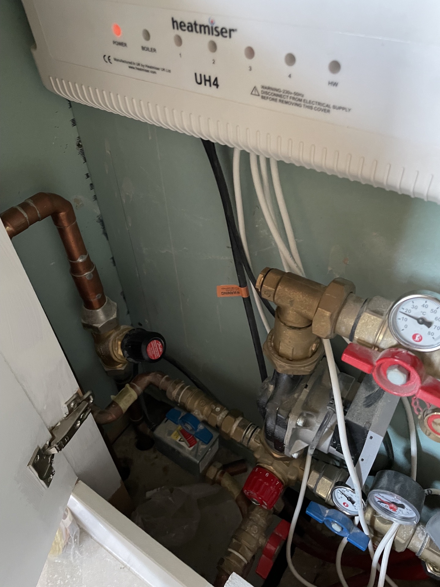

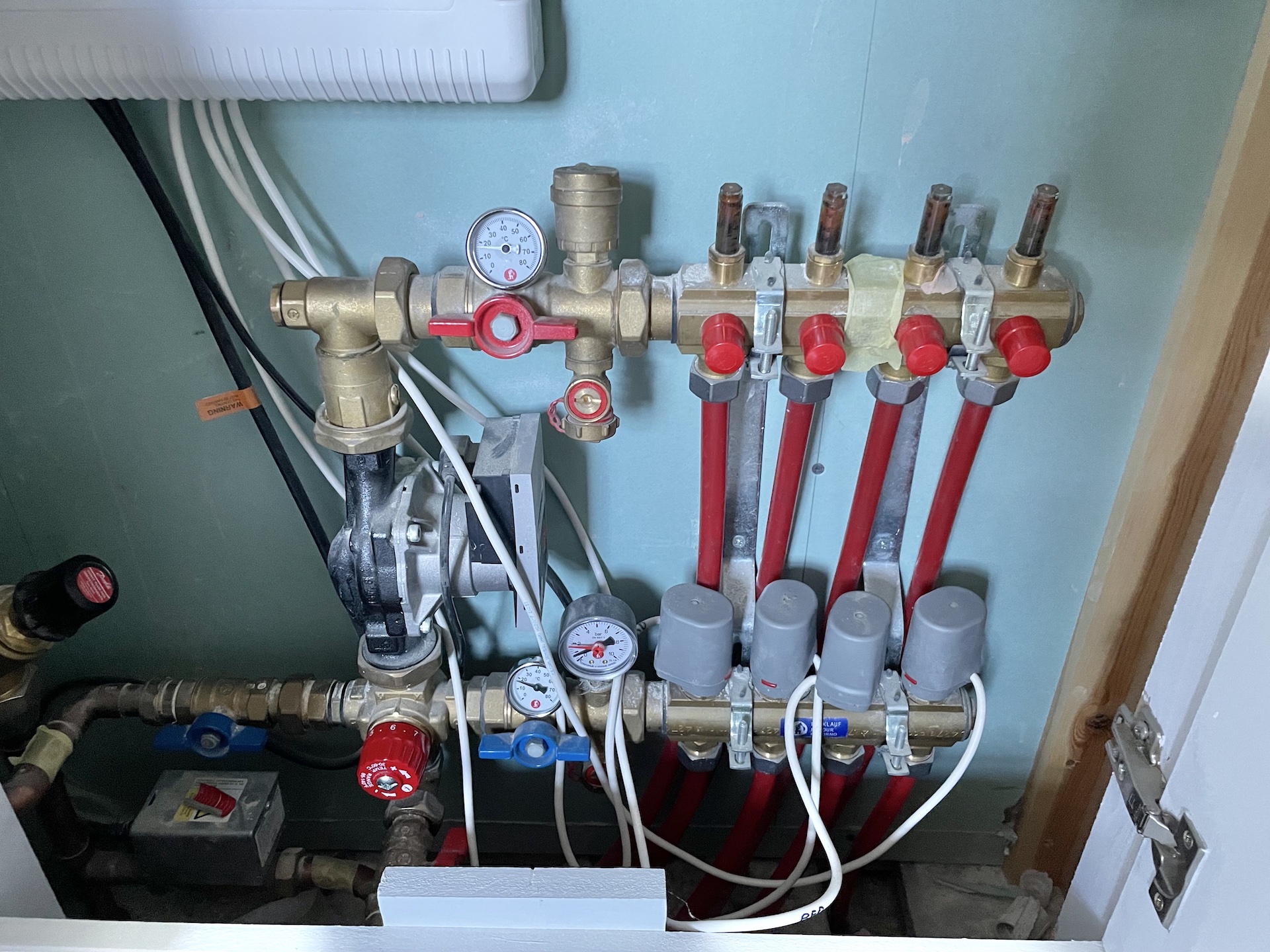

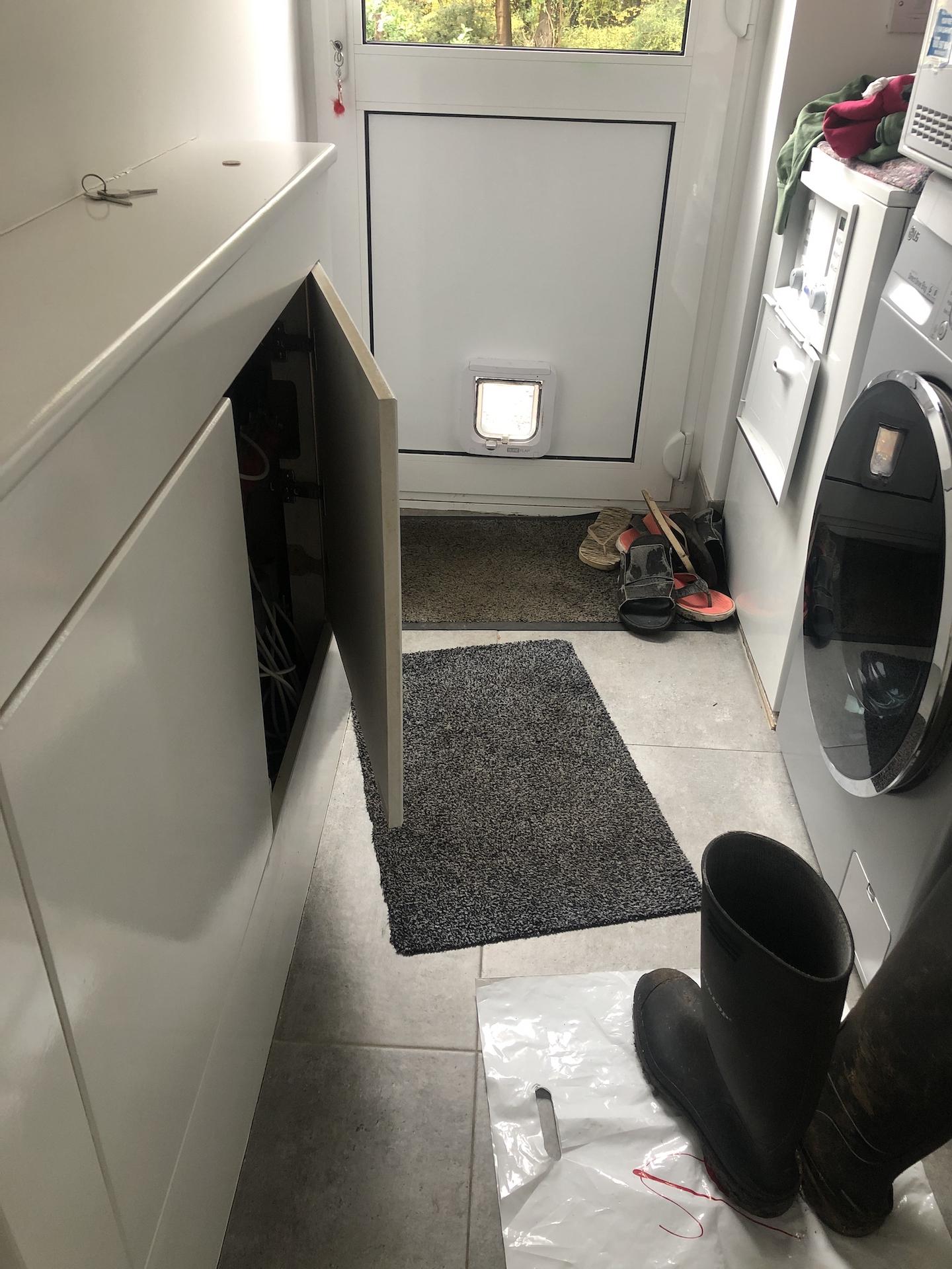

The pipework goes up for the manifolds on the upper floors. The ground floor manifold is installed on the wall opposite (in the utility). I can't be 100% but I think it does come down from above. The cabinet on the left contains the manifold. .

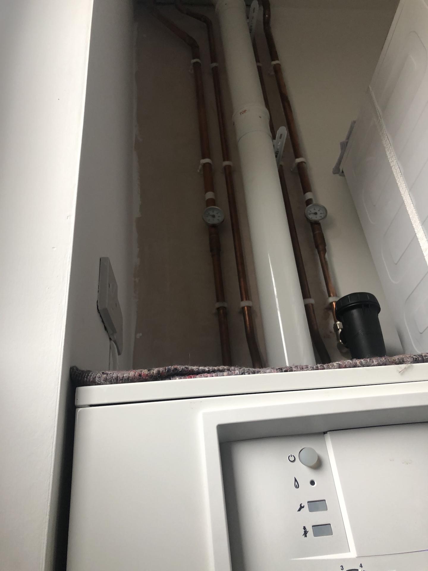

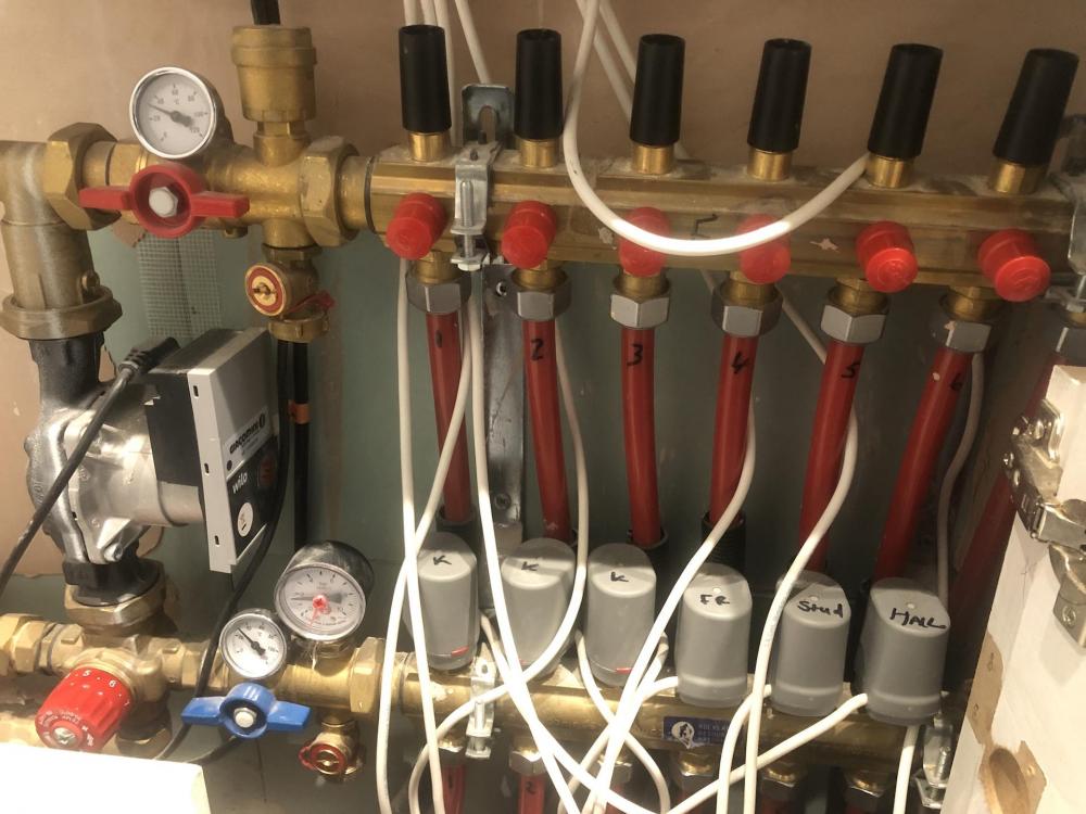

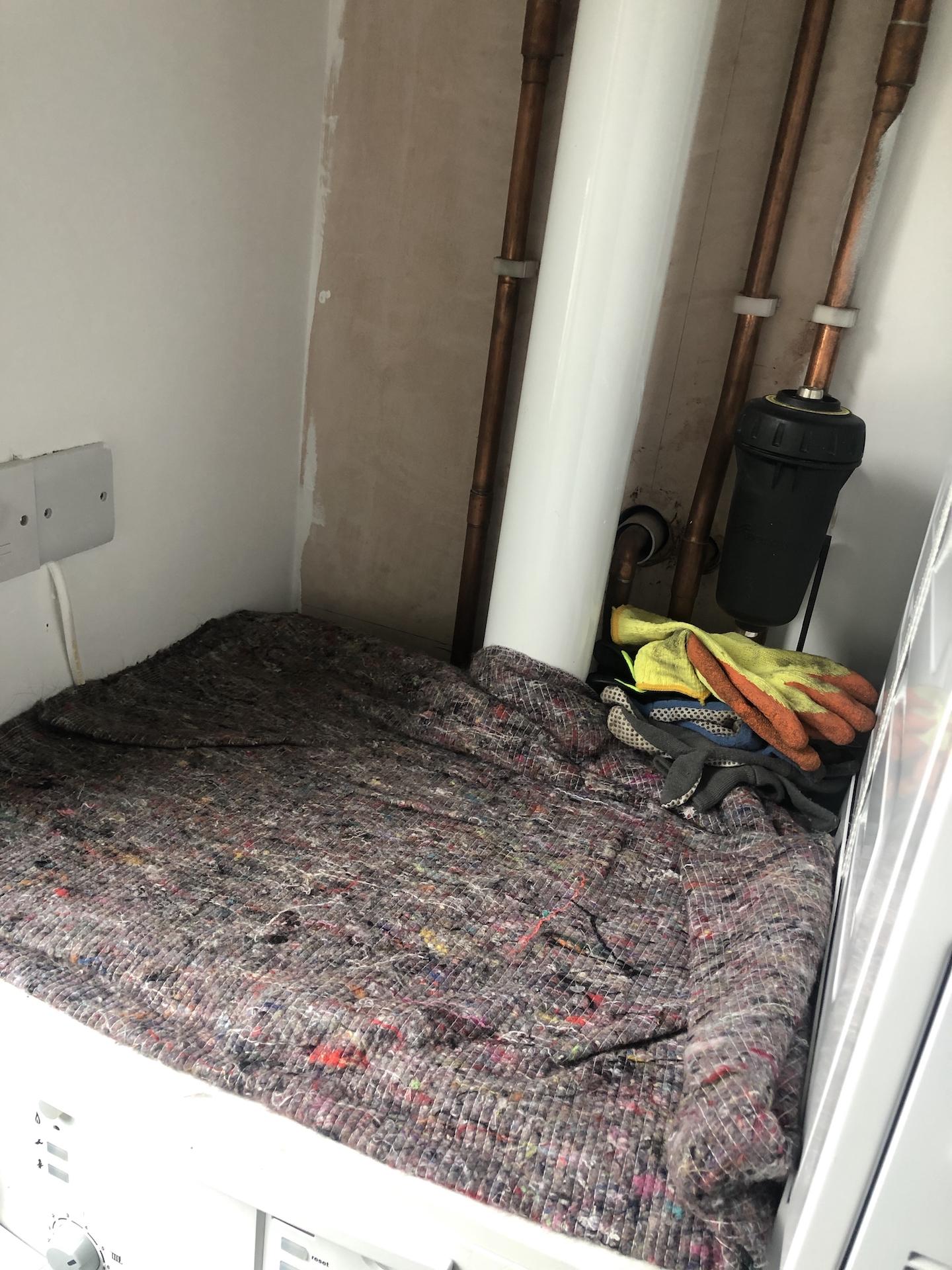

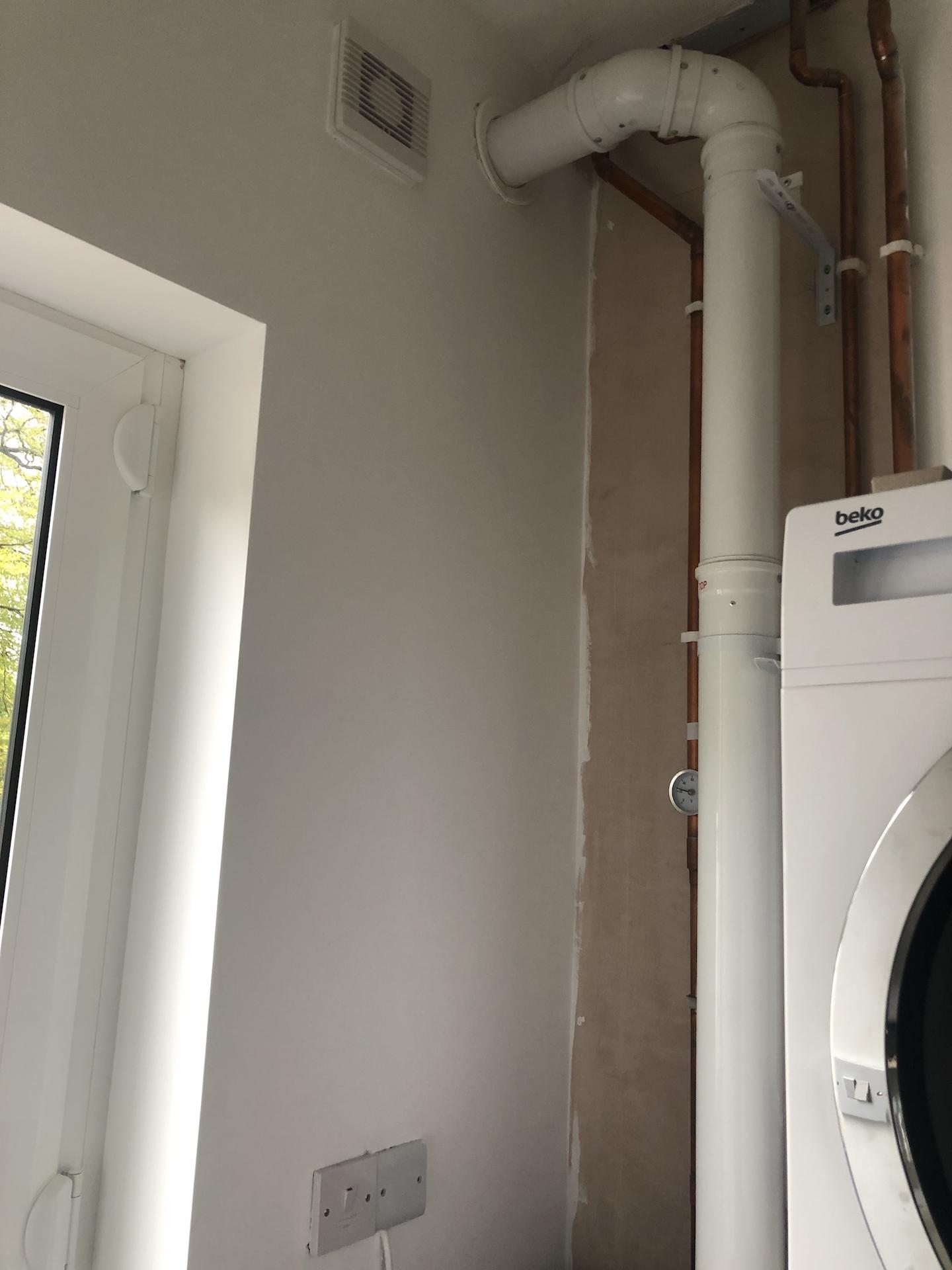

Managed to get the cat off the boiler, so here's the space above it (it's quite high ceiling), and I've taken one of the downstairs manifold. I've been looking into Salus self-balancing actuators , as Giacomini use their own thread sizes they won't fit straight on. I did hear that you can use adapters, but not heard anything more. I'll just have to wait for now. I'm not a fan of the mixer valve that's being used, the scale on it is 1-8, ranging from 30-60c but even on 5 as shown above the flow temp is still quite high. Not sure why that is. The boiler is set to flow at 65c.

Thanks guys. The refurb stripped back the house to the walls and added everything back in, plus added a new extension and raised the height (new roof) to add an attic floor. The screed had 120mm celotex below, new extension was timber frame (140mm celotex) and what was left had 50mm celotex + 12.5 plasterboard lining the inside of the outer walls. These numbers I've just pulled quickly from the BoQ so don't quote me but the house does feel warm enough. The upper floors have 14mm engineered wood + 2mm ufh-compatible underlay, on a deck of 22mm weyroc screwed on top of aluminium spreader plates across joists, earthwool loft roll 44 in-between the floors. The ground floor front of the house has the same wood flooring, the rear is open plan which has 10mm porcelain tiles which works really well but that's to be expected. Nick, I did find an installer setting (in the service booklet) to dial down the heating output of the boiler, but I don't think it will take it below the min rated output which is approx. 10kw, if you can find out anything else I'd appreciate it. Because the house is relatively well-insulated after a while it's just the odd zones that come on and off, in these instances the temp at the manifold never seems to get hot enough and (I'm no heating engineer) it looks like the boiler is short-cycling constantly. With hindsight I would have a smaller, wall-hung boiler and a tank rather than the 550cdi beast but I didn't have much of a say at the time, and now that the house is plastered and painted the thought of fitting a tank in somewhere...! I'm stuck with it for a few years now until it's time to fit a new one, but I think I have room for a buffer tank.
