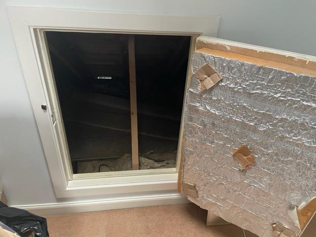

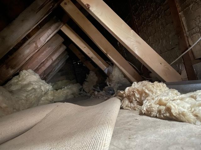

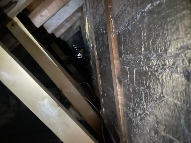

Eaves Storage Drawers - Structural Question
Ramaya replied to Ramaya's topic in Lofts, Dormers & Loft Conversions

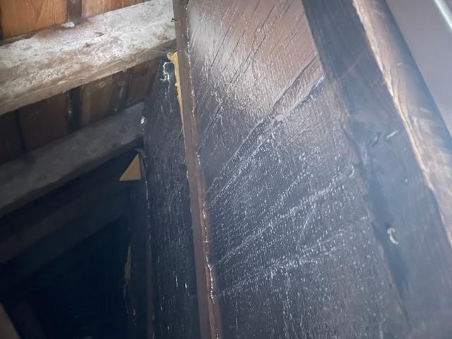

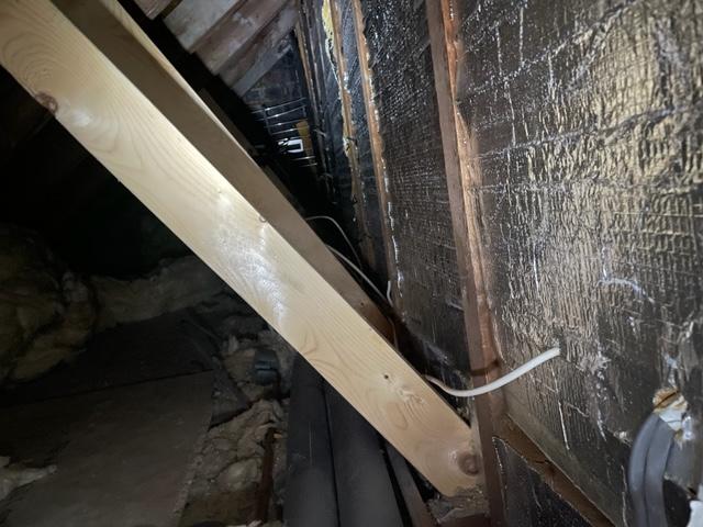

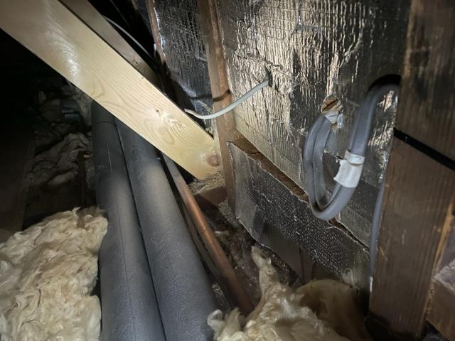

Hi Dave yes ofc the insulated envelope will move out and essentially refit the plaster boards at the back side of the Eaves, if that makes sense. I am also looking at a MVHR installation at the eaves does that section need to be insulated too? can the pipes run around the uninsulated part of the eaves space to route them around the flat? Thanks- 2 replies

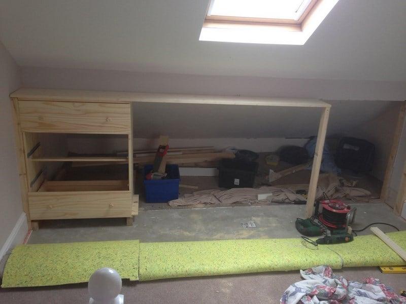

Hi, I am looking for some initial advice before I involve a structural engineer. I am looking to take advantage of the eaves storage space and create drawers that go into the eaves instead of reducing the attic space. I have attached a few photos of the roof construction and my questions are the following: - The angled 4'' by 2'' are definitely structural. So can not be touched. - Then there are some vertical 2'' by 2'' that essentially form the frame for the internal walls that the plasterboard is nailed onto. Can these be removed? Example of what I am looking to achieve. Eaves space

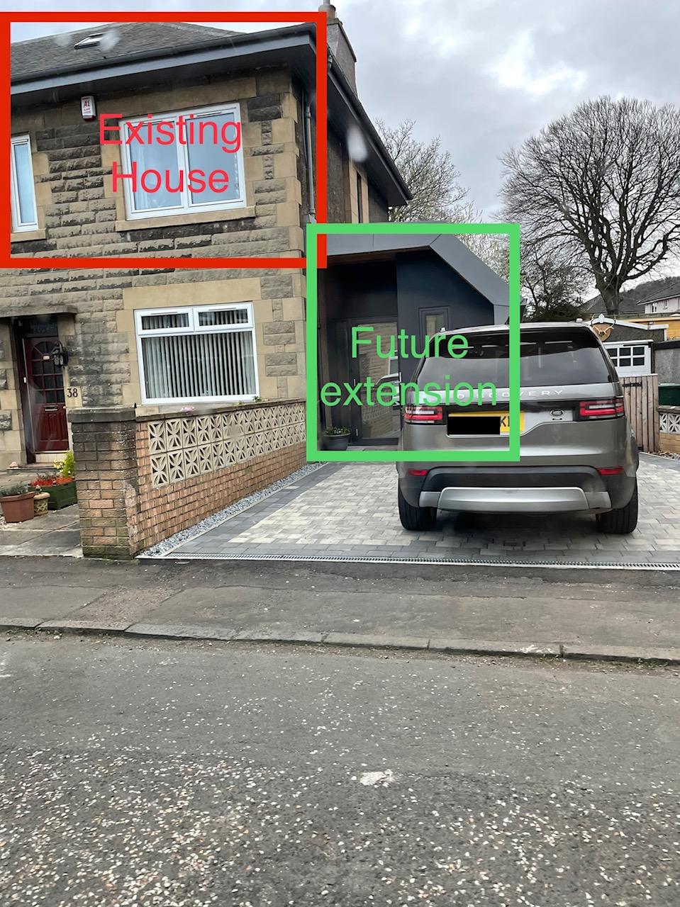

We have very recently (2-weeks) moved to a new property, 1930's upper Villa with a loft conversion (no dormers), about 100m3, 3 bed 1 bath 1 ensuite. I am planning a what i try to call soft refurbishment and I would like to try and future proof the place in every step I take. The house has an ageing combi boiler installed circa 2006 which works but every so often throws an ignition error so i know it is on its way out.. I am looking for what system would be best to go for for my situation considering the following facts: - Combi Boiler at the moment is located in the Attic which is also the master bedroom, I would like something quiet. - I have installed a Drayton Wiser as my wife works from home and we would like to control individual room temperatures. - A system that would be able to cater for a future ground floor side extension which will add 1 bed 1 ensuite, 3 rads in total. Attached photo of similar property. General comments the house is much colder on the first floor than what I anticipated, I'm guessing this is mainly due to 3 sides of it being exposed to the elements and also the ageing windows (already planning to replace all of them). Is a system boiler with an UVC the best option? Replace with another Combi System? Thanks,

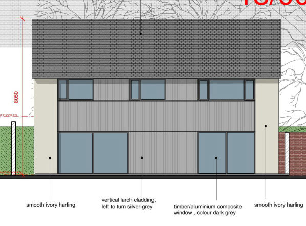

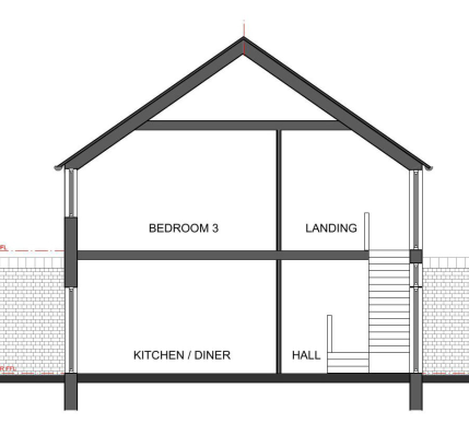

I'm trying to understand the economics of a self build better and want to understand how to better predict £/m2 pricing. Obviously the complexity, design features, material choices will have an immense impact on price but for the sake of this arguments let me simplify it to a cost for a watertight shell (finished render exterior & doors and windows). What would be more expensive: A 200m2 single storey house or A 200m2 1.75 storey dwelling with a ground floor area of 100m2. To me the answer is obvious the first will be more expensive due to the larger foundations roof etc. However, by how much? I am looking at a plot that has planning permission for a rectangular 4 bed 1.75 dwelling (200m2 roughly) and I'm straggling to understand how to price it correctly per m2. Location: outside Edinburgh by-pass, preferred construction method: ICF. I've budgeted about £110 - 130k so far for a water tight shell with me working PM'ing a contractor to reach that stage but maybe i'm day dreaming.
