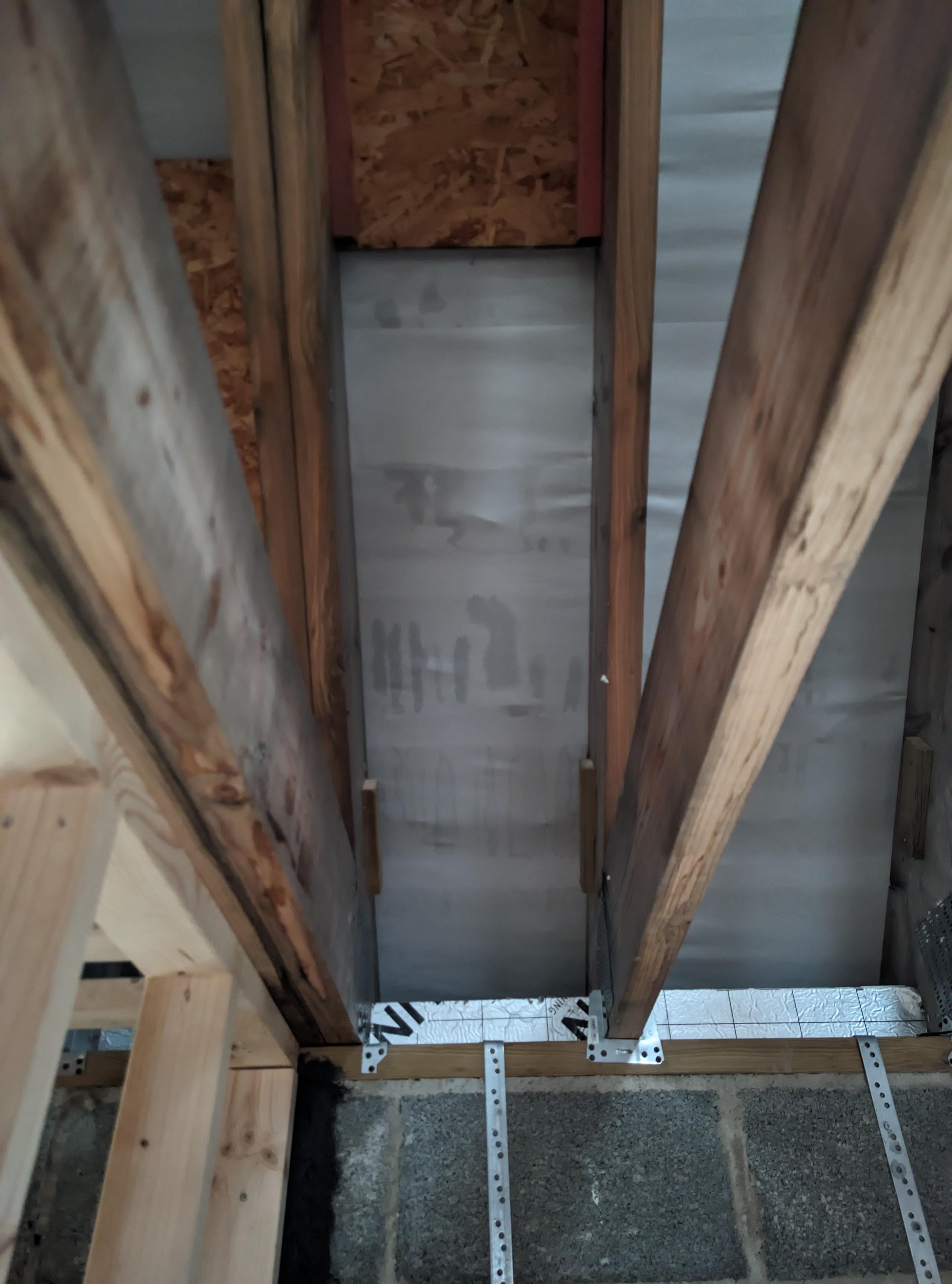

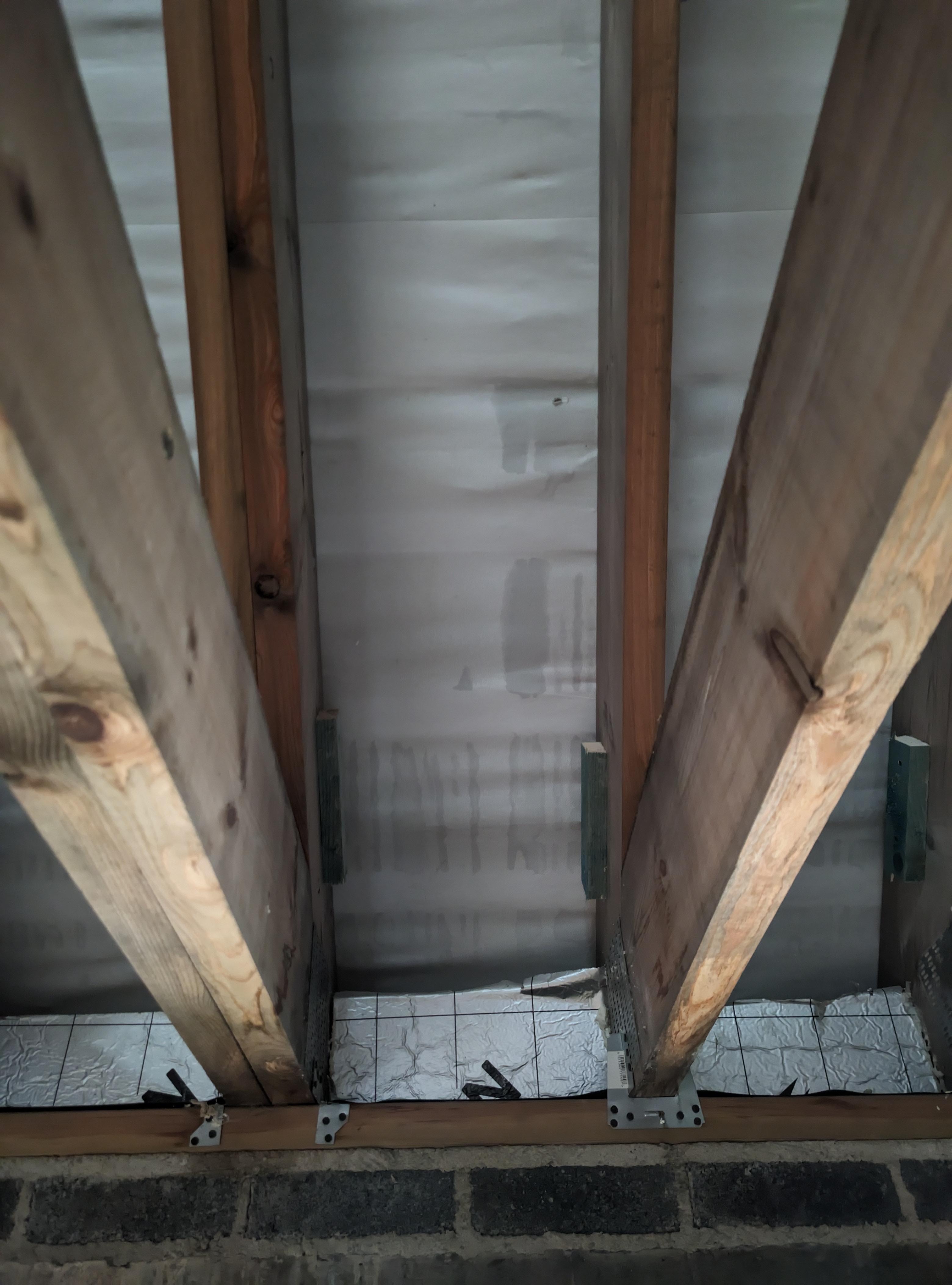

OK bit more progress on this. I'm even more dumbfounded. So I had a hose constantly on different parts of the roof flat out at hour intervals this week and nothing shown up on the inside. No patches, no streaks, nothing. I took a panel off (in the rain) to expose the GSE tray underneath and there was no running water on the tray, the top flashing and panel was taking the majority of the water away, but what I did notice was the tray had what looked like condensation on it, wiped it with my hand and was soaking. So is that what is showing up on the membrane?? Another test I did was put a piece of DPM across the opening in the tray to see which side of the DPM was getting wet. Went down this morning after rain, wet patches visible on the inside again, pulled the DPM out and found that the external side was dry and the internal side was wet with condensation?? So seems like possibly condensation but I still don't understand the science on it 🤷🏼♂️

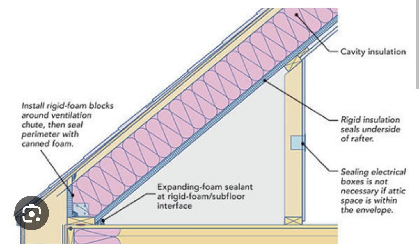

Yeah sorry I added that pic just as an example. It's a roof with attic trusses so need to work around the timber uprights of the dwarf wall etc

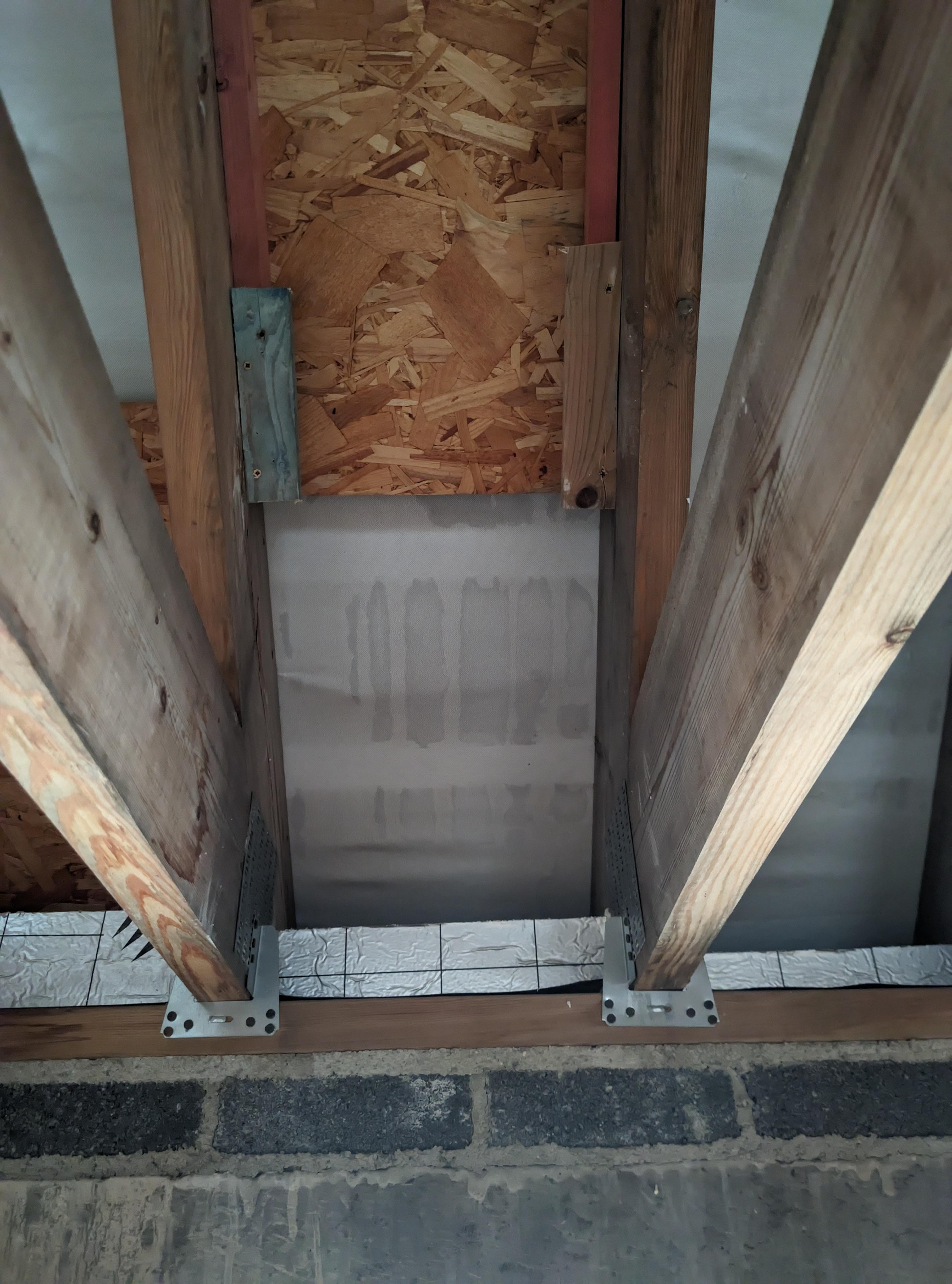

I have (maybe stupidly) decided to insulate my roof all the way down to the eaves to maintain a good thermal envelope with the wall insulation. All good. However, I now need to find a clever way to maintain the VCL/airtightness layer from the top all the way down to the walls whilst cutting around the dwarf wall timbers and floor chords of the trusses? Any ideas/tips how to maintain a good seal through and around the timbers and to make this as unfiddly as possible. Thanks
VCL across bottom chord of attic trusses
CH_18 replied to MortarThePoint's topic in Lofts, Dormers & Loft Conversions
Hi mate, sorry to resurrect this thread from the dead but did you come to a solution for this? I have the exact same issue of maintaining a continuous VCL through the dwarf wall timbers and truss chords. Thanks mate -

Hi everyone, We have recently had GSE in roof solar panels and trays fitted to our new build roof which is now complete and slated. Since then we have been getting wet patches/streaks on the membrane visible from below. My roofer has been round and said he's 90% sure it's condensation, which I'm not convinced by. The patches only form when it's raining which seems to be the big give away for me that it's water ingress and not condensation, but saying that, I'm no roofer. Any thoughts/advice would be much appreciated. Thanks

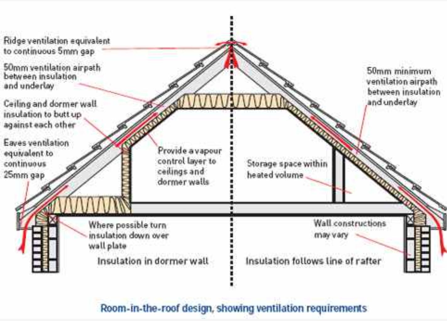

Hi all, The attached detail shows 2 options how to insulate the roof space of a room in roof. Our architect had specified the left hand option, 100mm between rafters of sloping roof and knee wall covered with a 50mm overlay then plasterboard. We would like to use the eaves space for storage/access so the right hand side option of insulating the roof line all the way down to the wall plate is my preferred way. Just seems way more energy efficient and easier for airtightness etc. So my plan was to put 100mm PIR in between rafters ideally from wall plate to ridge, overlay with 50mm celotex top to bottom and the install VCL and plasterboard. So my insulation and VCL envelope will follow the roof line. My questions are, if I insulate the roofline as preferred, Do I need to insulate the knee wall at all? Do I need to insulate the floor below the eaves space? Can I leave the eaves space with no plasterboard, and just plasterboard the room? thanks in advance

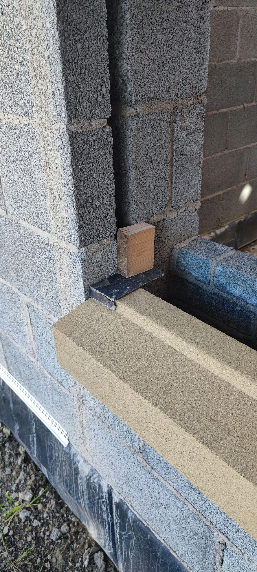

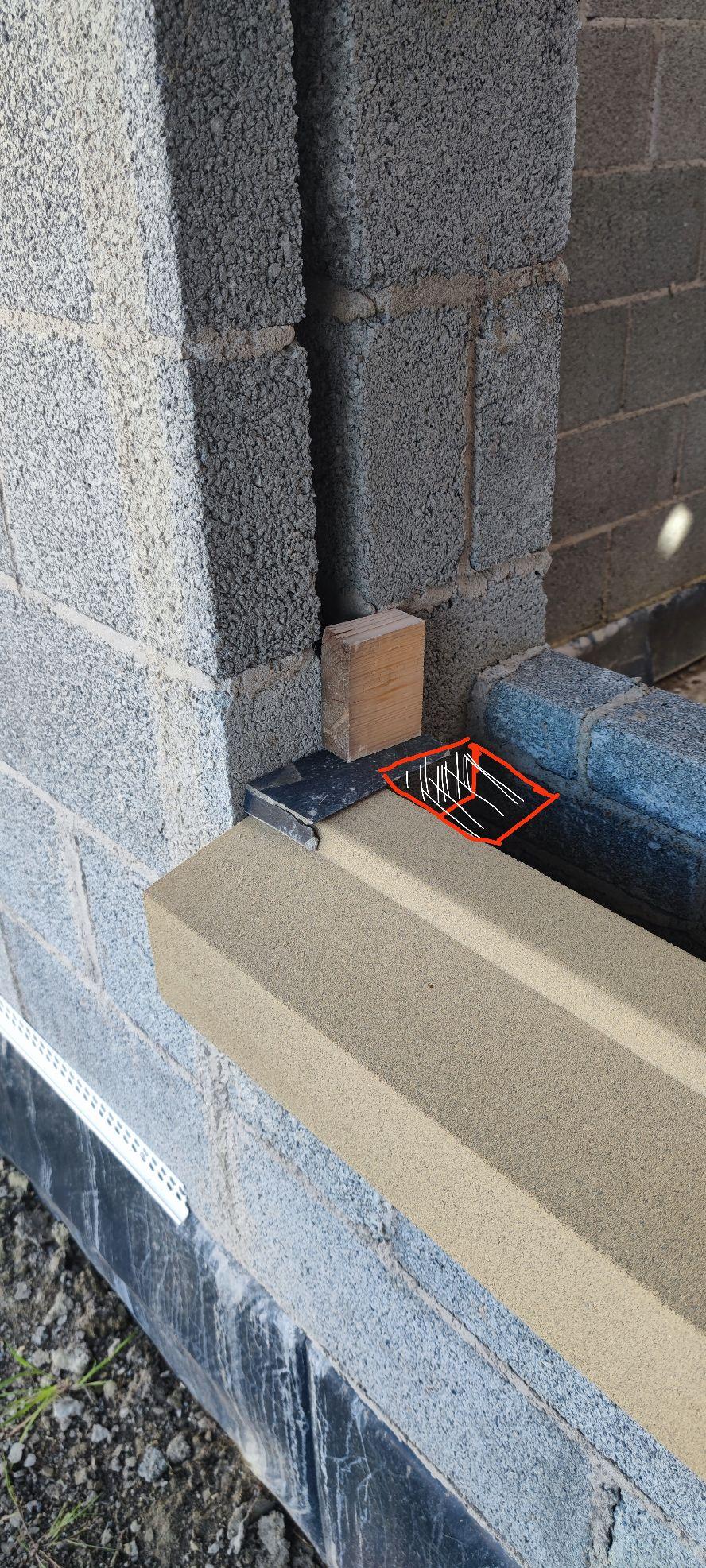

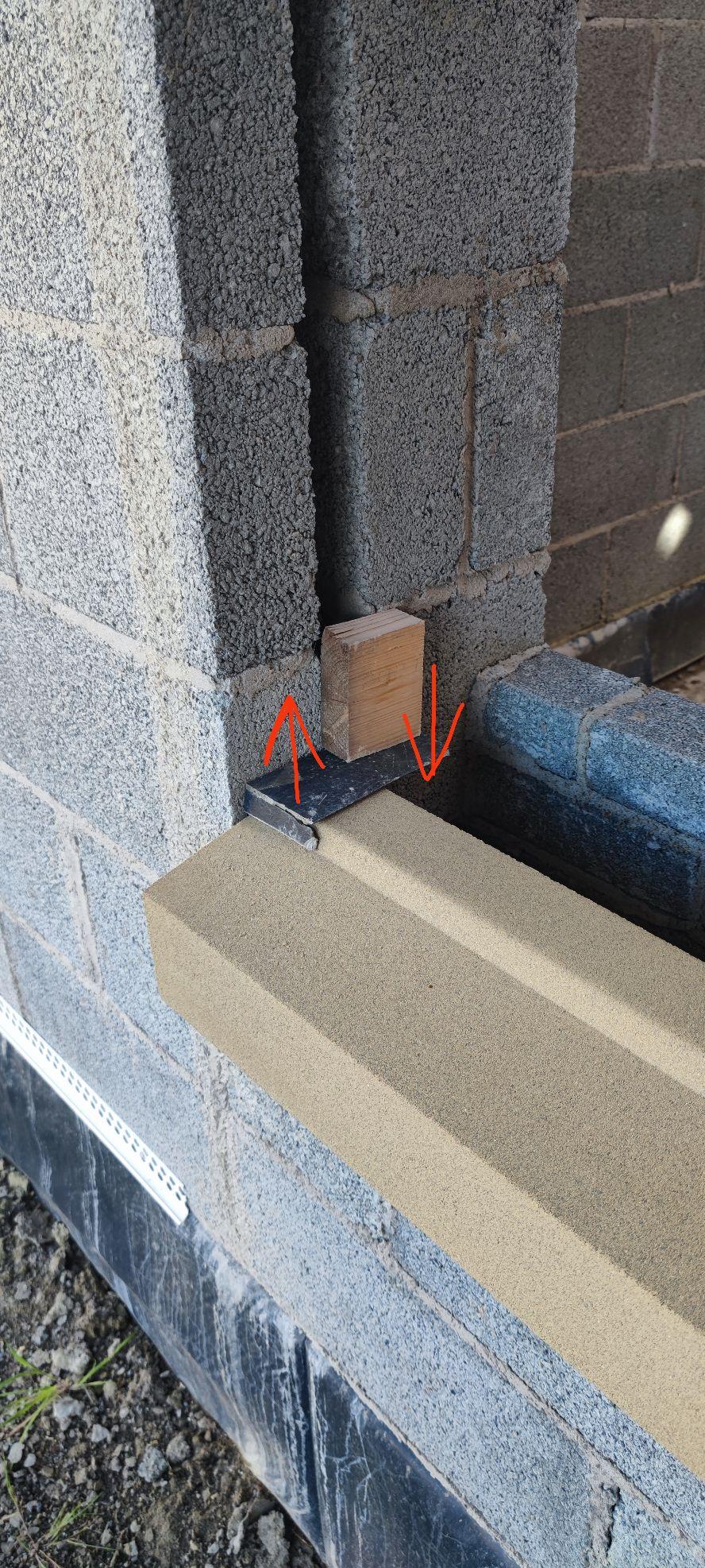

Been thinking about the best way to support the frame from the bottom, what about if I fix some angle brackets off the inside reveals. I've added a couple of pics to show. Will this be enough support? Obviously there will be straps also.

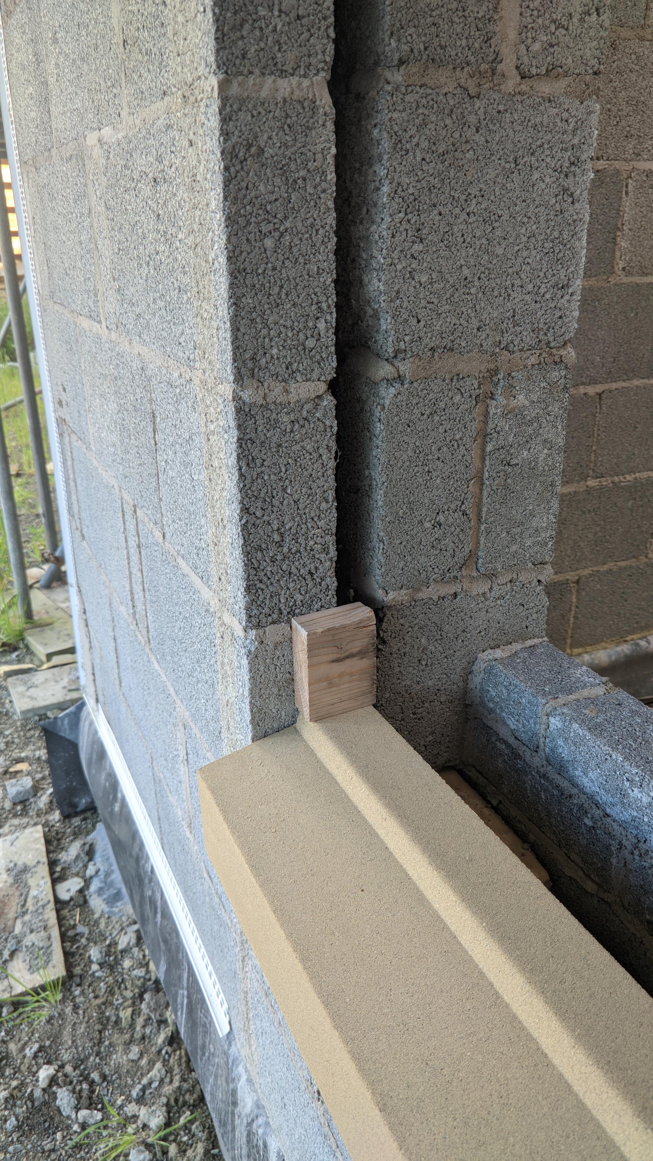

Thanks again @craig, appreciate your help. Option 2 (window positioned in the insulation layer) seems to be the way to go. My only issue is now figuring out a way to support the frame at the bottom. I will have the 150mm sill on the bottom but due to the weight and position of the frame (replicated by the piece of wood) the support would not be centered and may cause a cantilever effect (attached pic) Any ideas on how I can support the window? Metal dowels have been mentioned in other threads? Or simply angle iron/brackets? One last question, in normal situations where the frame is sitting on the sill, is this not a massive cold bridge? Or is there some sort of thermal break within the uPVC frame? Not really related but just curious. Everydays a school day 👍

Hi there, Our sills are not quite deep enough so I have two options below (wood simulating window frame position). I have just placed the sill in position to test fit, DPC's will be going in. See next post for pics... Option 1 (left) Go with a smaller reveal, with a cold bridge and not much overhang on the sill, although still clear of drip groove, which I think looks neater. Or Option 2 (right) Set the window back in the insulation space and utilise a 150mm uPVC sill to cover the flat part of the stone sill. More overhang on the sill but possibly looks a bit naff? (They are just off cuts of slate to replicate colour of sill.) I would really like to have smaller reveals but not sure if the cold bridge is worth the risk? Does it make that much difference? Any input is appreciated. Thanks
