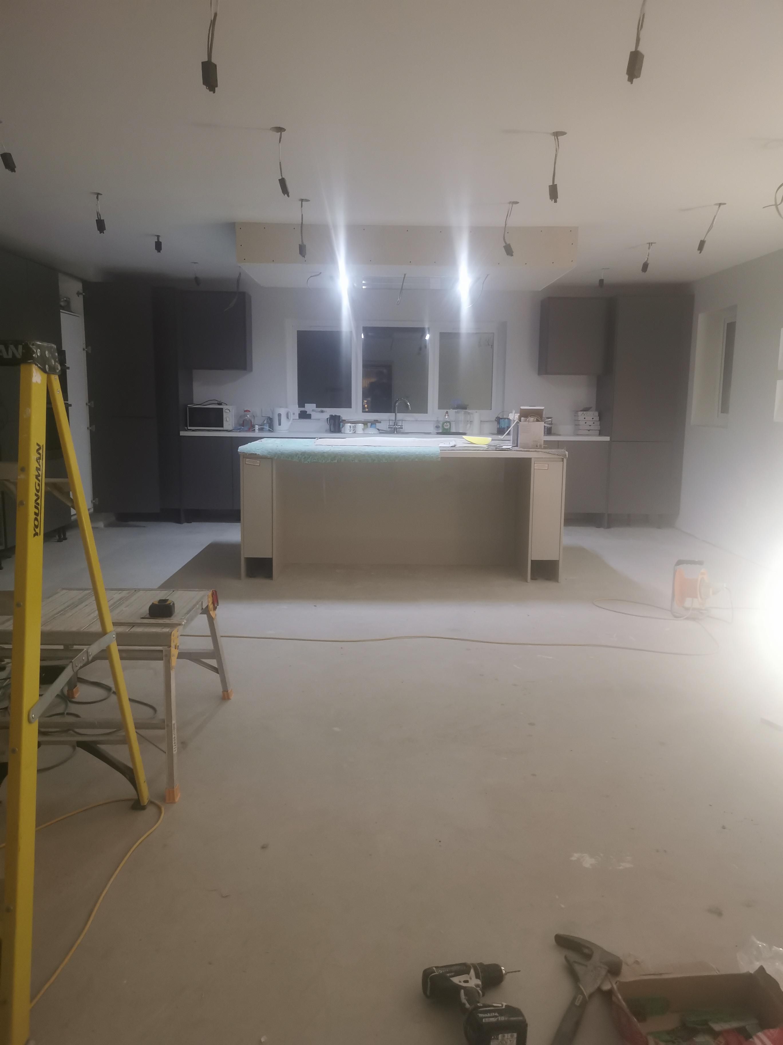

	Hoping to get into the new house this week. The price increases have definitely hit the budget a bit, but not enough for it to hinder our determination to reach the finish line! A year since we got the foundations in and started putting up the panels the we had already made on site. Here's a glimpse of the kitchen, flooring has since been laid.

	Hi everyone, just at the stage of fitting kitchen and doing floorings etc. My plan was to fit the kitchen/island then lay the vinyl click flooring. The island has a back panel, and end panels which could hide the edges, it could be in against the legs all the way along below kitchen units and hidden by kick plate. Since thinking I would do it this way, others have said lay the flooring everywhere before the kitchen, what's everyones experiences on this one?

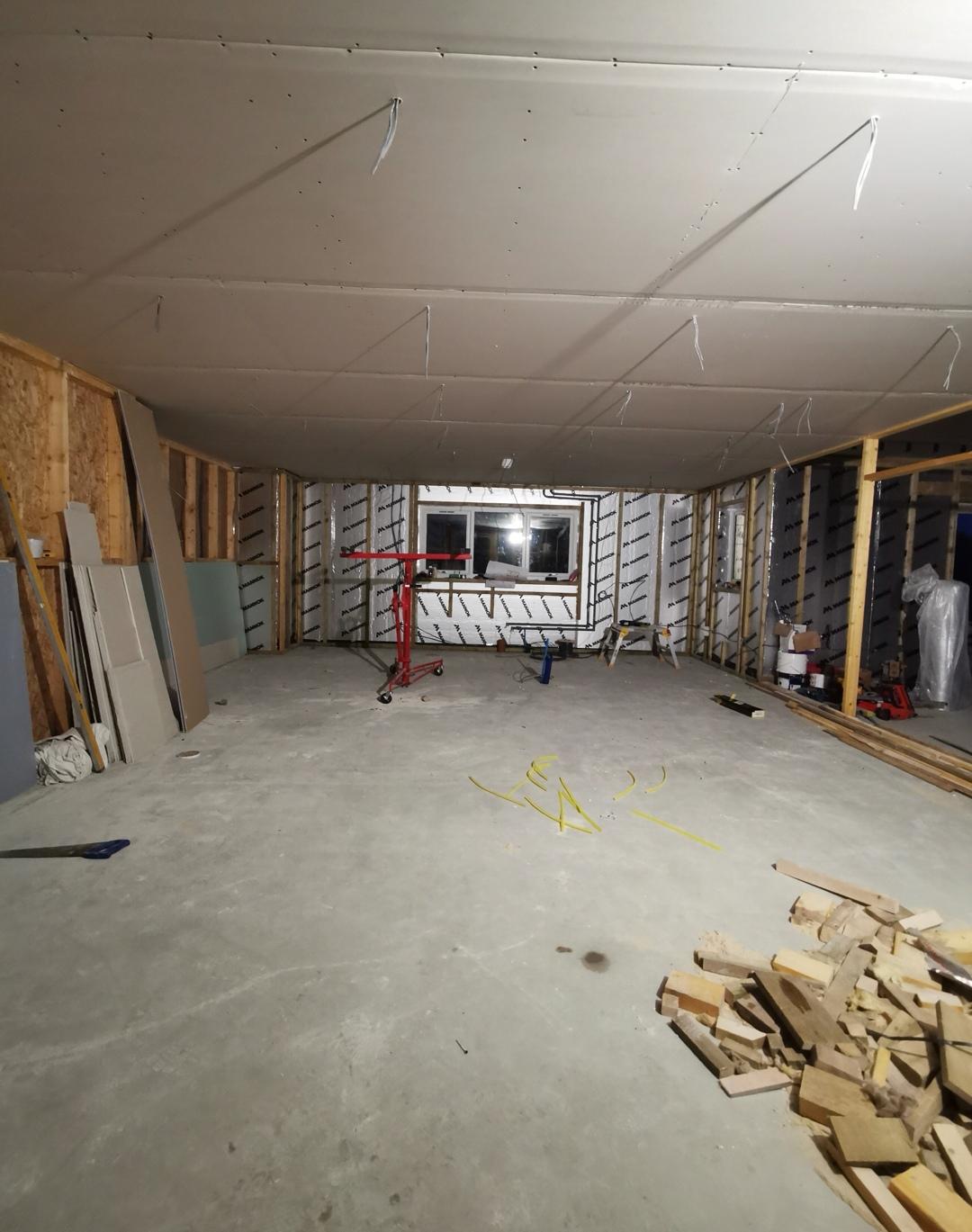

	Hi there, was wondering if anyone had any images of their projects at service void stage? Keen to see how everyone done their framing and what it looked like with all the services in just before plasterboarding.

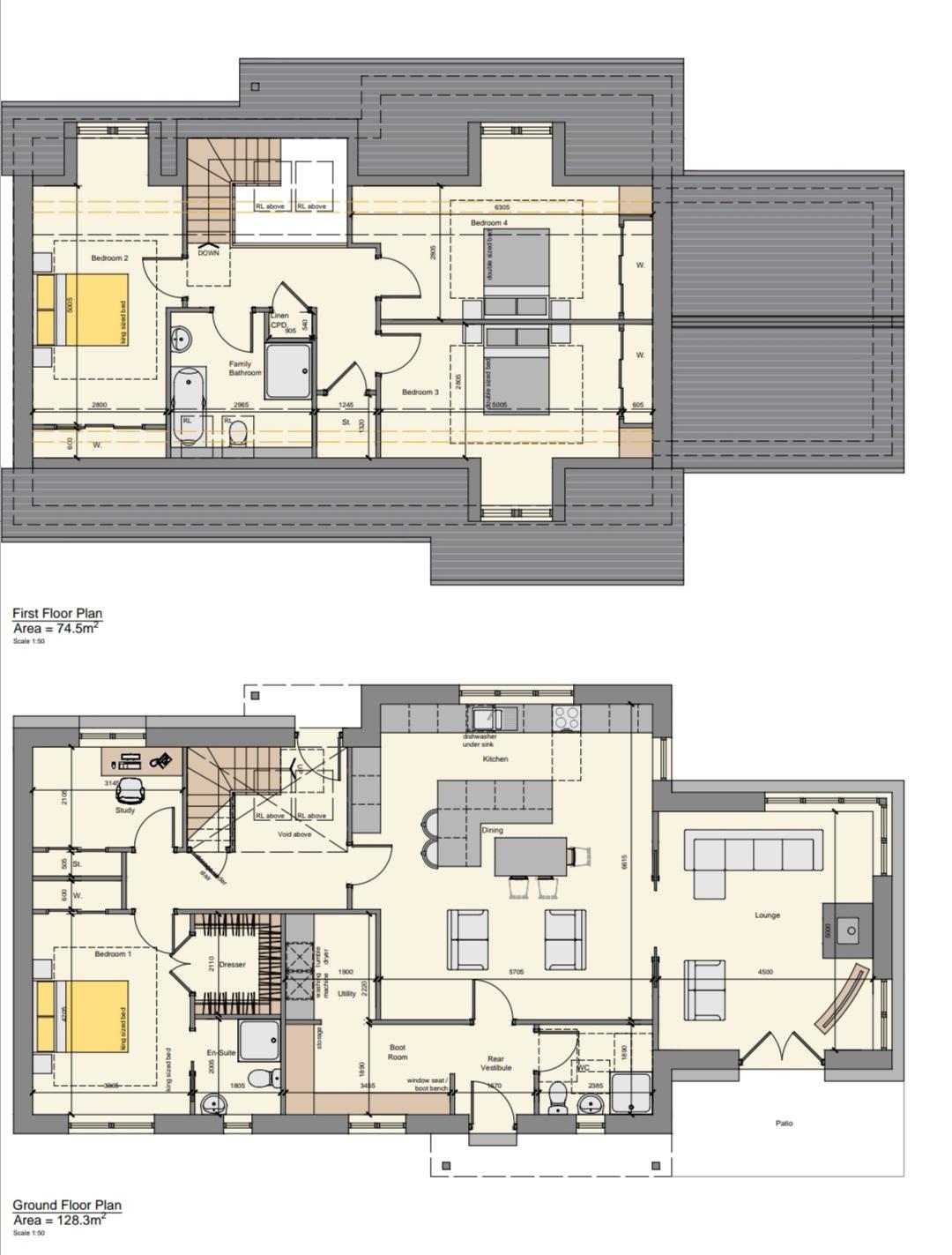

	When you see that, its the door in the middle of the bottom wall is our biggest hindrance! That would work well i'm sure. The table being against the island probably is as good as we can do though, but is the island and kitchen laid out to the best potential? We cant decide on it at all, would the island be best coming off the left wall or even the right wall and the table the opposite way round on the end of it? With the 3 kids i think the boot room area will be busy...jackets and dirty footwear galore i'd imagine.
	That fairly makes the room a decent size! We had that to begin with, but we didn't like the idea of walking through the utility, and being a farmhouse we wanted a toilet and decent boot room area when you come in the door. Thanks for the good idea though,If funds allowed we should have built bigger just!

	That is what is going on. We have since thought on just a long straight island....an over hang for stools at the right hand end if need be, but do we really need any breakfast bar area? The sofas would be both facing one of the corners or wherever the tv will be. We were thinking on a bench along the back of the island so the table could sit against the island and save space, that's where that idea came from.
	Thanks. The architect actually had pocket doors in there and a few other bits, we removed them as we weren't keen on them...mistake maybe?!
	Hi there, could anyone help with layout of the kitchen living area and the lounge please! We like the idea of two separate rooms, then done away with the double doors between the two. Now that we are getting kitchen plans done we are finding the kitchen space on the tight side for a sofa and that too, so has anyone any ideas on the arrangement the kitchen should be to suit, and if we should move the opening to the lounge or just totally open up that wall?
	That's the plans altered anyway. Done away with the amount of doors in the boot room area of the house, made it a metre longer to make kitchen wider and allow us to turn the wc at the backdoor around. Thanks for all the useful comments on here, still no MVHR, but room for plant cupboards at end of boot room against utility now.
