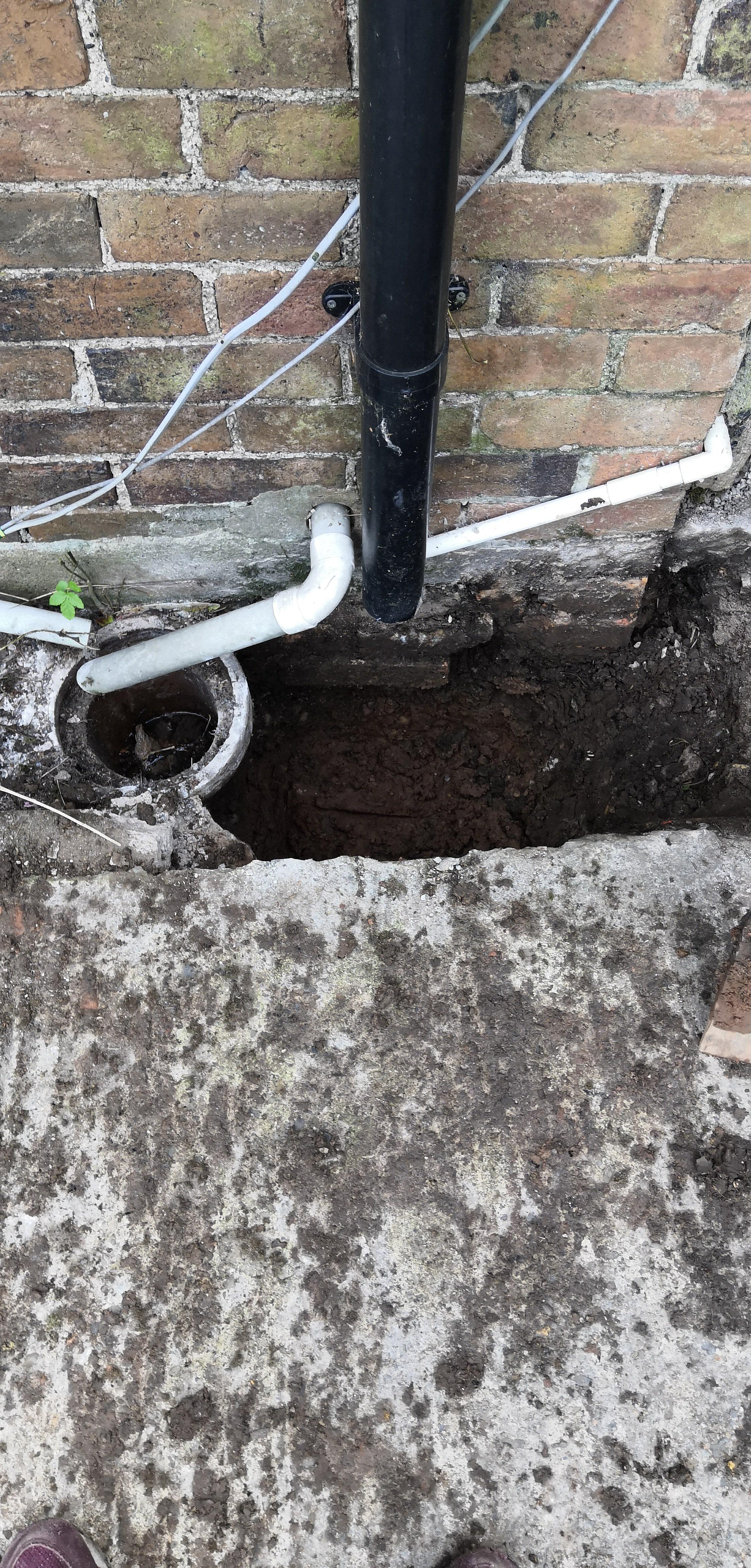

  9. Just added a pic of proposed exterior location..
  10. Hi again Peter The existing rising main is 22mm copper and is located in the corner of the kitchen, the pipe just disappears into the concrete, god knows where it ends up..Anyway rather than breaking out a section of concrete to a depth of 750mm around the existing rising main, is it possible to bring the new MDPE on the exterior side of the wall and penetrate the wall at say 400mm above floor level, avoiding the ballache of digging out and reinstating the section of floor..i'd need to insulate and/or use an enclosure of some kind. Cheers again in advance.

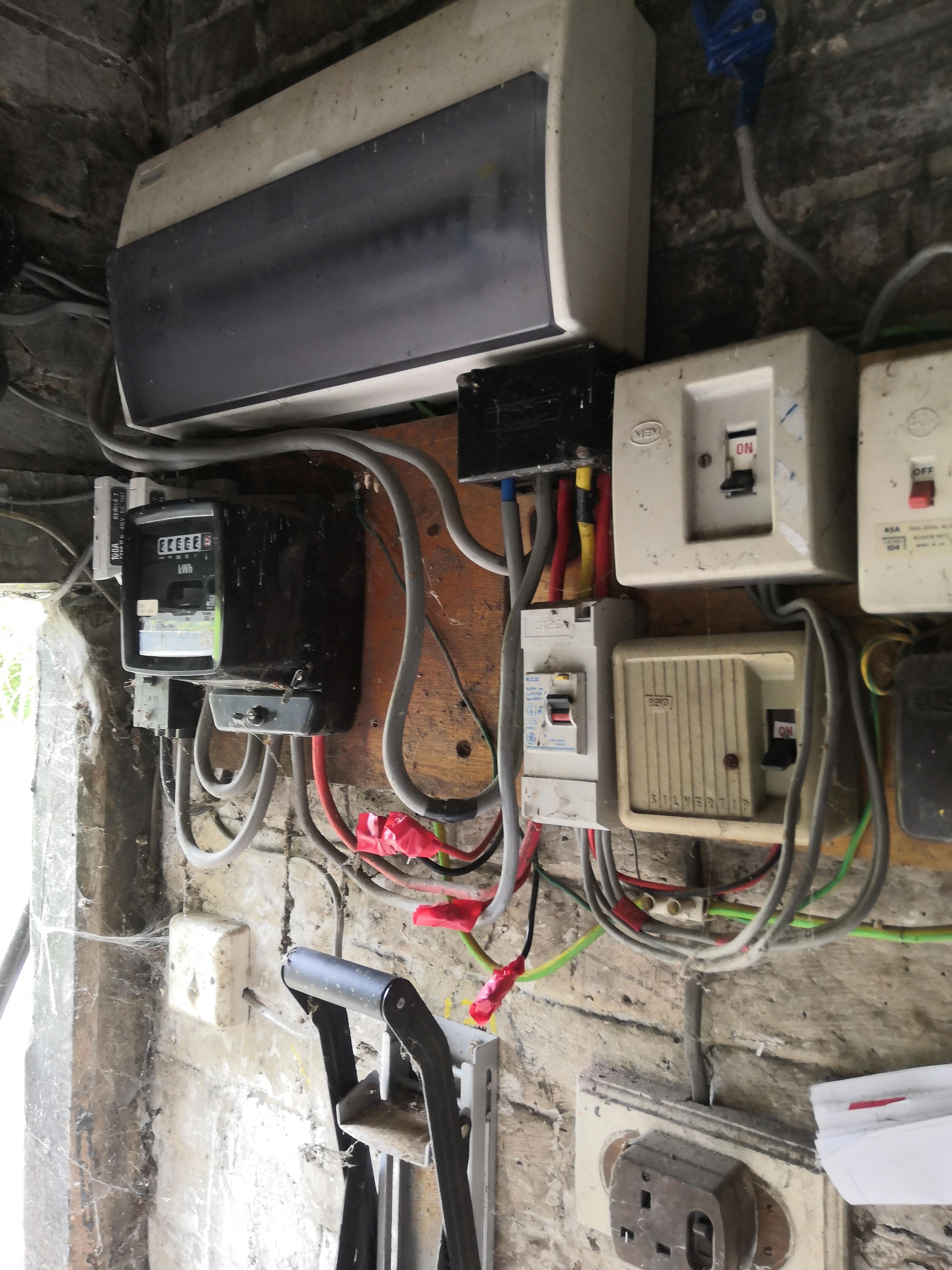

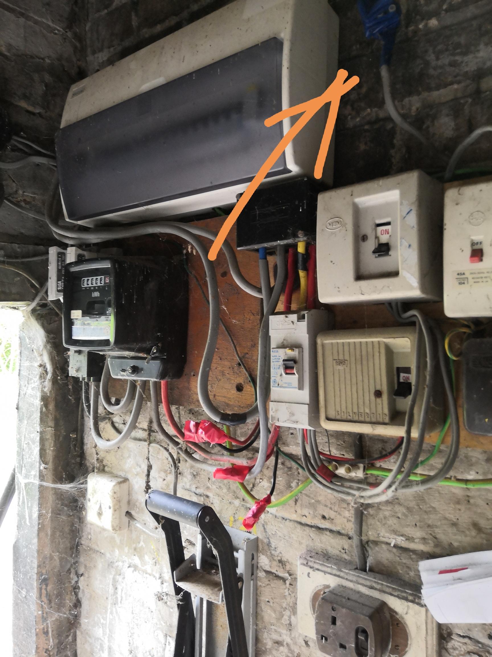

  13. I especially like the choc block connection above the consumer unit..???
  14. Yeah, I'll definitely get it tidied up. Try and get rid of what's not needed.
  15. Clearly it's not quite current regs, might do one day, all works for now though.?
  16. Yeah, definitely a mains supply though with a meter, god knows

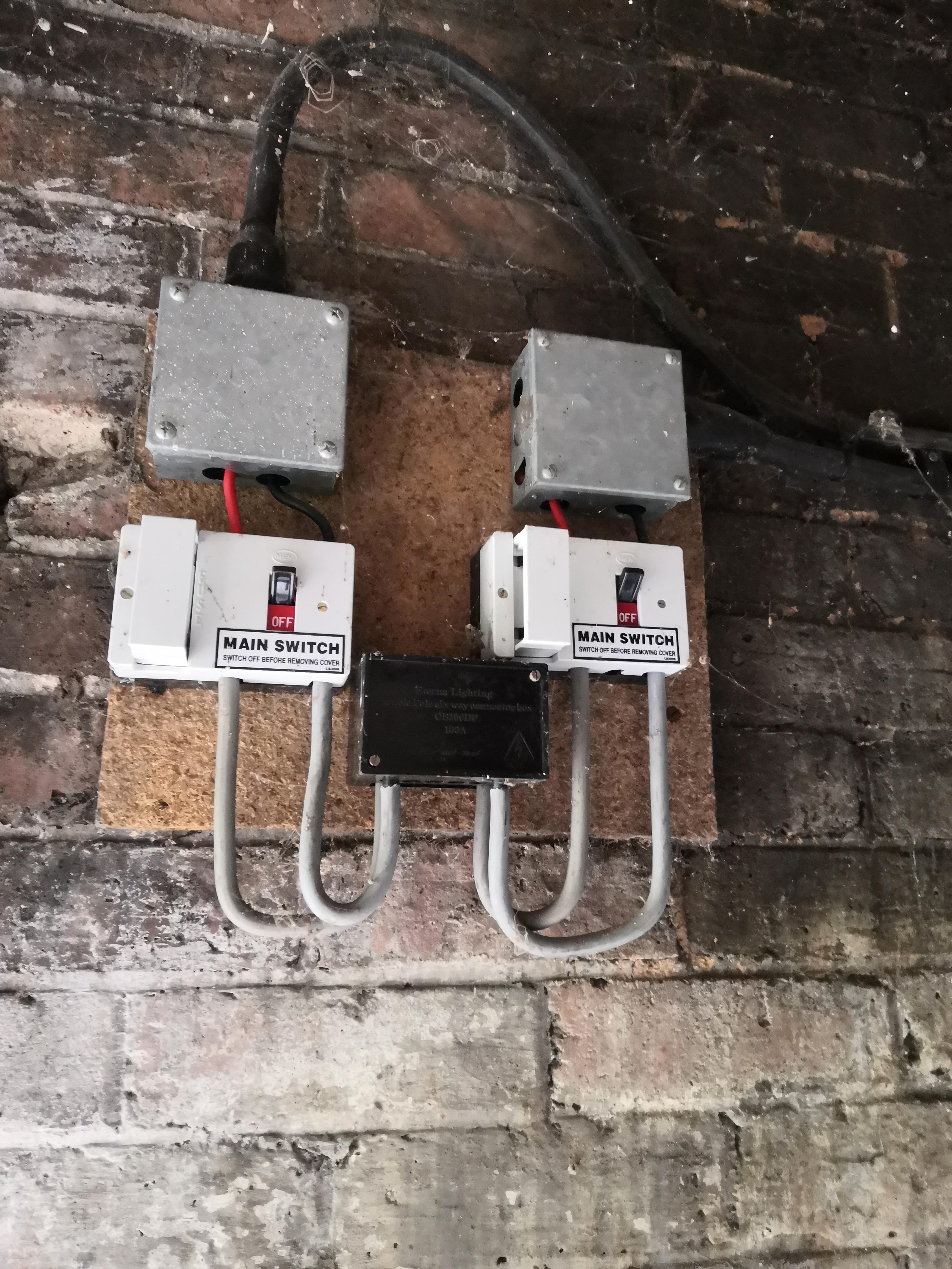

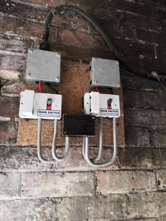

  17. You any good with electrics? Looks like a plan new terminated incoming feed, but it's not doing anything, what do you think?

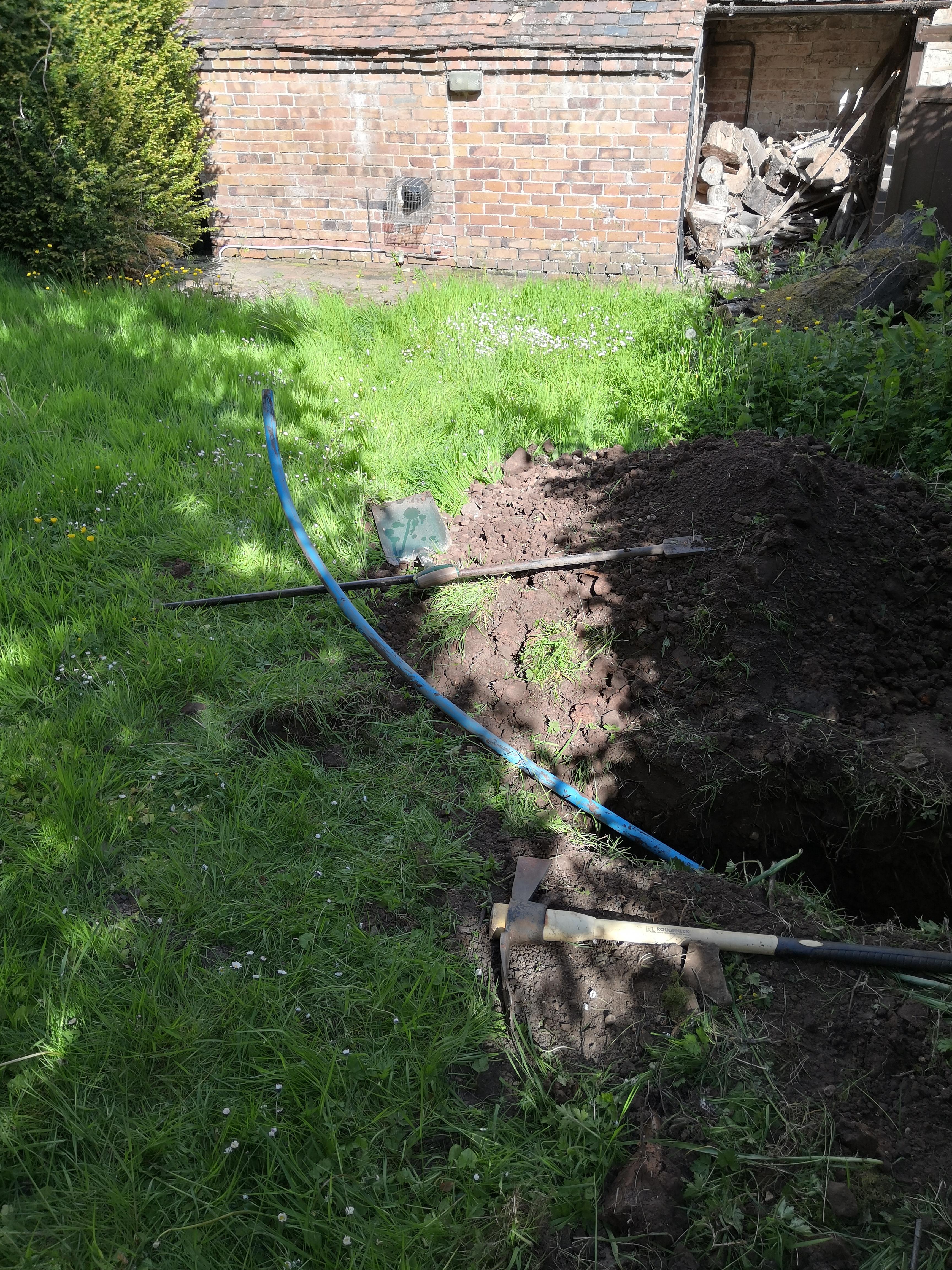

  19. Hi Peter, the pipe is in the garden, and a new supply side stoptap and meter have been fitted. So yes water is connected just turned off currently
  20. Hi Peter, the pipe is in the garden, and a new supply side stoptap and meter have been fitted. So yes water is connected just turned off currently
