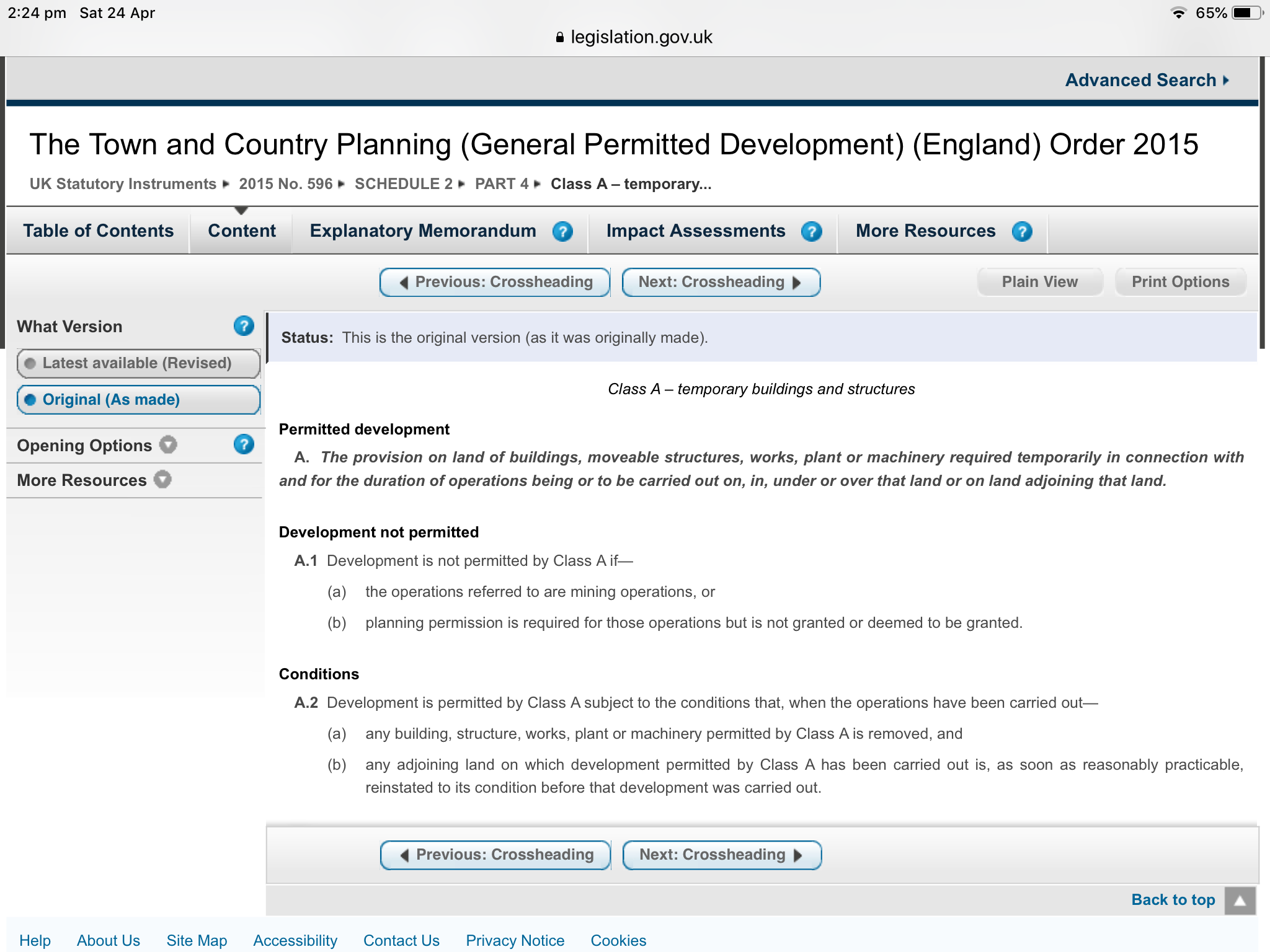

ProDave you are confusing permitted development rights which you do get when the dwelling is completed, unless of course the council have either restricted or withdrawn them and with what I am quoting - two different things.
You don’t need planning to site a mobile home. Under permitted development it allows the siting of a temporary/moveable structure that is required temporarily in connection with and for the duration of the operations being carried out. We have recently completed a barn conversion where we lived in a mobile home for 15 years on site (I told the wife it would be 3-5 years - but that’s a different story). We wrote to the council telling them of our intentions stating under what legislation, we also registered for council tax with no issues. This legislation does not vary from one authority to another (England) despite what you may have read on this post. My advice is be confident when dealing with the council, the bottom line is the law allows you to do it, the council may not like it but such is life!

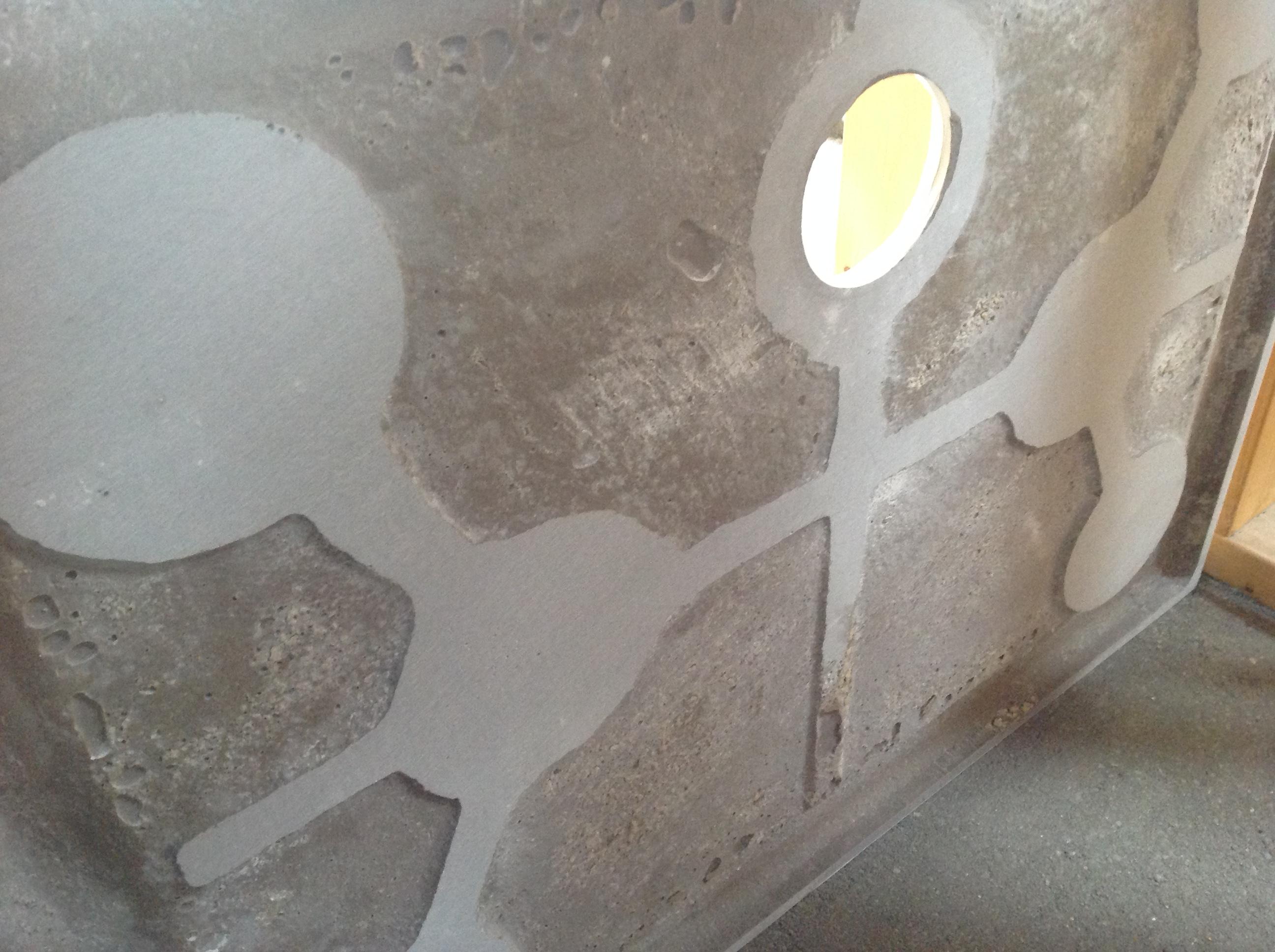

Fixing down a low profile shower tray
Miller3857 replied to Besidethewye's topic in Bathrooms, Ensuites & Wetrooms
Thanks Nick for the advice so far, am I right in assuming then that the whole of the underneath of the shower tray is bedded in adhesive not just the bits that have been machined flat. -

Looking for similar advice but onto a screeded floor. -
