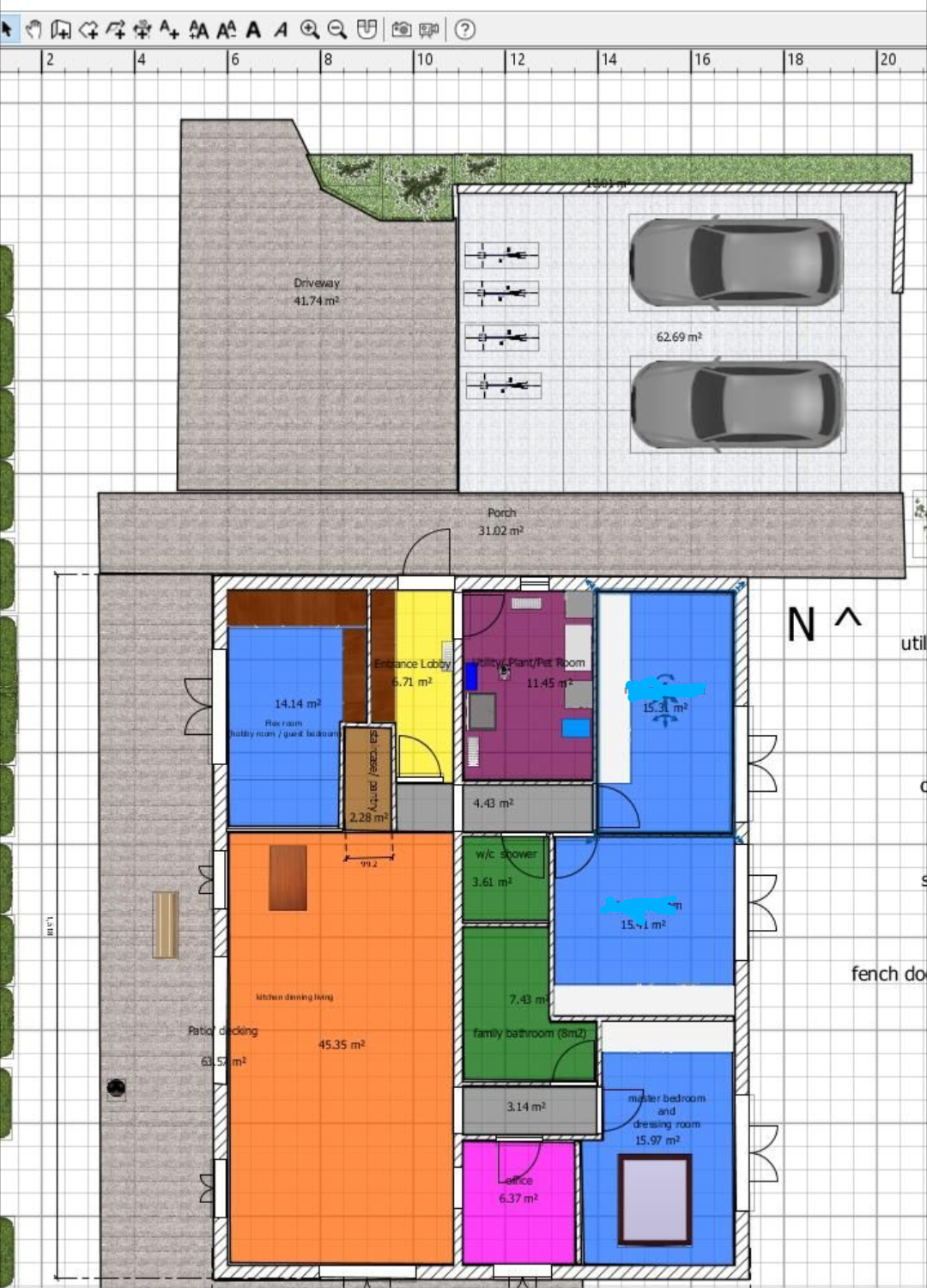

  2. A couple more pictures to the south again and west
  3. Hi Gus, Here are some views of the place. 1. Aerial view 2. View to East 3, View to North 4. View to South Light concrete blocks, external expanded polestyrene boards for insulation, a cut roof, Is the what I see on the local builds, typically a raft faoundation also. Important aspects: Costs - getting a good value living space. Making a comfortable living space that is adaptable to life as the family grows up. A cheap to run and easy to maintain house, so we can enjoy other things in life.

  8. Thanks @ETC I can read most of those spaces but i am struggling with the centre section and the 3 spaces on the right between bedrooms. Could you elaborate on them? It may well be, but life on 3 floors isn't something I would be willing to try with my money I have banished the flex room to upstairs, and given the north west end to entrance lobby. A stairs to seperate the spaces looks interesting , may need some further development. its small steps. i have looking at the danwood homes and the plans are similar to what ETC has drawn above. I am working through ideas and taking on your suggestions.

  10. Of course I don't really need the hobby room, however if I would like it to be incorporated as a multi function space including guest bedroom. I can look at utilising the upstairs space. ahh yes the classic Irishman giving directions "well, I wouldn't start here..." 3 corridors, fair cop. I consider the one by the entrance door to be a windbreak/ coats and boots space. the other 2 I would be delighted to get rid of, any suggestions? No, only 2 external doors, the opening windows show as doors in the model i used. the entrance door and a sliding door on the north end of the west wall in the dining area. I think you have nailed how we ended up here, everything else was worked on and then we found the kitchen doesn't work. It is a decent sized space in isolation, our design above suffers from the number entrances to the space and the need for a throughfare. Yes, v.29 is the 29th iteration, although many iteration have only been minor changes. In truth the guts of this design I had before going to the architect, who has reviewed the layout , but without putting forward a suggestion that made us go wow. the design is practical, but i have had a nagging for a few weeks now that it is not as good as it should be for a new build/ blank canvas. I have been looking harder at using the potential for 1.5 today. I have been self constraining to square-ish to get a decent area to perimeter ratio, I may be misguided on my use though. Our plot is big, views are of crop fields/pasture, distant neighbours, budget is of course the key. It looks like the days of €1,000m2 are over so I am braced for €1,600 - €2,000m2 all in. Highlighted in bold is exactly the reason i have shared the plan today. I appreciate the time everyone has taken to reply

  12. It's a long term ambition that's becoming reality, a self build house in the countryside. The new build house is a single storey approx 150m2 gross area, the option of using the loft as a 1.5 storey is available. The layout has been in progress for a while and in general between us and the architect it has evolved into an efficent shape, with some compromises, such as bathrooms with no windows. Presently the room has a vaulted ceiling, which should help make it feel spacious. The issue I am facing however is the open plan living/diner/kitchen. I am really struggling to make a decent kitchen in the space. What do you think buildhubbers, what could be done with the space/ floorplan to make a decent family kitchen?
  13. How time flies. Consider this a reintroduction. I am on the journey of a self build. Its a knock down and build new type of build. The site is in rural Latvia. The aim at the moment is a single storey, passive house inspired, family home in the 140m² to 180m². Lots of design work has been going on for the past 3 months with a view to breaking ground when the winter finishes in May. Attached is a floor plan of the proposed design, it is a work in progress.
