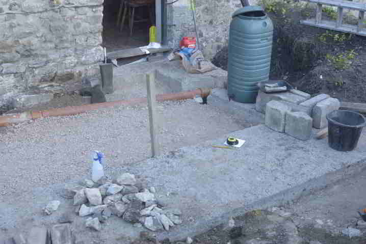

Many thanks for the additional advice and experience. I I've got some sawn planks (40 mm x 90 mm x 3600mm) that were actually used for making a ramp to get a mini digger onto the plot, which I'm thinking of using to make tamping rails. I'm planning to run the rails along the shorter sides of the slab so allowing me to tamp more than once if required. An alternative would be to run them along the longer side but I would have to fill and tamp as I go (so just the once). This orientation would make a board system for trowelling possible (shorter boards between the rails). I have a builder friend working with me who is very competent at troweling! The mix is being made by a local company and I can vary the mix to my requirements so a dryer mix would be possible if this helps to get a good surface. It has a 10mm aggregate in it, plus fibre and a retarder. I've (hopefully!) attached some pictures from today. They don't show the first block course, unfortunately as this is the next task after the hardcore/scalpings/sand layering. The back wall of the ground floor plus window and door will come out and the small kitchen/diner behind will be incorporated into one room.
Thanks for the additional explanation Nickfromwales. I've not got a huge slab to cast but I want to get it as near the desired finish as possible. The rafters idea is a good one as these should be sufficiently robust to keep their shape during the tamping process. The roof that I'm constructing will be approximately 3.25m X 4.5 meters, with Double Roman clay tiles. Not that I'm experienced in this but is a timber as big as 7"x2" needed? ..but I'm happy to buy whatever is needed to get the slab pour done!
