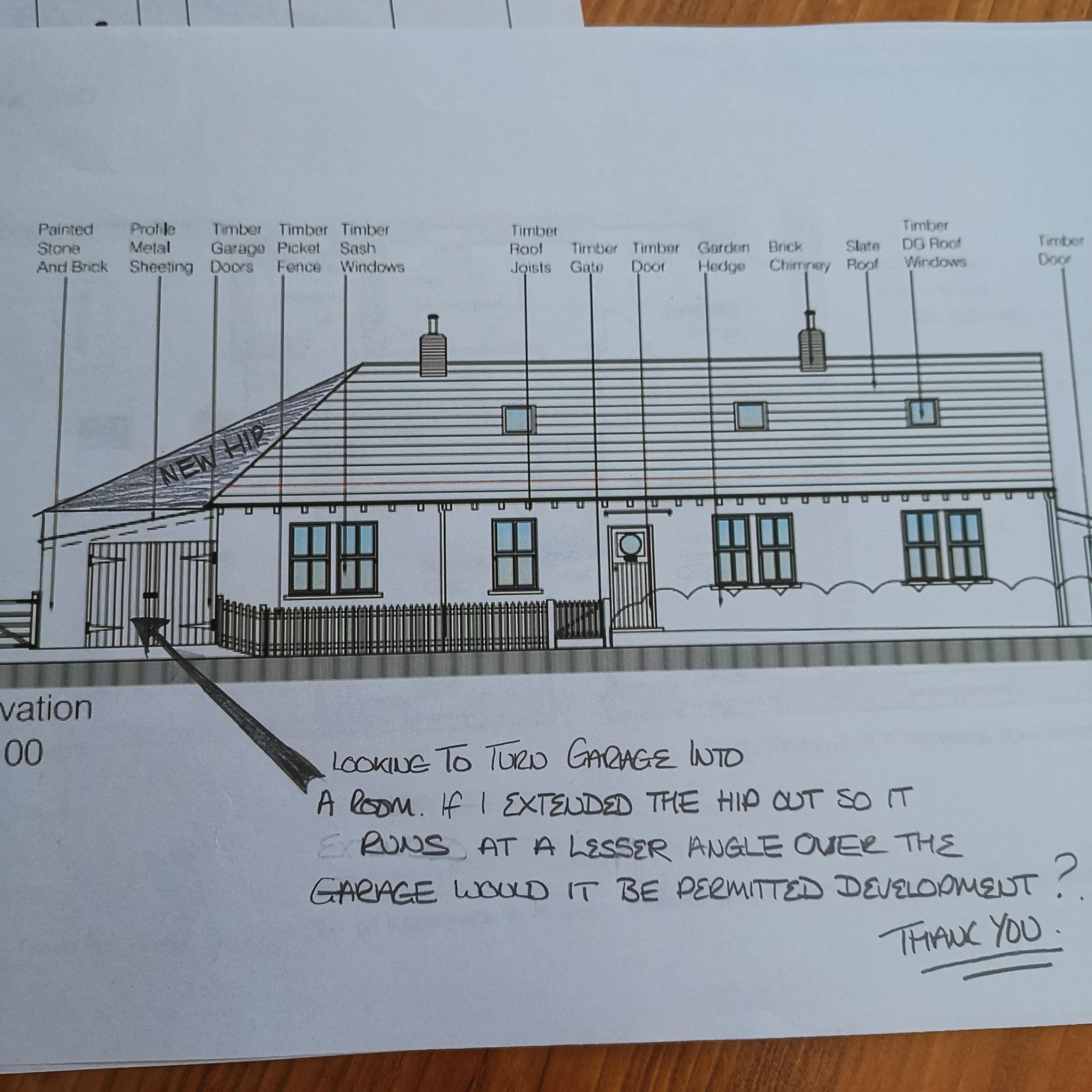

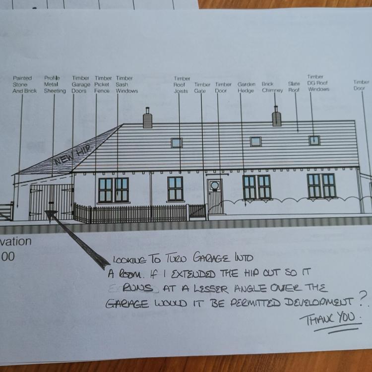

Extending a HIP roof to the side over a garage Query...
Powerjen replied to Powerjen's topic in Planning Permission
Thanks Russell, we are constrained by time and money and have found the council somewhat unhelpful so just looking at options and wondered if anyone had done similar here. -
Thanks, Peter. I know that PD info says that a roof alterations are permitted to accommodate and extension, but can't find any specific info. It would be better to do a gable aesthetically, though we are thinking about a wrap around extension on the side and back at that end so not sure how a gable would work. Unless we just did a single storey roof on the wrap around extension and didn't touch the existing HIP... -
Yes, you are absolutely right, sorry. Here is a photo which might help. I am not great at explaining things so hopefully this makes more sense! -
Anyone any ideas? Thank you! -
I am in Scotland and am looking at turning the old attached garage into a room, currently it has a tin roof with a slight slope and the main house on that end has a HIP roof. I know that PD guidelines say that alterations to a roof are allowed (the garage could be converted under PD, hopefully), but as it on the side of the house, fronting the road, does anyone know if it would be ok to extend the existing HIP under PD so that it essentially starts from the same place on the main roof, but just extends down further at a shallower slope to incorporate the garage too? Thank you
