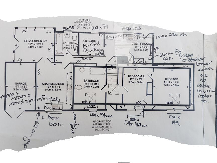

  8. Hi Ferdinand Thanks for the questions... here we go... 1) East Dumfriesshire 2) Nope, not listed or in a special area. 3) see attached - not sure if this is what you mean 4) Mm, define serious... it has been untouched for a few years. Electrics are old and need checking though consumer unit is modern, there are some plumbing issues, low pressure in a downstairs room and upstairs, roof has no membrane under slates, but joists and sarking look ok so may just leave it and repair dodgy slates. Has thin double glazed sliding sash at front and some blown units out back and some single glazed that need replacing. It really all just needs updating but other than a new boiler, nothing urgent. 5) Parents aren't getting any younger so i would say we are needing to get it done by the end of the year. It was supposed to happen through the summer. 6) Mm downstairs is all level except for a very slight slope where concrete floor meets old floorboards. Outside the house is on a slight slope right to left and the ground slopes up behind the house and to the left hand side, there is a retaining wall at the back.

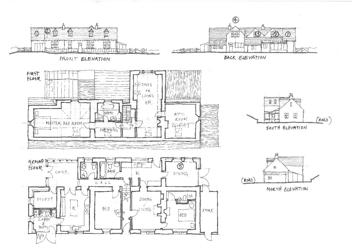

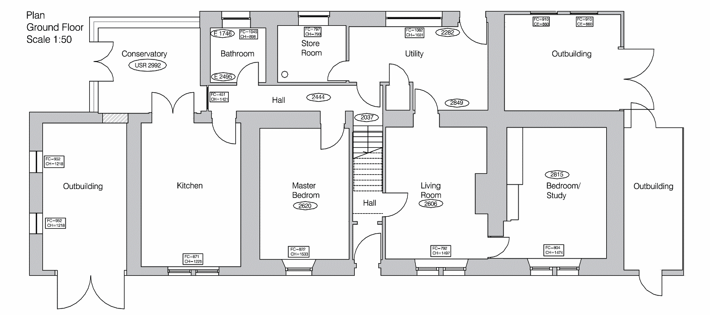

  9. @the_r_sole thank you for having a look at the plans. My parents are in their late 80s and yes we are doing it because they have to move in. You are right in that the idea is to give my parents an informally self contained area to the right side of the house downstairs and we get the rest, plus whatever we can squeeze out of upstairs. The architect wants the old Master bedroom as a second bedroom for my parents whilst I want it to be the 'Dining Room' instead - he never included it in his original idea, I have asked for it to be costed in. That way we can close the door by the stairs in the back kitchen and it will could be a self contained flat. The idea is that we could let it as a holiday rental if need be once they're not around. We would then have everything to the left of that door for ourselves. Hope that makes sense. We want to keep the original front door so if we do have it as a rental then guests can just sit in the front garden and not disturb us out back. We will then have a new front door at the other end where everyone will get diverted to. Probably should have explained it better. I would like to knock down the conservatory, currently wooden thin double glazing with plastic roof and extend out so it is flush with the current garage. We have animals so as this will be our back door we were hoping to have a boot room/shower room to decamp into first before we went into the house proper. There is the current bathroom down there but you'd still have to walk through to get to it. The conservatory is a sun trap and the best bit of the house (or could be) but we don't really want to be walking into it covered in mud when it could be a nice calm space to chill out...

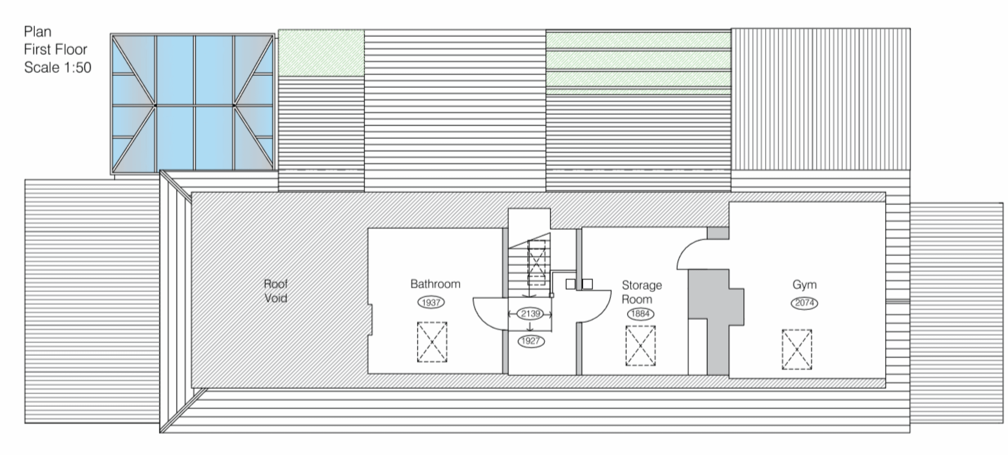

  12. @D Walter thank you. I agree, a good builder is worth their weight in gold, if you can find one. I have already tried two who I thought were up for the work but have never got back with quotes (this was with the old architect) so am talking to a local chap who was recommended to me at the moment seems like he might be someone we could work with. I have just bought a couple of building books though, so I might have to get my overalls on! I have posted on here the plans of current and proposed ideas too.

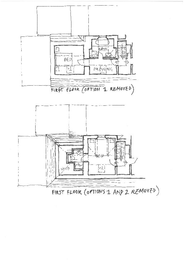

  18. Don't know why I am nervous about posting this. Have posted in the intro section about having an older 1800's cottage and need to renovate to accommodate elderly parents. Budget is tight and we need to maximise space so we don't kill each other. The house lends itself to an informal split which is why we bought it. We would like some upstairs space to get away from our parents when times are hard. Currently upstairs rooms have limited head room. An architect has done these sketches. The numbered bits are options which we have asked a QS to cost to see what we can afford to do. We have an old attached garage and workshop at either end of the house we would like to incorporate. House is in a dip so have been told it's too costly to extend out from existing footprint. Are looking at trying to keep things under PD to limit time waiting for the council. Any bright ideas gratefully received. Already got rid of one architect who wasted our time and money with a ridiculous plan 3 times over budget so not a great start. Still nervous! Thanks
