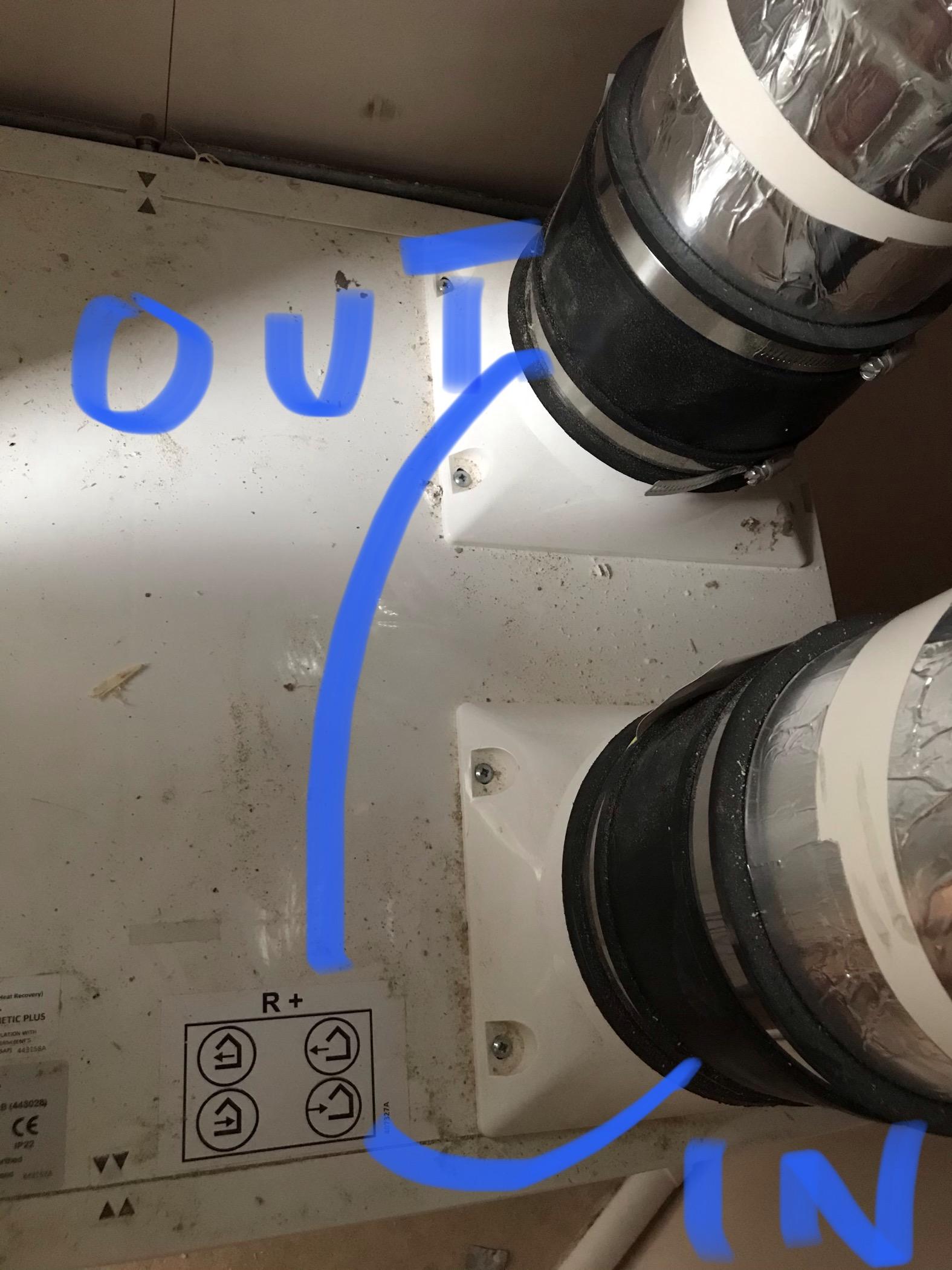

MVHR airflow reversed
OllyH replied to OllyH's topic in Mechanical Ventilation with Heat Recovery (MVHR)
Thanks for the info JFDIY. I’ll look into it and also give Vent Axia a call on Tuesday -
Yeah it’s been installed as if it were a left hand unit instead of right. Just need to swap it all over. Cheers -
Thanks for your responses. I’ll check the manual and report back. We don’t have a lot of leeway at all. The feeds to the manifolds will have to be swapped over. -
Hi everyone, My builder has installed by Vent Axia unit for me. I’ve just switched it on for the first time and noticed all the extraction vents are blowing air into the bathrooms and living area vents are drawing air in!! I’ve checked the manifolds have been connected correctly, the diagram on the unit has a logo showing air flow being removed from the house and this is the connection that has the bathroom ducting manifold. Anyone else experienced this? Thanks Olly
