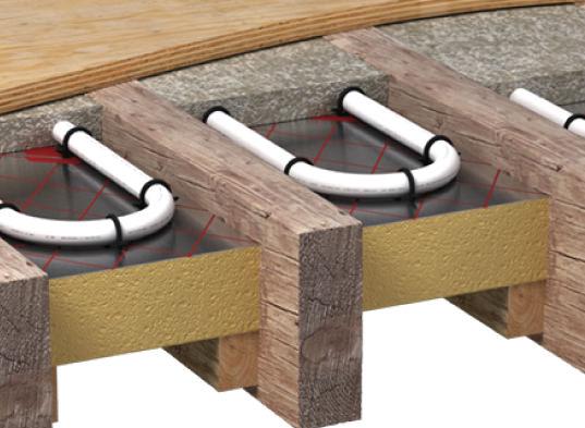

I was going to fit water fed UFH from a standard boiler, through a manifold with the pipes fitted between joists set on top of insulation in a biscuit screed mix - so far so good. I have then had that much conflicting information (loads of it) its totally put me off the idea and think of going for a double panel radiator with possibly an electric UFH mat to take the cold edge off the tiles. So frustrating.

We have a new suspended 6 x 2 joist floor and are planning to fit a water fed UFH heating system, I had set out the joists to allow for 18mm chipboard, 6mm tile backer, adhesive, tile to meet the level of the existing floor, would I be better going for a thinner ply and a thicker tile backer in order to make the UFH more effective?

I've read/heard conflicting info so I thought I'd ask the questions on here, I'm planning on fitting a wet UFH system between joists on a suspended floor so in one room only (approx 23m2): What do the pipes need to be centred at Do I need a manifold or can it be connected using a TRV Does it need to be connected directly to the boiler

I'm using 6 x 2 joists which finish about 147mm, I've had some timber machined up to 22 x 22mm to give me 25mm at the top, I'll be using 16mm pipework. I'm putting the joists in over the next few days then the insulation to follow after the building inspector has been.
Yes I was going to do a similar thing with slate lathe and some 1 x 1 timber to let the insulation sit 25mm below the top of the joist.
I'm going to be putting UFH pipework on the top of 100mm Celotex insulation between joists, joists are at 400mm centres, how many runs of pipework would I need down each joist run? Length of each run is approx 5.3m.
