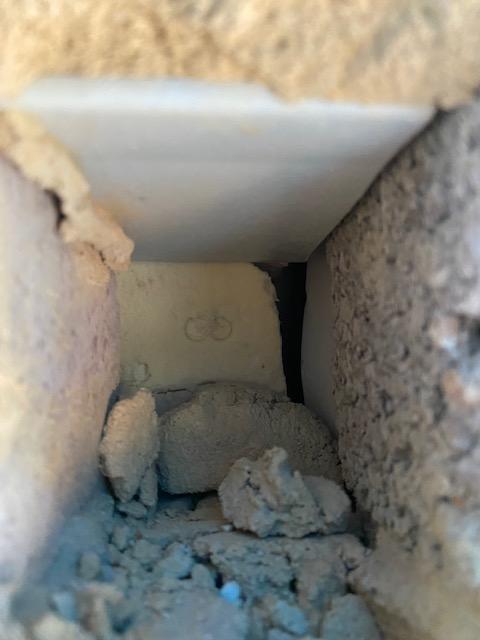

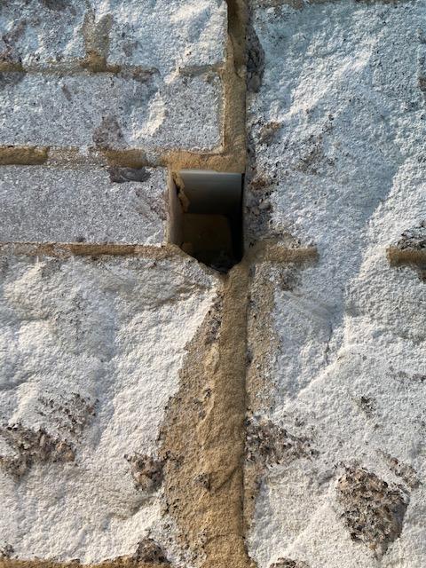

  1. Is this acceptable having a small bit of brick under the lintel and the insulation board does not fill right back to the inner blocks and has gaps.

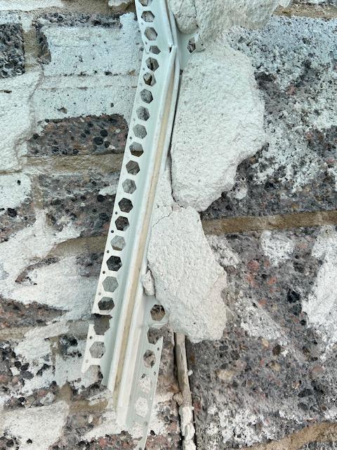

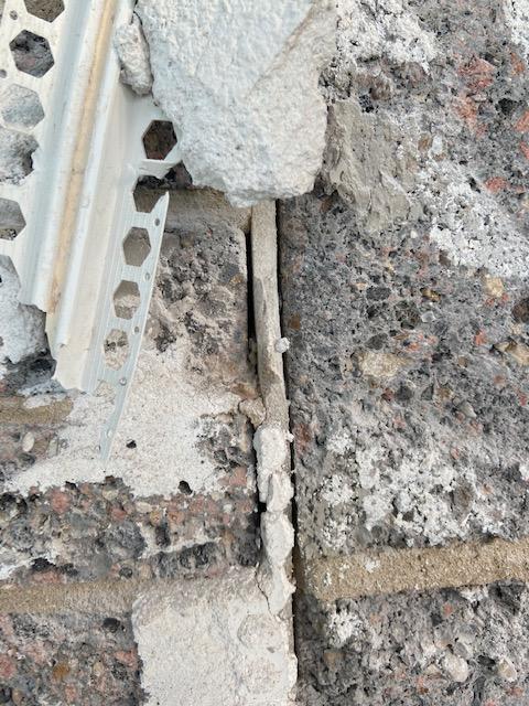

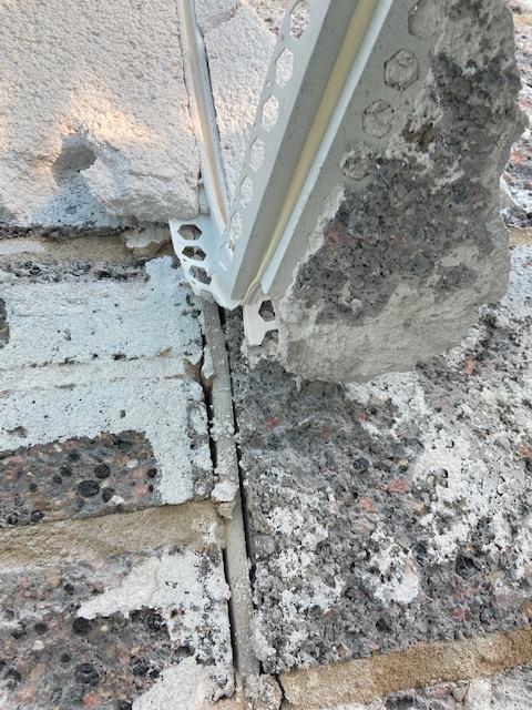

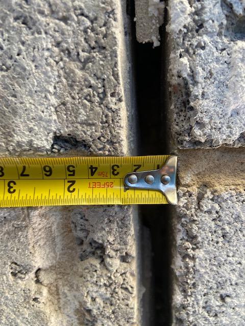

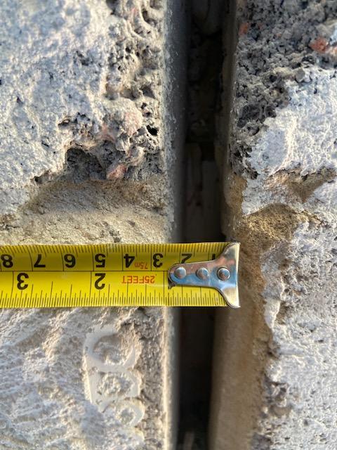

  2. There are no render beads that go in the gaps. I took a picture of the other expansion joint that is a uniform 10mm wide. The render bead sits over the foam, across the blockwork but not in the gap. What is the point of building regs if it does not matter about the size of gap? The guidelines state certain widths and never say above 16mm or to fill with mortar to make up any shortfall.

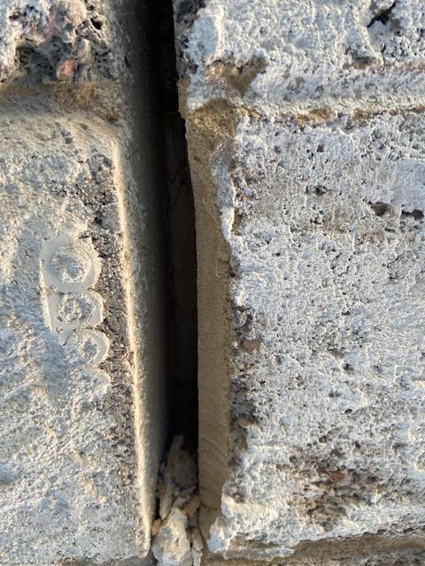

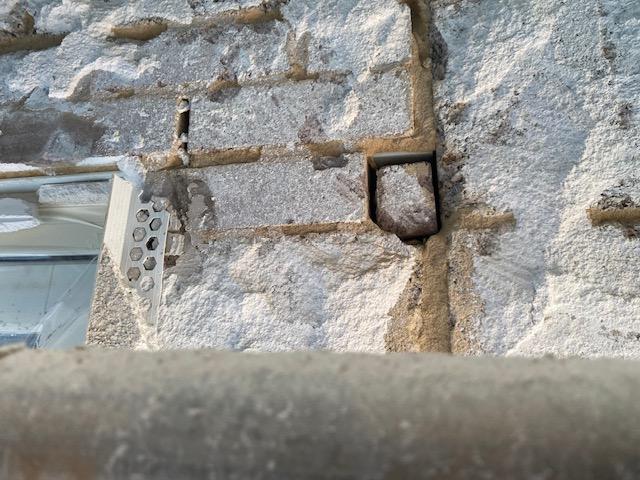

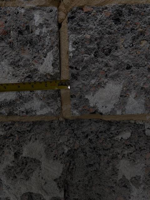

  3. Is this too wide then? It`s different widths between blocks with a thin sheet of foam held in place with mortar. When looking in the gap the end of the blocks are not straight, they are angled as though they have been cut and some packed with mortar on the ends.
  4. A quick question. How wide should the gap be between blocks for the expansion joint?

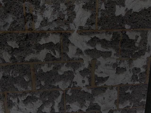

  5. Yes they are fitting the helifix bars. They have to remove a DPC which is halfway up the building as well. The cracks are still happening because of the expansion joints are incorrect. The render is being removed to see if any other issues are hidden. The render is Weber Mono that`s not suppose to be painted but the front and side of the house had been painted prior to purchase with the paint hiding hairline cracks.

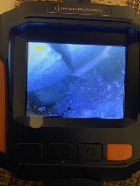

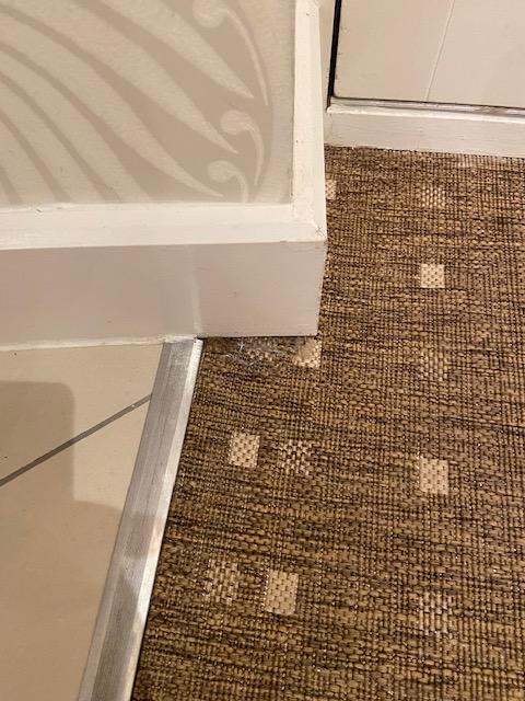

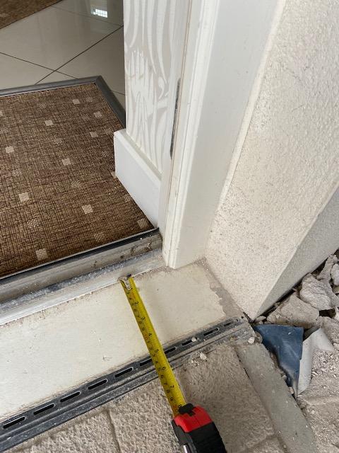

  7. It`s a picture of the inside wall I believe in the cavity. I have slugs enter the house from under the skirting board next to the door. There is a gap on both sides of the door skirting. So i slid a snake camera under the skirting gap and into the cavity. I believe insulation is not required below the DPC. here is said skirting board where the gap is. same on other side of door. You can see the slime on carpet and a picture of a big cellar slug making its way round the wall. I get a lot of small slugs and woodlice coming through. As for air tightness, I can see daylight all around the front and back doors. They are wood. Developer says this is to allow expansion because it`s wood. There is a seal around but it does not stop the light and i guess air coming through. There`s a good chance the only barrier from the cavity on all my skirtings is the mastik.

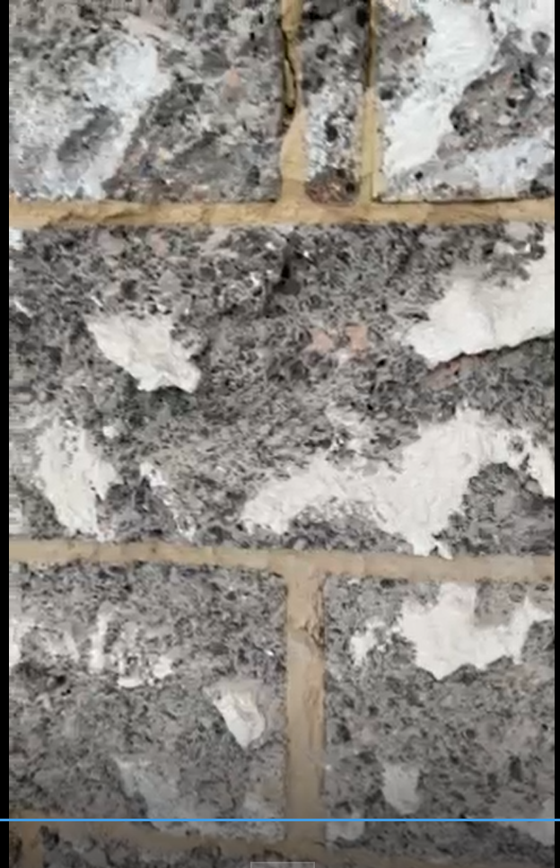

  8. They are removing all the render as I type. On the section so far I can see the mortar joints between the blockwork are all over the place. Ranging from 40mm down to 10mm. Some 20mm etc. There are part blocks in there. I`ll try to get better pictures later. Not a single piece of mesh in the removed render. I managed to get an image of the internal blocks via underneath the skirting board where there is a gap straight into the cavity. There appears to be no mortar at all between the block. What do you guys think?

  12. Finally had a copy of the structural report. Waiting on the developer to advise on what they will do and how long the work will take. What are your thoughts on whats wrong? RECOMMENDATIONS The vertical cracking which is evident in parts of the external walls has resulted from shrinkage of the blockwork in the outer leaf of the cavity walls. This requires repair using a crack stitching repair process but additional works are also required to the existing movement joints. The crack stitch repair involves the installation of bed joint reinforcement using Helibars by Helifix or similar. The repair process should be carried out by following the guide provided by Helifix ref. CS02 – Crack stitching a rendered cavity wall using Helibars, a copy of which is appended to this report. The Helibars will be 1.0m long extending 500mm from the crack on either side. These should be placed at a minimum of 450mm centres, every other bed joint. To facilitate the installation render will need to be cut out from the repair area and replaced with stainless steel eml reinforcement in the render to strengthen the repair across the old crack line. A complete re-rendering of the external walls may be considered appropriate and if implement the render should be reinforced across the old crack lines. The existing movement joint in the side wall should be extended through the recessed panel between 1st and 2nd floor window openings. I would also recommend introducing flat stainless steel ties across the joint, debonded on one side to allow movement. The vertical movement joints should also be extended through the cast-stone band at 1st floor level and at parapet level, and through the parapet-wall coping at roof level. There is a horizontal crack in the side wall at 2nd floor level and this has been caused due to a DPC in the outer blockwork leaf. This DPC needs to be removed and the wall made good. Re-rendering across the repair introducing stainless steel eml to reinforce the render across the old crack line. The other horizontal crack at 2nd floor-window-cill level in the side wall requires crack stitching as specified above but using Helibars placed vertically across the crack placed at 450mm centres. If whilst undertaking the repairs in becomes apparent that there is a horizontal DPC in this location as well then this will need to be removed. The defective cast-stone window cills should be repaired.

  21. They are a big developer. I found out the site manager while my house would have been built was busted for owning a large herbal plant farm in his house, they sacked him and upgraded the fork lift truck driver to site manager.
