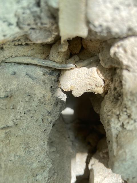

  3. Hi It looks like one. It is a piece of wire joining these two outer blocks together, if it goes all the way across to the other block.
  4. What would be the purpose of this wall tie connecting these two blocks approximately 3 foot from ground level? That`s if it goes all the way across to the next block.

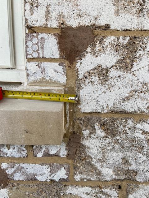

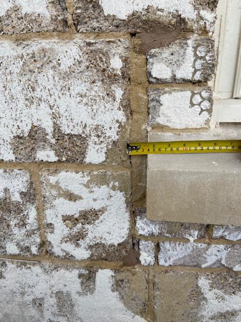

  22. These are my last images i`ll post. Shows both ends of window cill, 40mm mortar joints and a cool repair of a smashed block.

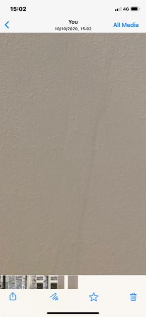

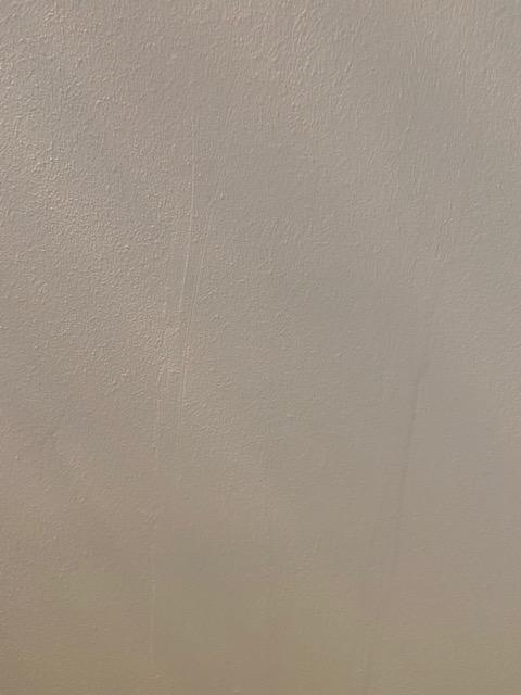

  23. This picture if you look closely has a 3 inch wide ridge running the full length of the ceiling. They never smoothed it down. I suspect it is from a leaking roof repair before I purchased.

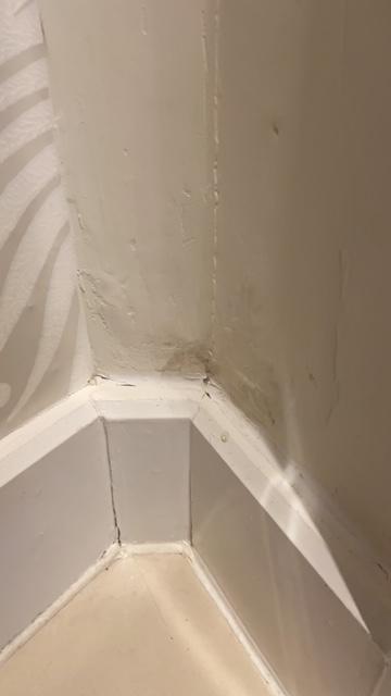

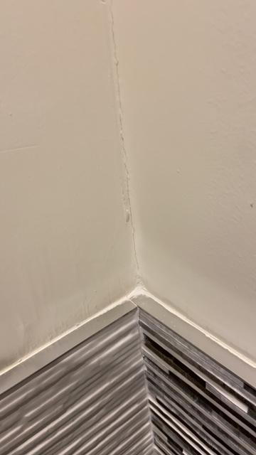

  24. Looking at the gable end it`s about to fall down anyway. It has been problem after problem since moving in. Our first day in, the roof leaked after we had been living there for 20 minutes. Second day, boiler leaked and broke down. No heat for over a week. But... they`re sorry for the inconvenience. I`ll have to stop posting pictures as there are just too many issues. lots of rooms the plaster boards and ceilings are cracking because of the vibration from render removal.
  25. Could this be the start of damp? ;Plus look at the quality finish. Was hidden by an umbrella stand when viewing.
