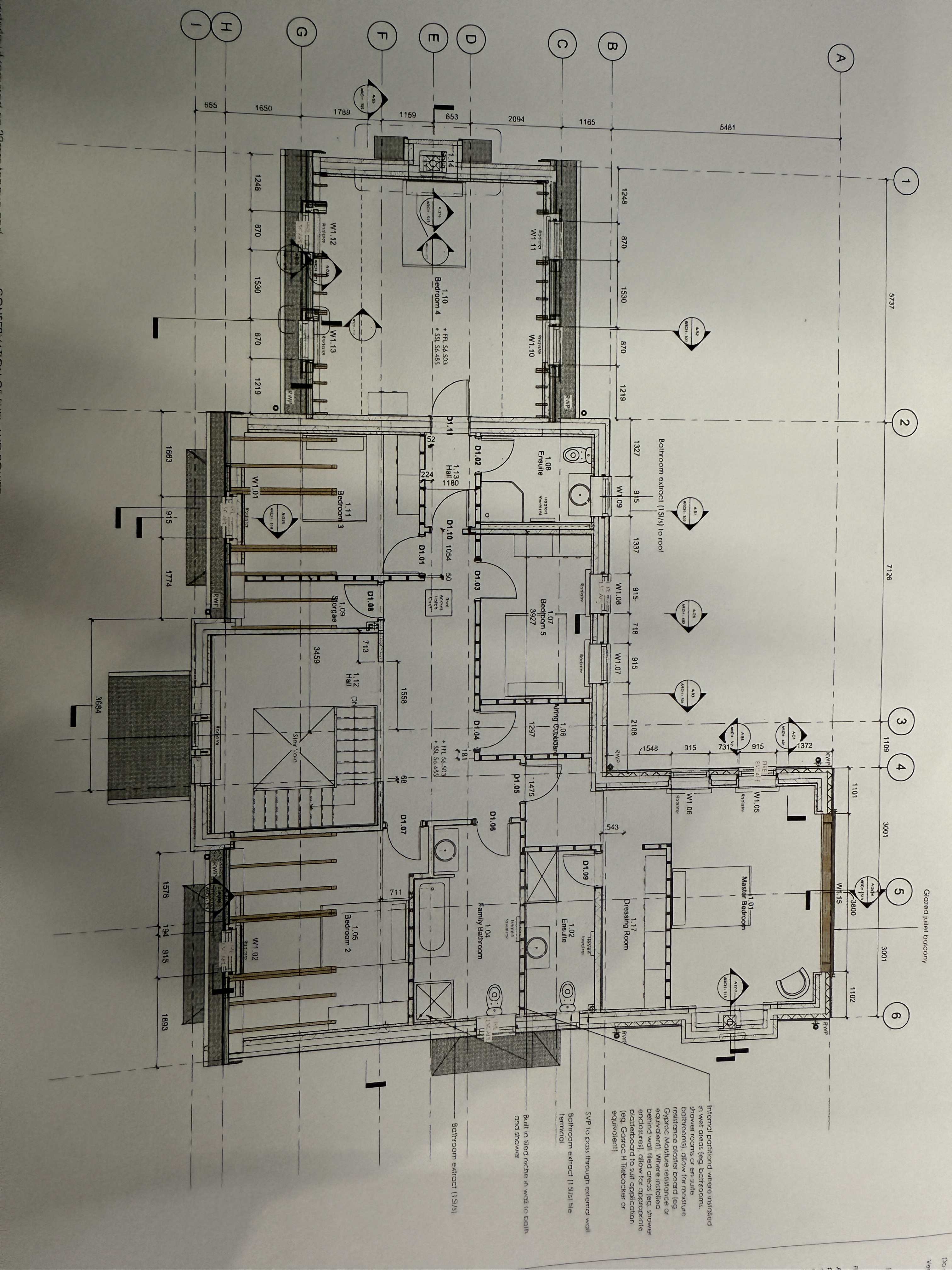

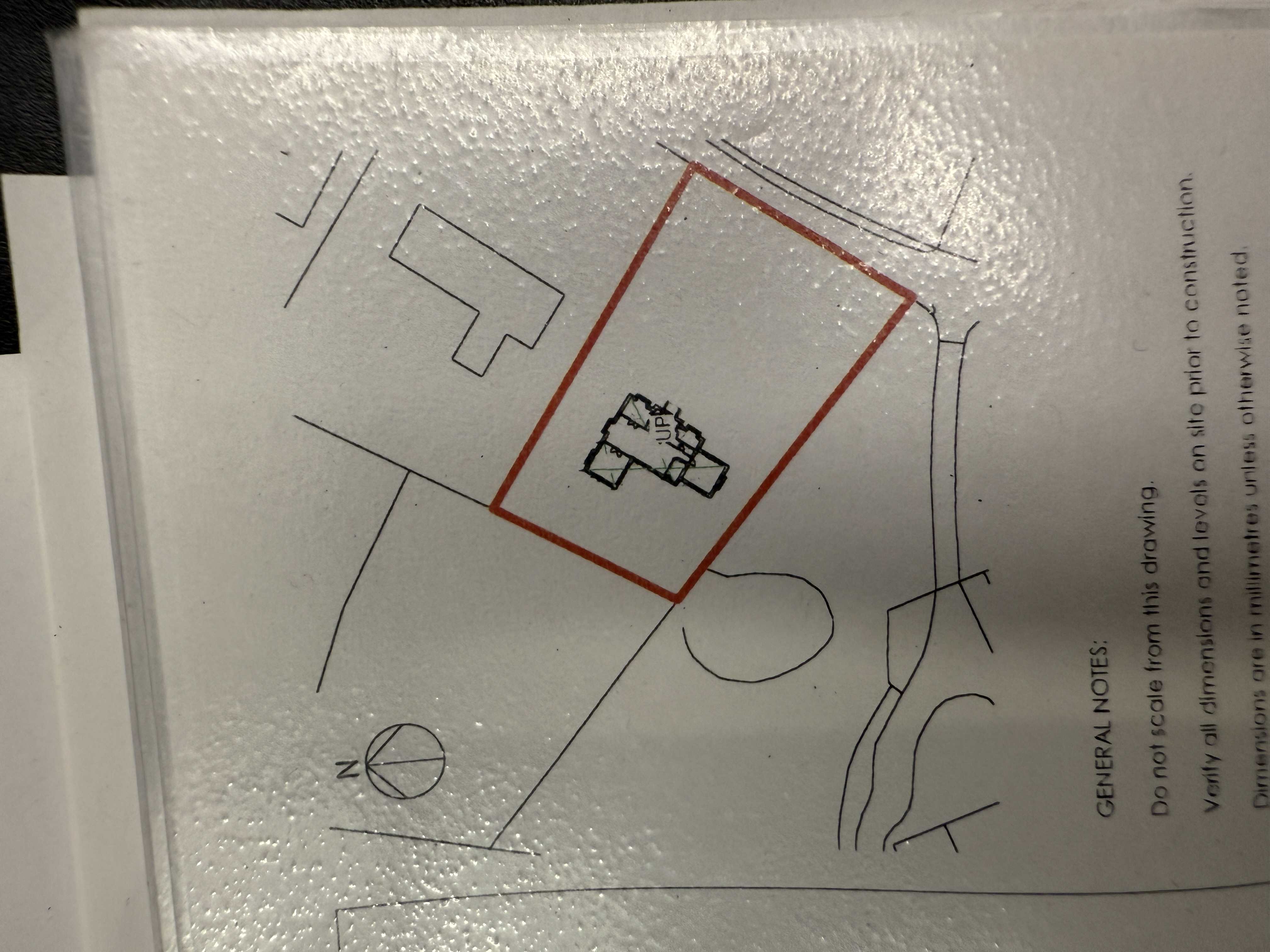

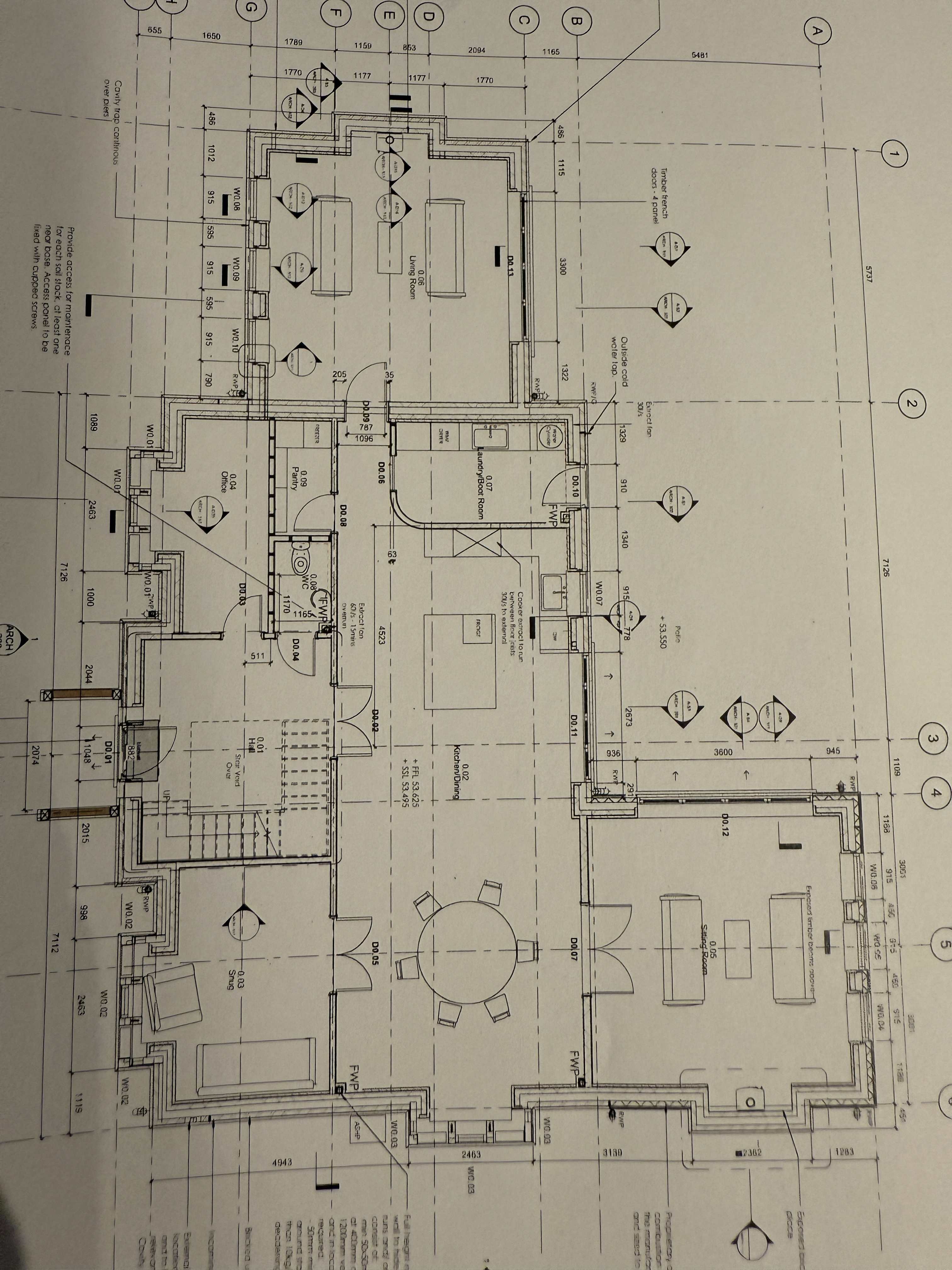

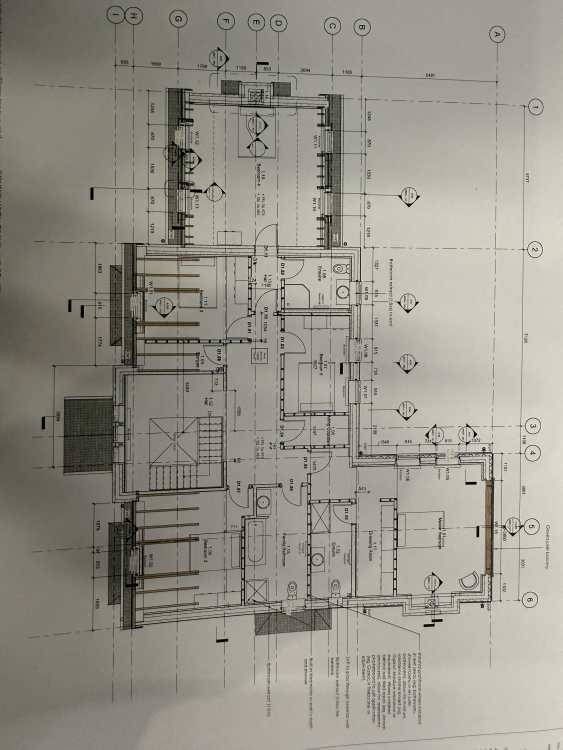

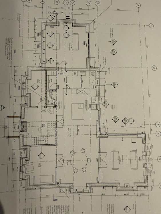

Member (3/5)

  2. What does SAAs, HAAs and CO stand for? I guess EEW means emergency egress windows? Sorry, I’m not aware of all the acronyms! The drawings have already been reviewed by building control, they had a couple of comments which I have addressed. What do you mean by the bay windows being weird structurally? The drawings are done in Revit (self taught), so they are a bit weird looking on the drawing.
  3. Thanks for the suggestions, I was actually thinking of making the other living area a gym or future annexe. I think I’m going to put a stub stack for drainage in there, for future flexibility. Thanks again
  4. Thanks this is amazing! I like the kitchen arrangement, it looks a lot more practical. And yes those are the construction drawings I have put together.
  5. I don’t really have enough money to finish it, so any easy savings I am looking to take. I could reduce the size but it’s on a big plot, so seems a shame.
  6. In reality I think one of the living rooms will be a gym. Ok thanks, I was more worried with over heating but also got plenty of insulation. Thanks for the feedback
  7. Nothing wrong, just if anyone spotted any improvements. I think the kitchen counter space is a bit lacking, so I could make the bi-fold doors smaller.
