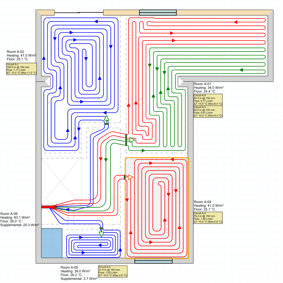

UFH Design - LoopCAD, Heatpunk,Spreadsheets & Copilot
Adrock replied to Adrock's topic in Underfloor Heating
A small update. I'm onto connecting this underfloor heating install onto my existing boiler but with a view to an ASHP in the future, once the rest of the house is sufficiently thermally performant. I've done some watching of videos and very dodgy calculations, it appears 28mm copper or 32mm MLCP for the flow and return. This will pipework will also likely end up feeding the manifold for the ground floor, eventually. Any thoughts? Have I asked in the right part of the forum? -
