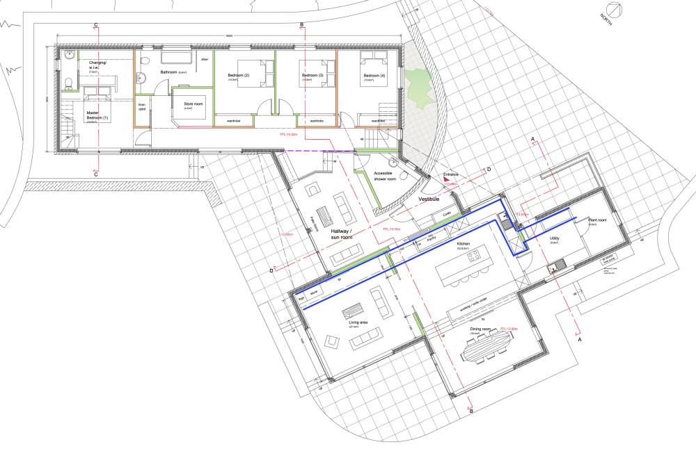

Because i wouldnt get pipes up my ducts @JohnMo i havnt thought about how ill seal it but id imagine a bit of armaflex and sealant will hold a few psi. -

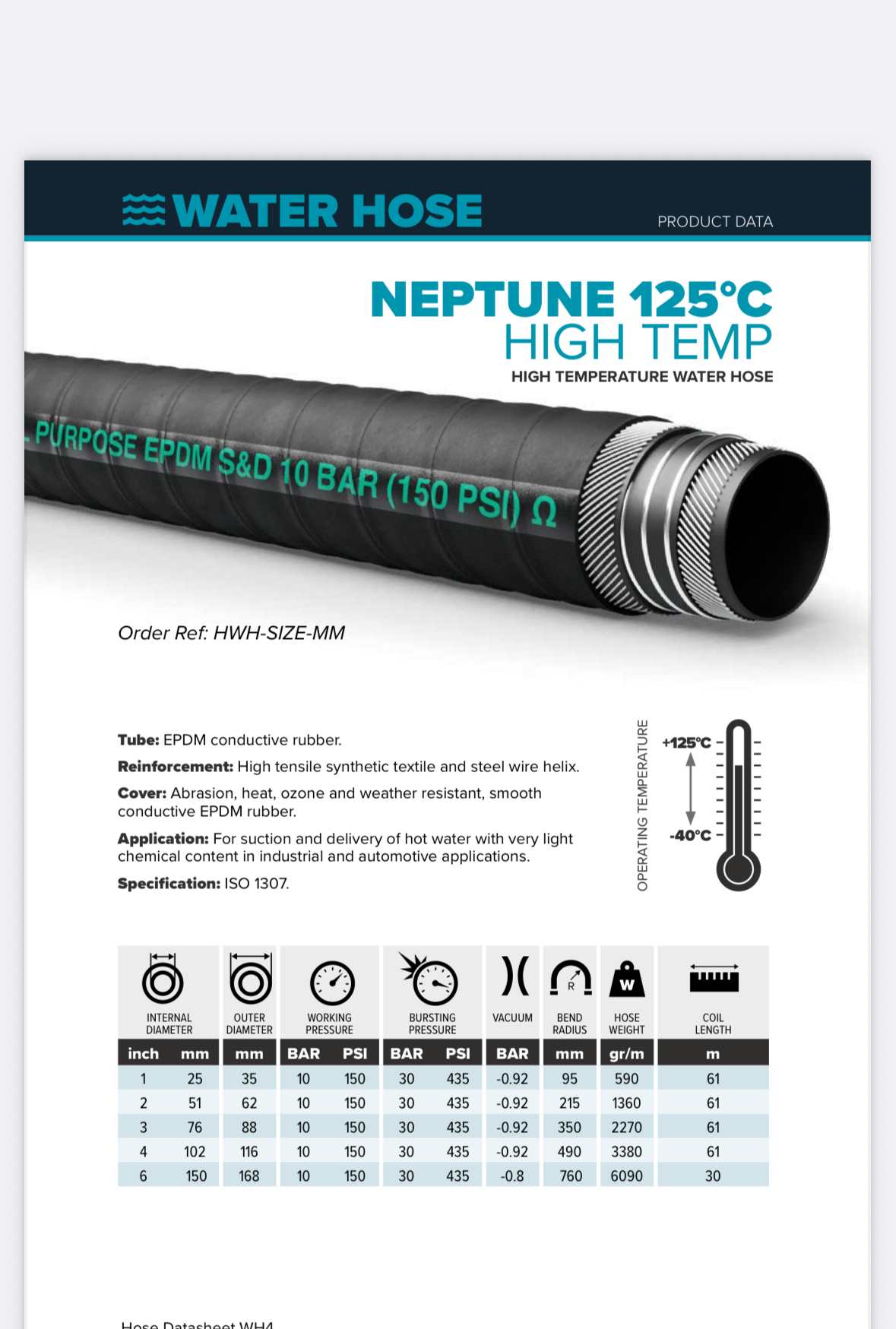

Thanks for that @Nick Laslett thats just the info ive been searching for. looks very similar in spec to this stuff which i could get by the meter and get hose tails for, ill search some more to make sure theres no max guideline for hoses but i cant see why there would be. Im not planning on going crazy just 1.5 - 1.8 meters maybe. -

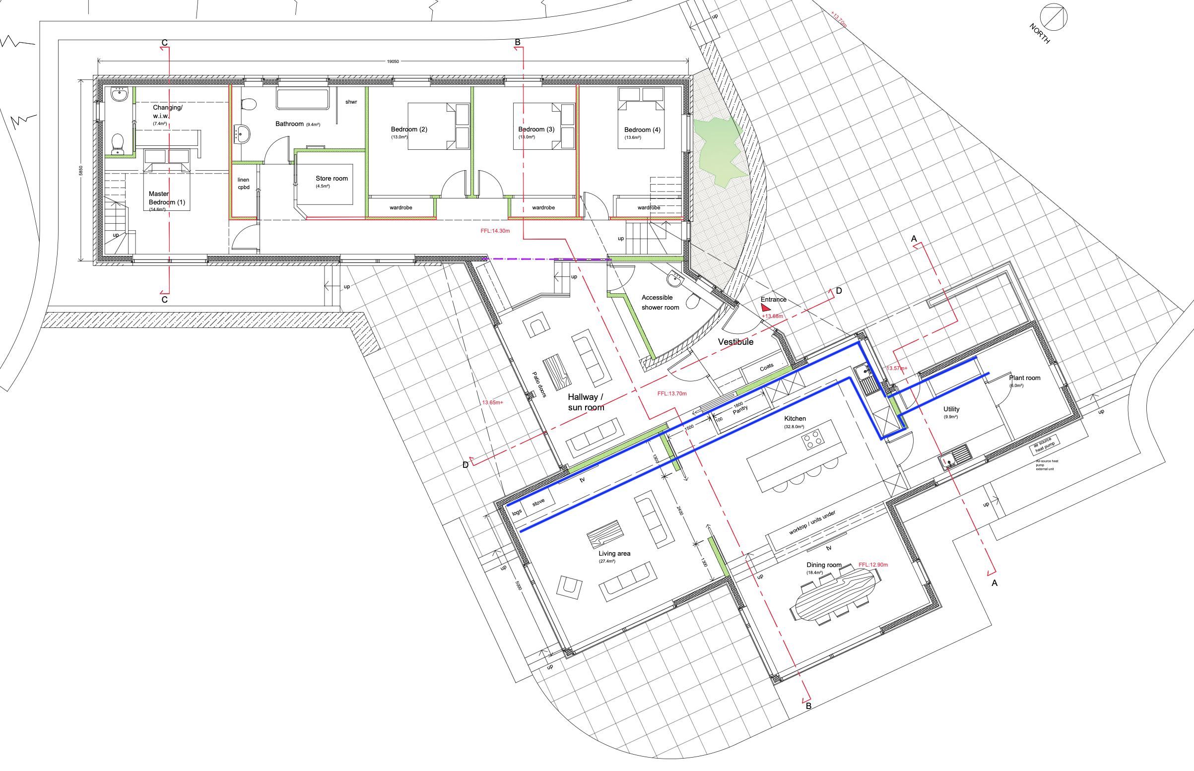

Well if i can get long ones i wont need multiples. I need flexis off the unit then also flexis up my ducts. if i can be confident in the spec i dont see any reason not to run hose from the unit to inside the house, potentially less heat loss, less joins, less turbulence? I dont see any negatives. -
Does anyone know the specifications of the flexible hoses used on ASHP. is it just 10 bar epdm lined hot water hose with a stainless braid? Basically im looking for longer hoses so i dont have to go from flexi to pipe to flexi to pipe and in doing so reduce fittings and connections.

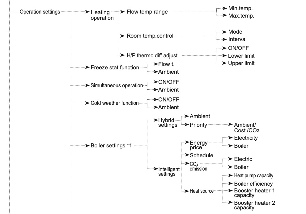

there's no grants available for new builds now so the basically mandatory ASHP for planning up our way stings even more. ill keep searching the internet for ecodan info, Mitsubishi offer basic information to everyone but hopefully more detailed info to agents and installers. the emergency mode seems to overcome the ASHP availability issue, it overrides the comms to the ASHP and assumes its unavailable, this is where I expect ill need to physically try it or get a meter on a similar unit. -

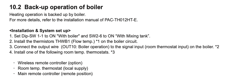

JohnMo thanks. ive no experience of ASHP so I dont know where a secondary becomes a hybrid or a hybrid becomes a backup. I've read a lot on ecodan ftc6 and ftc7 in the last couple of days and it references hybrid in the context of adding and controlling a second heat source - both boilers and electrical heaters. from what ive read the ecodan when combined with the ecodan pre plumbed cylinder can be used in a hybrid mode where it controls a boiler if selected as priority, not sure quite how but it looks simple on the drawings, and also if hybrid mode is selected and it knows there is a boiler connected you can go into an emergency mode where the ASHP isn't available or comms are lost or for instance a power loss and it uses the boiler for heat - provided there is enough power for all of that. as far as I can see everything else works as if the heat pump is there, primary pump, controls, everything. this has encouraged me a bit now, be nice to see it done in practice or talk to someone who has done it with an ecodan but it all seems to be possible. incase anyone else comes looking for the same - Hybrid P-P, 2x HTG Zones.pdf -

that's also interesting, it looks like ecodan FTC6 and FTC7 controllers on a pre plumbed tank already have boiler hybrid function built in, ill do a bit more research but looks like the header even has blanked connections ready for it. -

That is very interesting, so I could just run the ASHP through a PHE, probably on the flow side and put the boiler on the other side of the PHE presumably with a small volumiser on the boiler circuit. im just surmising here but as you say if the ASHP sees adequate return temp it won't be required but the other controls would work as if the boiler wasn't there. I wouldn't expect a fair sized PHE would add much restriction to the flow. thanks for the info, ill have a bit of a look into that -

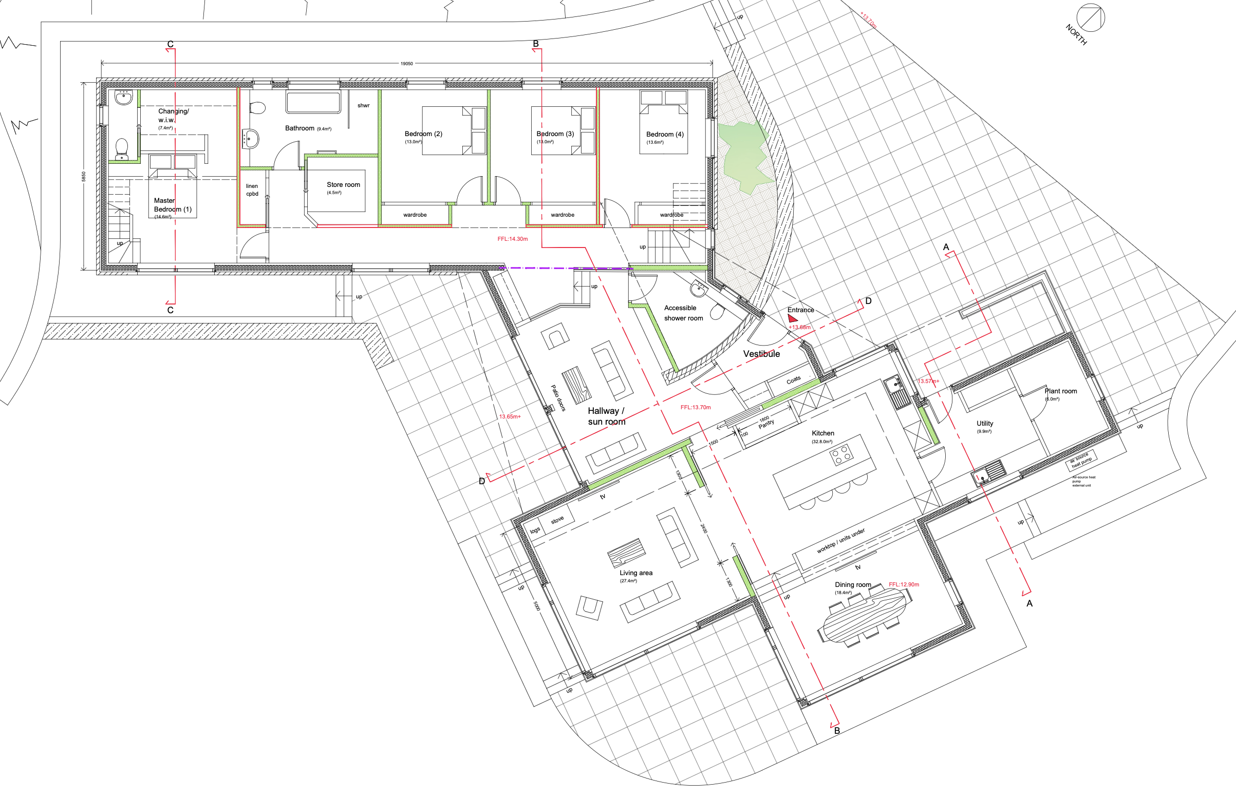

we will be fitting an Ecodan ASHP in our new build, probably a 8.5kw maybe a 6kw, the calcs and things have not been finally done yet, we will be using a Mitsubishi as they are the best supported up here and seem to be the preferred choice, its also the type the company we will be using supply and repair. I have a few questions for anyone with experience or have maybe been down this route before. while reading on line about them I see the Ecodans have some sort of hybrid function built in for integrating with existing oil or gas boilers, anyone know how this is done? I can't see any info on this. secondly, if I were to opt for a 250 / 300 litre ecodan solar cylinder which has a secondary coil fitted, is there anything stopping me from running an oil boiler through this coil? as far as I can gather this would only give me DHW heating as since the ecodan pre plumbed tanks use a heat exchanger for the DHW there would be no way to use this coil for the UFH side of things. thirdly! if I were to use a buffer tank inline with the ASHP, im imagining only on the return side? and I then connect the boiler to the buffer tank to heat the primary water will the ASHP and UFH system just run as normal but just not have to heat the water or would it get all confused, ie the house is calling for heat so the pumps would run but the ASHP wouldn't have to heat the water being returned to it as it would already be preheated by the boiler. my ideal solution in my mind is a 100liter buffer tank with an indirect coil, with 1 1/4 fittings and I just run the boiler through the coil and the ASHP on the other section and the two systems are separated, but I can't see anything like that online, the closest seems to be just a standard indirect unvented cylinder but these have 28mm on the coil and then 22mm on the HW side?? any experience or insights appreciated.

thanks for the replies, there is no fire rated partitions or protected areas, I have not actually had any questions from BC on this im just trying to figure out if it is going to be something that is questioned as I can see that it might be something they could query as they are very focused on fire spread etc. they have insisted on me putting an LD1 fire alarm system in so this may help. the building has 2 sections, 1 single storey and one storey and a half, this section is single storey, the floor plan for the ground floor is attached. and I've marked up in blue where the service access void is -

newbuild upnorth replied to newbuild upnorth's topic in General Construction Issues
Eric, thanks for that, I would tend to think of it as the same. I probably will plasterboard it if I have offcuts and I can get them in there after first fix. do you or anyone else see that there might be a need to partition between the rooms or apartments as BC refers to them, there is no fireproof walls or doors etc, I can just see it as a means for fire to spread through, although again no more so than an attic or coombed ceiling void. id rather not contact them if I can use common sense and others experience if im honest!
