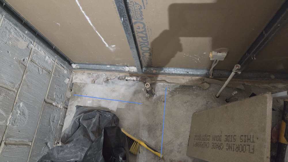

Update on this post @Nickfromwales, I think I am going to put the valve into the thermalite wall. 1. It means my arm wont get wet 2. Wont be worrying about the 50mm stud conundrum and that being tight as a ducks butt, I've had the Abacus Mounting plate come in and that is going to take 10/15 mm. I've decided to got a pipe bender to run the 15mm down and up from the original water feeds in the loft. Pic has where I plan to run up pipe work. I've got a 3 way crossbox backing valve and two way front plate, One thing im thinking about is running the 3rd outlet under the bath and blanking it off, it provides future owners with the option to change the front valve plate to three way and use the bath filler. Is that just me being OTT? I know you mentioned you've used a Multi before, was that with a carbide tipped blade?

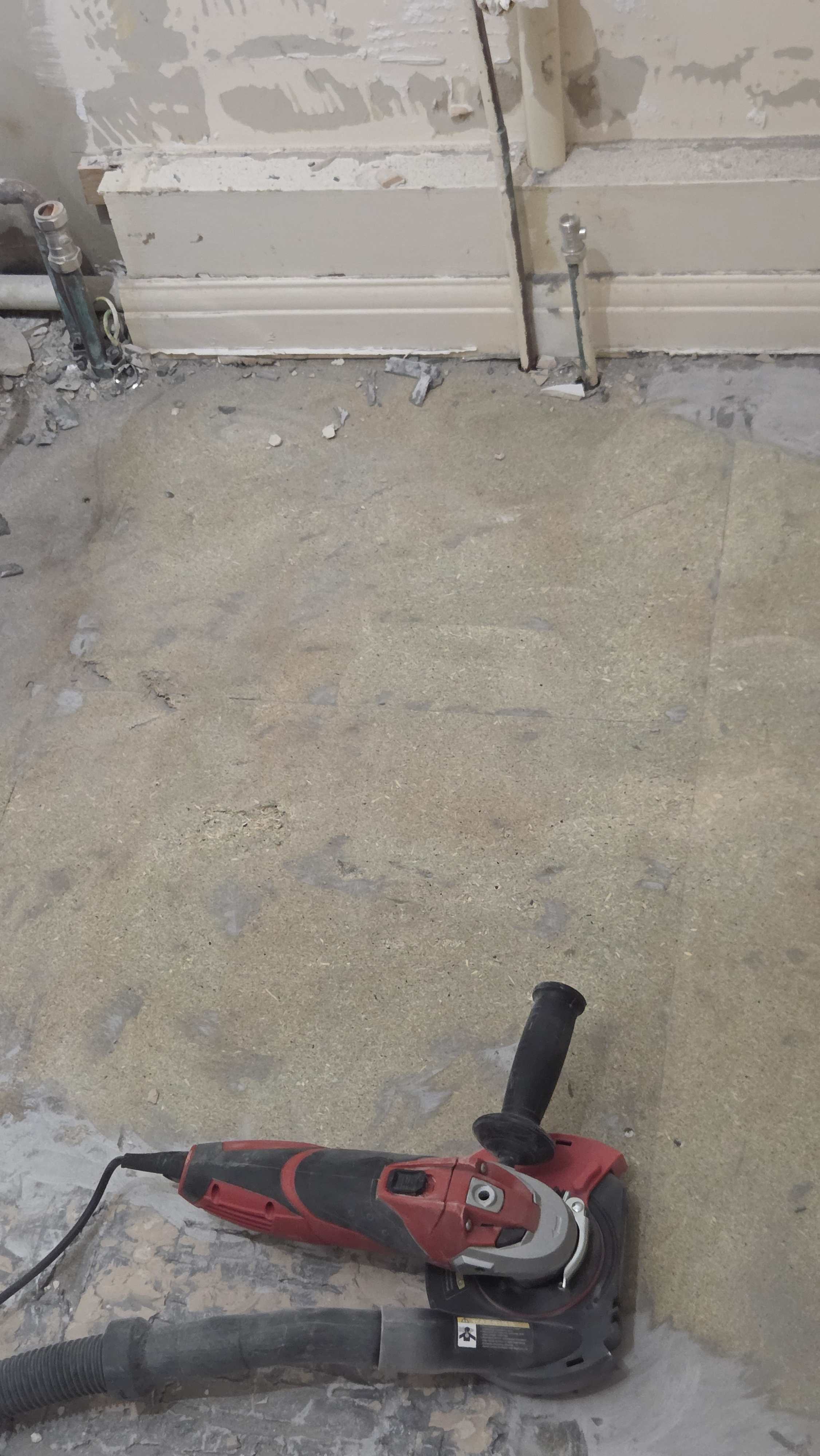

Previous late 90's house has had 40MM pipe running along in boxing that I'd quite like to remove in my bathroom refit if it's feasible and do a wall hung basin. Existing mains feed spurs off existing 22mm pipe directly up through the floorboards, I planned on spurring off this 22mm direct into the Stud wall. Waste outlet hole is 40mm to the soil stack. I plan on extending enough 40mm for the bath drainage and then for the sink basin I thought I'd be able to go 32mm from sink to 40mm and run this through the stud but reviewing a few posts it doesn't sound possible to put the pipe through Metal stud (Needing to drill for holes) and also will mean sound issues? (It will be 20/30mm Tileback to front. The fall is another challenge, the wall width is approximately 1500mm. Am I right/wrong on this and does anyone have advice on this ? Boxing would be possible but clutter this room big time so I'd really like to avoid this if I can sensibly and easily.

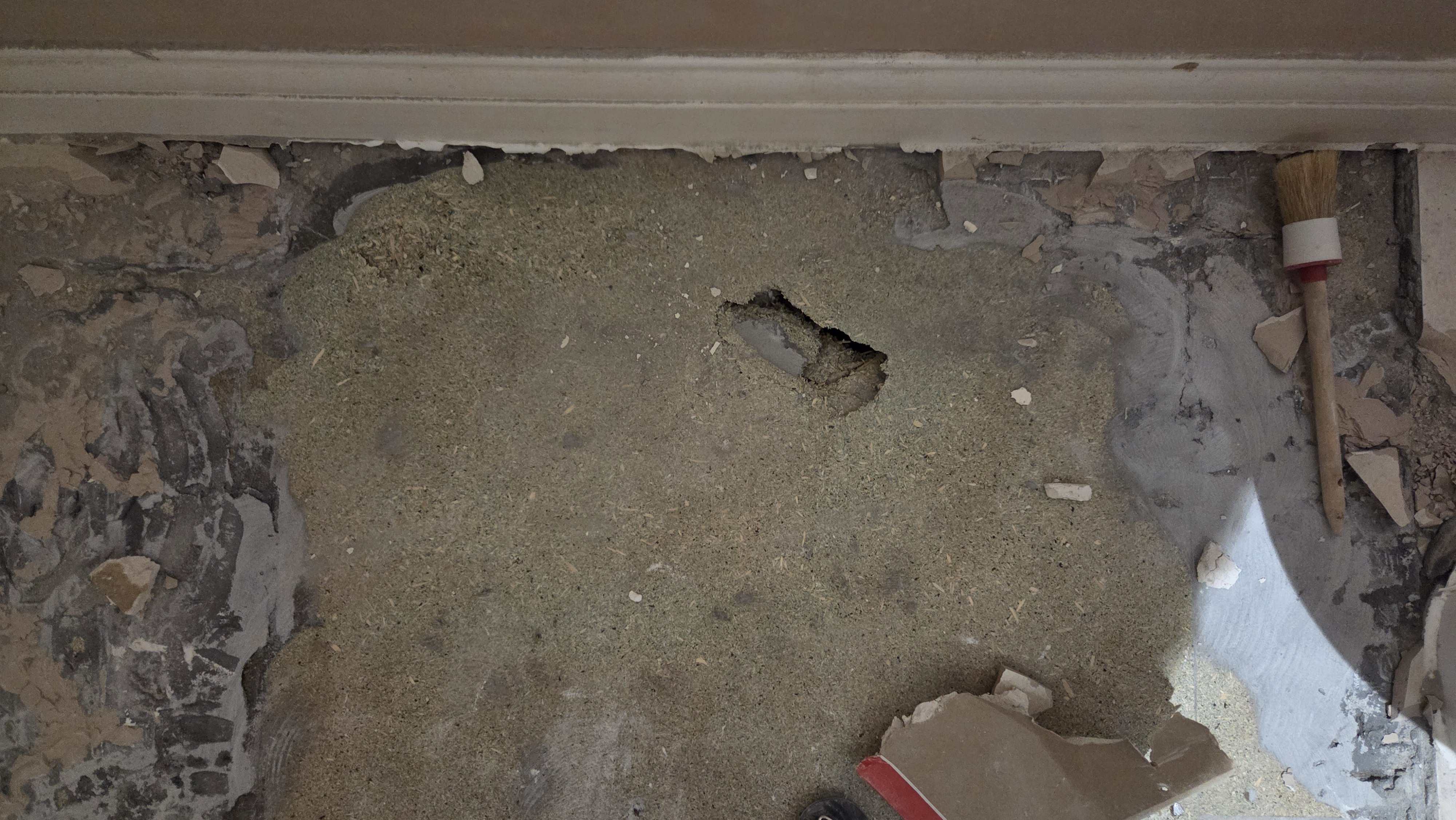

Going to be skimming and adding downlights. I have an extractor behind where I've taken this picture with ducting already. The block wall is an outside wall, it's breeze then London brick.
Hi, I have taken down Plasterboard to prepare for a concealed shower. I have metal stud that is 50MM The current wall is PB on the adjacent room already screwed into the Metal stud. My depth is 50MM, a concealed valve will need about 75MM to comfortably have a patress/batten to put the valve on and room to pipe in. The other issue is I need 1700mm for the eventual bath. Being a DIY idiot I'm not sure what is going to be the most viable. I do have other options to conceal the shower which involves channelling breeze, this is preferred but never done this before, and also if it (Ever) went wrong on the stud wall I can get access from behind. I wish I had a bigger bathroom lol
