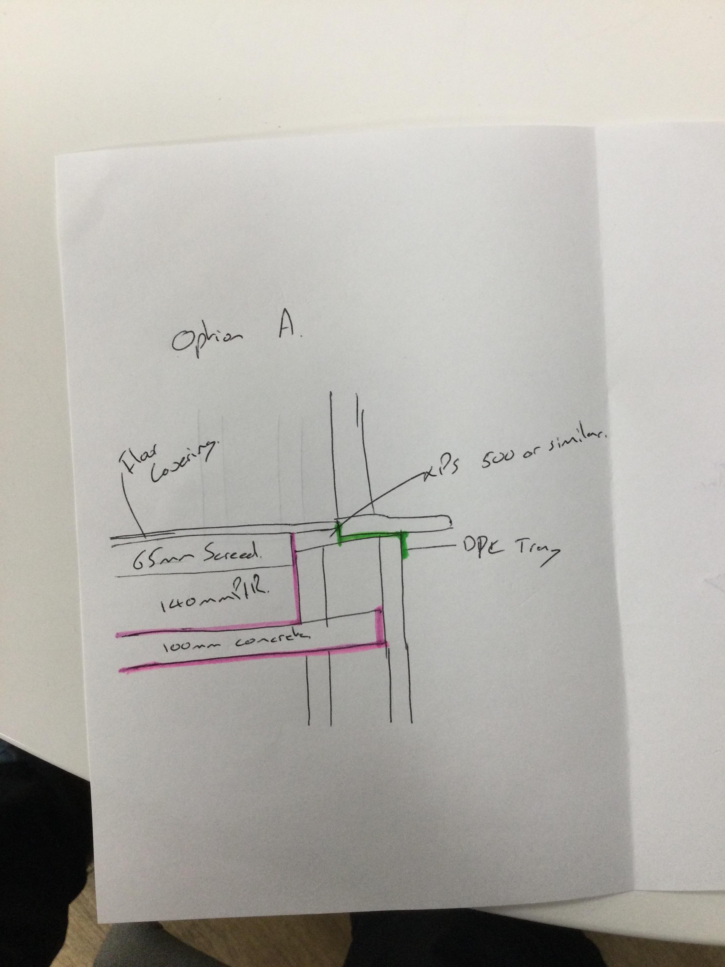

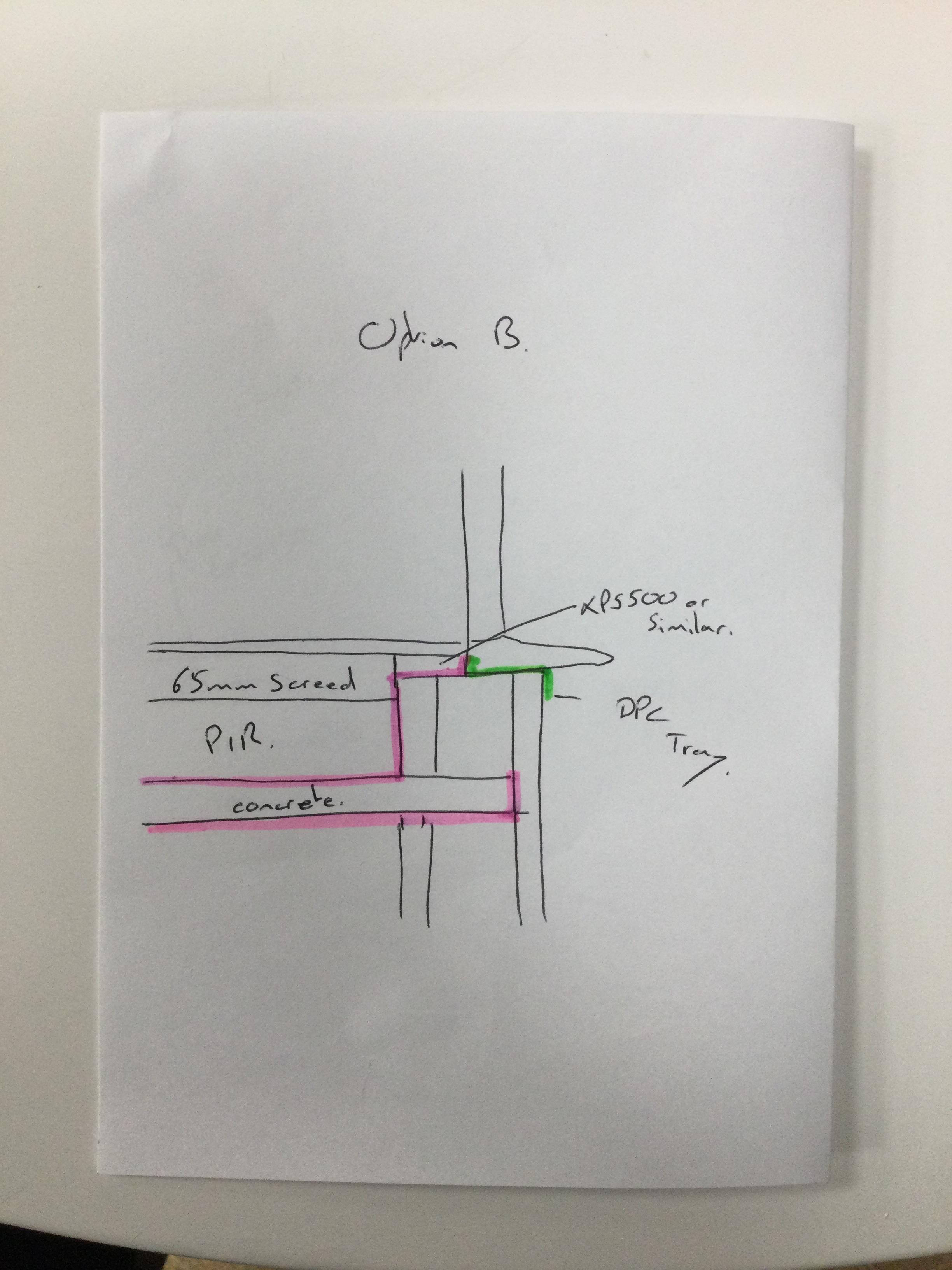

  7. Currently thinking of either of these options, Option A would be easier to detail as I thinking fixing the small piece of xps500 over a radon barrier could prove challenging. In hindsight I know I should have used xps500 under the sill as a cavity closer, but too late for that now. Option A Option B
  8. Thanks Jenki, That’s useful, I hadn’t considered the use of a higher compaction rated insulation in the threshold. That should help eliminate the cold bridging detail I was worried about. Nickfromwales, our details around the door threshold/doc are very vague, but we are basically having a 2 layer radon barrier, one under a ground bearing slab, then one internally, lapped up the wall.

  10. Does anyone have any drawings of how they have detailed their doorway thresholds when building with a polystyrene ICF. Specifically radon barrier and cold bridging details? I’m not totally convinced my detailing is best, but it may be too late for any other options. Thanks

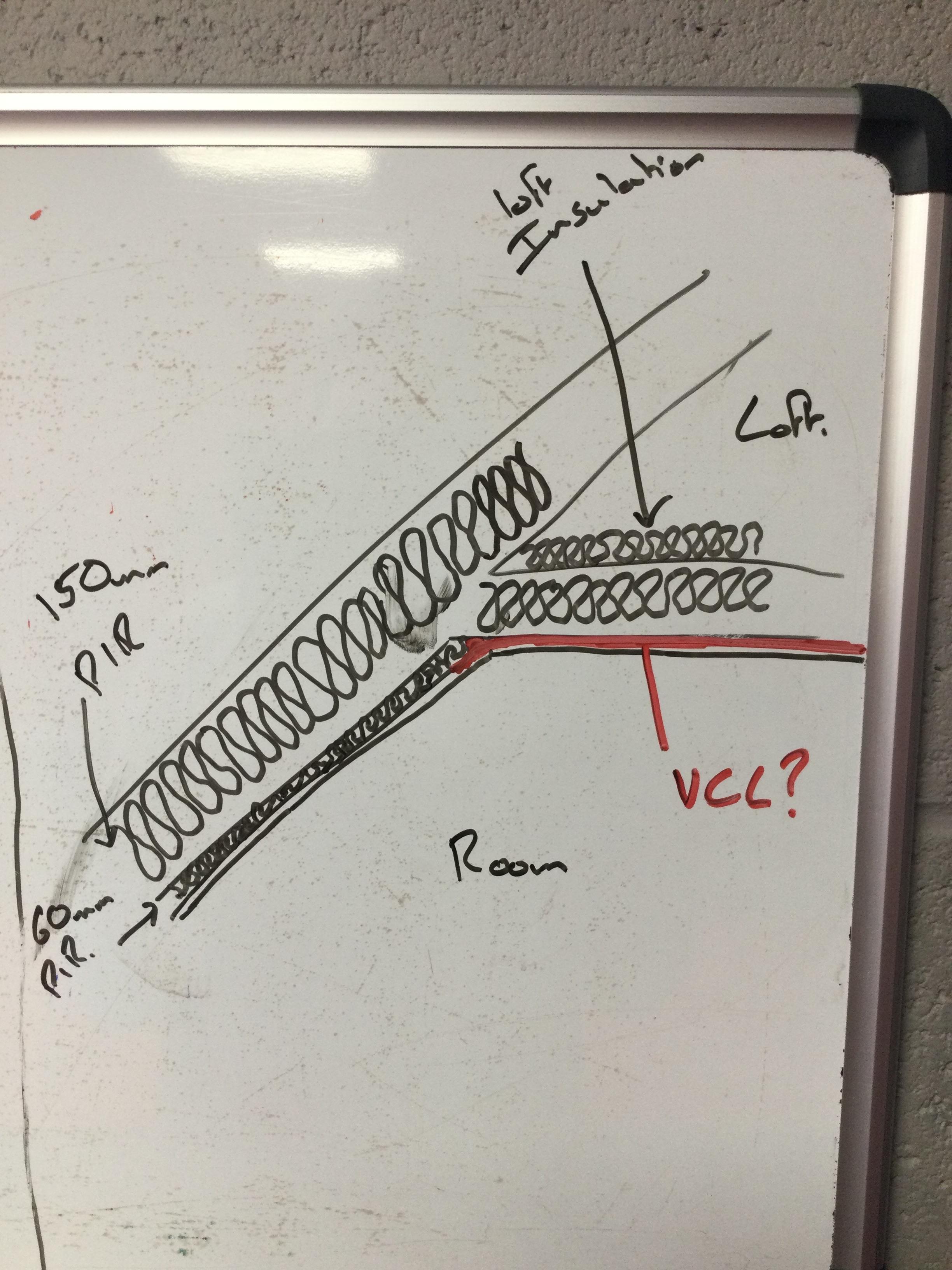

  22. What is used on the flat ceiling parts? I understand the lack of need for it on slopes with pir, it just adds an extra layer for condensation risk. I can see the benefit of both ways, I have come across properties in the past with excessive condensation on the breather membrane due to too much moisture travelling upwards, but also times when the vapour barrier has caused sweating. It seems there is no definitive answer on this one
  23. Perhaps the attached photo makes more sense? pir between trusses stops just above ceiling height. Loft space to be unventilated
  24. Woulld you say this is also true on flat ceilings with loft insulation as opposed to sloped ceilings with PIR? I know it’s a highly debated topic
  25. Thanks for the responses, Yes I’m happy with taped joints being sufficient on sloped ceilings What about on the flat ceiling under loft insulation?
