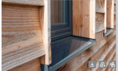

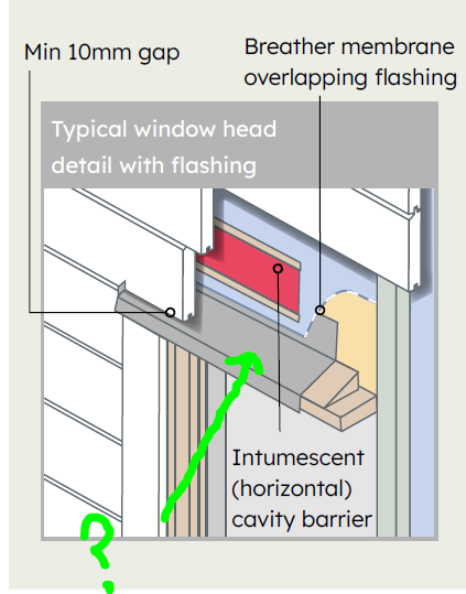

flashing over windows and doors - timber cladding
marmic replied to marmic's topic in Building Materials
many thanks - was thinking that as a possibility if I couldnt find a more purposeful trim and already have a roll here....... I did same on a garden office (posh shed!) few years ago at last place but wrapped it down over and stapled to the front edge of the reveal board (which were gravel boards!) - not sure how well it will withstand UV / full exposure etc.
