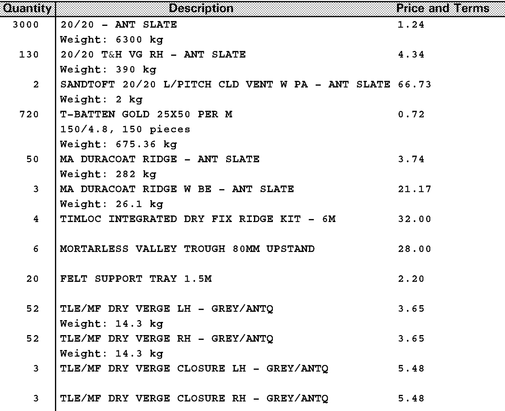

I am in the process of rebuilding my roof and one of the roofers I had out is recommending Kytun dry valleys. My current materials are already on order from Henshaws and include ( see pic attached at bottom for specifics ) Tiles & T&Hs Tile Vents Ridges Dry Ridge Kit Dry Upstand Valleys Felt Support Trays Dry Verge Tile Nails My house amongst trees in a forested and moss prone environment with lots of leaf fall. Are Kytun Valleys worth it in a leafy mossy area? Do they shed debris well, resist moss build up compared with mortarless valley troughs? Are they compatible with Sandtoft 20/20 tiles? Any issues with battens, valley board requirements etc? Any recommendations for Kytun model to choose for 20/20s and any ends or connectors I should order? Install and detailing: Eaves and ridge junction details for Kytun valleys Jointing between lengthsm gaps and any particular recommended fixings? Any recommended leaf guards, things to stop birds? If Kytun is the better route, I plan to return the generic valley troughs and order the Kytun equivalents. Anyone who has advice, experience or even some pictures to share would be great!
