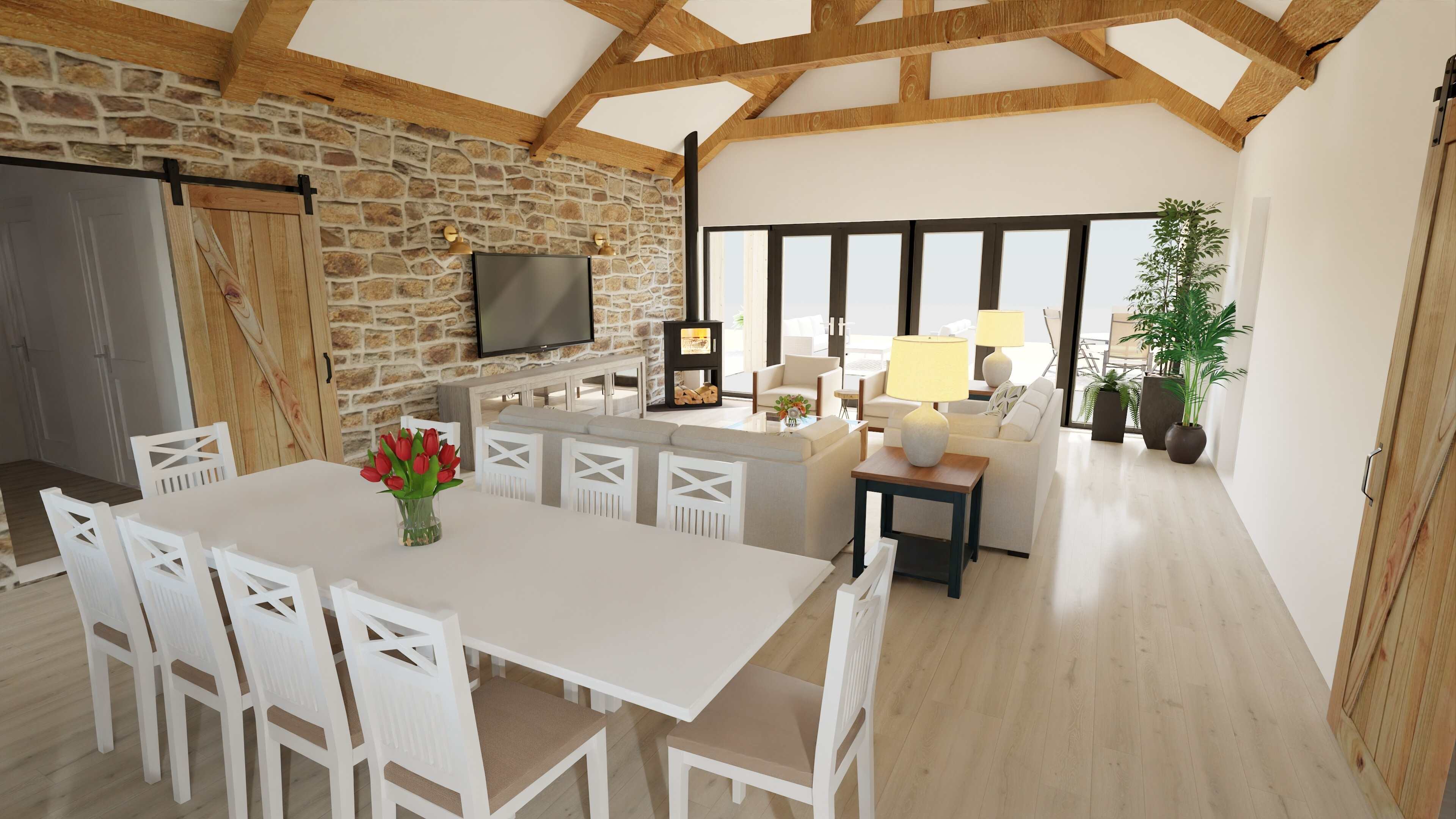

Great idea. Thanks for noting. We had one in our living room in Galatina, Italy when we stayed there a few months back. It worked far better than I expected - I completely forgot about it. Do you think it would be beneficial to add these to the living space, too? Very conscious the room is pretty large and the windows are at the far ends. Any thoughts on cost-saving potentials on this sort of layout? Anything I should consider?

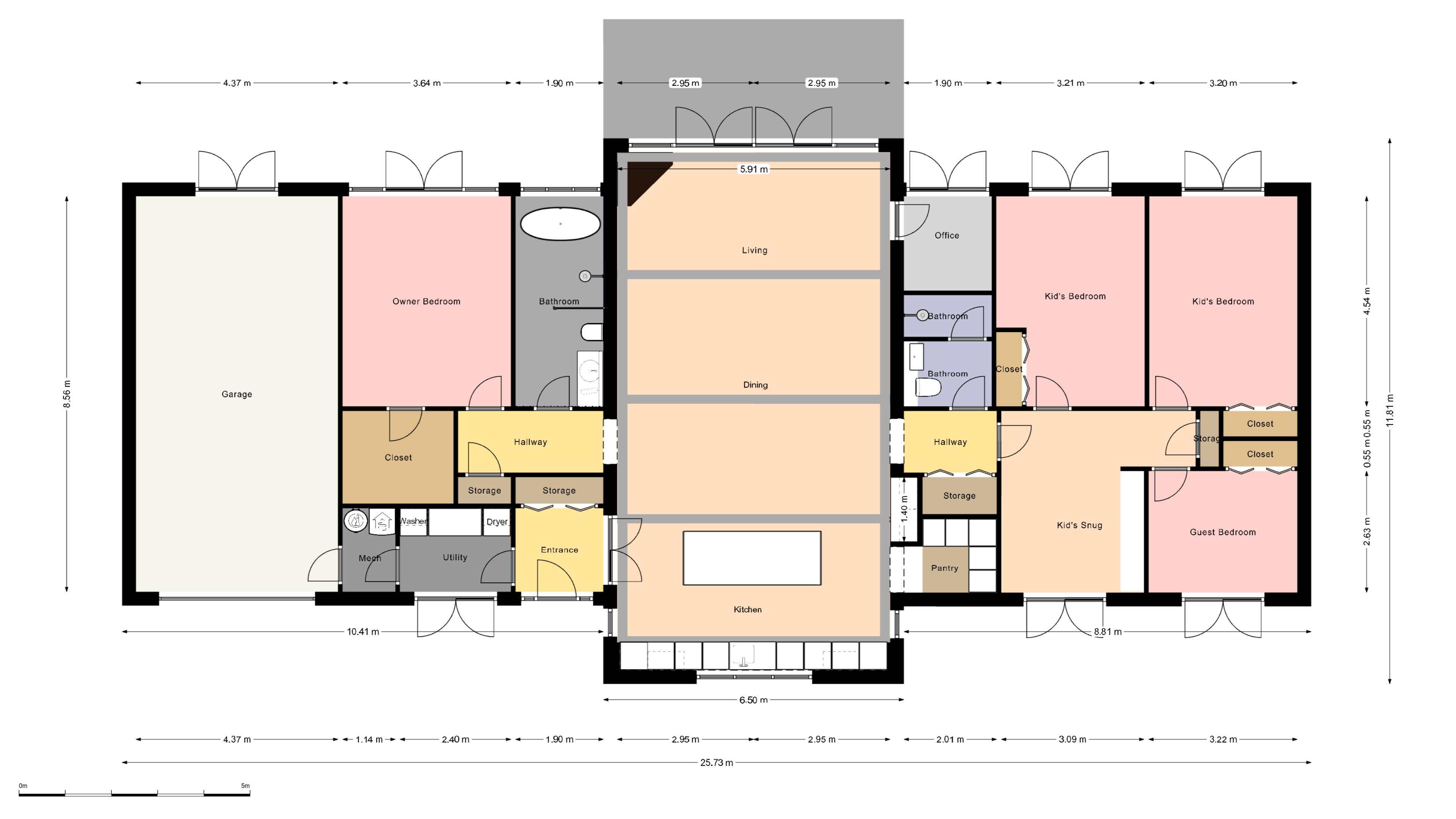

Completely agree. I've updated the plan based on @G and J's feedback. This leaves me with two rooms without windows: the closet and the second bathroom. The closet I can live with. The bathroom, I could personally live with (I had no windows in one of my last property's bathrooms and it caused no issues or annoyance). That said, of course, I would prefer natural light. Could this be fixed with a roof light? The bathroom is pretty central and would cause the window to be close to the roof apex, so may not work. Unfortunately, the software I'm using doesn't have a roof light option so I can't test that option.

Thanks again for the great advice. I see what you mean. I've played around with the plans to incorporate your feedback and thought about natural lighting in the hallways and the entrance's size. My wife and I agreed that we do like the kid's nook not being a separate room so chose not to close this off (not sure if this is what you meant about walking through a room into another). We don't see an issue walking through a utility into the mech/garage. To make this work, we had to swap the ensuite and the bedroom horizontally. This places the bedroom next to the living room -- will this be an issue? Also, allowed me to add a toilet in the entrance room which we can also use to hang jackets. Would love to hear feedback/thoughts/observations. Try not to be brutal 🤣

Hey Bozza. Thanks for feeding in! Completely aware of the general view on designing without land. I tried to make this clear in my post, we're using the design process to understand what we want, as a learning tool, and because we enjoy it. Ultimately, until we have land, we can't do anything other than research and plan; this is part of our process. Completely respectful of your feedback of course, and your suggestions are good and noted. In terms of lighting hallways for example, is this not fixable with roof lighting (my design program doesn't allow me to add this unfortunately). I'd be keen to know which room you're referring to "walking through a room to get to another room." Do you mean the kids snug? I can close this off, but my view was to keep this end of the house for the kids. Utility into Mech I think makes sense but please correct me if I'm wrong. Any suggestions how I can create a larger entrance space? Being honest, the entrance hall was really the room we care about less lol. We just wanted an area to enter the house which wasn't directly into the living space and had somewhere to store coats and shoes, but would love to hear suggestions if you have any. Thanks again!

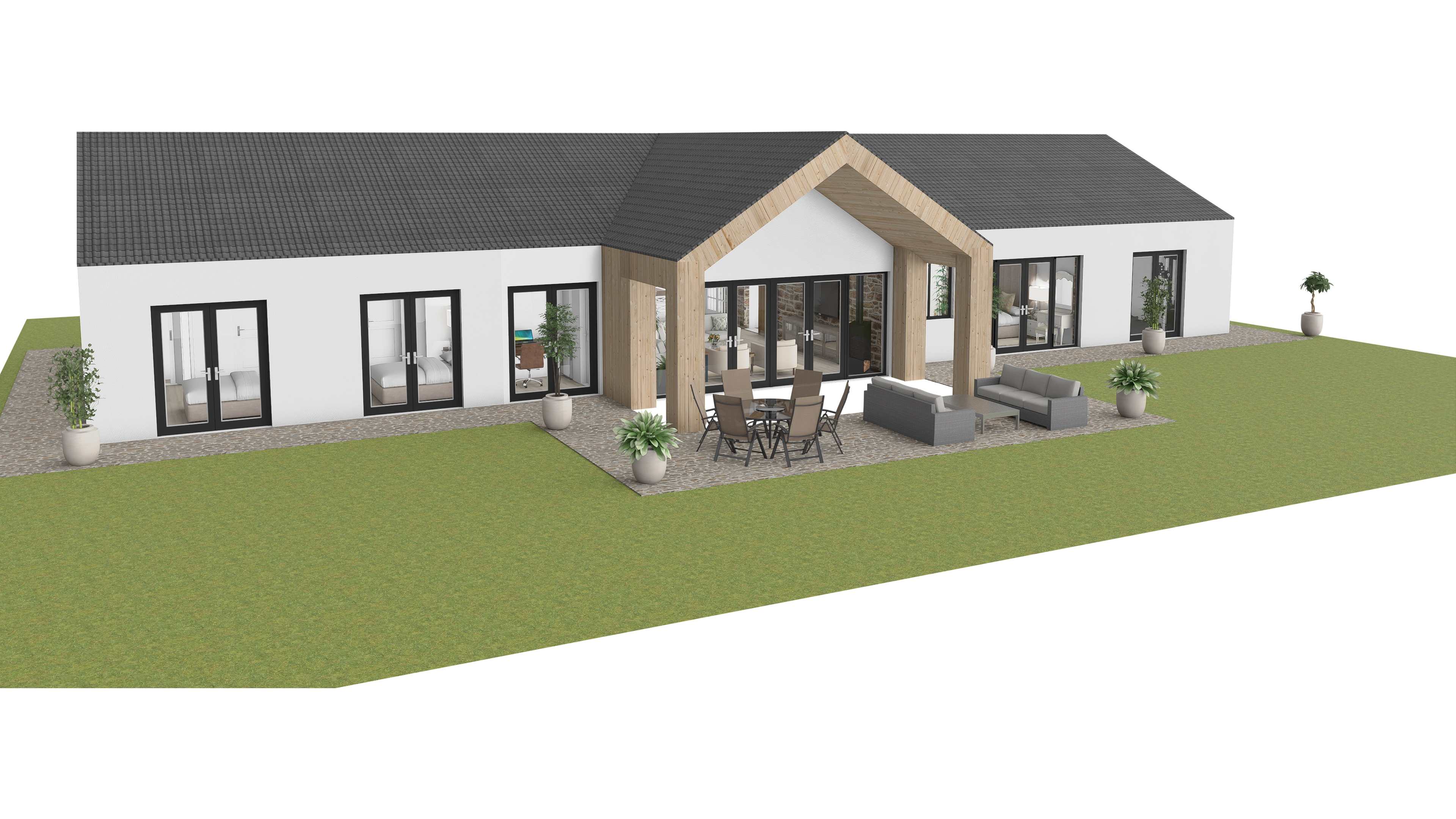

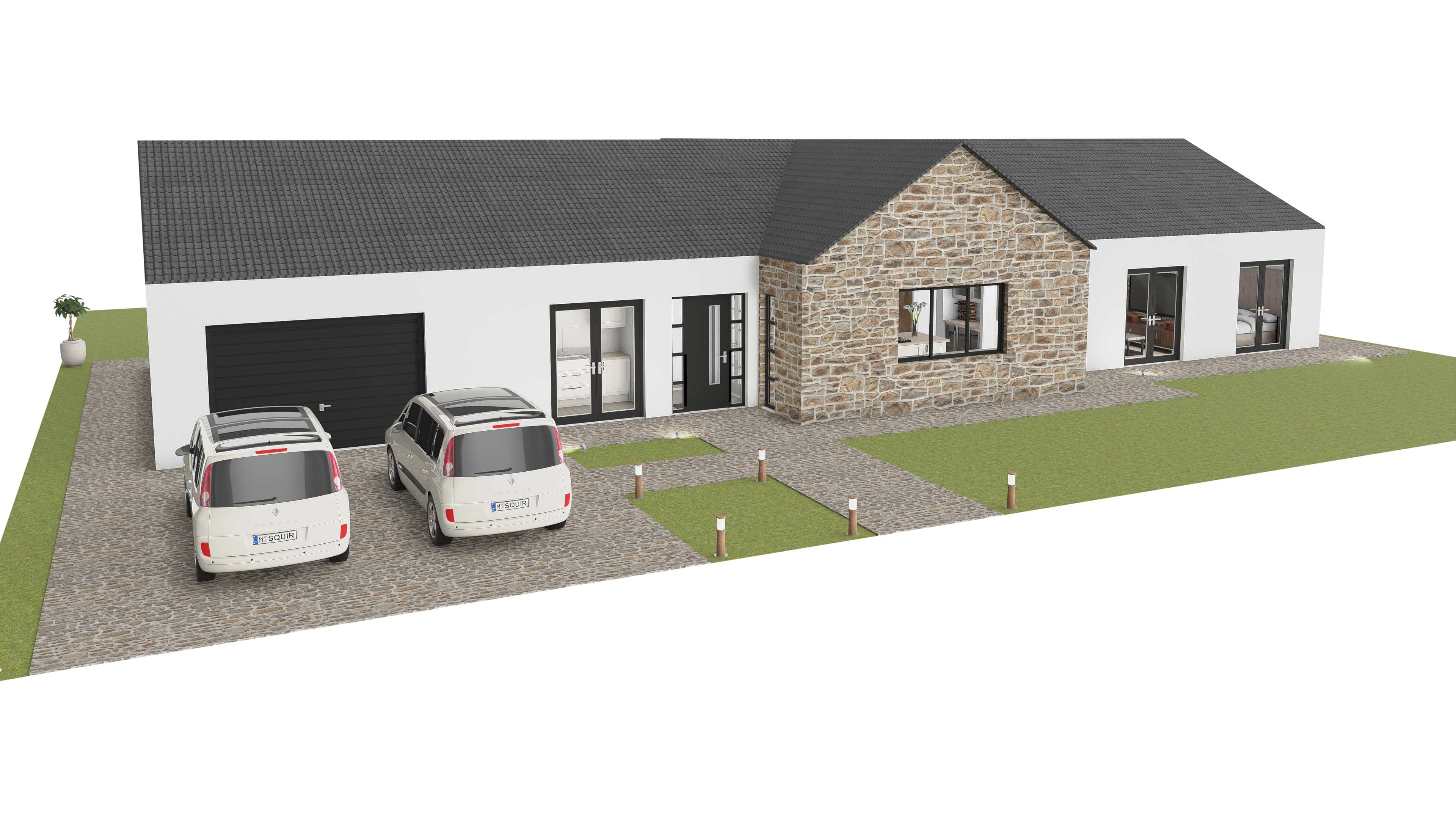

Hello, Adding my updated floor plans based on feedback from this group previously. My wife and I have messed around with more 1.5/1.75 plans, but we're struggling to make it work with space, so we are playing around with a bungalow again. This design is 215m2 (177 + garage). We figured with this layout we could build the garage later if we cannot build to our £1400m2 budget. The garage is deliberately oversized, as it will be used as a workshop/gym/art/drumkit room lol. The car will never be in there. I'd love constructive feedback on the flow and general layout. Anything you see that will cause annoyance which I may have not spotted? So far, I think the office leading to the living room is really all I can pick out, and that's not a big deal to me. Disclaimer: All my designs are concepts - we're still looking for land within a town in Perthshire, Scotland. I'm aware that designing a house without land isn't the norm, but we're using the design process to understand what we want, as a learning tool, and because we enjoy it. If that doesn't work for you, please feel free to move on. I'll no doubt use any feedback to create updated versions, so to keep it all in one place, dumping here Thanks!
