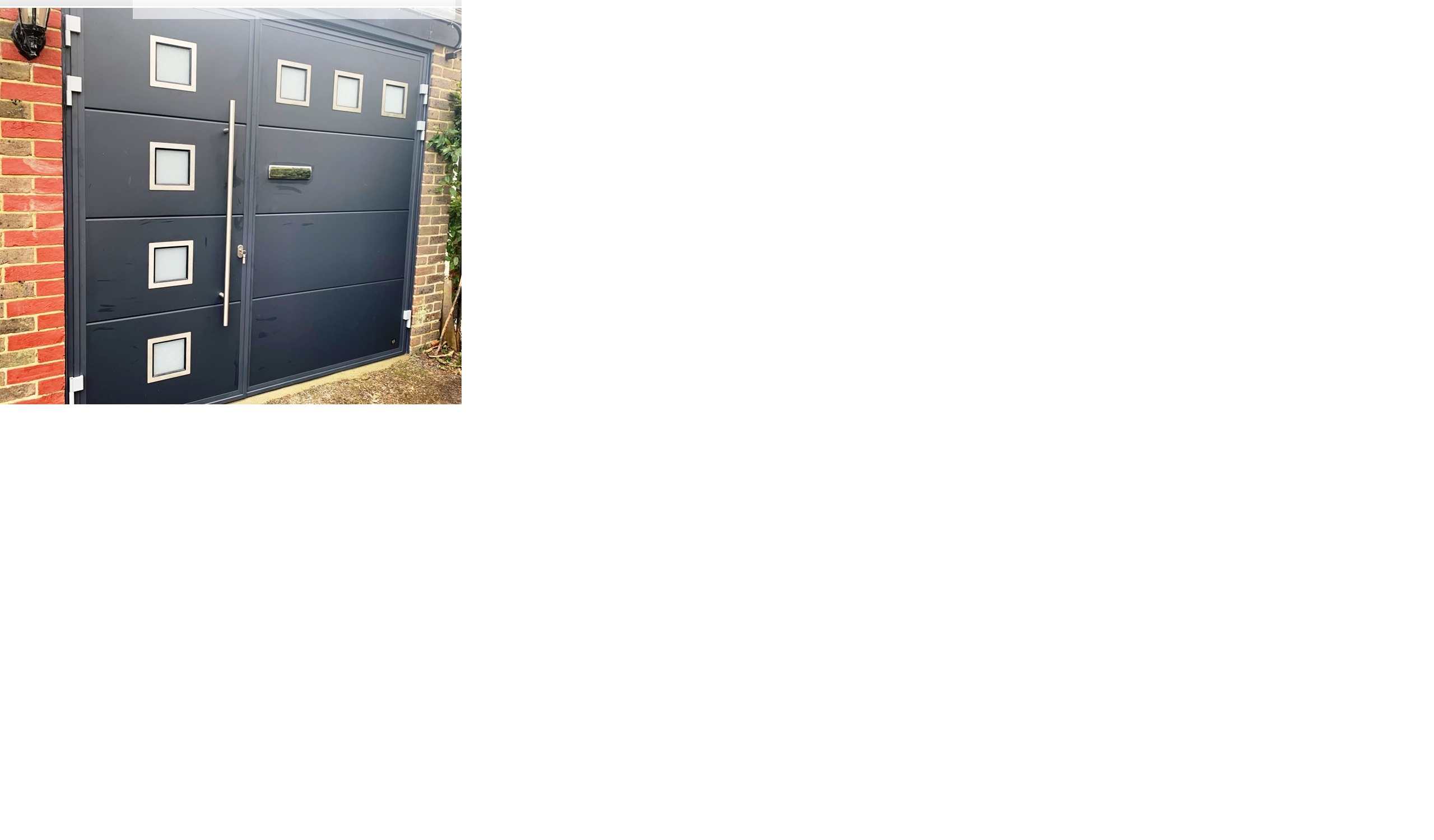

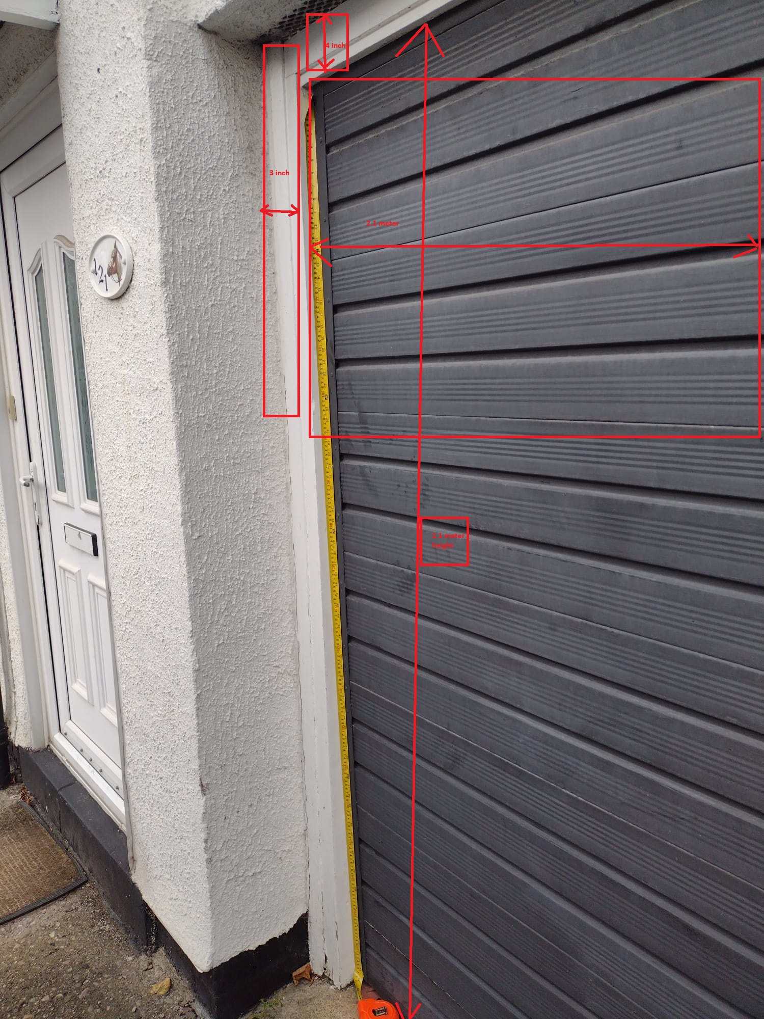

Hi there, I want to order garage doors like the attached from China or Europe whoever gives the best service and quality. And statisfies UK regulations. Could you suggest some websites?. This is the one with a side door(Garage_Door) I also have some questions, what is the best way to choose a door or French door size based on the existing garage door. I believe we should go for smaller size so we can adjust or fill the space using any additional fitting or bricks in the free space. I am interested for the garage door with trickle ventilation and some small window outlets for air as I am doing for garage conversion however having bigger door will help it to serve as garage as well if need be. My garage opening is 2.1 meters by 2.1 meters with some additional space which has white wooden frame as attached. Its 3 inch wide on both sides and 4 inch wide on top(refer attached snapshot of garage door. (Garge_door_with_white_frame)
If you can see the garage picture there is study behind the garage.(which you cannot see however for your information). This garage is 4 metre by 2.5 metre. So not wide enough more on bit narrower side. My plan build a living cum storage place for other garage items and couple of cycles which can be wall mounted. *I want it to have garage ambiance or retain that look. Any ideas will help* Question : 1. Any design ideas of garage conversion into living cum storage room.(Couple of cycles & some tools, paint tins)Will BC approve it? 2. I want to take help of builder to first install a french window with ventilation to replace garage door or do you recommend some other door type . I want the door to be wide enough atleast 1.5 to 2 meters wide to get some items through into back garden. Plan is do floor, wall and ceiling later by undertaking DYI or friends help. Is this sequence correct or we need to do insulation job done first. 3. I am planning to purchase used french door from FB or eBay. Can you please advise how ensure I get right size. The have measured just the garage door(black metal) excluding white wooden frame. It's 2000 *2210 mm. Can I purchase French door of this size. If the french window is bit smaller size can the builder fill the extra space with brick or some other material or is it better to use companies who measurements and do fittings.
