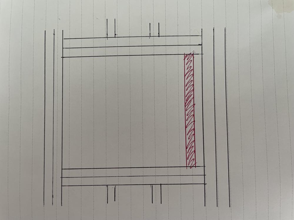

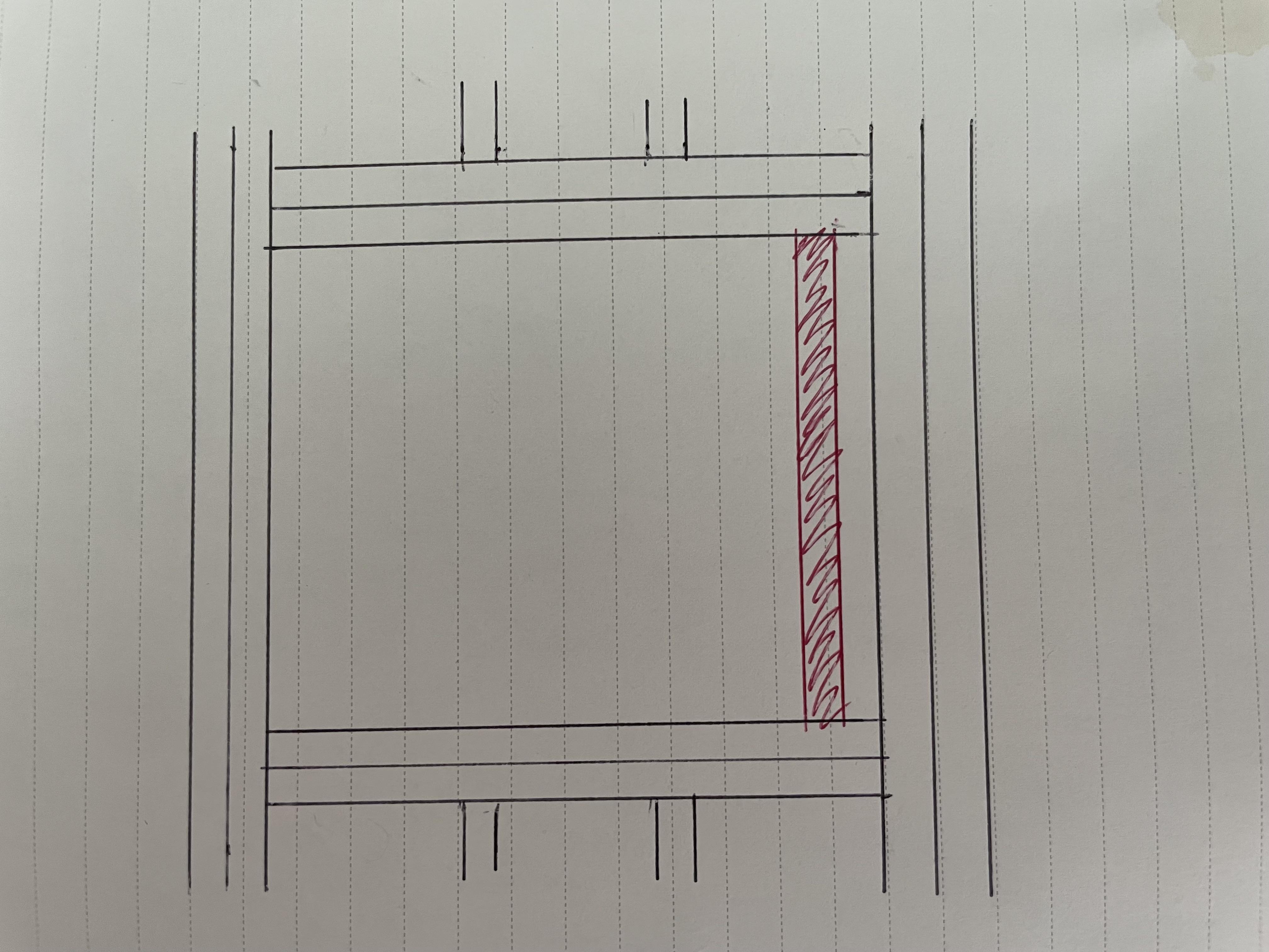

  2. Thank you for your input so far @ToughButterCup A good idea thank you - I have added a quick sketch which I hope clarifies the issues! @bassanclan That was plan A but unfortunately every combo / of roof light size seems to end with the same issue... @Redbeard that seems a good solution but no purlins here! I can only assume that this is a fairly common situation when retrofitting into older properties, surely there must be a solution that keeps the BCO happy!?
  3. Good morning all, I was hoping someone may have encountered this same issue… I am installing roof lights into an existing roof structure so I will be keeping the joists and existing deck. For the openings I will double the joists either side and add double headers as per normal. However, due to the spacing of the joists, the doubled joists will still be too wide for the upstand so I will need to add an extra length of timber between the two headers to support one side. I have discussed with BC and they were also unsure how best to proceed as it seems that you should not add additional fixings into headers…. I have exhausted TRADA / BR approved docs etc in search of a solution but have not managed to come up with anything useful. Any advice would be greatly appreciated!

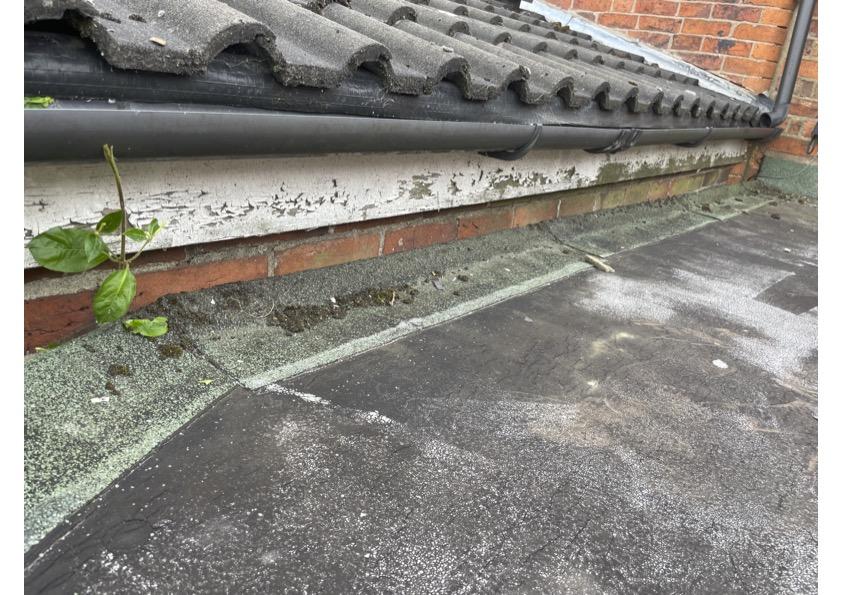

  7. Hi all, I was wandering if anyone could help me with suggestions as to how to marry up my new warm roof build up with my neighbour’s property? The issue is that my roof was installed about 50 years ago and since then my neighbour’s property has been extended meaning there is no access to the existing fascia etc. to make this even more fun, I am going to add a warm roof build up of 170-175mm (Velutrix, 150mm PIR, 18mm OSB, GRP over existing deck). This brings the new height to around halfway up their fascia board. I have my neighbour’s consent to take my roof to meet their wall and close the 40-100mm gap which currently exists but I would appreciate any thoughts as to how best to do this while allowing the GRP to run high enough… ie. Should this be behind their fascia board? I have added a picture for reference - the gap is below the gutter line although it does not really show very well. Any input would be greatly appreciated! Many thanks in advance…
