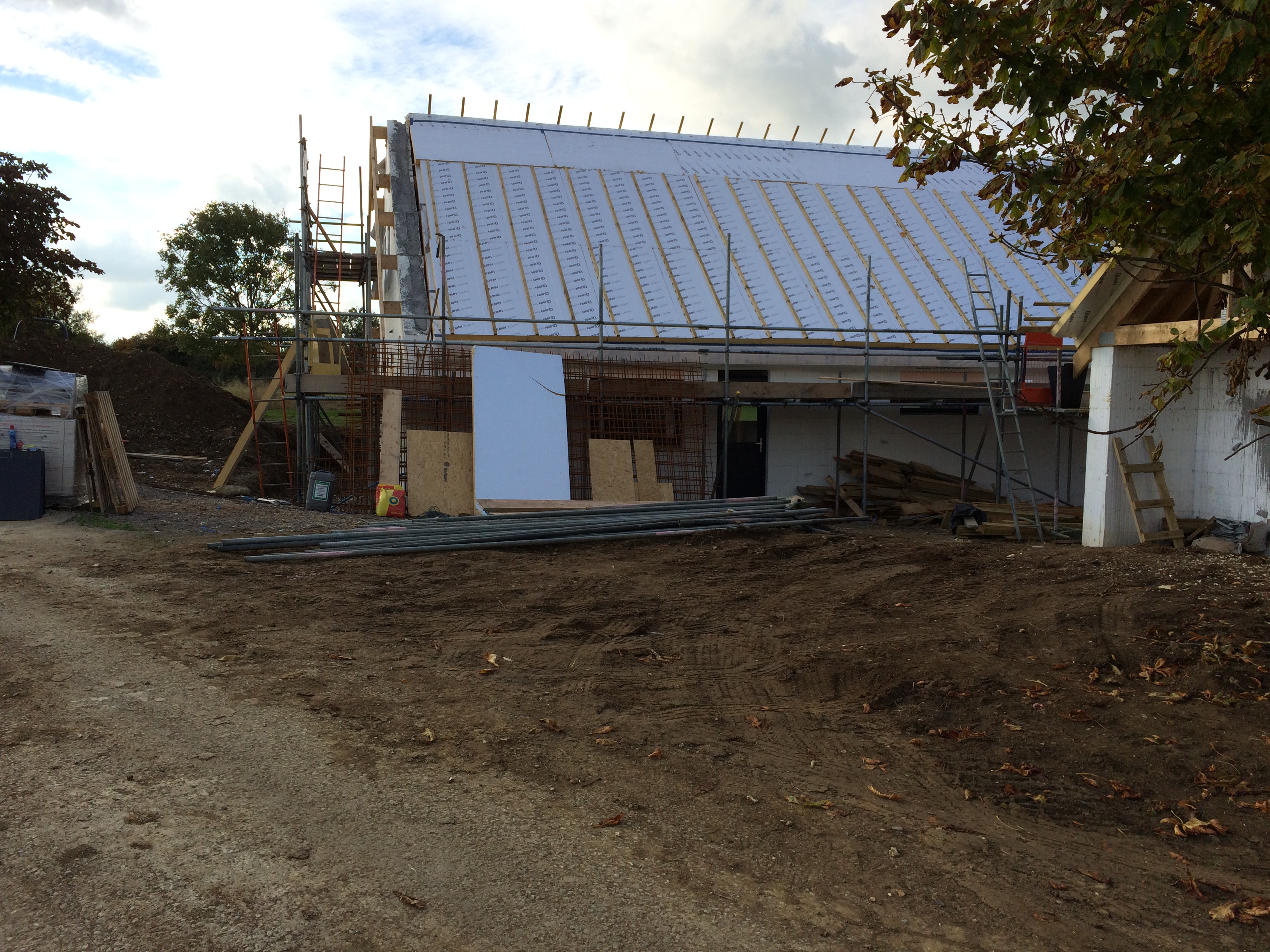

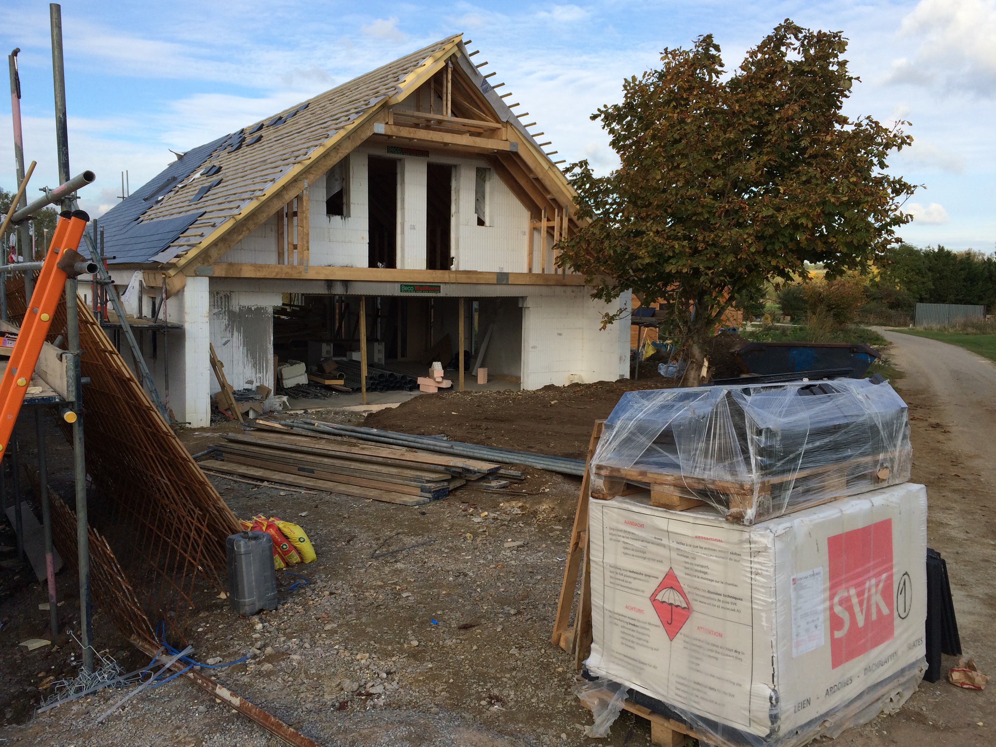

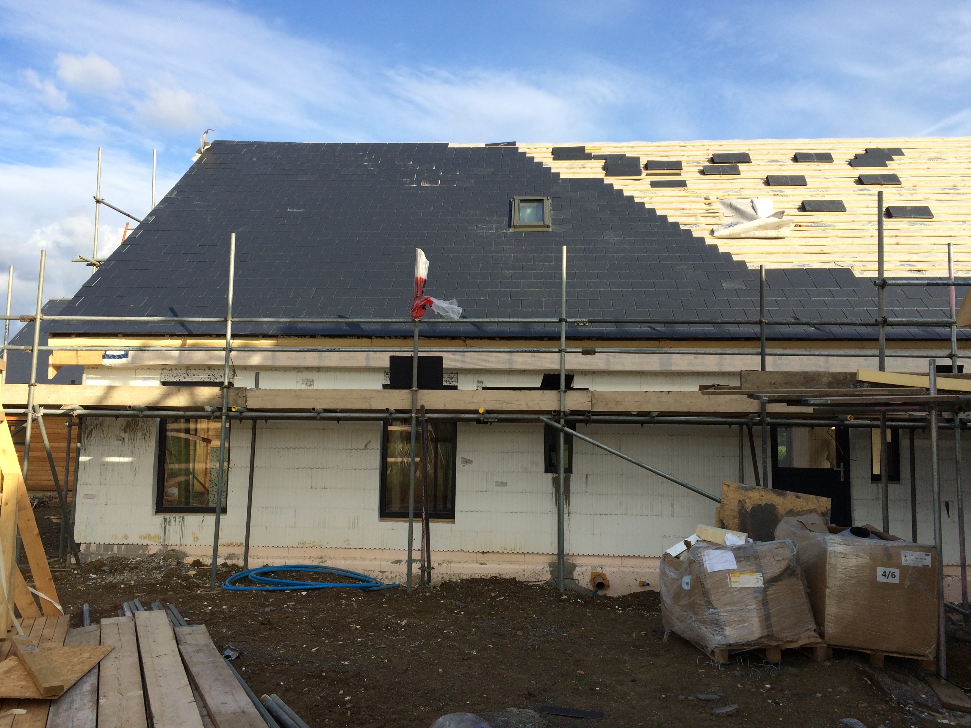

Well time (quickly) and build (slowly) have moved on. So an update is in order. MVHR is to be a Zhender Q600 comfoair system with the Q600 comfocool attachment. Ductwork is rigid Lindab and currently installed in Tom's, our next door neighbours. We are both pretty much water tight although 5.8M Internorm doors are yet to be installed along with some other Internorm windows and doors. Second week in November for the remaining doors and windows. I decided to go with SunAmp 5kW PV with 5kW expansion. That is until I got the schematics and found that they (SunAmp) supplied the two units in a series configuration. So flow seriously compromised by 15mm pipework throughout. I was expecting them to be connected in parallel! So I went back to SunAmp to cancel the order and revert to thermal store. However, I am now awaiting confirmation or otherwise from SunAmp on early deployment of 10kW mini stacks which feature 22mm pipework throughout. I will get to know this week so decision in the balance. If we get offered a ministack solution then Electric based Duct heaters, rather than hydronic Veab Duct heaters will be required. We already have the VEAB units albeit the wrong diameter (too small) ..... another story! In answer to the question by PeterStarck, yes the outer EPS of the Isoquick lines up with the outer EPS of the Beco walls. The wall to truss joint was always going to be a thermal bridging challenge though not a huge issue. The warm roof comprises of 2 x staggered layers of 100mm thick PIR fastened to 11mm OSB deck (Sarking) across the external edge of the roof trusses then membraned battened and tiled. Between the trusses is an additional 100mm of acoustic/thermal insulation followed by the airtight membrane (Pro Clima Intello Plus). The roof insulation continues under the exposed ends of the trusses ( between truss and Soffit) to meet up with the wall EPS. Internally the truss to wall plate joint is filled with Thermal/acoustic insulation to minimise thermal bridging. 6kW of Solar PV is to be installed; 3kW on each of the East and West facing roofs. If looks like we will use electrically heated towel rails and an electric duct heater in the groundfloor MVHR supply loop only IF we go with SunAmp. This is because there is no stored hot water in the SunAmp based system. I have attached the space and DHW system as employed in our other Passivhaus. Clearly, this will be different for the current houses but with same functionality. Depends on whether we revert to thermal stores. roof wall junction detail v2.pdf Saddleback Heating and DHW.pdf

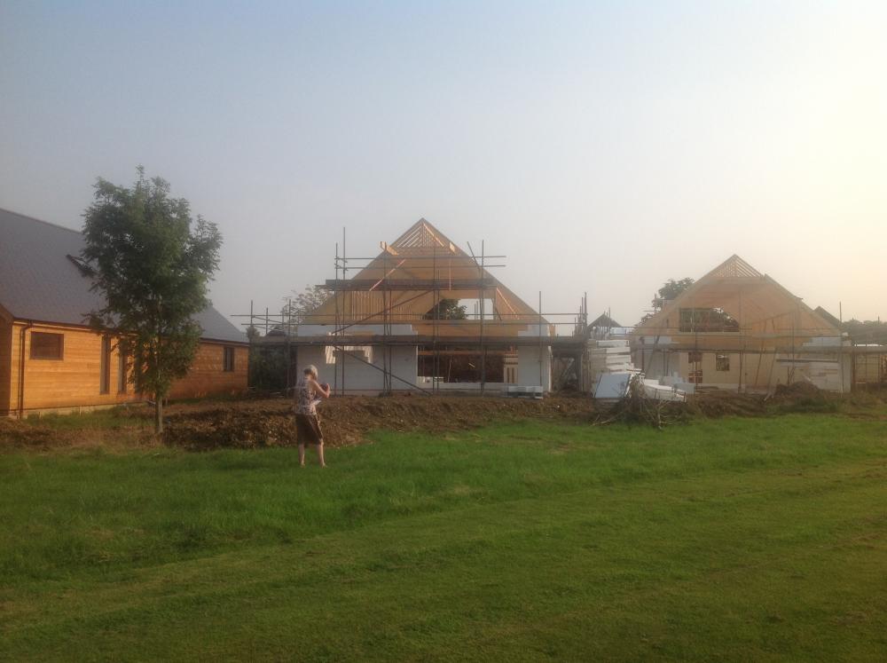

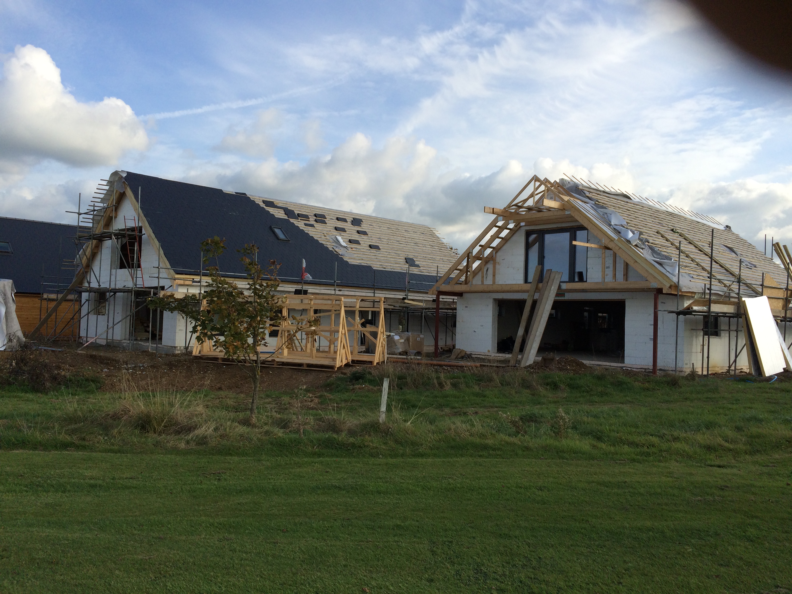

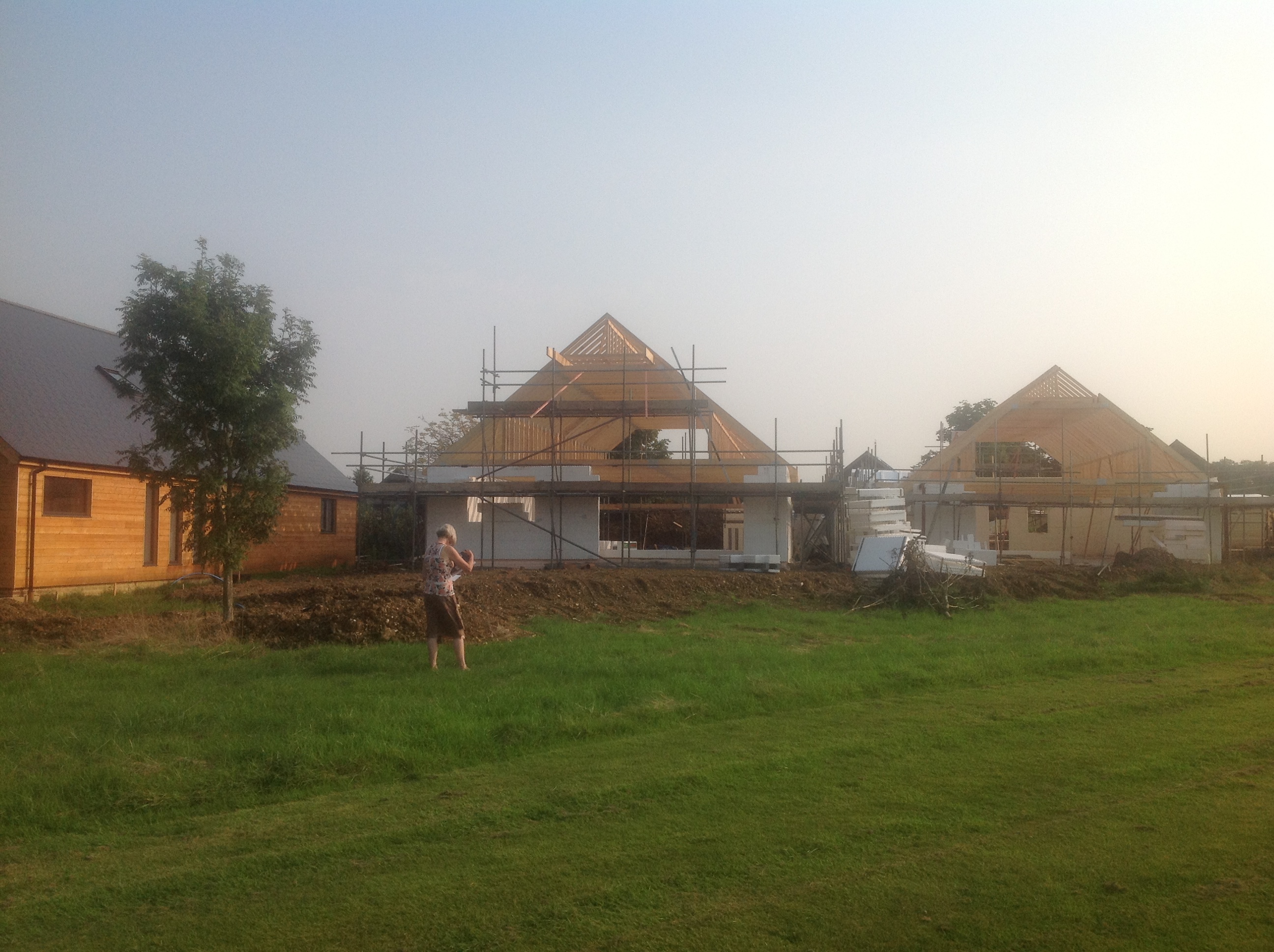

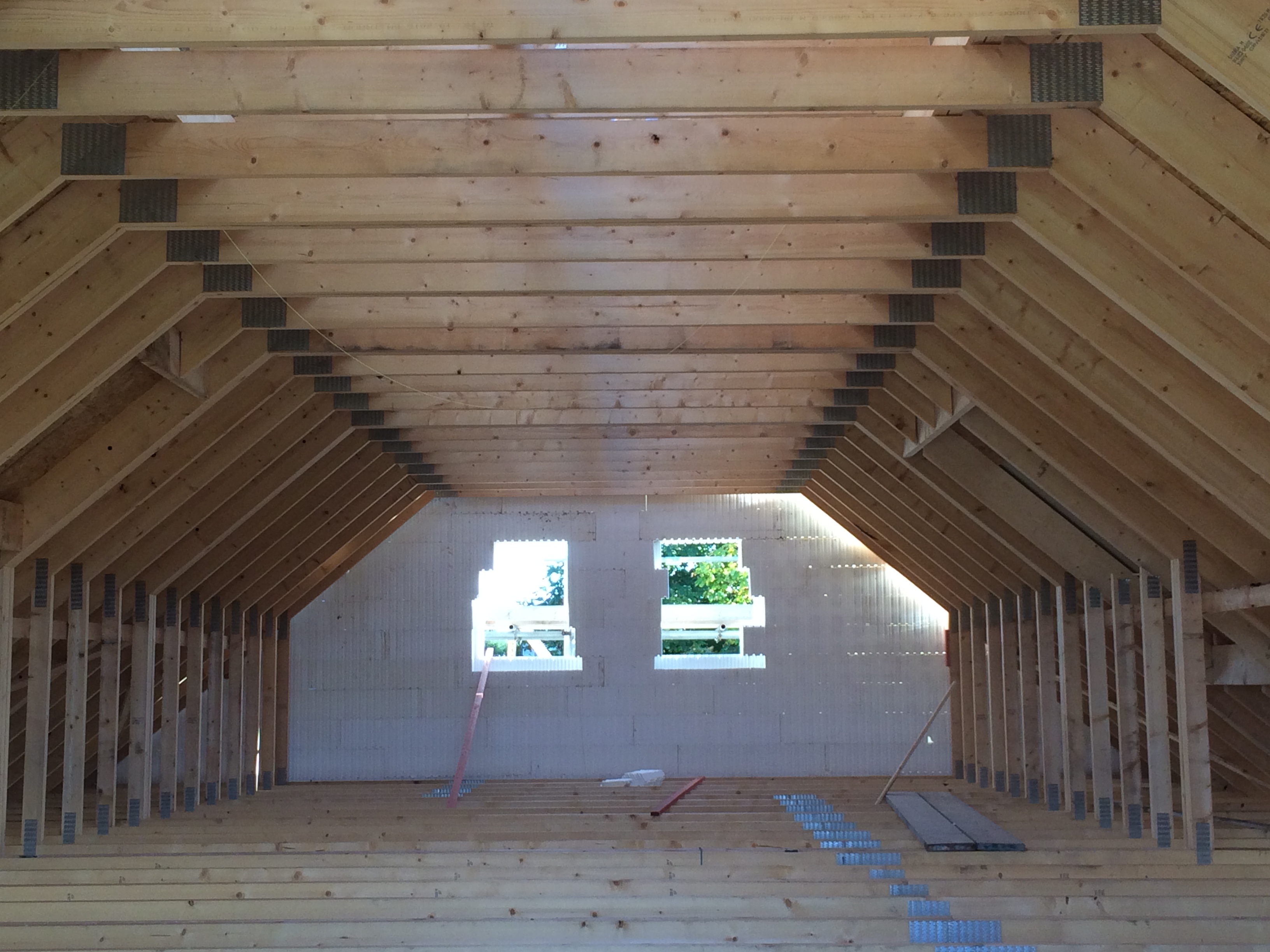

Hi everyone, I'm a "mature" retired electronic/electrical design engineer come computer networking consultant come PH self builder. See following link for existing building details. http://passivhausprojekte.de/#k_4186 Currently designing second PH for construction in Brinkworth, on Woodbridge park golf course. Build commences 2nd August. Also designing next door neighbours from PHPP perspective. Scandanavian Lodge design ( planning requirement), Isoquick insulated raft foundation, Beco ICF walls (polstyrene lego bricks according to my wife!), attic trussed warm roof. Approx. 240m2 and 550m3 gross including voids which are within thermal and airtight envelope. Techie bit. Hmm.. The intension was to have very similar to current house as it works well! However no mains gas so all electric. MVHR to be a Paul Novus 300 with Lindab rigid safe ducting, silencers etc. Thermal store to be Akva Nero 750l (current house has Akvaterm std tank of 500l with top and bottom DHW coils giving up to 35l per min). Change of size result of no mains gas and probable use of Eco7 electric to supplement Solar PV via Immersun PWM switch to two high temp immersions. Space heating via VEAB CCW 125-6-2.5 in living area duct branch only - no active heating to bedrooms. Summer active cooling via VEAB CWK 125-6-2.5 in bedroom ducting only or VEAB CWK 160-6-2.5 for all areas... 3kW ASHP air to water supplying the VEAB CWK. Secondary DHW loop to provide "instant" hot water to all areas with little potted water wastage (as per current house). Well that was the plan until I discovered Sunamp and Zehnder Comfocool Q600! So undecided now although no apparent pricing/availability of Sunamp Stack.... Sunamp PV 5kW units look good but only a fraction of the capacity of a 750l TS. Multiple units look very expensive by comparison. However, need to make a decision soon I guess.......
