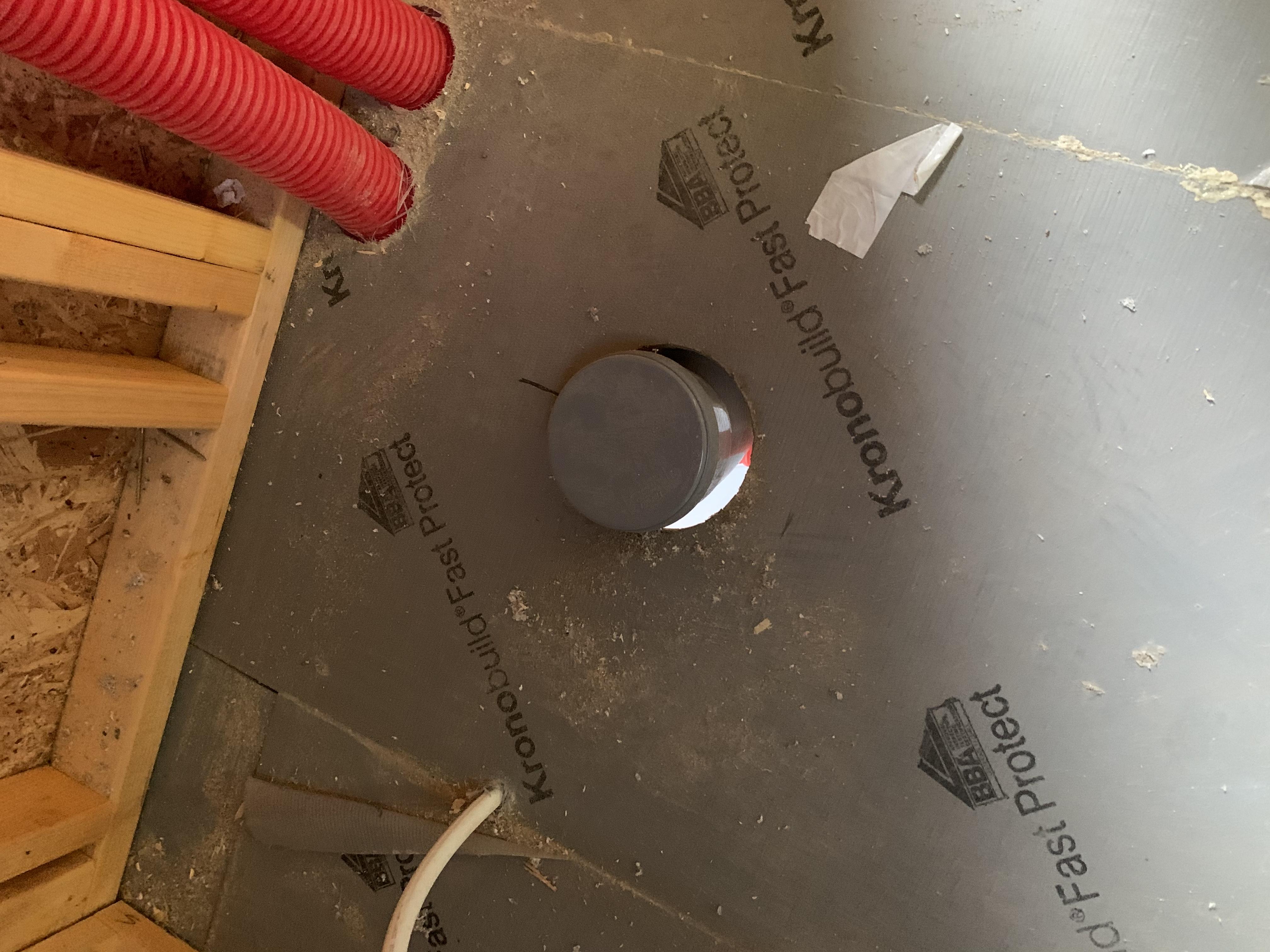

Coops85 posted a topic in Sound Insulation
We are at first fix stage and as plumbing pipes are going in we notice a lot of gaps that will need filling to stop airborne sound travelling between floors and walls. What is the best method, tools, adhesives to go about filling these holes/gaps to stop sound transfer through them, please? Thanks in advance. -

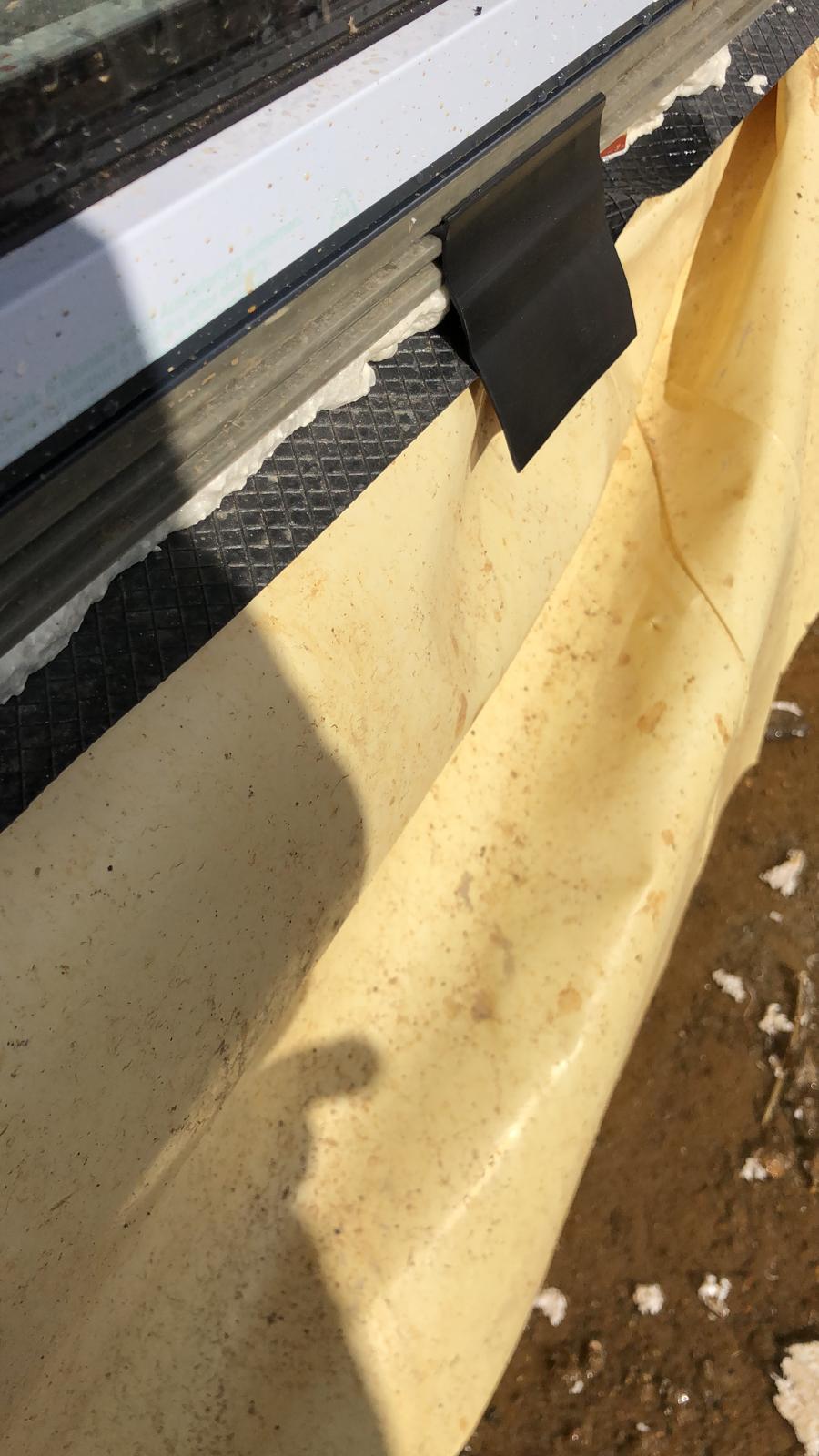

MBC raft foundation - what to do with membrane hanging over EPS
Coops85 replied to Coops85's topic in Foundations
Thanks Jeremy. The uPVC sounds a lot cheaper than the Aluminium. Where did you get your uPVC cladding from and what sort of profile works? How did you fit the mesh and cladding to the EPS? Sorry for what may seem like daft questions. -
Quick question. The yellow membrane which goes on top of the EPS but under the concrete and UFH hangs over the edge of the EPS on various amounts round the perimeter of the house. What do we do with this? We are thinking of having like an aluminium fascia (?) going round the bottom below the render or cladding to cover the EPS. Our internorm Lift and slide doors are just going in and the are wondering what to fix the external sill (?) onto with the yellow membrane being there. Any speedy helpful comments would be very much appreciated.
