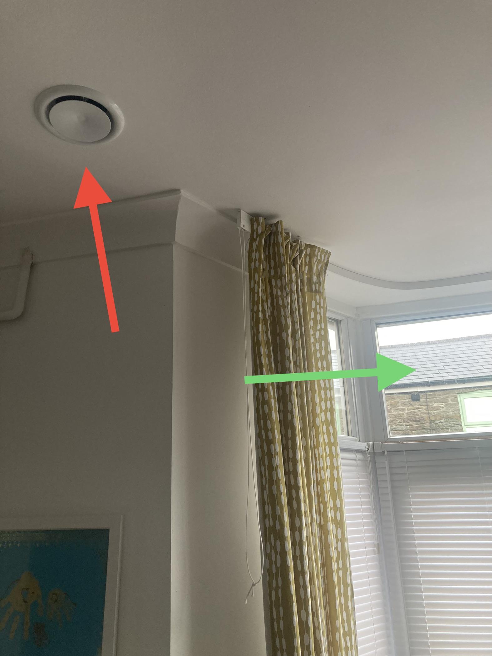

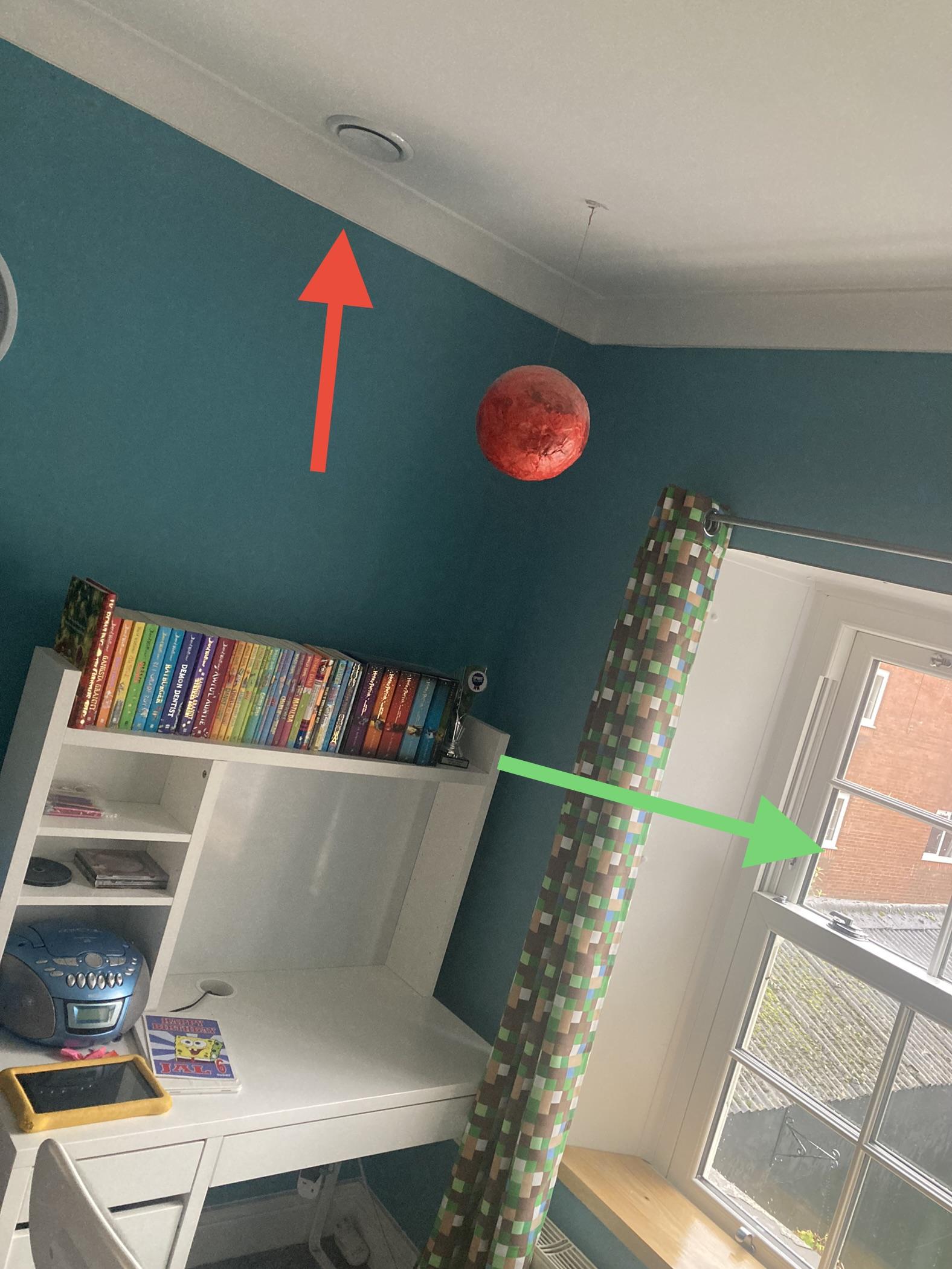

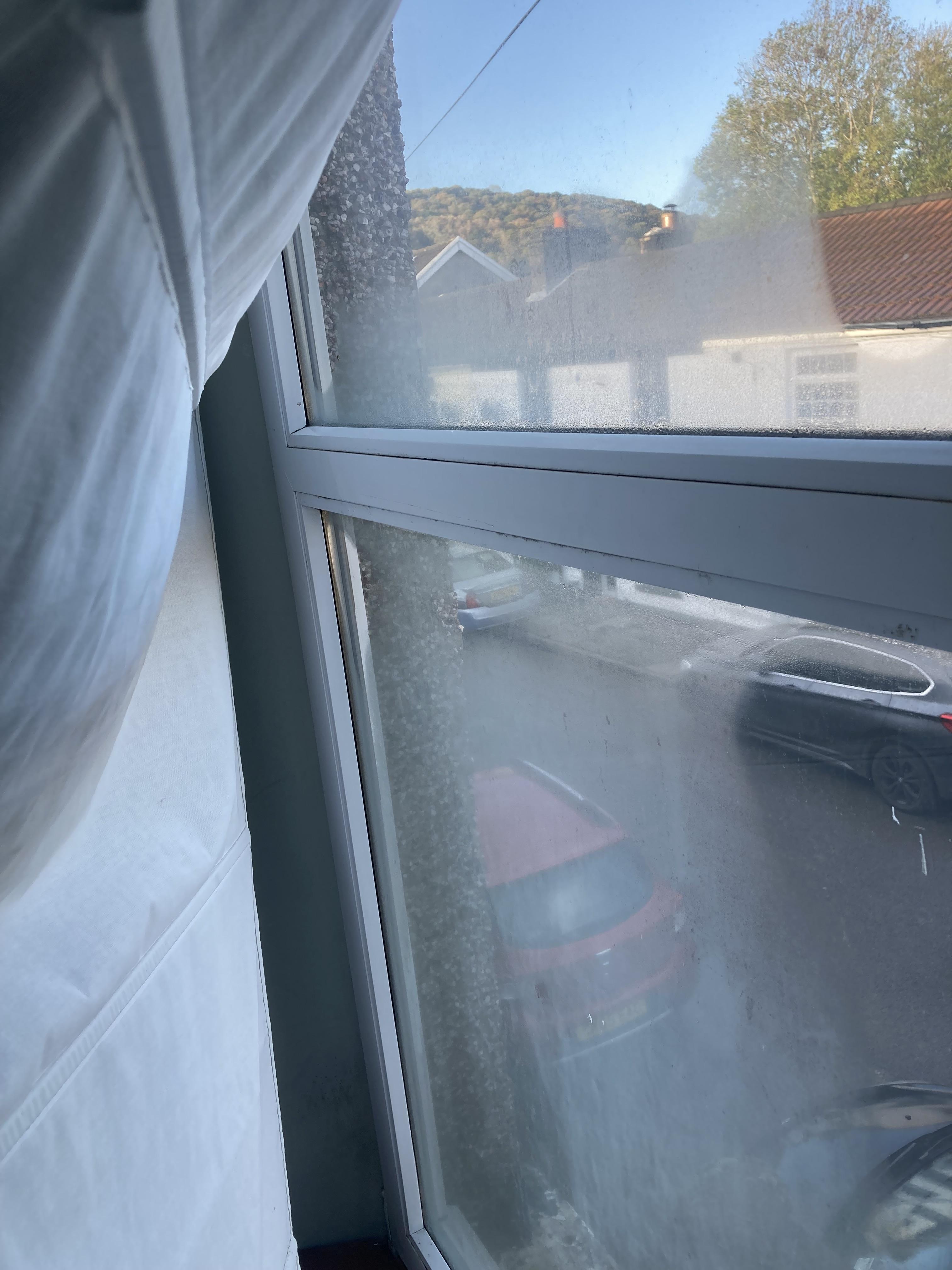

This was the big bedroom this morning , cold side of the house, still reduced from what it was but meh i followed document F and divided the fresh air equally between the supply rooms so each room is like 5.5 litres per second , can I adjust the valves so the other rooms are less and this double bedroom gets a few more litres per second or am I just wasting my time as the windows are old and house isn’t airtight? -

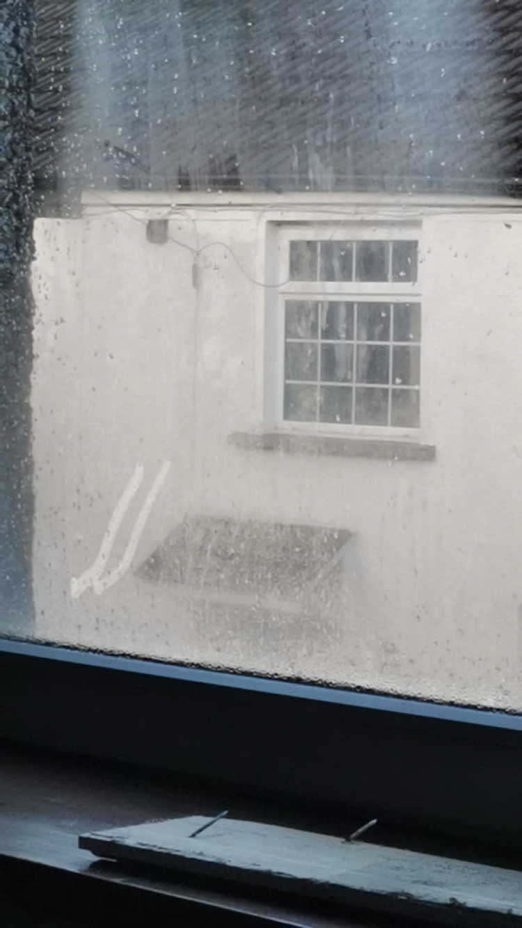

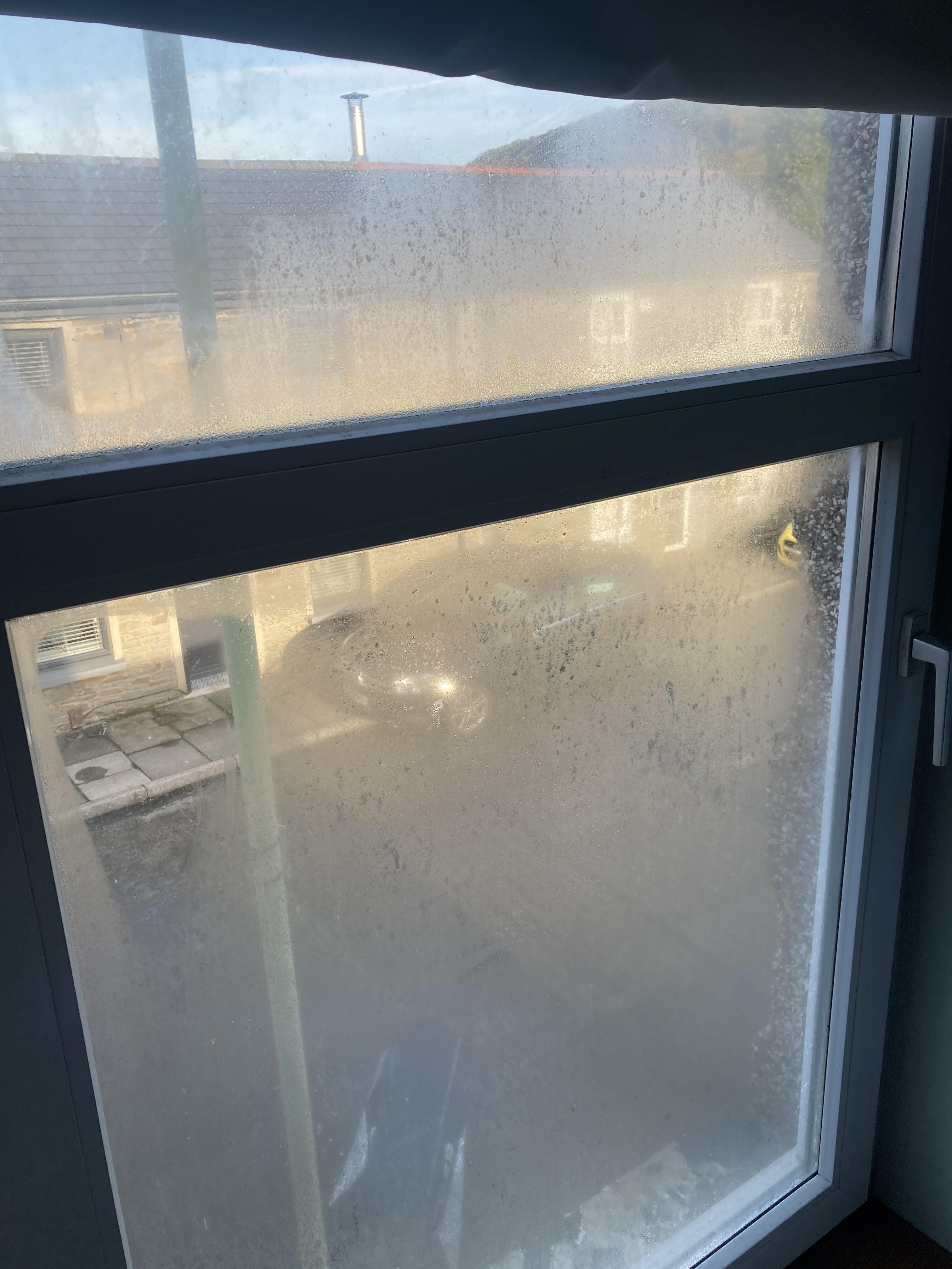

This was on a cold night and we’ve gone from waterfall windows to mist! So mvhr does help with condenstion in an old leaky house! -

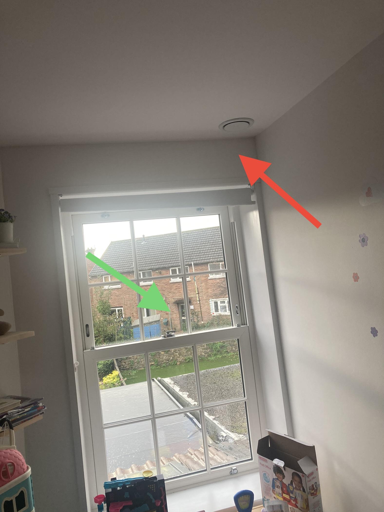

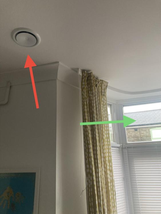

Added a few pics just to show grilles and condensation free windows!! -

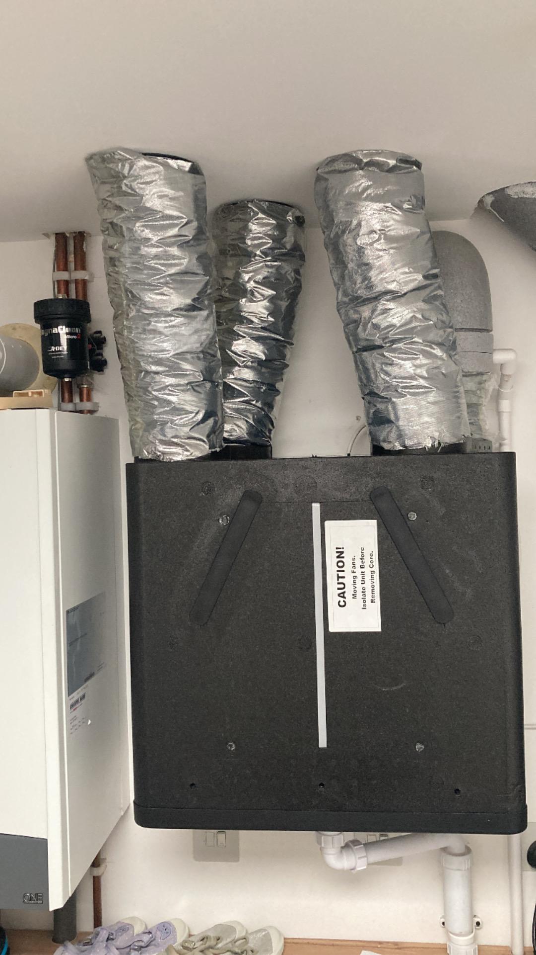

Ok so I’ve finished the install!!! I tried setting it up with the testo hot wire 405 Bluetooth probe in the 100mm duct as others have done set the app to l/s and added the damping to stop measurements jumping about i closed 3 out of 4 supply valves and opened the furthest one all the way, got it to 21 l/s by adjusting the pot, then opened the other 3 valves and fiddled and fiddled until I got all 4 valves at 5 litres per second as best I could then I did both extracts same way to get 21 litres per second, as best I could so when it’s measured they are there or there abouts for a balanced supply and extract but…… 5 litres per second in each room doesn’t seem very strong , can hardly feel it, don’t think it would even blow a candle out! Is that right? also even though they are nearly extracting and supplying the same the supply trickle pot is at a different position to the extract trickle pot supply is say at 10 o’clock position and extract is at 12 o’clock position? but I guess if I’ve measured all the valves and they balance out then the that’s just how it is? is there anything else I need to do? if I meet the rates in normal mode , what should I set boost to? In this unit boost has to be higher than trickle -

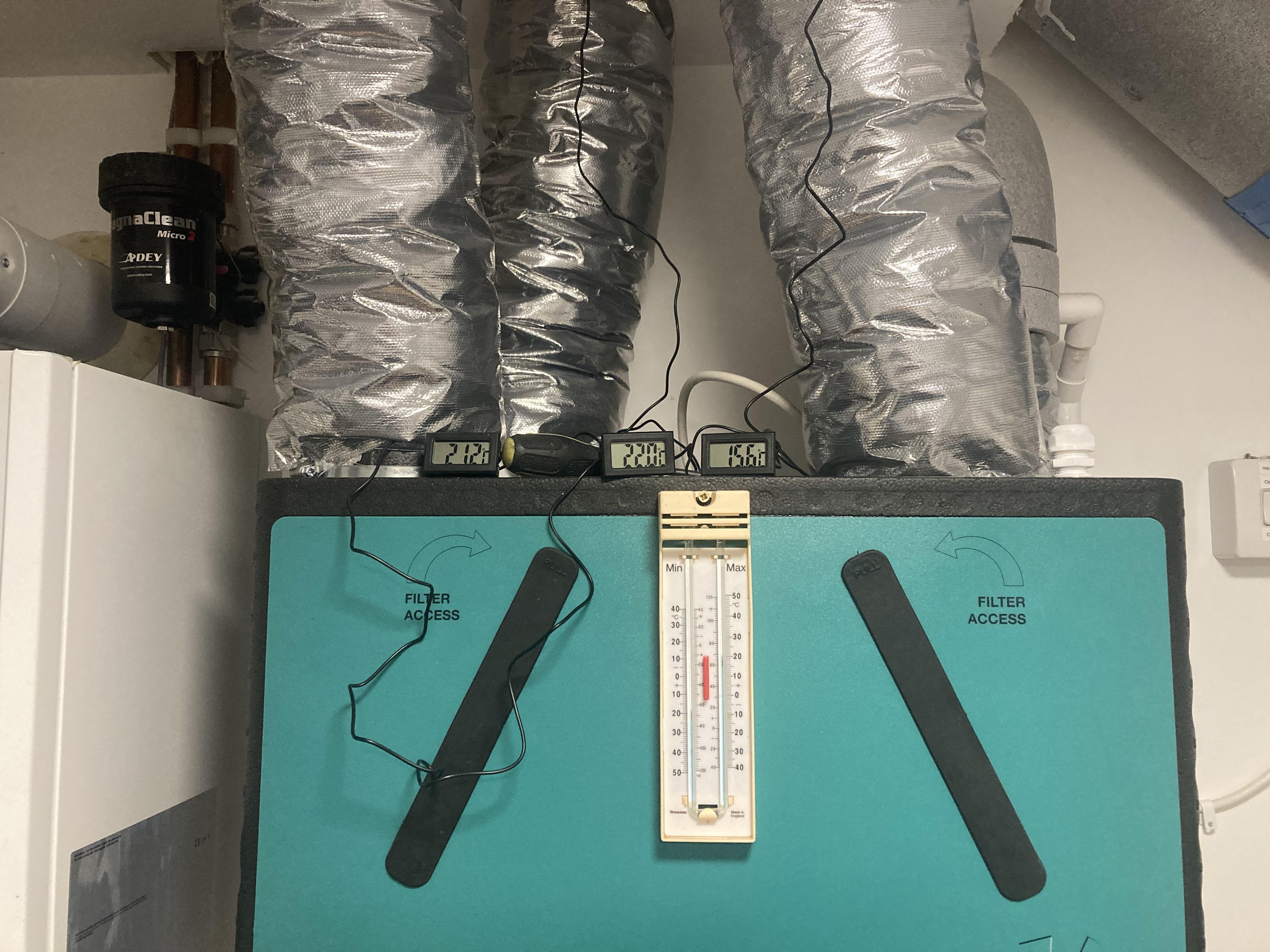

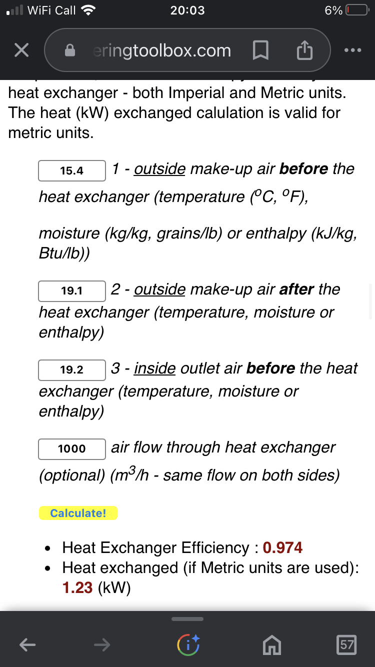

Are these figures ok? Am I measuring in the right place? Poked the probes under the insulation and left them there for an hour, set heating to 22 extracting 22, outisde air in is 15.6 heat recovered air into house is 21.2 is this how you even measure it or do I need the temperatures at the grilled in the rooms? -

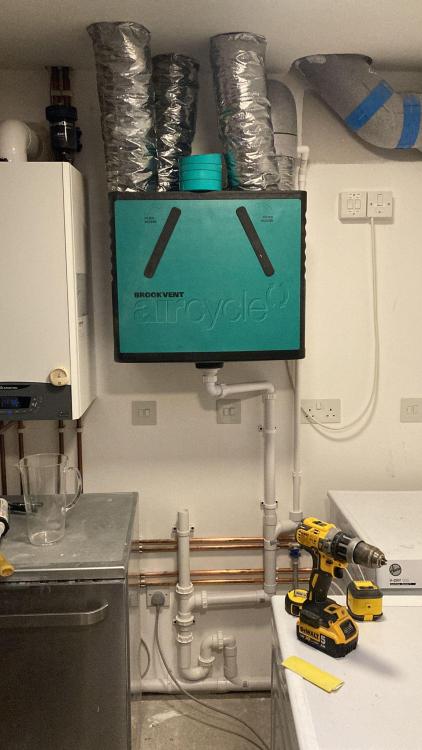

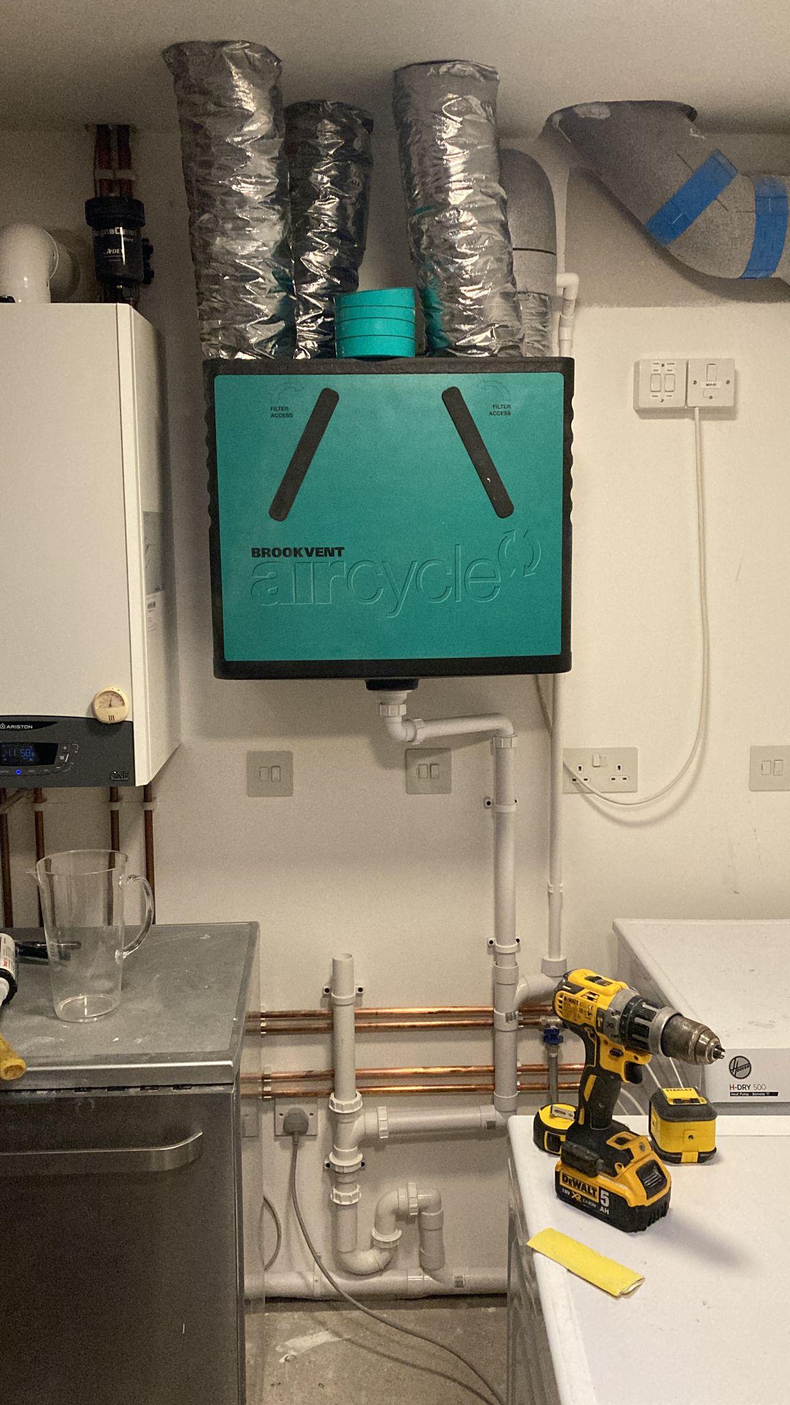

There’s a dry trap for the big condensate, but nothing has condensed yet , I’ve been checking, the smaller condensate takes whatever runs back down the extract , i angled to run inside rather than drip outside , this drips down and I’m using the trap right at the bottom to stop any smells , this is always kept full of water from the washing machine and it’s also in the extract pipe so any smells will go outside anyways , I hope -

Originally it was going to be loft mount but then changing filters would do my head in and the in and out would be close to chimneys and smoke, and the condensate was an issue as I knew the upstairs bathroom was getting moved downstairs, so yeah I didn’t have motivation to complete it, but new extension out the back made us gain a utility room between new extension and the house , it made sense for the in and out through the wall, makes sense for condensate, made sense for filter changes, just made the ductwork about a million times harder getting it up to the loft but hey Ho I’m sure I’ll get there in the end! All ducts were taped up when left and the unit had protective caps on it -
