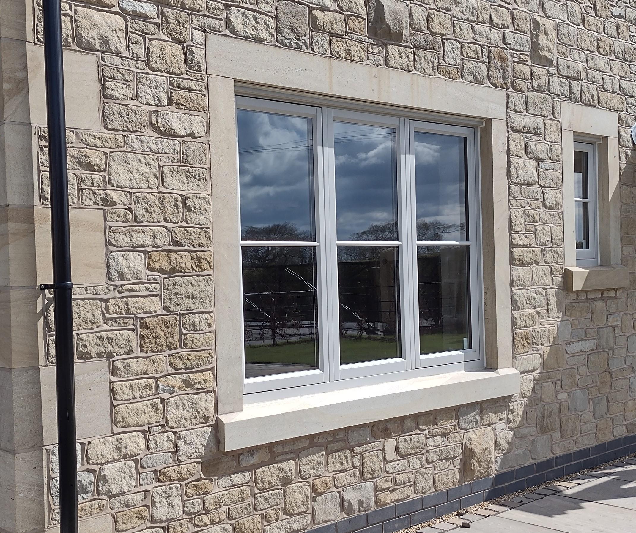

Anyone have any thoughts on my second query about window frame drainage? This picture shows an example of what we would like to achieve (ie no upvc stub sill), but there's no sign of any window frame drainage. Have they made a mistake or am I missing something?
