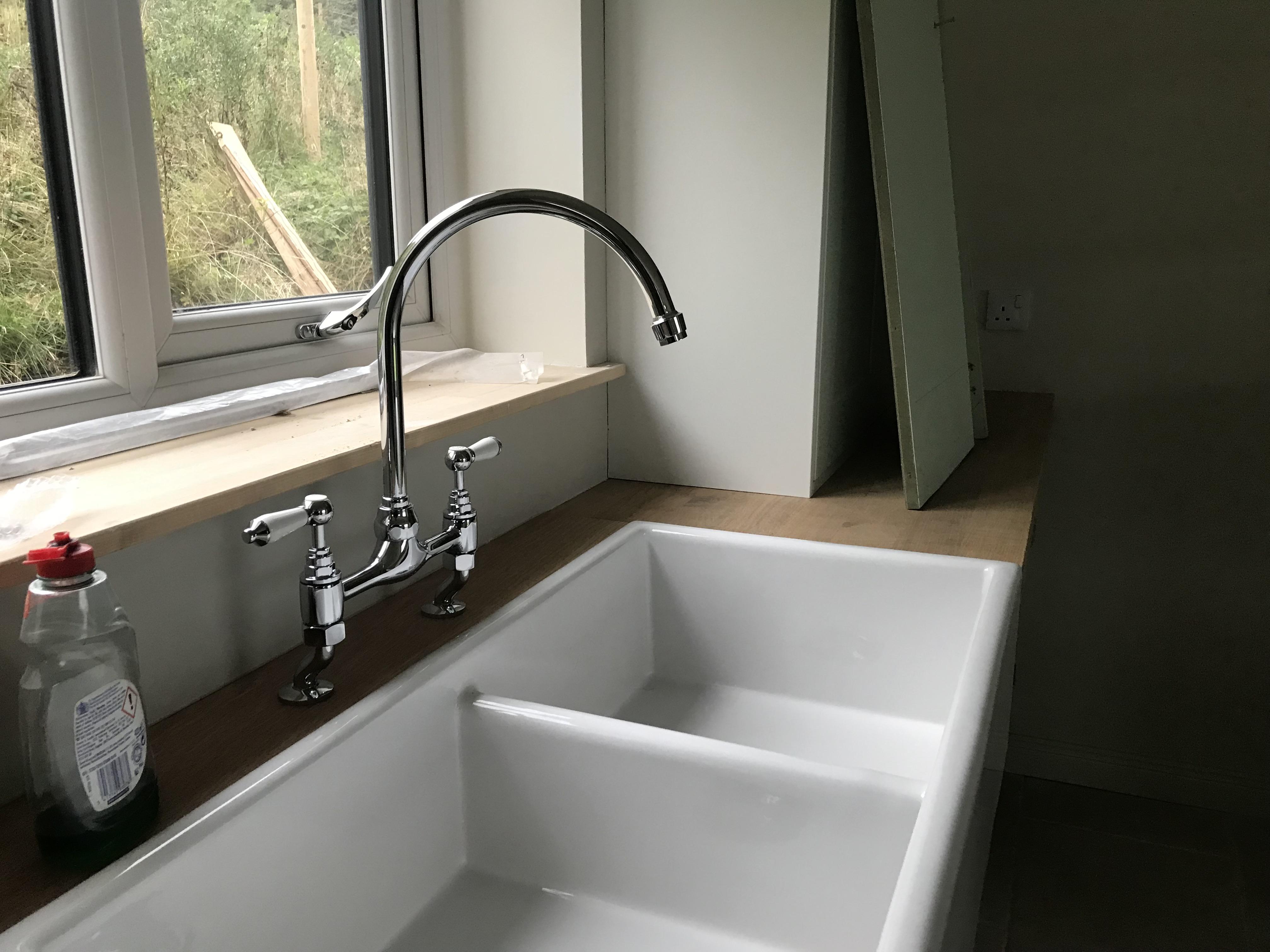

This morning him indoors broke his 5th glass this year, we are about to move in to our house and I fear for the sink. What bowls, bottom-liners or anything else have folk used to preserve their Belfast sinks please?
