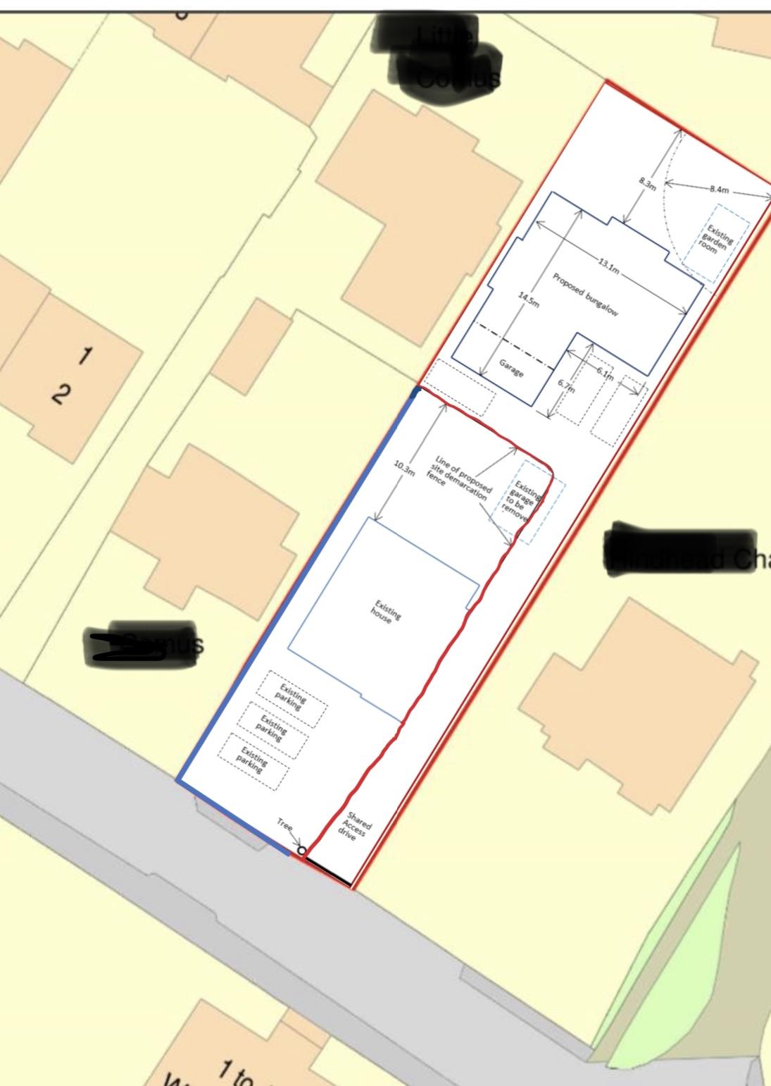

Hi all. I have a preplanning meeting over Teams on Wednesday to get advice about whether building a new house in our back garden would be feasible. I have just provided a current and proposed site plan I mocked up for now and would like them to advise on height, design, position etc. I also included a design and access statement referring to all relevant planning regulations. does anyone have any advice on important things to ask at this stage?

I genuinely don’t know where any services are! I just know water is by drive and sewer in front of garage. See attached plan. -

I think utilities should be ok. I know water comes from the front of our current house so that could easily run through, but not sure about electricity. Architect I spoke to that came to visit didn’t seem to think it would be an issue when I asked. no idea on sewers. I know a new soil pipe we had was going to be connected to a drain right in front of the current garage which is actually behind our current house (see previous posted site plan) so that would only be 10m or so from the new proposed dwelling. No issue with access as obviously we own the whole site. Maybe there’s something I’m not considering though? -

Thanks all. Definitely not rushing. We have 4 years to actually move in as that’s when our current fixed rate mortgage deal ends. I have attached a proposed site plan I created to go to preplanning with. Any thought on shape, position welcome. Worth noting that the NE corner has a tree with TPO and the ground raises quite a bit at this point. Will attach photo out of current back window to show site (separate post due to file size) -

Thanks both. I’ve just spoken to a broker actually and it may be that a self build mortgage is a safer option for us. Just need to weigh a few bits up and maybe beg to the bank of mum and dad and offer them a decent interest rate! in terms of copying neighbours, I certainly don’t mean building the same as them (it’s a horrible retirement bungalow), but more the footprint. It’s actually just the most sensible shape and maximises the house size whilst keeping a sensible shape garden and avoid a root protection area. It also allows for a turning circle as cars need to be able to leave in a forward gear. If anyone’s interested I’ll happy pm the site plan over for you to take a look at but would prefer to keep out of the public domain at this stage! -
