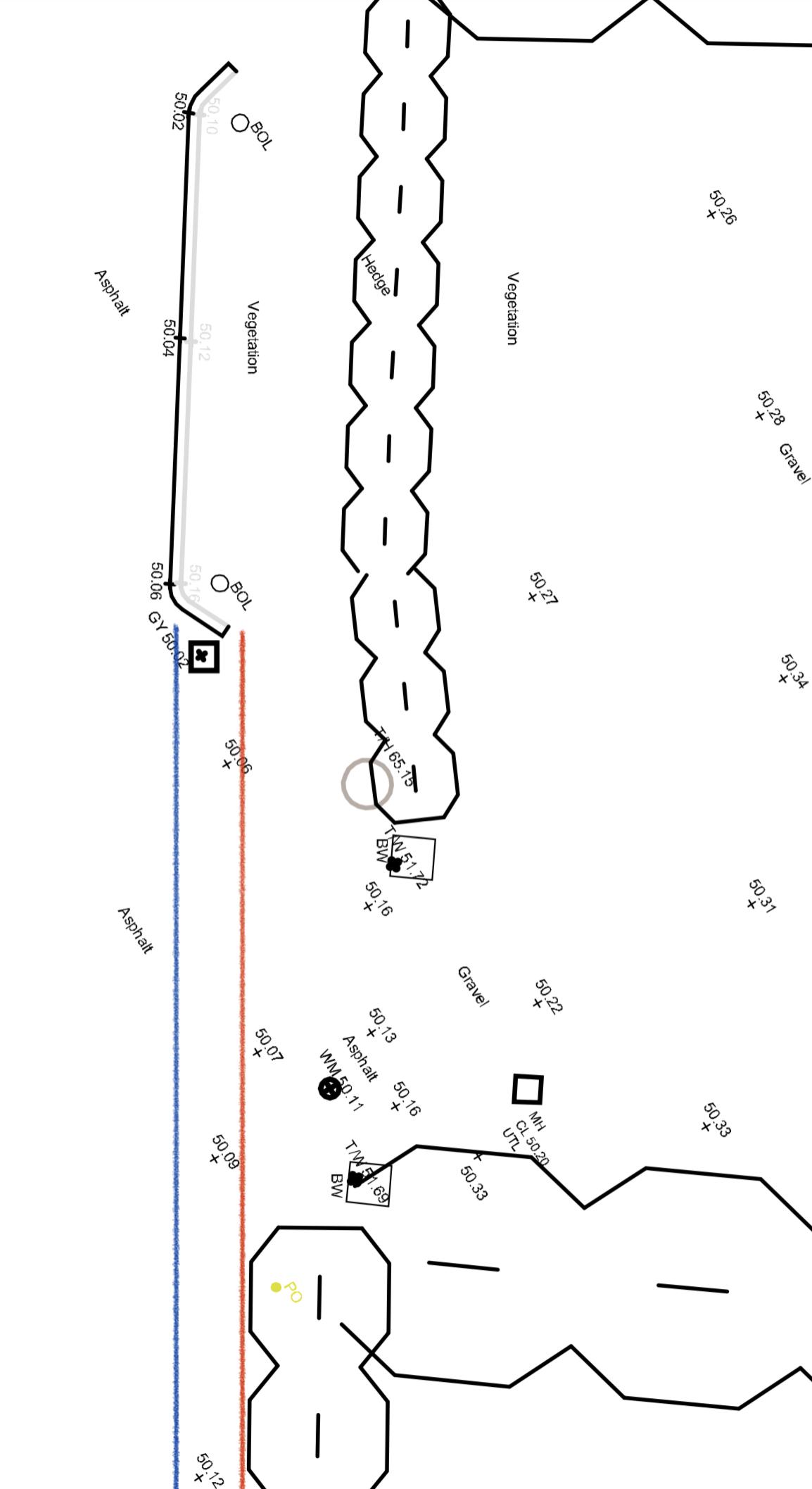

  1. It is. However, I was under the impression it was ‘free flowing traffic’ they had to measure. Given the fact most traffic is waiting to pass through in turn, it is not free flowing. Also,as it is already a 20mph road, they won’t lower the visibility any lower than 25m either direction (as is my understanding), so a speed survey can only go against us I think! our main hope is that the context of the buildout being there and therefore the ability of cars joining the highway to nose out into the road further than normal and therefore improving visibility in both directions. It’s a fairly unprecedented situation (as far as one can google anyway!) so I just wondered if people felt this was a valid point. I imagine it will just come down to the highways officer on the day!
  2. Thanks everyone for your input. I have a slightly odd situation in that even though technically the current splays cannot be achieved within my land (due to a hedge right on boundary of next door - it’s not encroaching highway, I’ve checked!) when looking left out of drive. However, there is a traffic calming ‘buildout’ right next to our driveway, which accompanied with another directly opposite makes it almost impossible for 2 cars to get through separately. I’m banking on the fact that the x distance (which I can hopefully blag to be 2m not the 2.4) can be measured further into the carriageway (the blue line on my picture) as the buildout sort of acts like a verge. The official edge of highway is the red line. Does anyone have any thoughts??
  3. Hi there we are looking to build a new house in our garden and use the current driveway as the access for both houses. The current driveway goes straight onto a 20mph C road. the current visibility is not great (we don’t quite get the the nearside kerb 25m when looking left). As far as I understand, highways are only consulted when there is a change to the current access when it is under 5 dwellings. I understand it will attract a little more traffic (current house is 4 bed and new one is 2 bed) but the access remains unchanged. does anyone have any experience with this sort of thing and how much scrutiny we are likely to face? Looking at applications in my area, some seem to fly through with awful visibility and some are required to show very detailed plans that already have fairly good splays. Any advice welcome.
