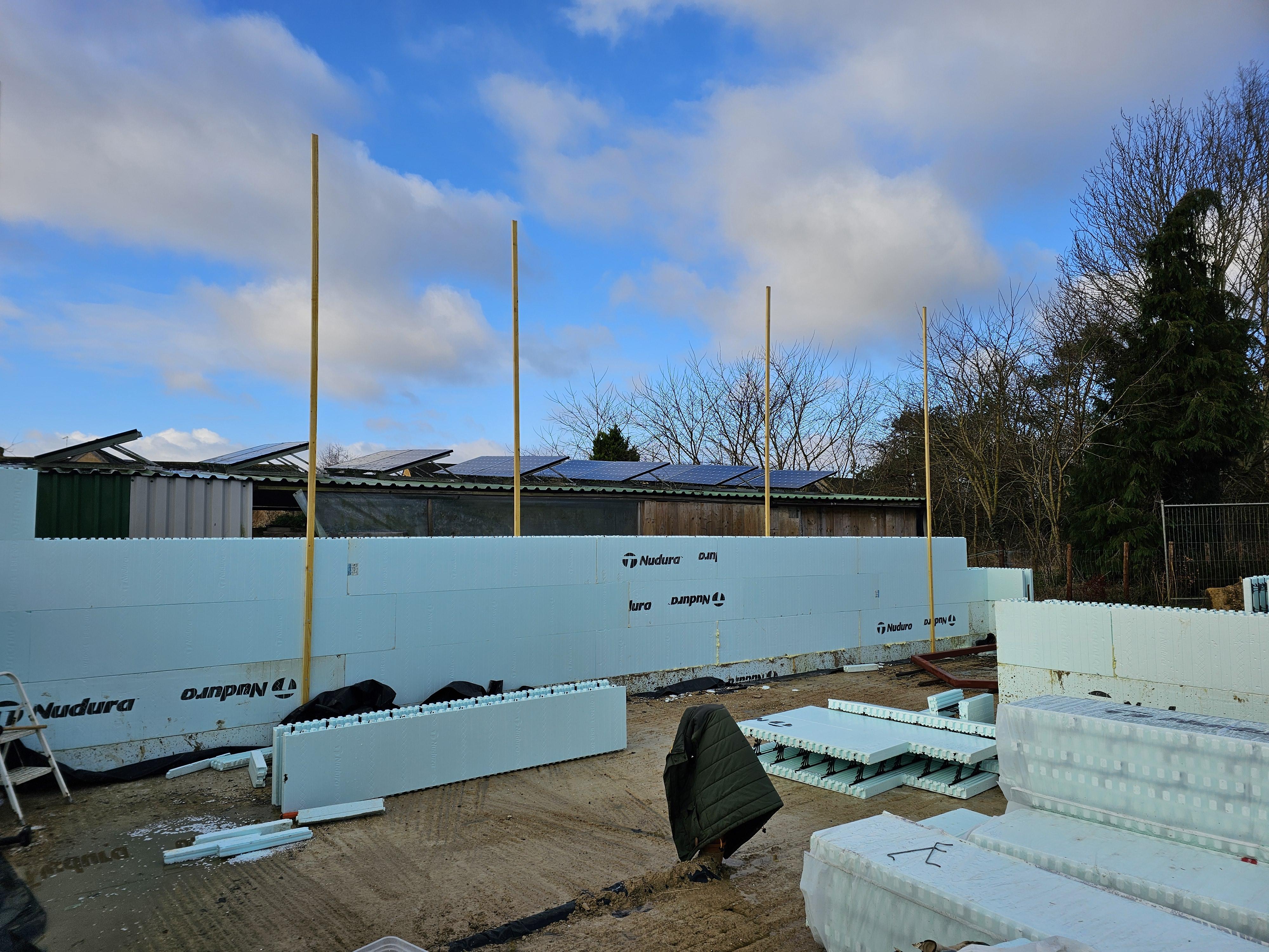

  5. Well we had our big pour today... Nervous all week. Had a big blowout on the corner...twice! Same corner, 4 blocks gone. Others bits stayed up when I thought they wouldn't. Will have to do the other walls another day. Learnt alot today. I would definitely recommend strap, brace and brace the corners again and again!

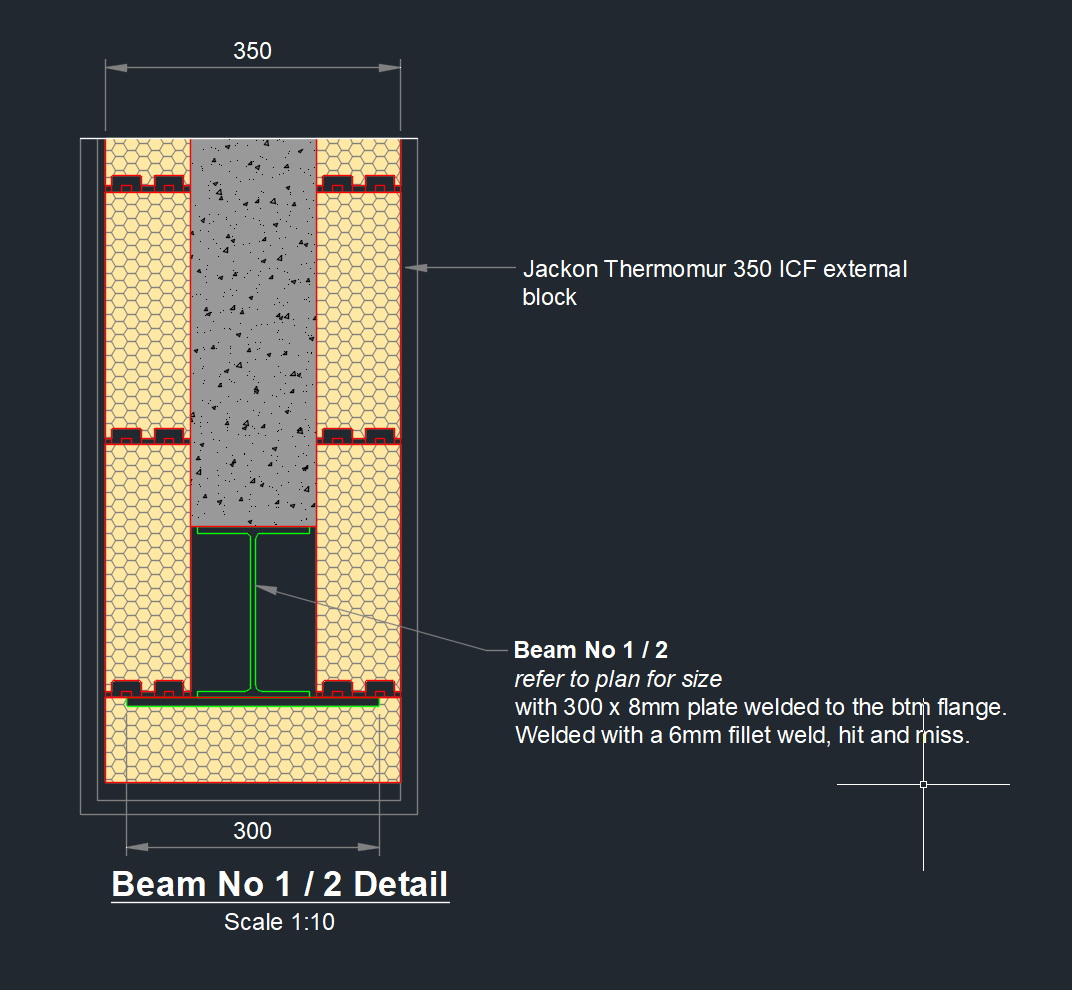

  7. My S.E has overspecified IMO but it's his head on the block so..its the way it is. The steels span big openings, over bifolds/sliders, garage opening so over 4.5m Cheers for the tips!
  8. Hi All, getting there slowly, now the bit I can't get my head around! Using Nudura, our S.E. has specified this..for openings. Above will be the nudura block and walls. How do I do this? Any ideas? I will need to prop it obviously but surely the weight will crush the EPS underneath? Cheers

  17. Hi All, No it's not sprout related... We have been progressing well with the Nudura but this wind is causing havoc. We haven't got scaffold or alignment system yet as we weren't that high but getting blocks up to the near joist level and the wind is just blowing it over or off the DPC block. Would the scaffold/alignment really combat the wind? Any tips? I thought about bracing it vertically to the concrete filled DPC level to strengthen it Cheers
