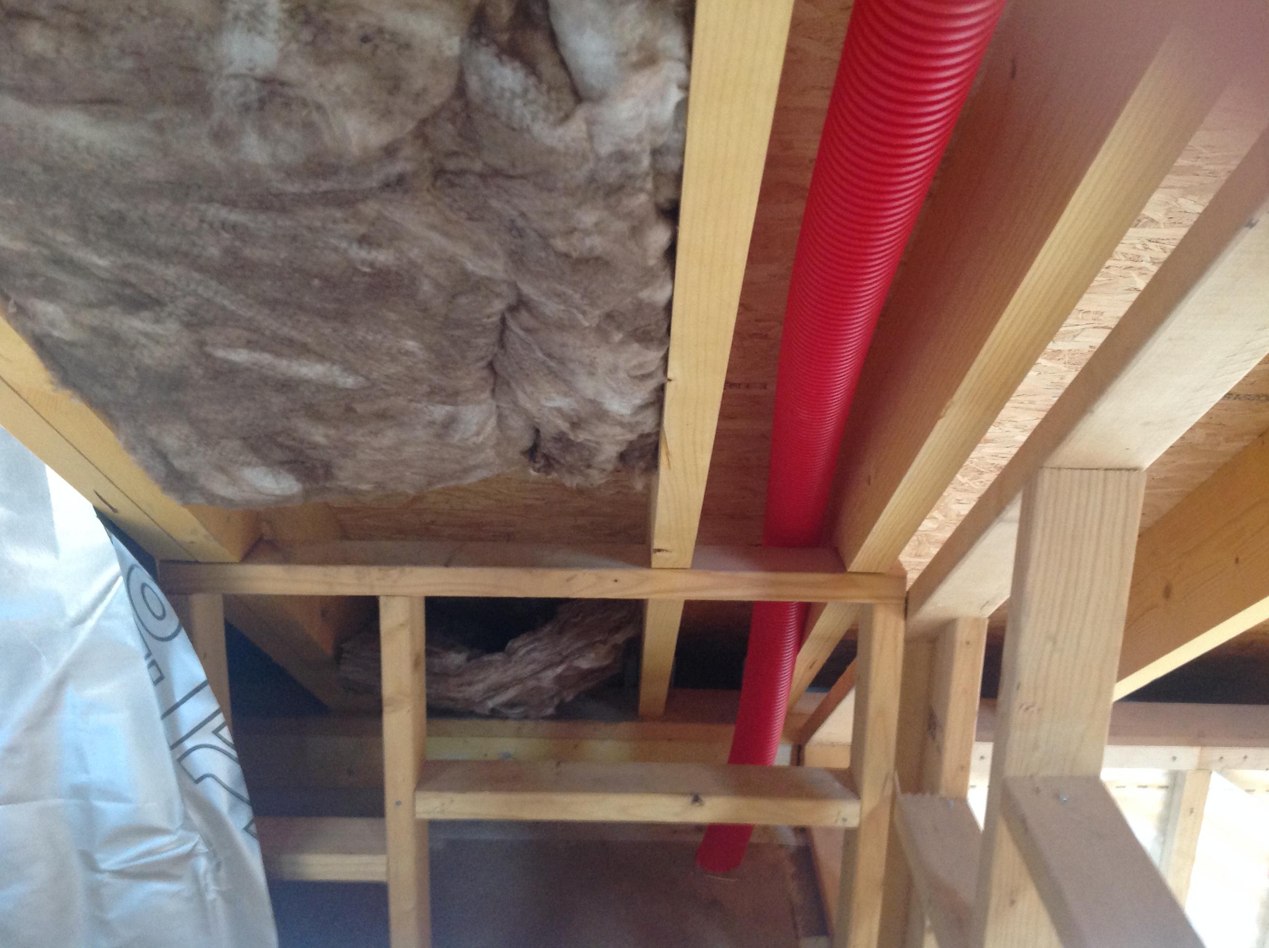

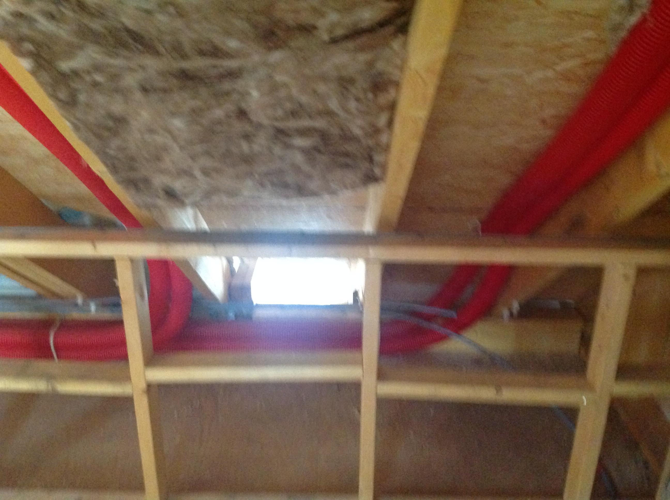

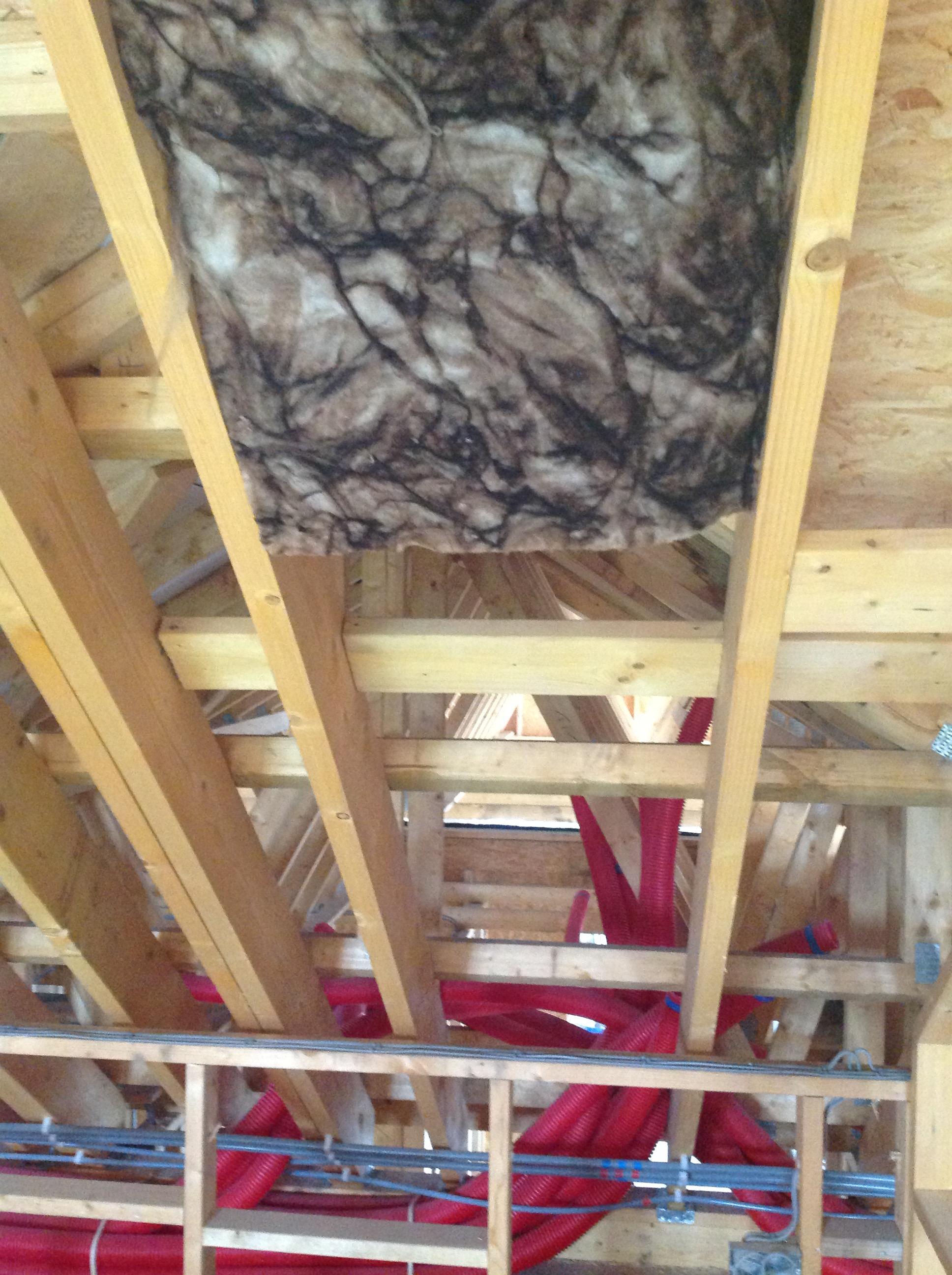

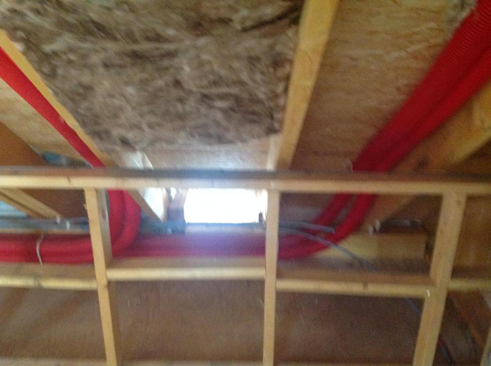

Regular Member (4/5)

  10. I get so,confused over warm roof cold roof, the area im insulating,is as im led to believe a warm roof ie open to habitable rooms was advised to not bother with batten and could insulate up to sarking as a breathable membrane is being used, the area beyond where all the ducting is going, is what i thought a cold roof so boarded below and will have 2 huge layers of rockwool over rafters before boarding. see how easily im confused is your roof space habitable? And why is it a cold roof not a warm one lol

  12. Only tied with old electrical flex at present just to neaten it up we up to 200 of duct and not,finished yet,, in between rafters ive put a layer under duct before putting some over the top
