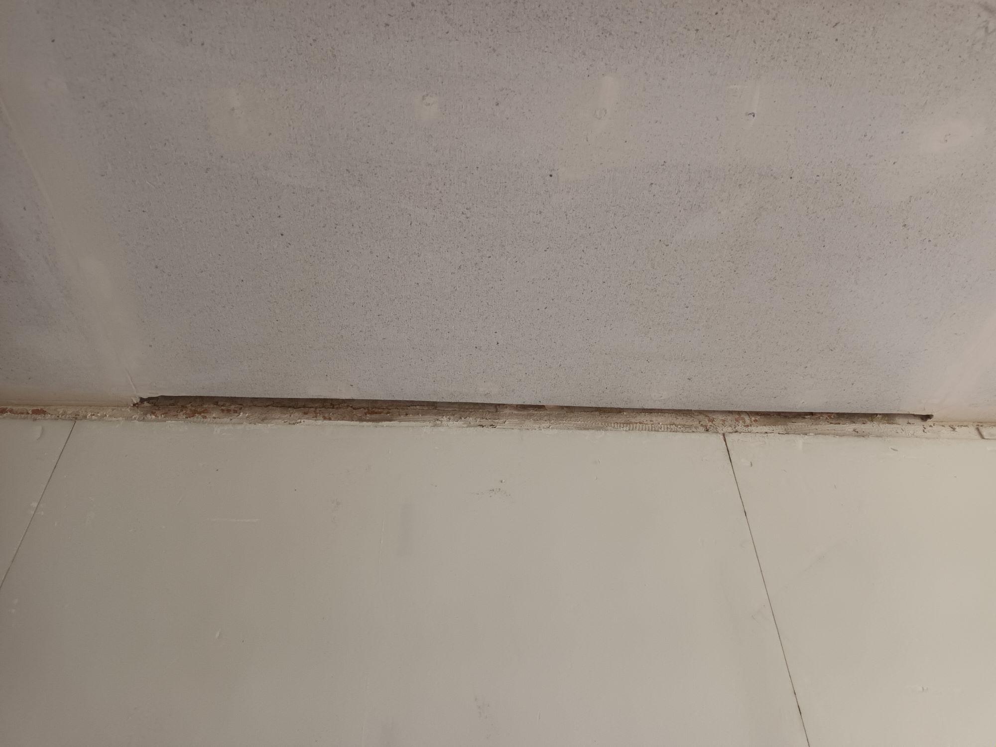

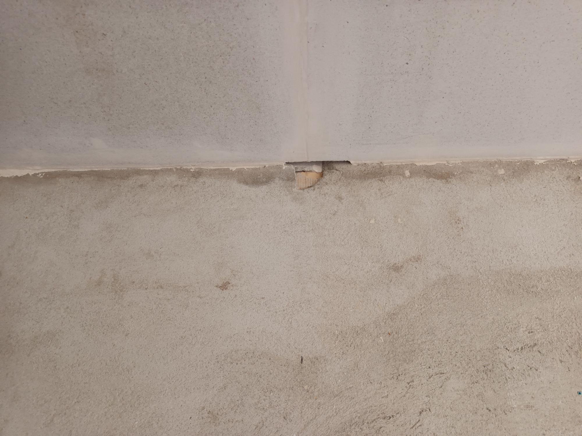

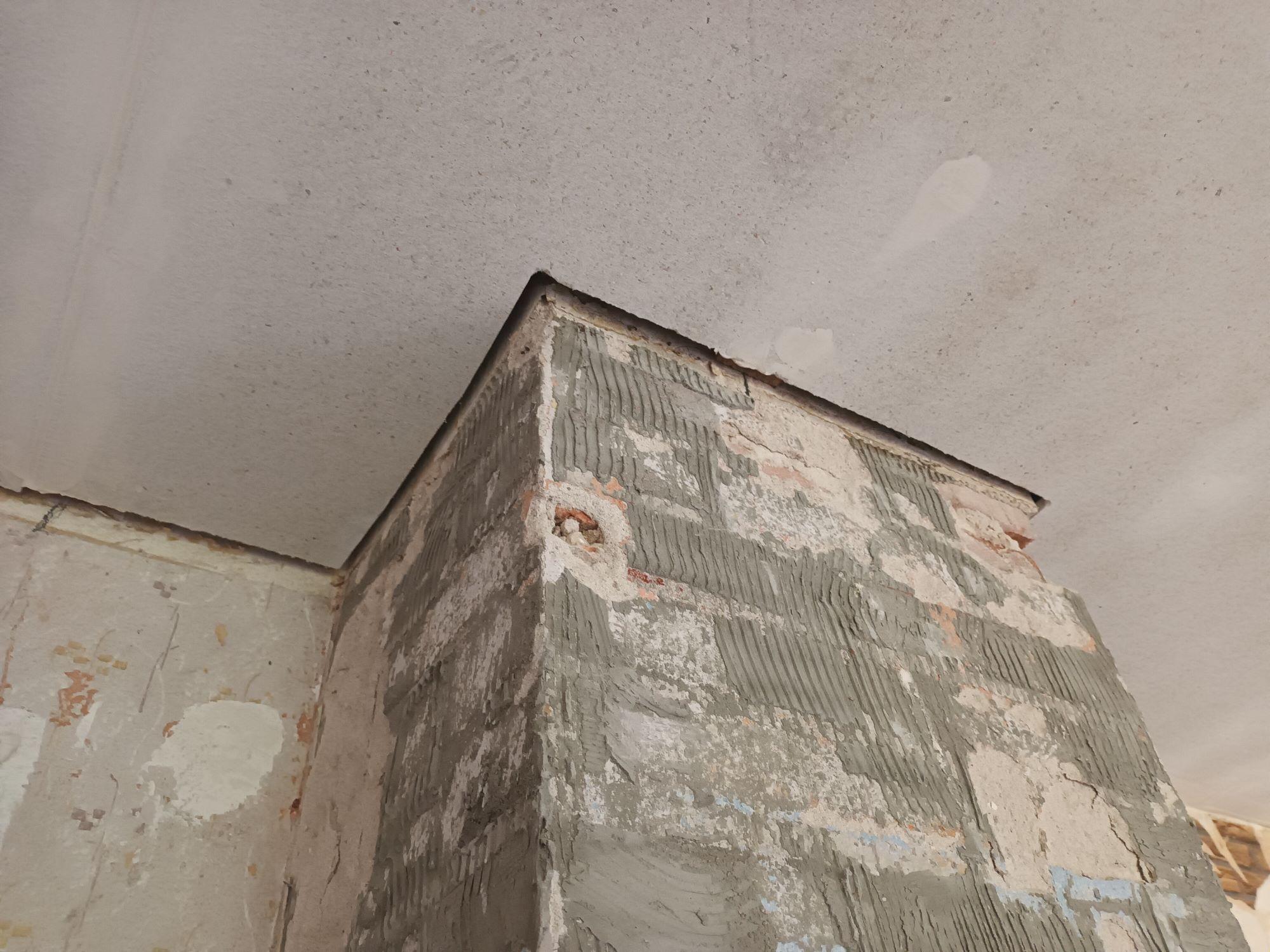

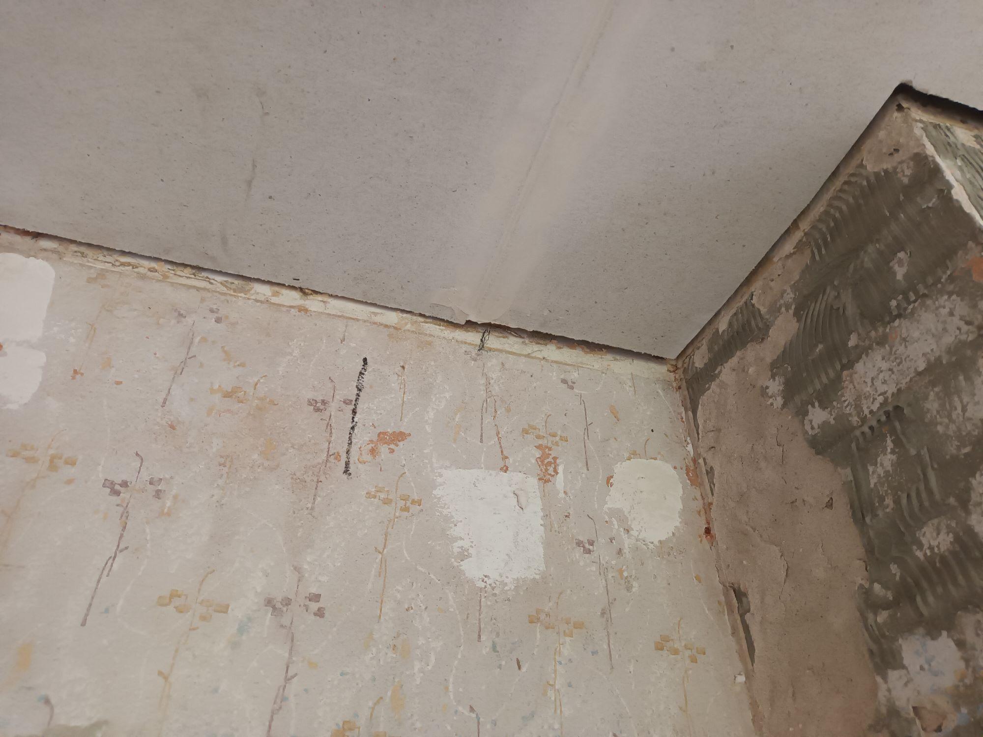

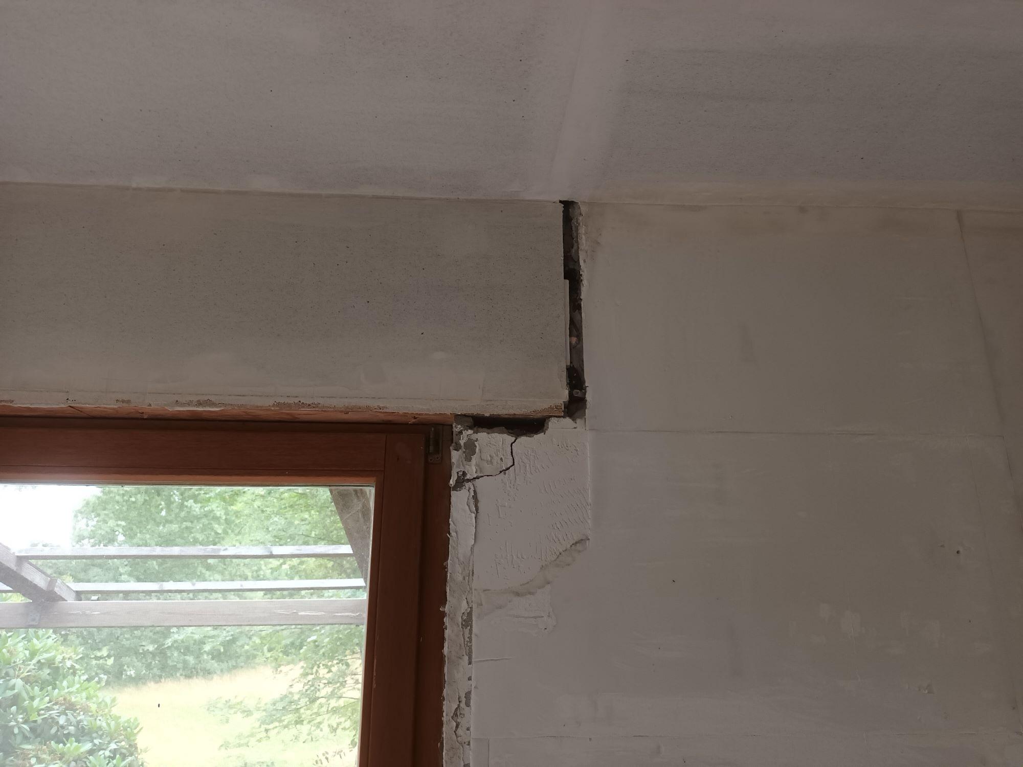

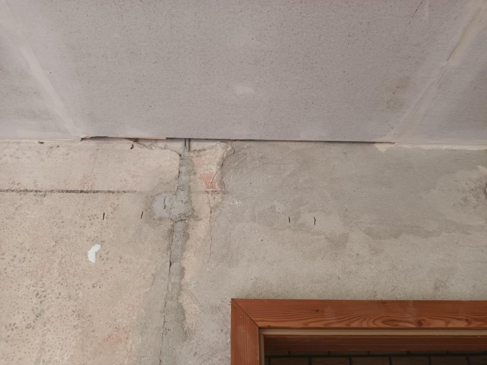

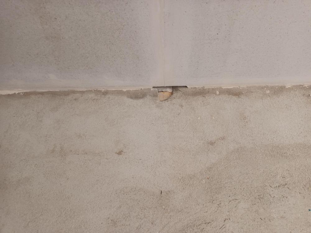

Filling 1-3cm gaps between ceiling and wall
vagrantly3893 replied to vagrantly3893's topic in Plastering & Rendering
All good reasons. My step father wanted to use it and considering I had no experienced I went with it. We used a board lift which helped, but positioning it accurately so there is a 5-7mm gap between boards for the filler was hard. It's also possible to glue the edges instead of using filler which would have been easier. I also like that for a quality 2 finish (wallpaper), we only need to fill the gap between the boards. No taping and feathering with filler. I think I'll try plasterboard for another room to compare the process. -
We live in Germany. Anything else isn't allowed. -
Why not use it on a ceiling? -
We plan to wallpaper the ceiling with wood chip -
Those are actually Fermacell boards rather than plasterboards. You can hit them with a hammer and won't do any damage, so the boards themselves are very tough. The ceilings and walls won't be plastered. Elsewhere I've been recommended expanding foam. -
I recently plasterboarded my ceiling and I am left with some larger gaps between the edge of the board and the wall. How should I fill these gaps?

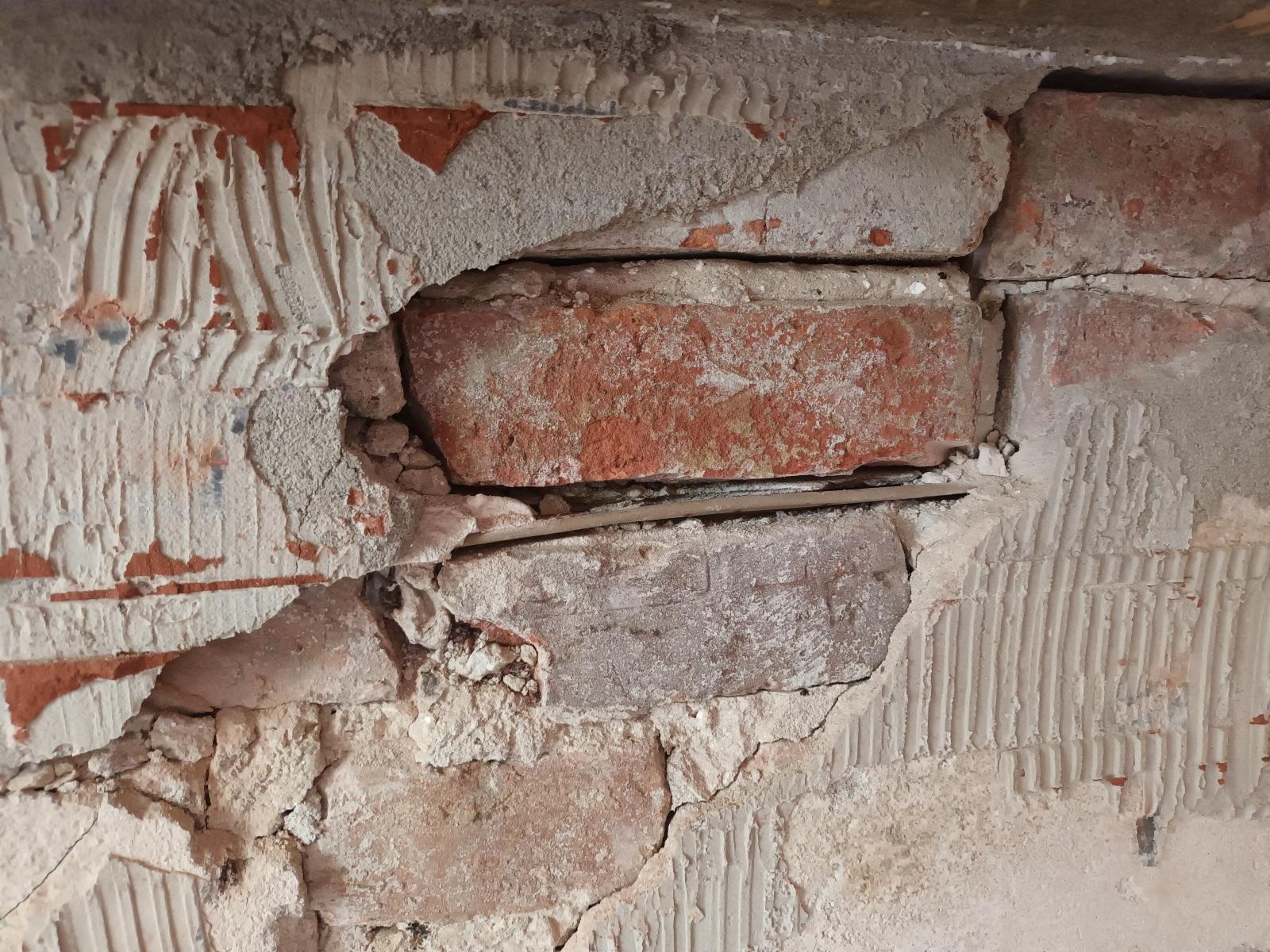

Mortar between loose bricks before plastering
Also that wall has a radiator so I wouldn't expect any issues from cold or damp -
Thanks for the detailed response. Yeah I think the sill is concrete but I'm not sure if it goes through to the outside of the wall. I'll check later. -
and then plaster over the top -
vagrantly3893 posted a topic in Plastering & Rendering
a couple of the bricks are loose. should I first use some mortar between the bricks and the plaster over the top? -

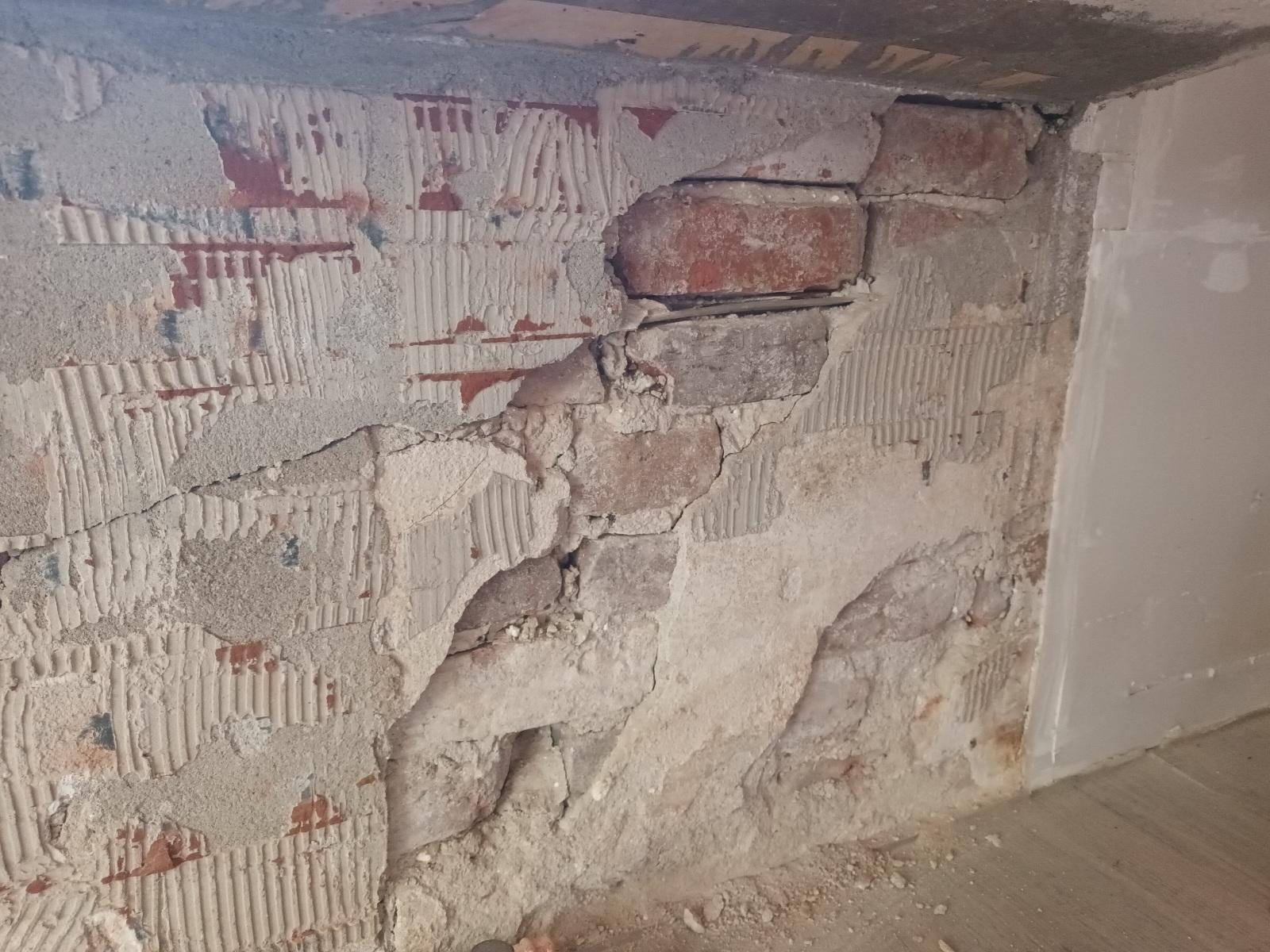

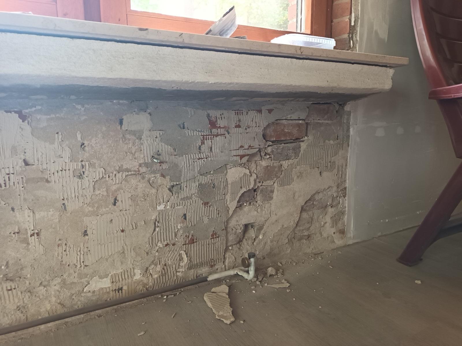

How to make good the area behind these radiators?
What should I skim it with? Can I just skim the area where the tiles were removed? -

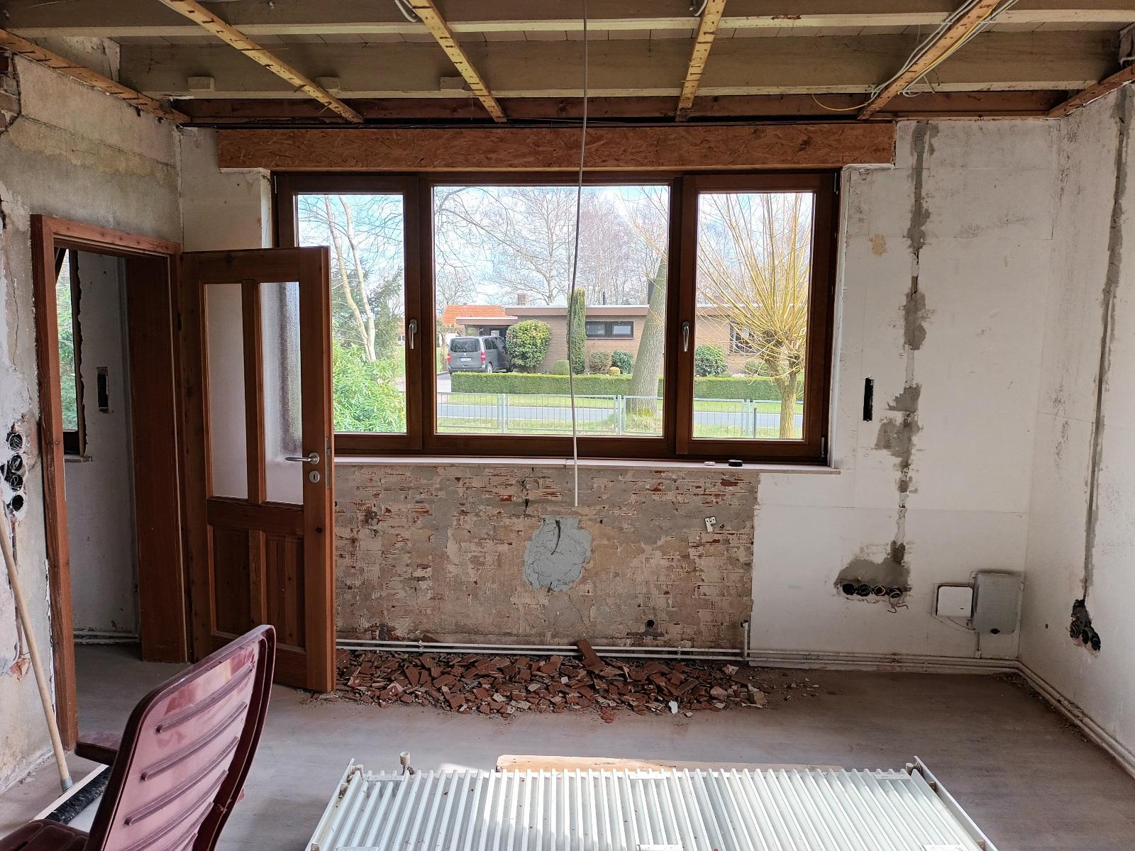

We removed the "brick" tiles behind these radiators and want to make the wall good and wallpaper before putting the radiators back. In a couple of areas the plaster has blown from the brick work. Mostly however the plaster is still good. As we aren't painting, the finish doesn't need to be super smooth.
