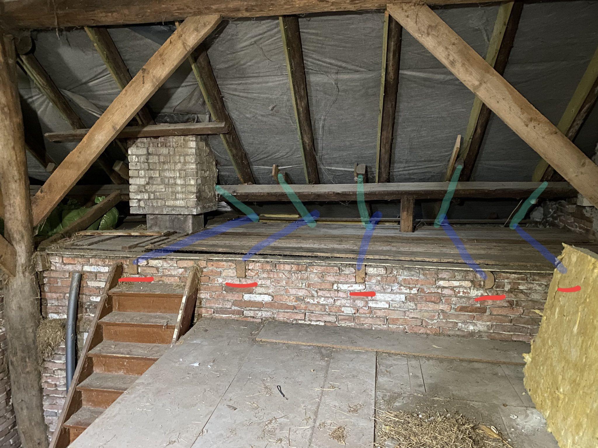

  5. So ideally we want to prevent any air escaping the heated space through the ceiling (and probably anywhere else), because when the heated air escapes, the air cools and the moisture in the air will condense against the wood once it passes through the insulation? 2. Do you have any recommendations for "permanently flexible sealant"? 4. Is it OK that the sides of the sandwich are left open? Do we also have the option to just leave the sandwich open, like you would in an unwalkable insulated attic?

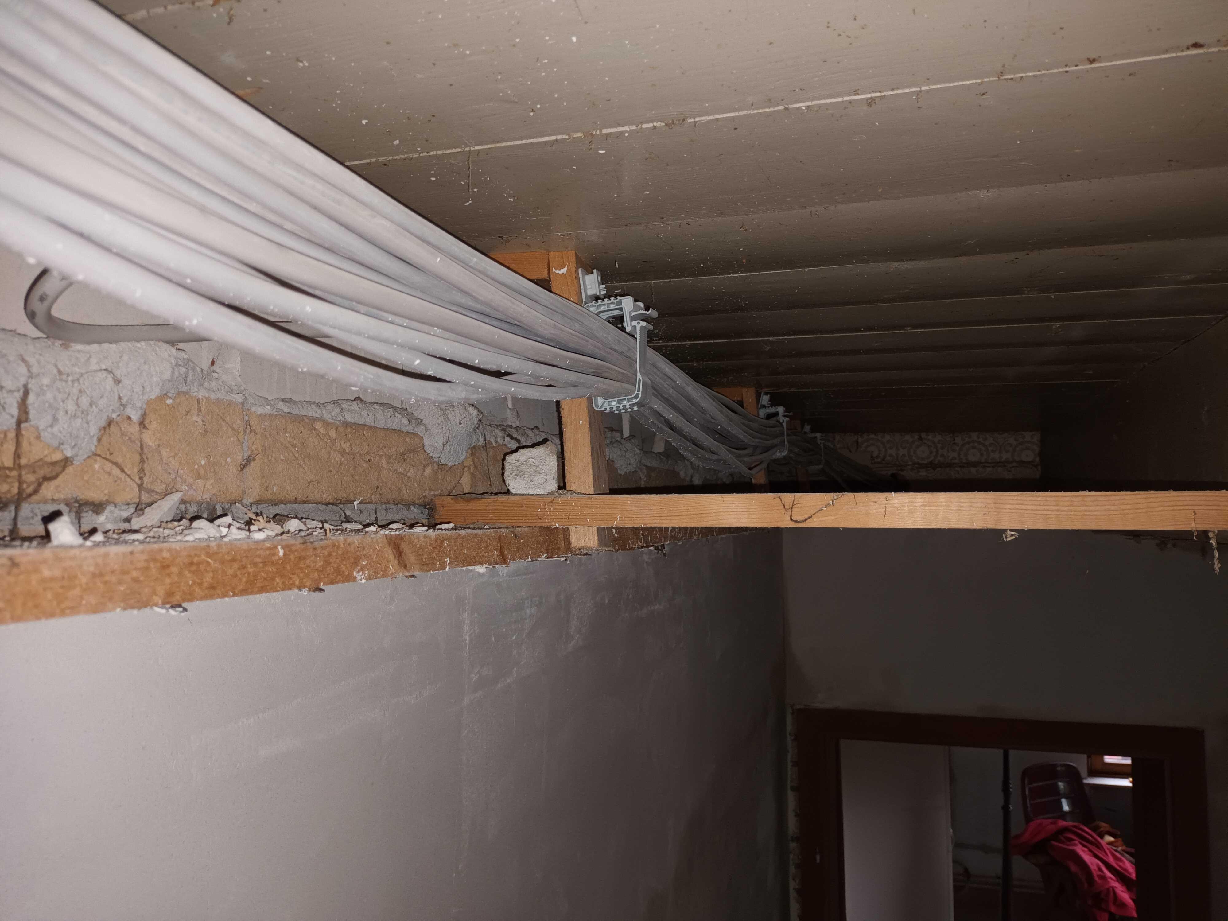

  9. I was quite confused by the existing frame. The first layer is nailed to the ceiling, the 2nd layer runs adjacent to the first, and the 3rd level runs in the same direction of the first. It was stuffed with insulation so maybe it was just to add depth.

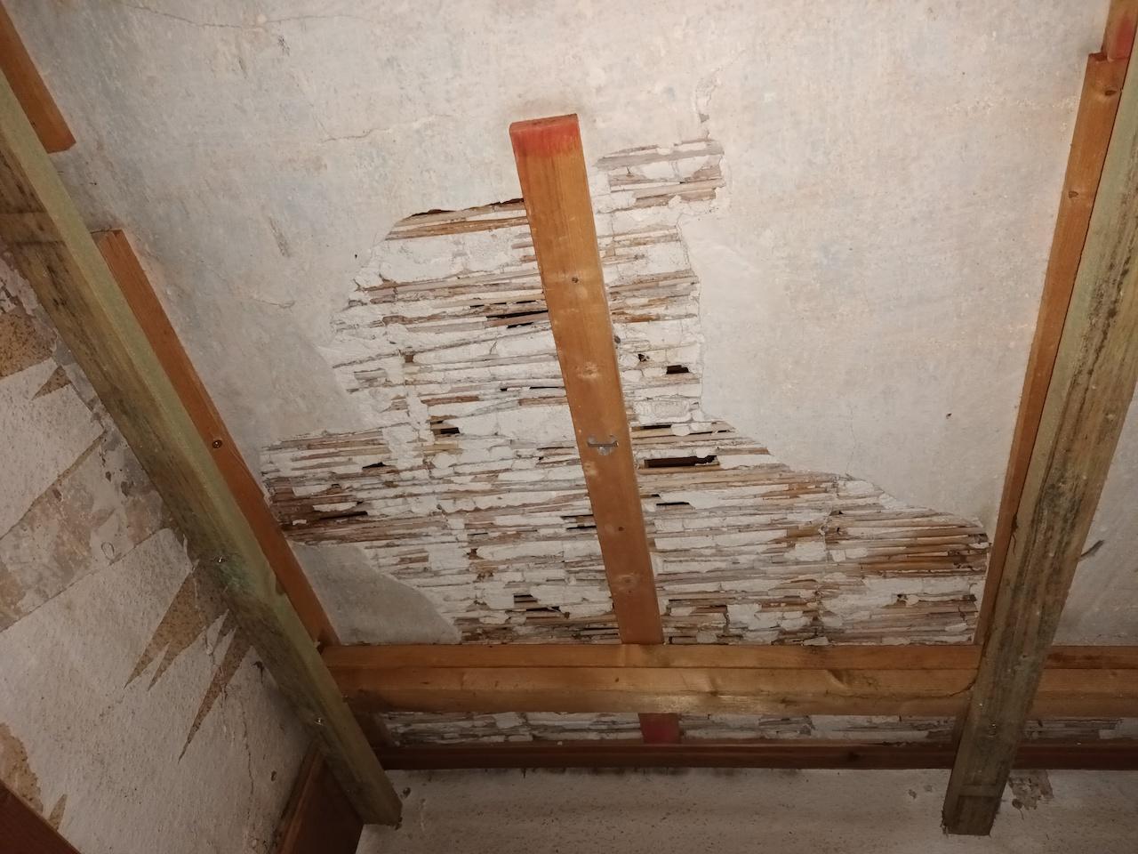

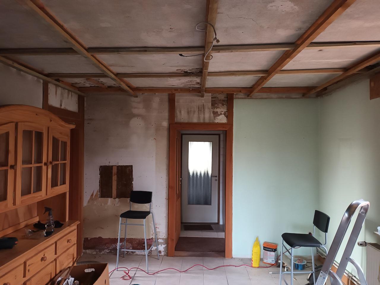

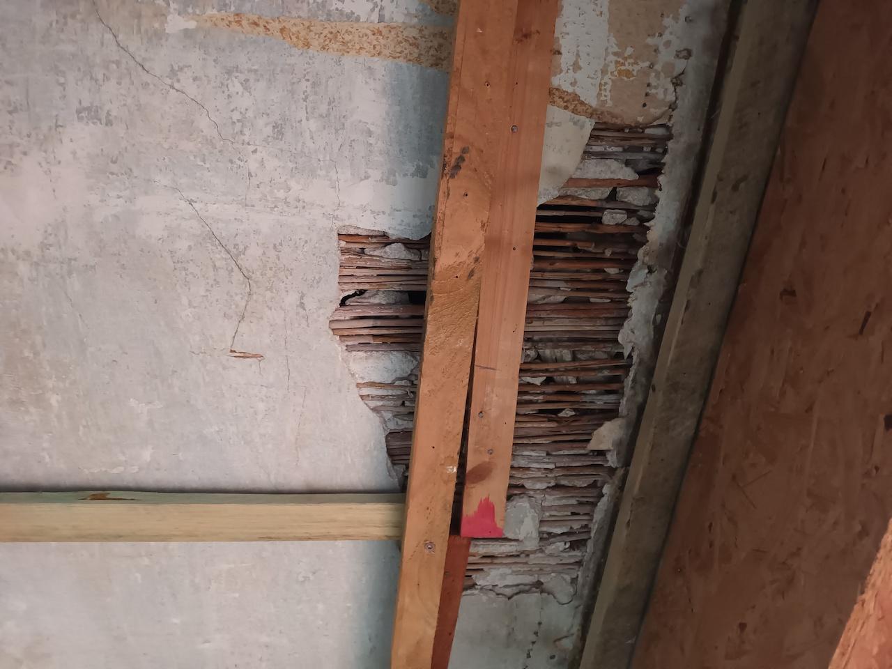

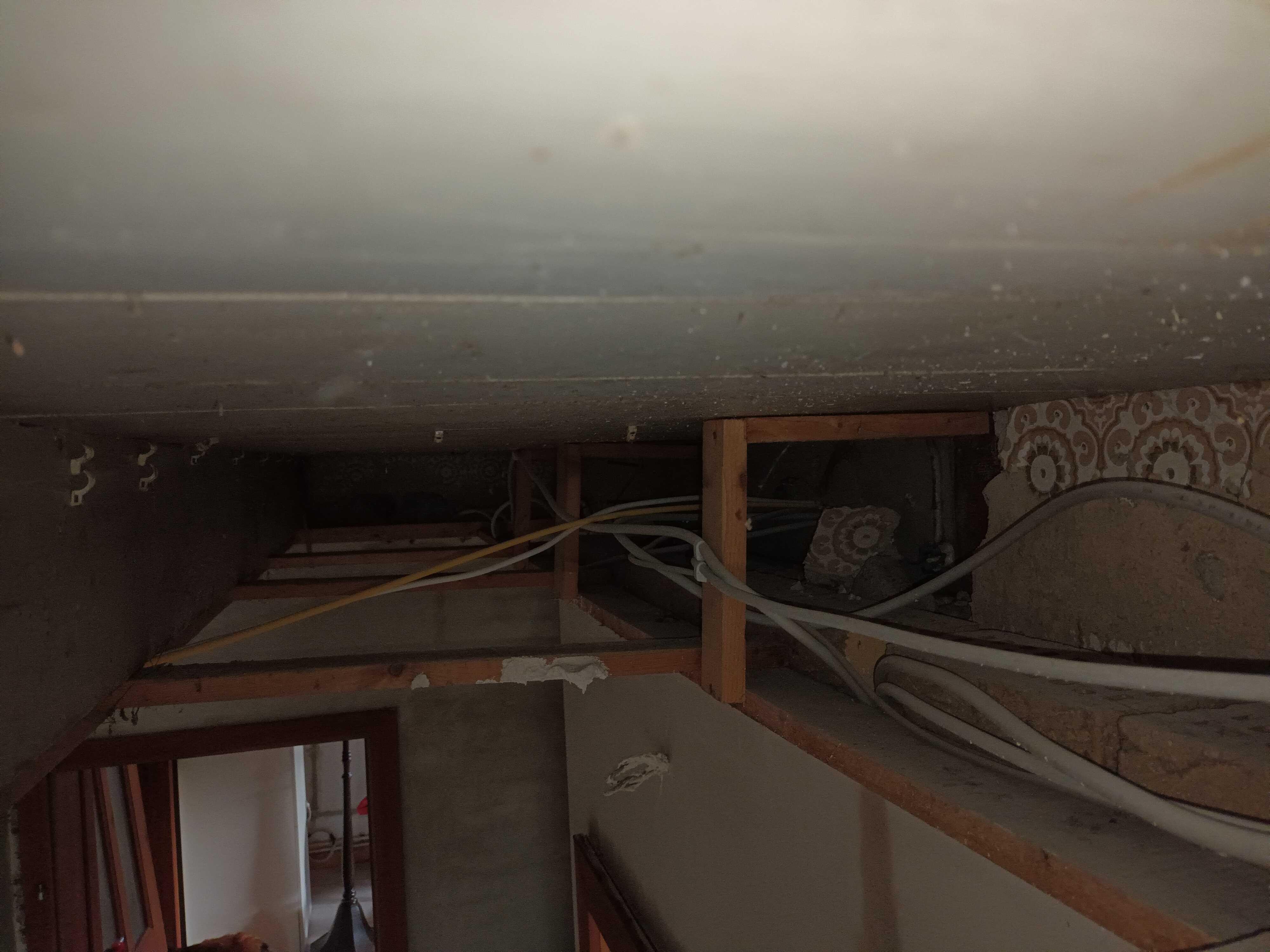

  11. We want to convert this room in to a kitchen. It currently has an old lath and plaster ceiling. It's quite uneven so overboarding directly isn't an option. Could we leave the ceiling in place, remove the wood that is there, install a new wooden substructure by screwing in to the joists and then plasterboard?

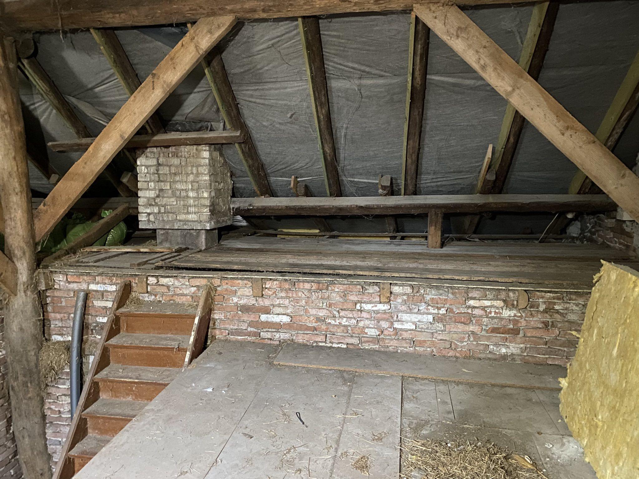

  13. We have a room in our home that was converted from barn space. It is a small hall linking the barn area to the general living space. The room is heated. Above the room is a cold barn. There are 140mm beams running across the room ceiling (highlighted blue) with wooden planks laid upon them. Below the beams is 10mm Fermacell gypsum boards. We are planning on placing 140mm mineral wool insulation between the beams. 1. Should we also place a 2nd layer of mineral wool e.g 100mm adjacent to the first, covering the beams? 2. Do we need to place something above the mineral wool, effectively sealing the mineral wool in to the ceiling. E.g. OSB boards. 3. Do we need to install a vapour barrier?

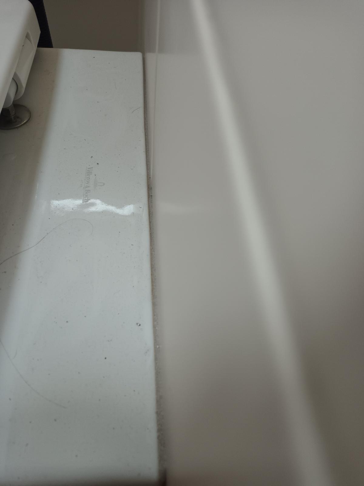

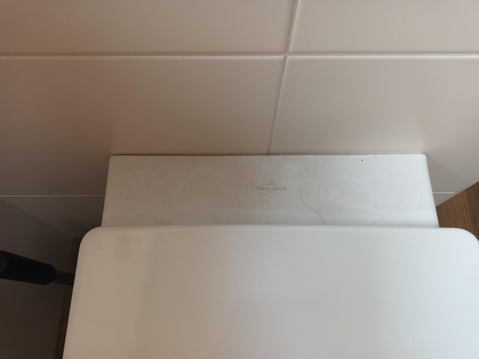

  17. We have a mounted toilet installed and I am curious if there should be some more sealant in the join? Currently it seems like dust and other stuff will get stuck in this small gap and be difficult to clean:

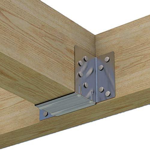

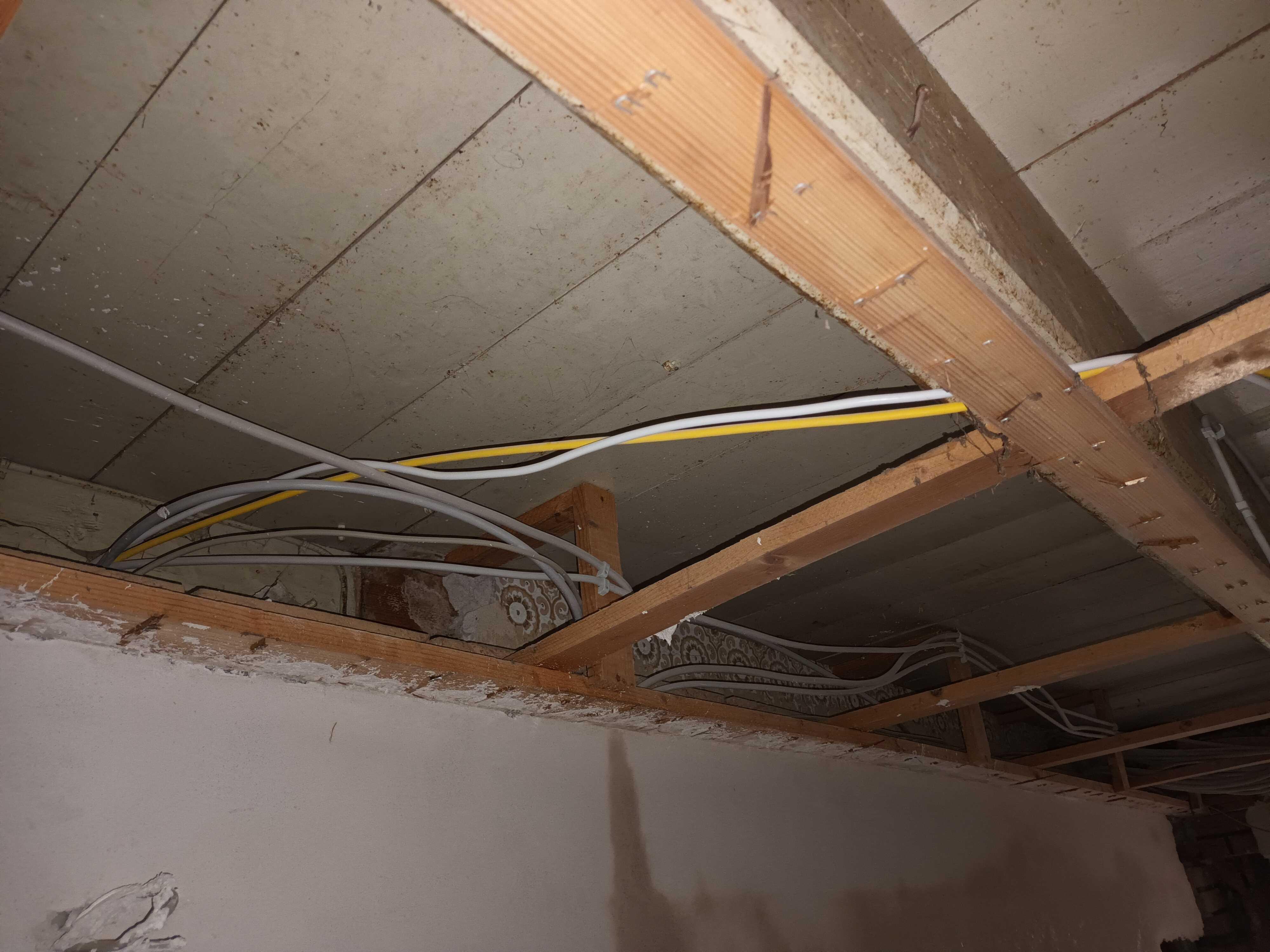

  19. I also found some mini joist hangers which might also work nicely, however this results in the permiter wood and the joists not being completely flush which I think isn't ideal for plasterboard:
  20. I found a video tutorial using your suggested method. On my narrow hallway this should be easy
  21. Would the inset pieces be screwed to the perimiter pieces, with the screws at an angle?

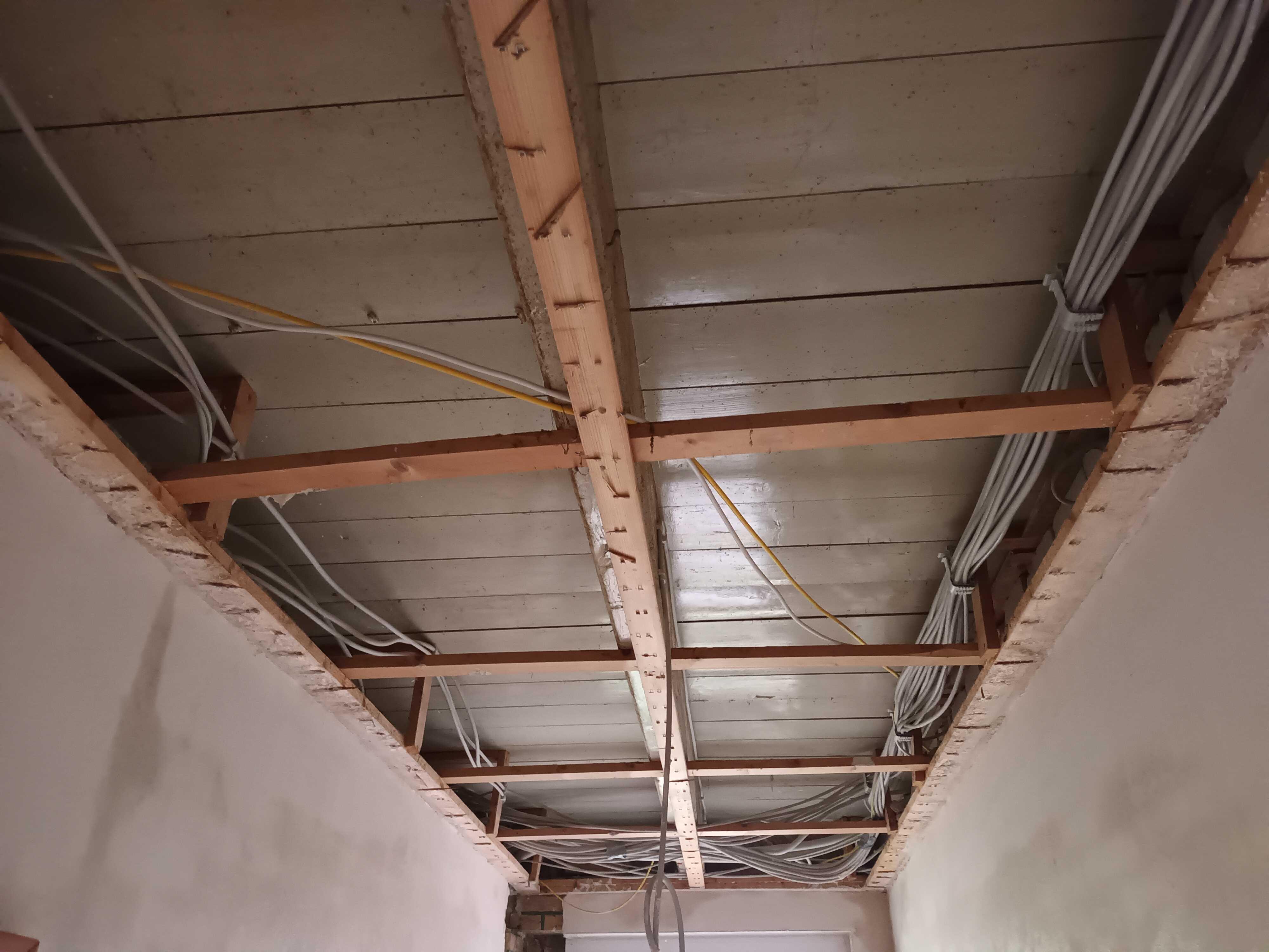

  22. How would the wood be connected? Metal plates?

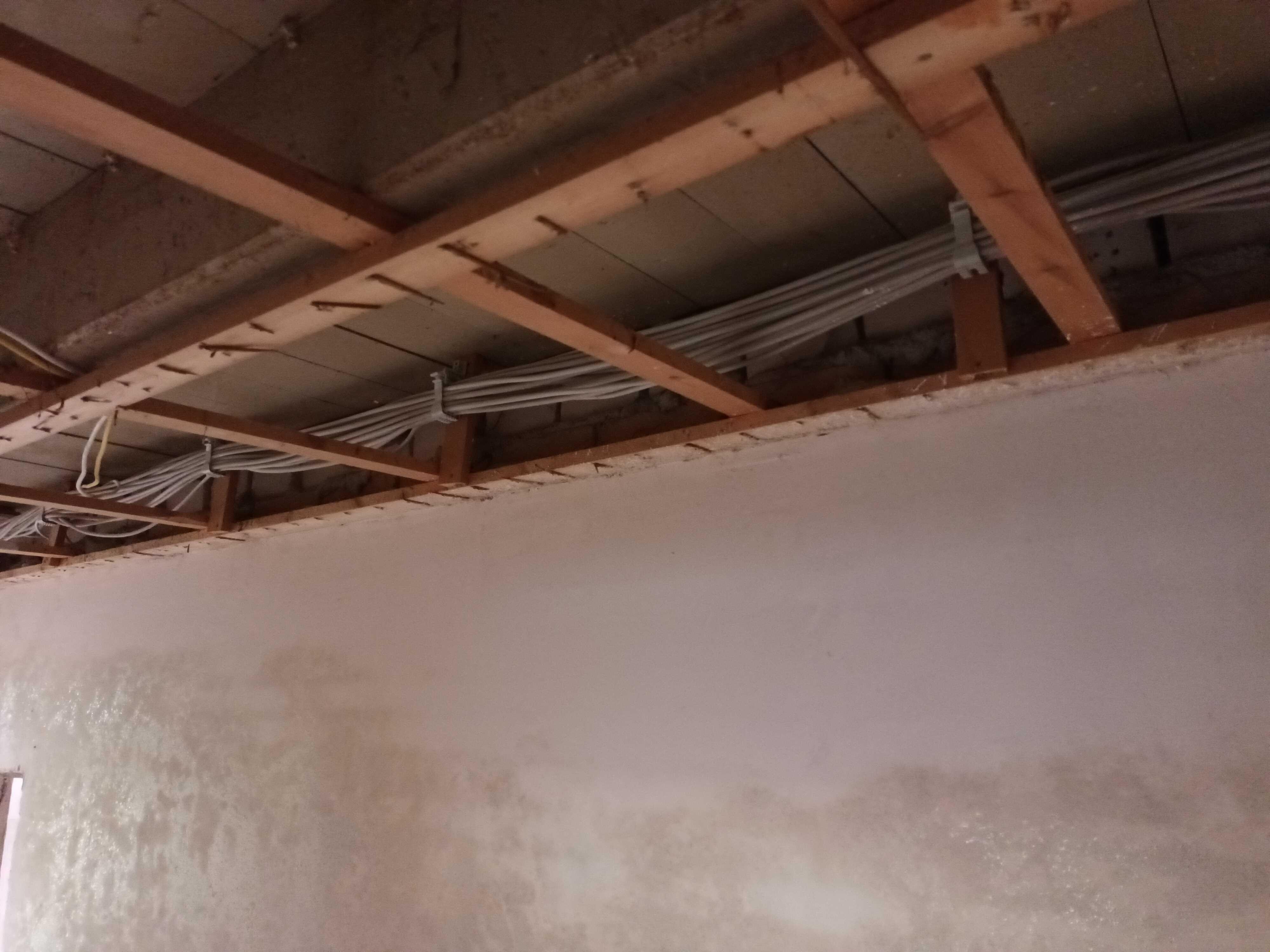

  23. Would the joins etc be fixed to the bottom of the perimeter 2x2? E.g. the top level would be the 2x2 perimeter, and the level below would be the rest of the substructure that the plasterboard is fixed to?
  24. Ah that's an interesting solution. Someone else mentioned using metal framing which I'm not familiar with. I think whatever I do, I'm going to have to fix something in to the brickwork for support.

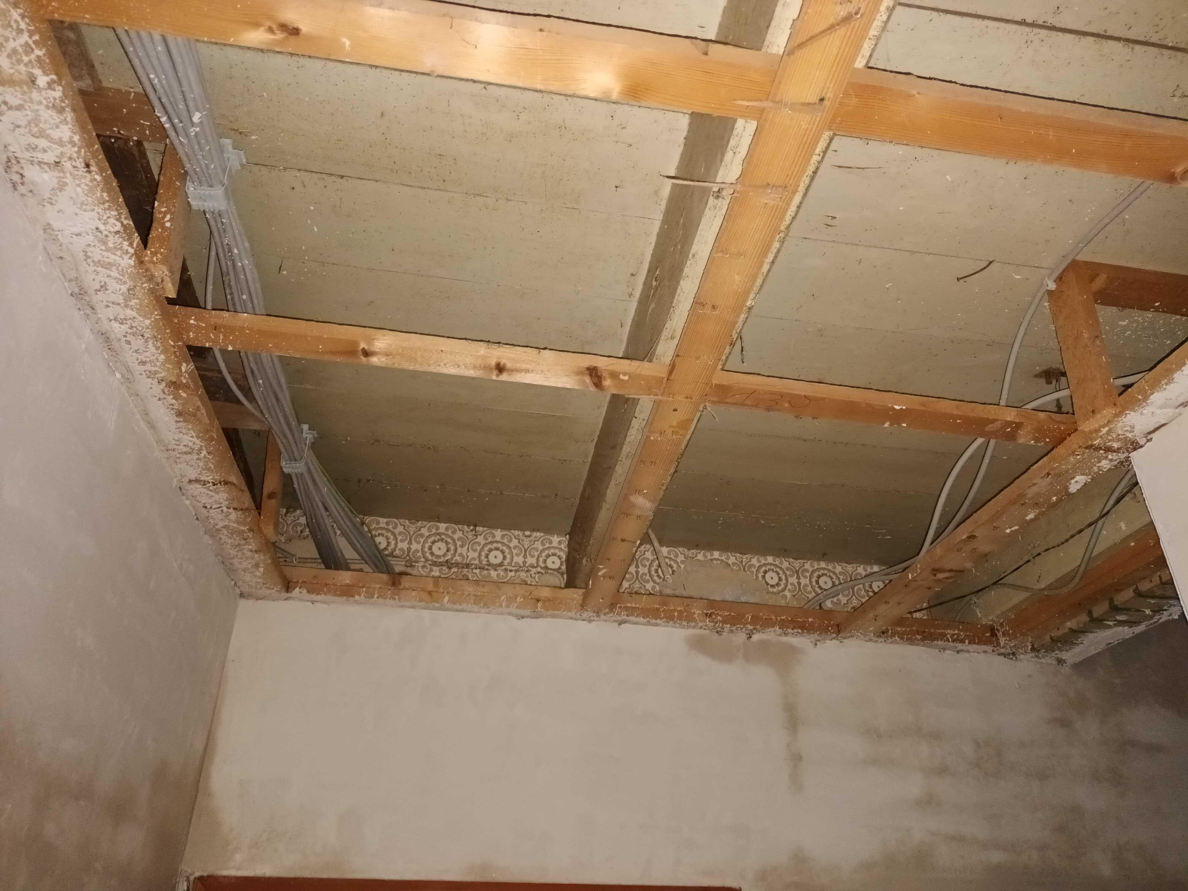

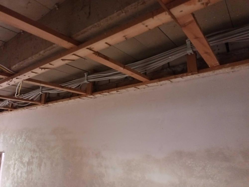

  25. We removed the light wooden slats ceiling in our hallway to reveal the substructure. There is a beam A running the length of the hallway. Battens B are secured adjacent to beam A. Battens XY are then secured to the ends of battens B and a batten Z is secured to the middle of a batten B and run the length of the hallway. Battens XY are then connected to the floorboards above the ceiling. To me this seems daft because if you try pulling up floorboards, you end up pulling on the battens and thus the ceiling. Ideally we can remove the supports that are currently connected to the floorboards. Ideally we would plasterboard, however if a suitable substructure is not possible, we would be fine with something light such as panels.
