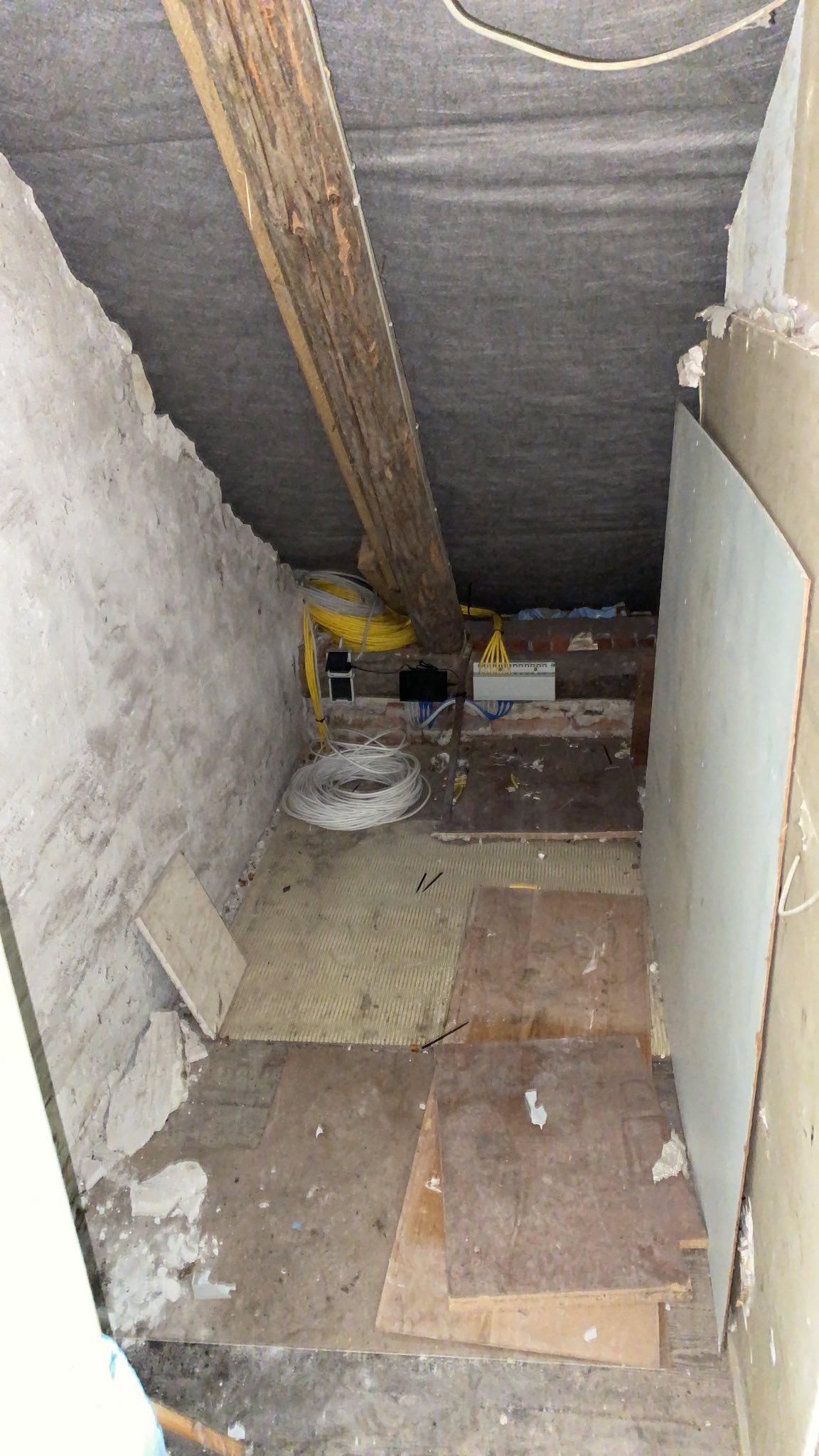

  16. It's behind a small door on the 2nd floor so access is easy. Though in the future we might close off and insulate the knee wall so we'll probably move the switch in to the habitable space. I think it's on the same circuit as the other plugs on the 2nd floor but I'll have to verify. Na I'm in Germany.
  17. Yes it's a loft area. Actually it's behind a knee wall. Hopefully there is no damp or condensation here but ji can't be certain as we just moved in.
  18. I just had a house rewired and they also did the networking. The switch and patch panel are mounted on a joist. I was considering getting a case to put everything in instead.
