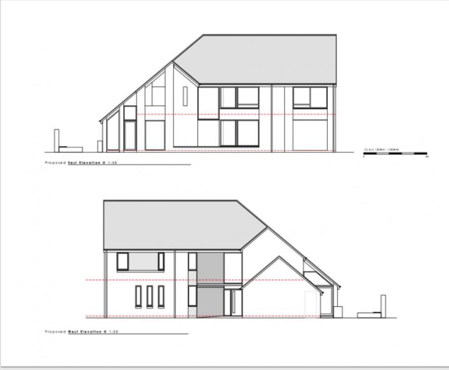

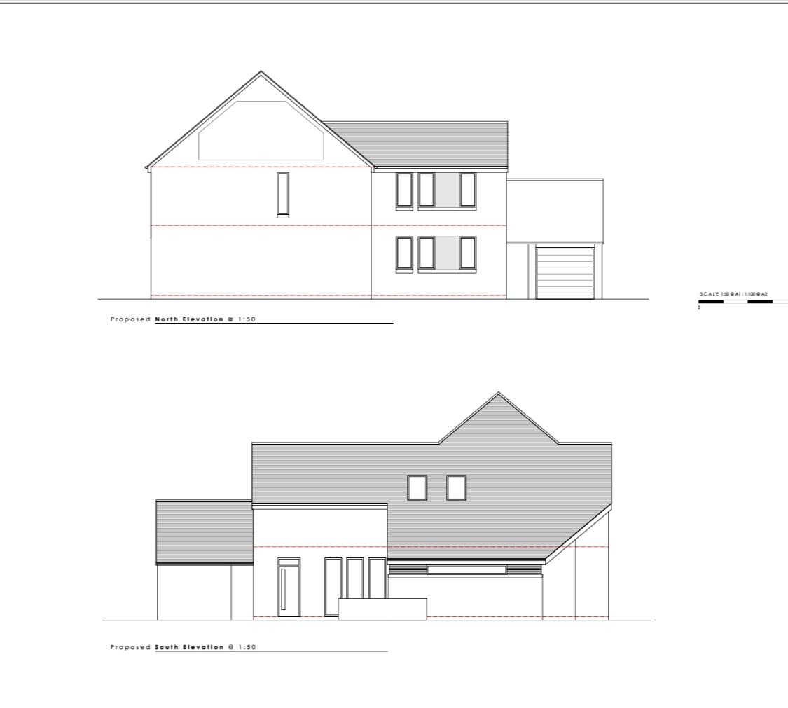

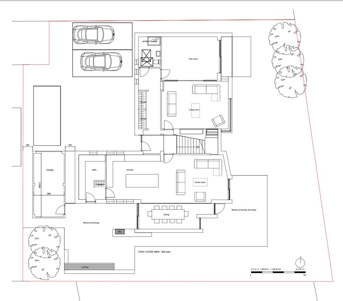

Thanks for taking the time to feedback, it is appreciated. To give you a little bit of context it’s more of a £500/550k house as opposed to £1M which maybe impact some of the overall comments. We had already considered a few of the comments/point raised and some are entirely new which is exactly the reason we thought it would be good to get feedback. The space itself is fairly flexible and we feel that rooms could easily be changed around to reflect our needs further down the line eg playroom could become fifth bedroom/grannex since the bathroom is next door. We are also putting in roof trusses to be able to go up a level in the future so this could accomodate future studies/cinema rooms etc should we require the extra space (especially if we end up having twins ?). We we have decided to square off the angle on the open plan living area as it seemed unnecessary so this might give us a bit more hidden storage and flexibility with the stairs. thanks! -

It’s 303sqm. Originally the plan suggested by the architect was to keep the kitchen/utility to a single story but we decided to build up since we would be paying for foundations/roof etc anyway. I’d be keen to hear about those bits you aren’t convinced by, I’d like to see how our thoughts/decisions stack up against challenge. Yes, the architect mentioned this around the elevations and is working on a materials schedule now with this in mind. -

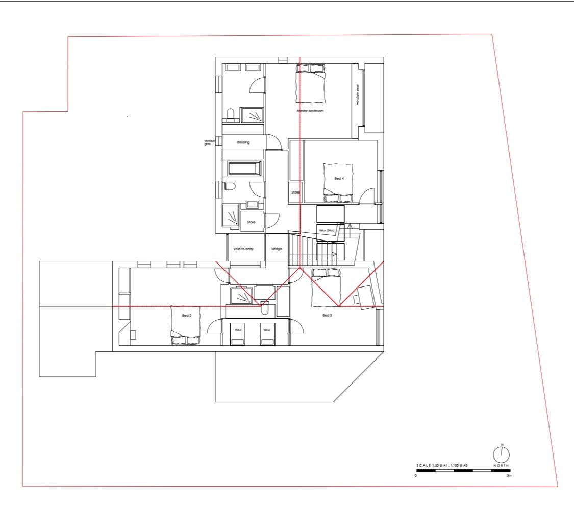

Thanks for the heads up re windows and blinds. I’ll look into that a bit more. We we have a jack and Jill in our current home and it works great for us. Trying to minimize the number of bathrooms that need kitted out and cleaned! Lol -

Thanks for your feedback, we quite like the angled wall and corner windowx as design features but appreciate they might end up expensive features which may have to consider changing when we get quotes etc. Ill have ave a look at the double landing, hadn’t occurred to me it could be tight. Yes; plot is too tight for a bigger garage however we had decided fairly early on that since all we use our current double garage for is storage, it’s a sacrifice that works for us. -
Hi all We have been working with our architect to finalise our plans for our self build. We are really happy with the plans but thought it would be interesting to share them here and benefit from the helpful critique, experience and suggestions others have obtained doing the same. The house itself is on the larger side being 303sqm (exc garage) as it is to accommodate our growing young family. thanks in advance. jenna
