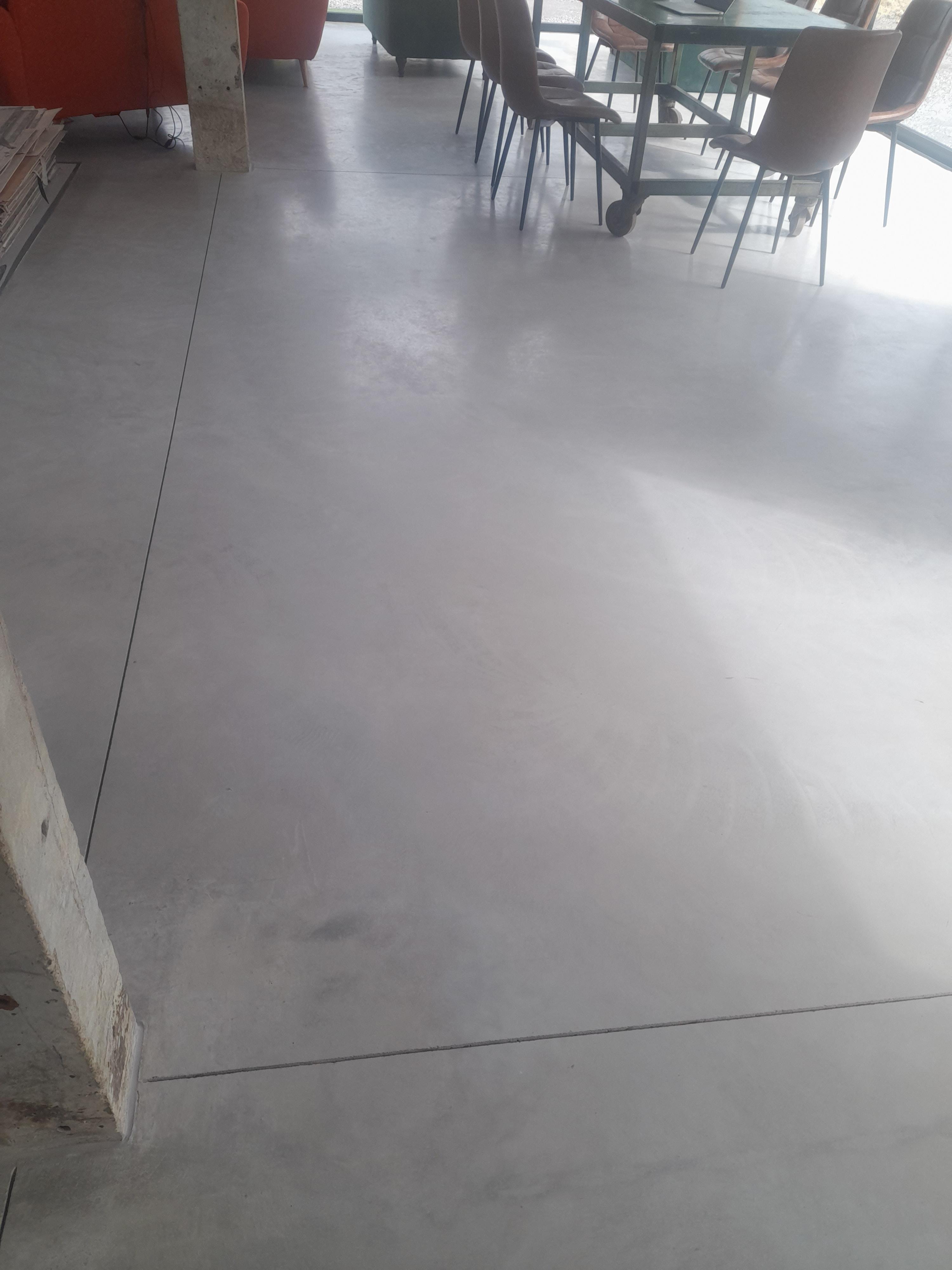

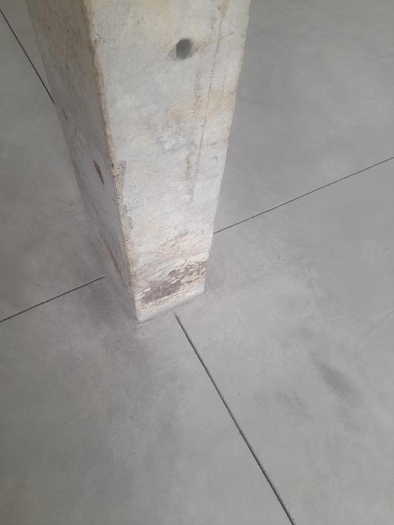

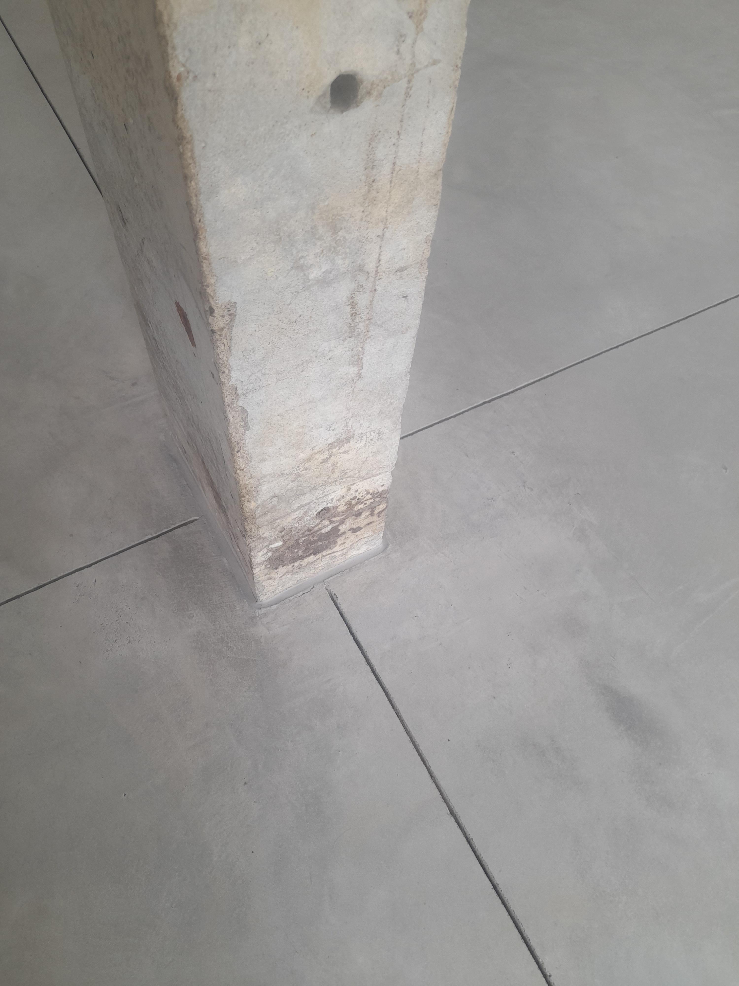

@SarahHutch it was essentially a traditional slab style make up, blockwork perimeter with stick on 150mm perimeter insulation strip that also acts as expansion & limits thermal bridge. Slab make up was 100mm rejects / sand / membrane / 150mm insulation / slip membrane / mesh on 40mm feet with UFH tied to it / 150mm concrete i looked at some of the pre-formed systems but they were so expensive & didnt really work so well for fixing the SIP down do, whereas with this system our sole plate is bolted down to the blockwork.
Sorry missed your comment. I'll be honest I'm not sure what app was done when solar was installed but there was never a mention of costs until after the event. I simply don't agree with SSE and their rationale the legislation talks about new connections which ours is not, its just a pv install. The network doesn't need upgrading at all. The only way out is for me to limit my export and reapply which just seems completely stupid logic as everyone looses. Still these things never seem to have any common sense applied
I call polished when it's ground back and polished whereas ours is just floated. Agree on reason to fill cracks but our robot hoovers every day 🤣. It's purely a design detail we like regardless of practicality
No not yet. Osmo do an oil but its quite a faff to do now we've moved in. It's marked a bit in kitchen area from drops of grease but it doesn't really show due to the nature of the natural imperfections in the finish
We've recently done something similar. 150mm powerfloated finish (Not polished - i'm not sure why you would?) mesh in bottom 40-50mm with UFH pipes tied to the mesh. so circa 100mm on top but some places a touch less where levels werent perfect. we have saw cuts made throughout the slab the following day circa 30mm deep, crisscorssing the whole building. we have chosen not to mastic them as quite like them, but have mastic sealed other places as we have the old concrete barn protuding through the floor. most builds probably wouldnt have as many cuts but with the fixed structure with 8 posts we felt safer to cut to each to allow it to crack in all directions we have only got one major crack not down the cut line which is right down our hallway but i think probably due to the hot water supply to the other end of the house running under that bit. although that's even under the mesh at the bottom it must have had an impact
