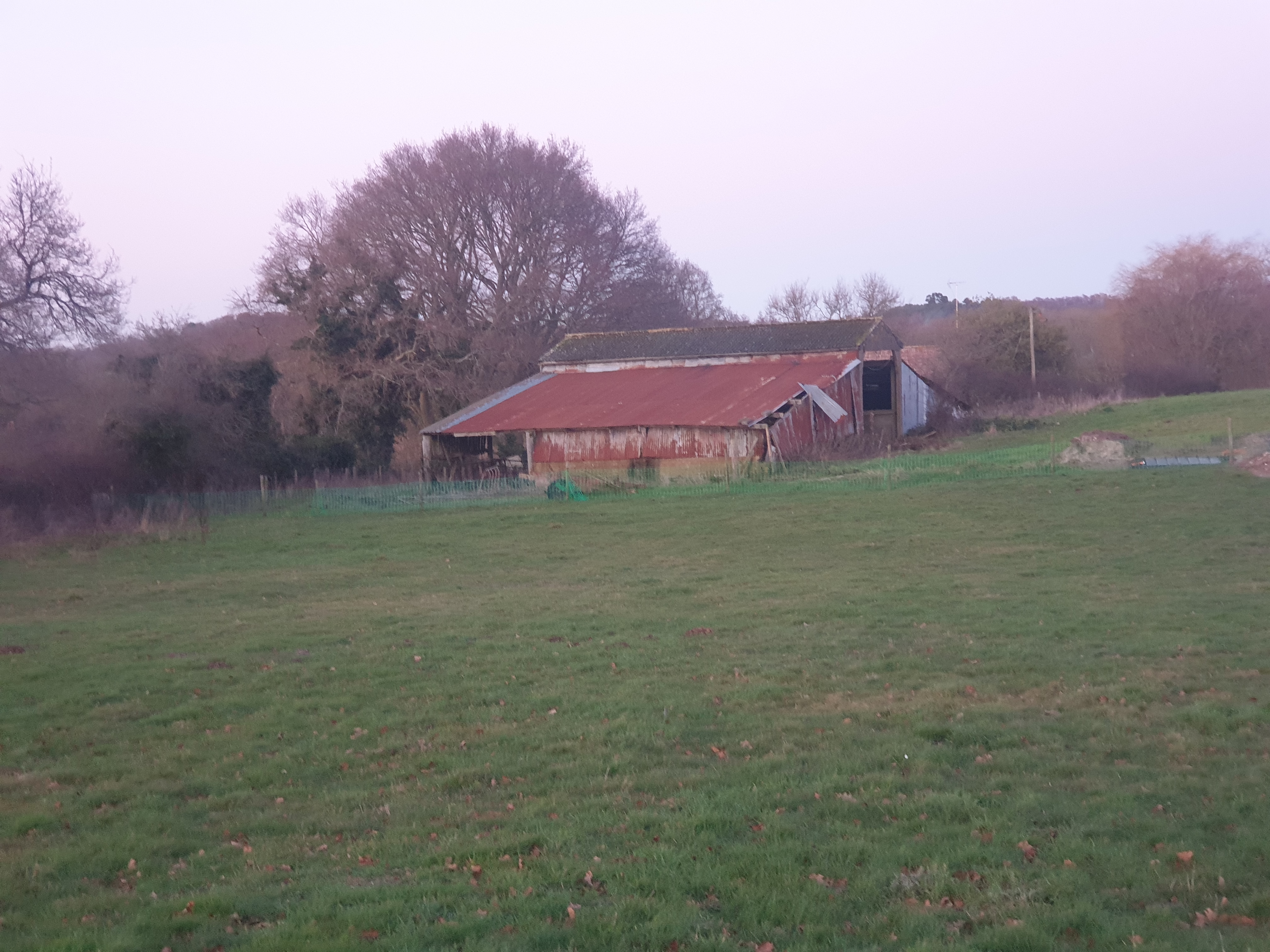

  16. a good friend has just built in ICF, hadn't particularly considered for this but can definitely explore as you describe. thanks 👍
  17. Hi all, Looking forward to getting some top tips from those that have been here already. Starting the journey to turn this old cow shed into something a little more habitable. Two areas I'll be after some advice on right away are PSTP & out letting of discharge & also starting to understand Solar in a bit more detail to get specs right. Current outline spec is SIP build / Air source underfloor / Solar / Batteries / MVHR - starting building regs & SAP side now. Have done loads of renovations before but not a ground up build using any of the new 'renewable' tech. We have to retain the original concrete frame for the central section but the rest is from scratch.
