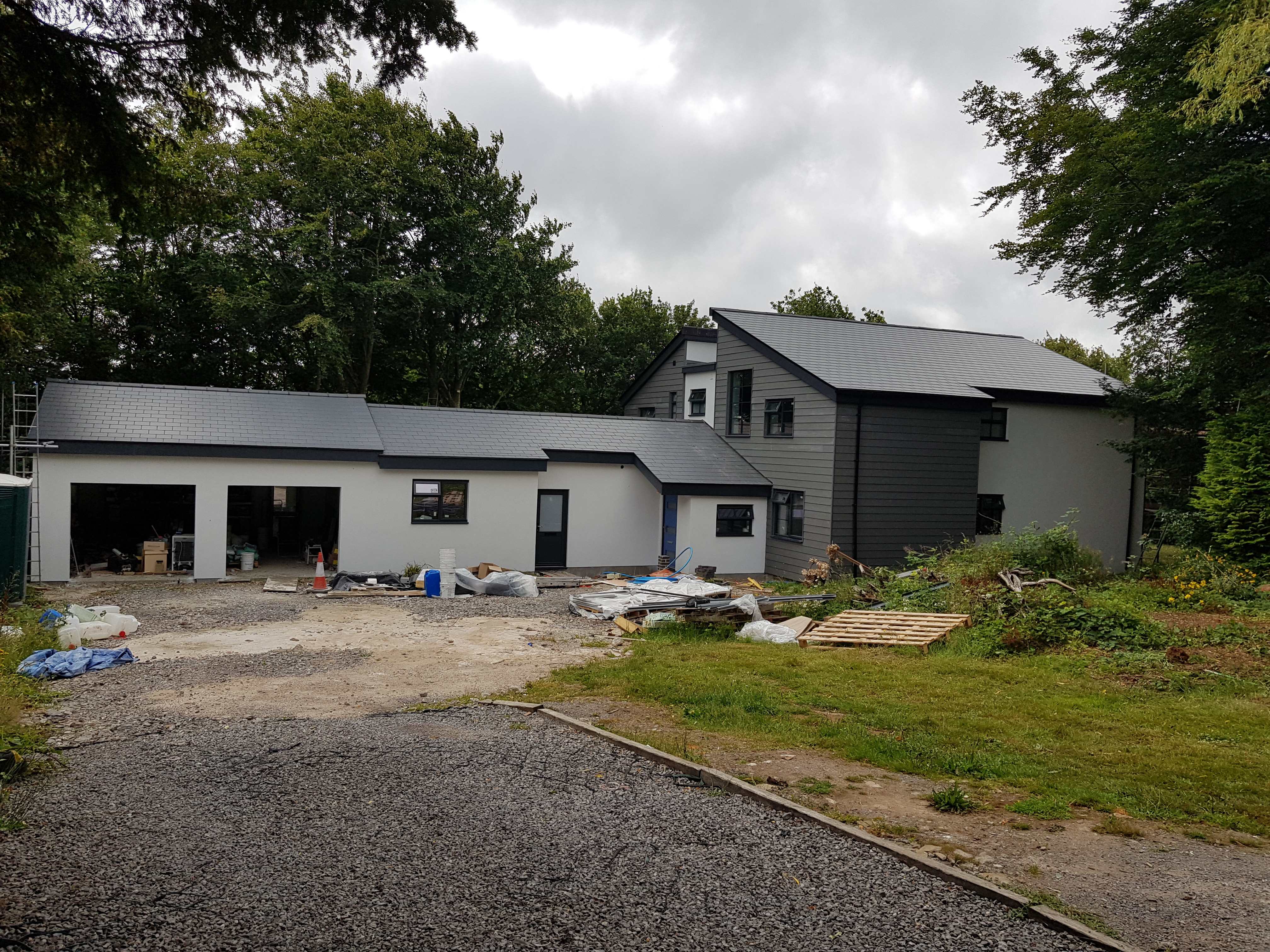

I have gone for a combination of Drivit Render and fibre cement cladding (Cladco)on my Nudura build. Photo taken last week. Still cladding rear but render finished and looking crisp in White Haze which has the slightest touch of grey in it. Hope that helps. Cheers Drew -
