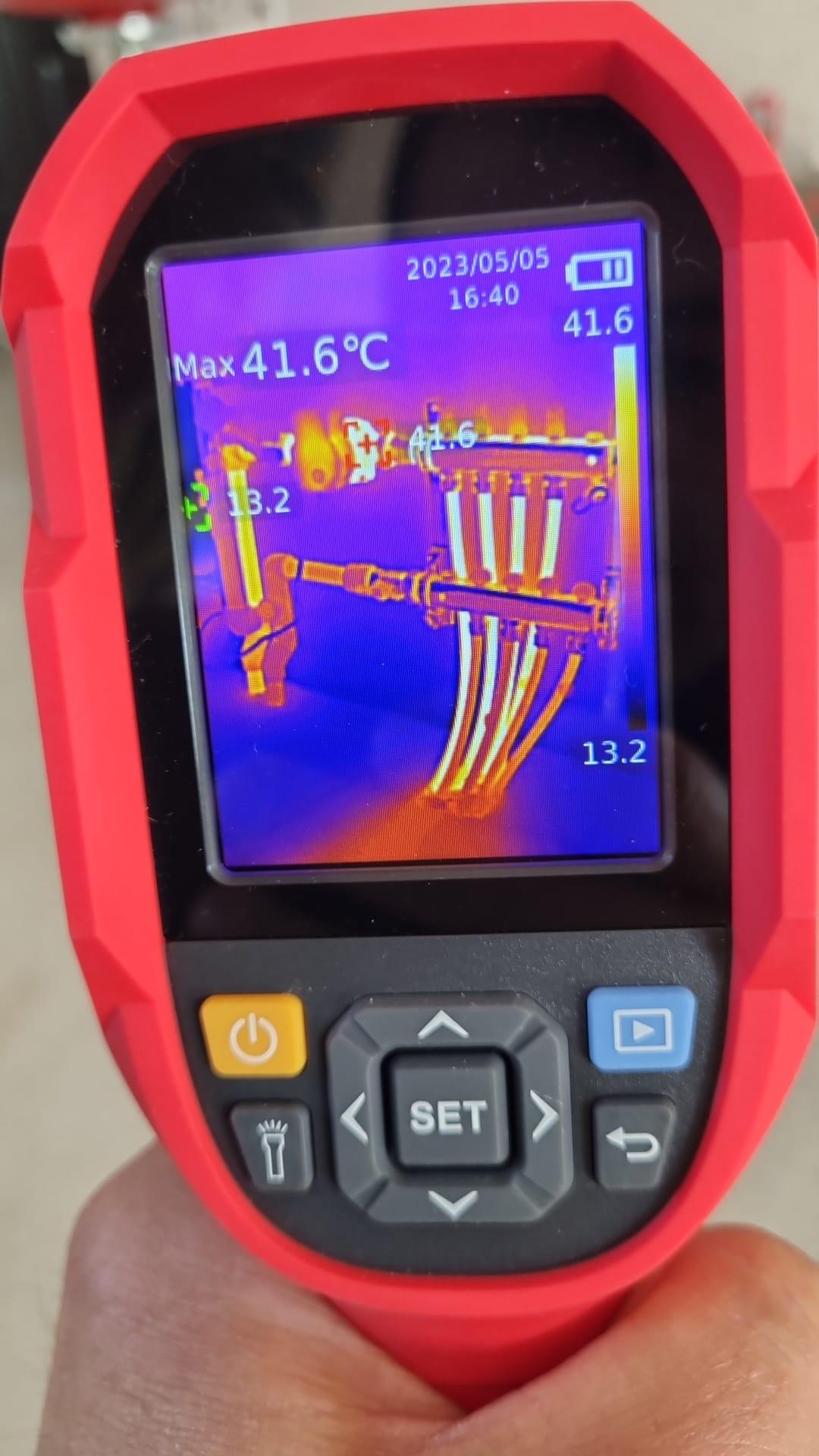

Hi all just an update on second hand heat pump I was trying to bring back to life. I shorted the flow switch and heat pump started to work. I will order a new switch and hopefully that will be it. Heat pump's heat exchanger covered with ice in very short period of time (30min) what would that mean? I have heat pump connected to water underfloor heating only and it was off all this time with antifreeze in the pipes. It was -10°C last night. Does anyone know how can I change the settings so it works only for heating and not with hot water storage tank? My setup sketch below: -

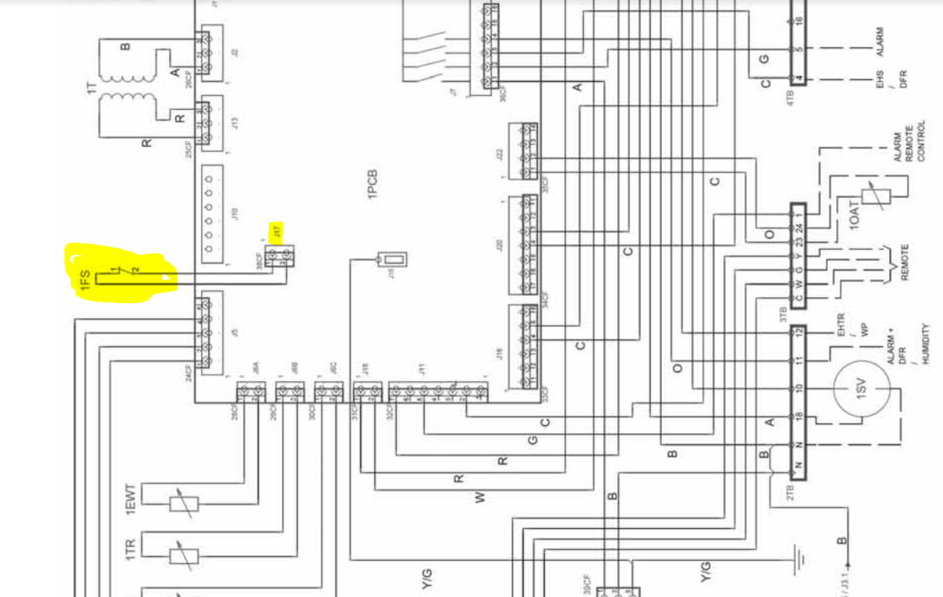

You are right, I finally found a drawing and it is just a switch which is connected to J17 on this particular model. -

Hi! Does anybody know if flow switch is the switch (closes or opens circuit) or it returns resistance when flow is over 8L/min? Thanks! -
