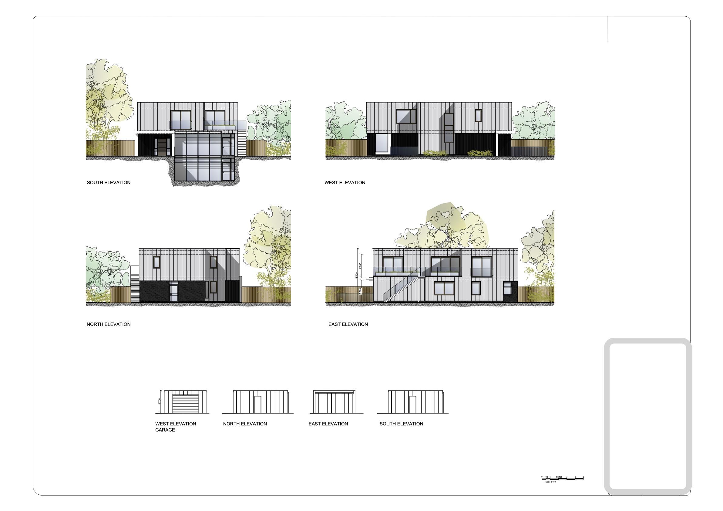

  5. West wall and the double height South glazing are the two complex aspect of this build. I am leaning on using ICF (Nadura) and I did review the design with a consultant and he was seemed not to concerned with the west wall. Southern wall double height glazing worries me a bit for overheating and for the cost of so much glazing.

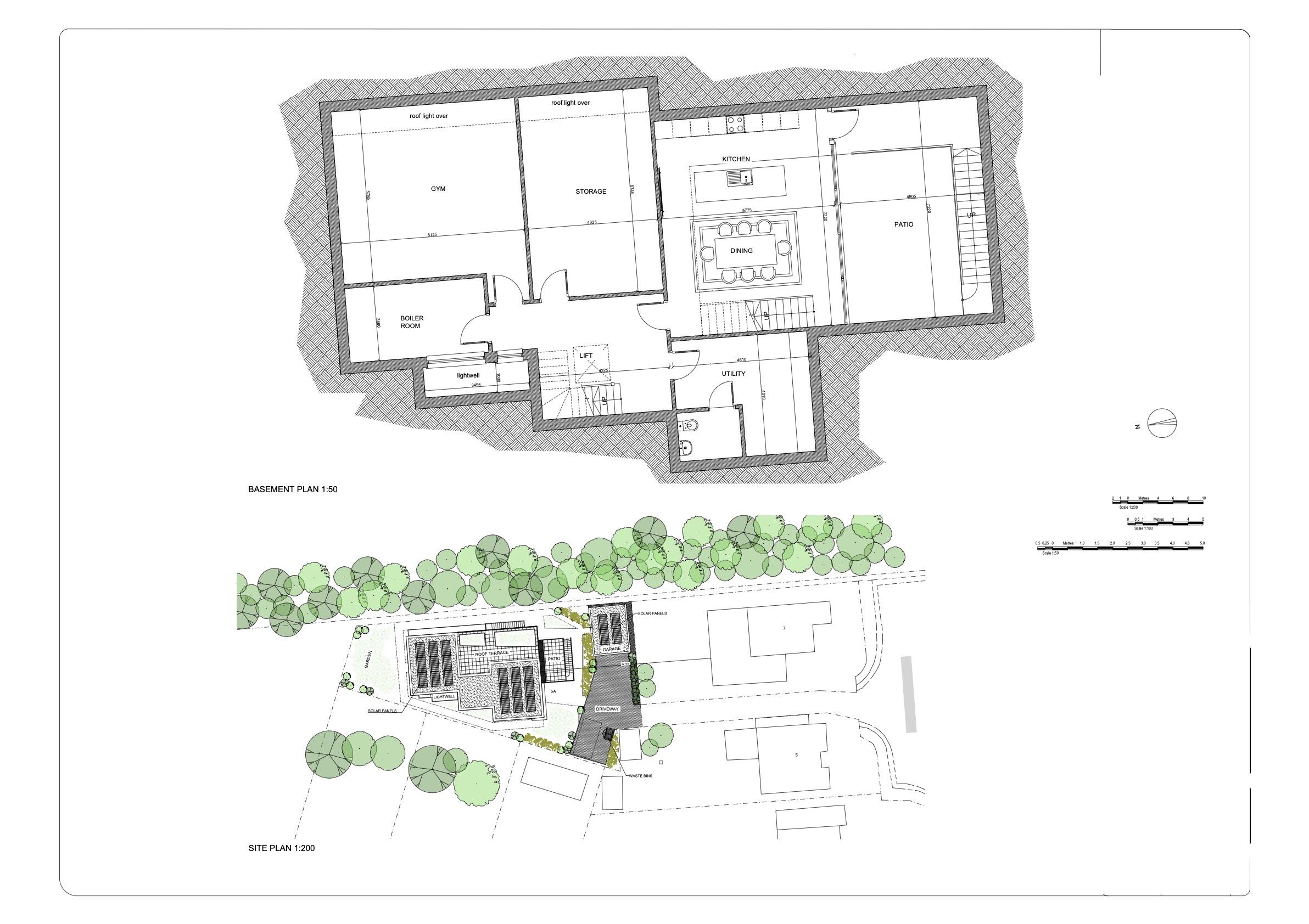

  8. Thank you - using ICF, I calculated that putting a basement of whole footprint of the house was cost effecient and gave us lot more space than we need
  9. Yes, while the wifey is very excited about the high ceilings and double height glazing, I am very worried about over heating in summer. I do plan Brise soleil to bring shade - I don't have much idea what else to do. How did you manage to prevent over heating ?

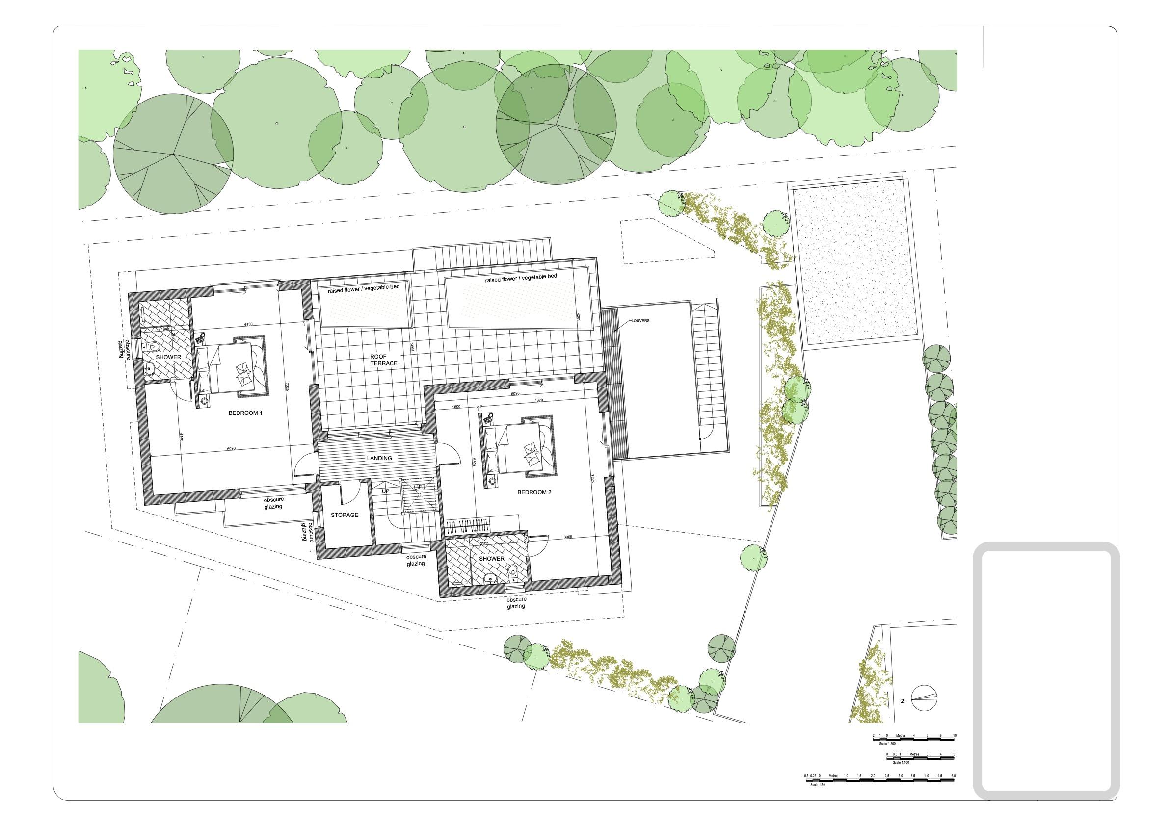

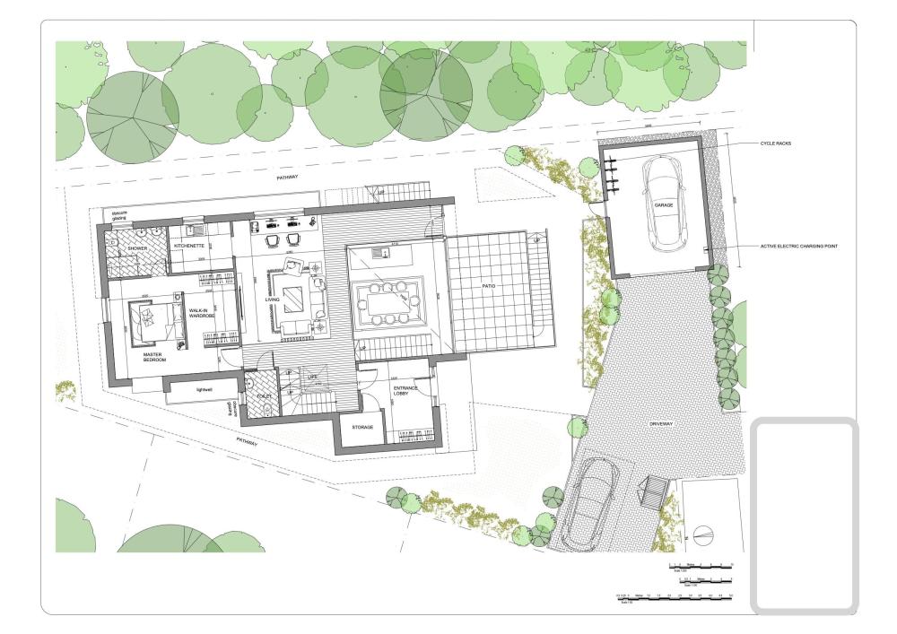

  10. thanks for your feedback @Bozza . Yes, I do agree that we have designed the bedrooms to be a bit larger than standard - this was one of the features that my misses was not ready to budge on 🙂 In terms of house features and needs : 1. We are a family of two with no kids. We hope to bring dog to this house some time in future as this will be our house for life. 2. Upstairs bedrooms are kept larger and an external access is proposed with an option that when we retire or if life circumstances ever change then the top floor bedrooms could be let out as self contained studio/Airbnb. 3. We needed two working spaces becuse there are days when we both WFH. We have kept one of the space in the living area is only for illustration. It was kept to keep the person working from home stay connected with the living space and have awareness of the front door. 4. Two kitchens - One as show kitchen at the basement level and another kitechenette on the GF for actual contained cooking. Indian food cooking demands an airtight kitchen with industrial exhaust 😄 5. We do cherish doing Yoga and the gym space is for that. 6. Individual bathrooms because when we go to work, it's rush hour to get ready at the same time. 7. Large bedrooms, double garage, mezzanine floor, walk in wardrobes and an east facing terrace are all wishful features that we thought we will never get a chance to have in our house so when this opportunity presented it self, we put all that in the design. We don't have much needs other than ones listed above - we started self-build journey when me and my wife were looking at an American style fridge freezer and my wife cracked a joke that we would need to build a new house to fit a fridge of our choice (we live in a 9 year old new build btw). So most of our requirements are a collection of features that didn't worked for us in our current house or are features that we fancied when watching grand design on tele 😄 Thanks for all your inputs.
  11. Hello Everyone, I am a first time self-builder who has never built anything before. We have obtained a planning permission to demolish an exsiting timber bungalow and rebuild a traditional style bungalow with basement and patio. However, we have applied another application with design for a contemporary a house with basement. The plot is a backland and it has a 25m drive in with two neighbour to the front and no neighbours on all other side. We hope that, while this is a contrast to the local scene, we are roughly 35m away from the stree and snuck behind two neighbours to the front so the design will be acceptable to council. Please can I have some valuable inputs based on your experiences - mostly around how we have designed the internal floor design (please note that basement gym/Store is for depiction only - we may use it as cinema room) Thank you all in advance. Cheers, G.
