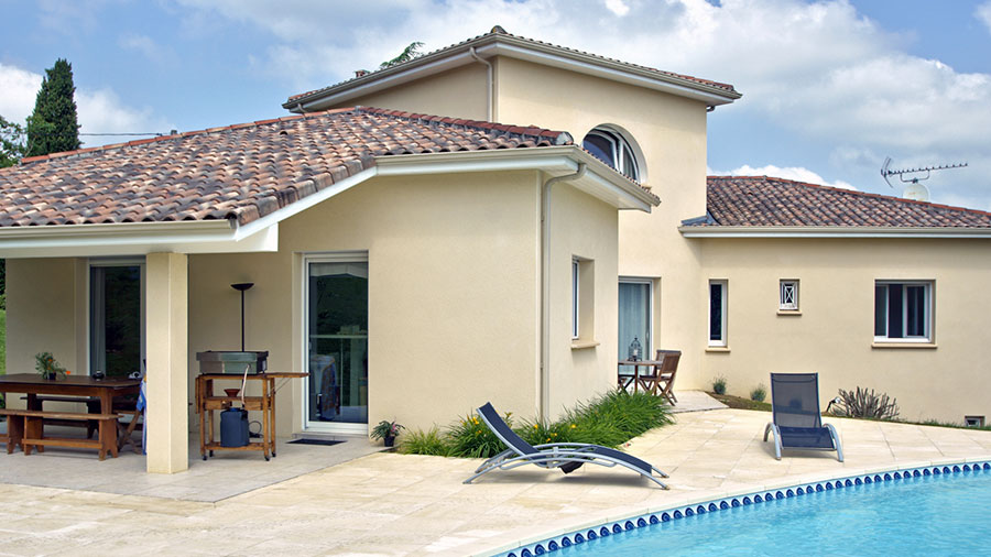

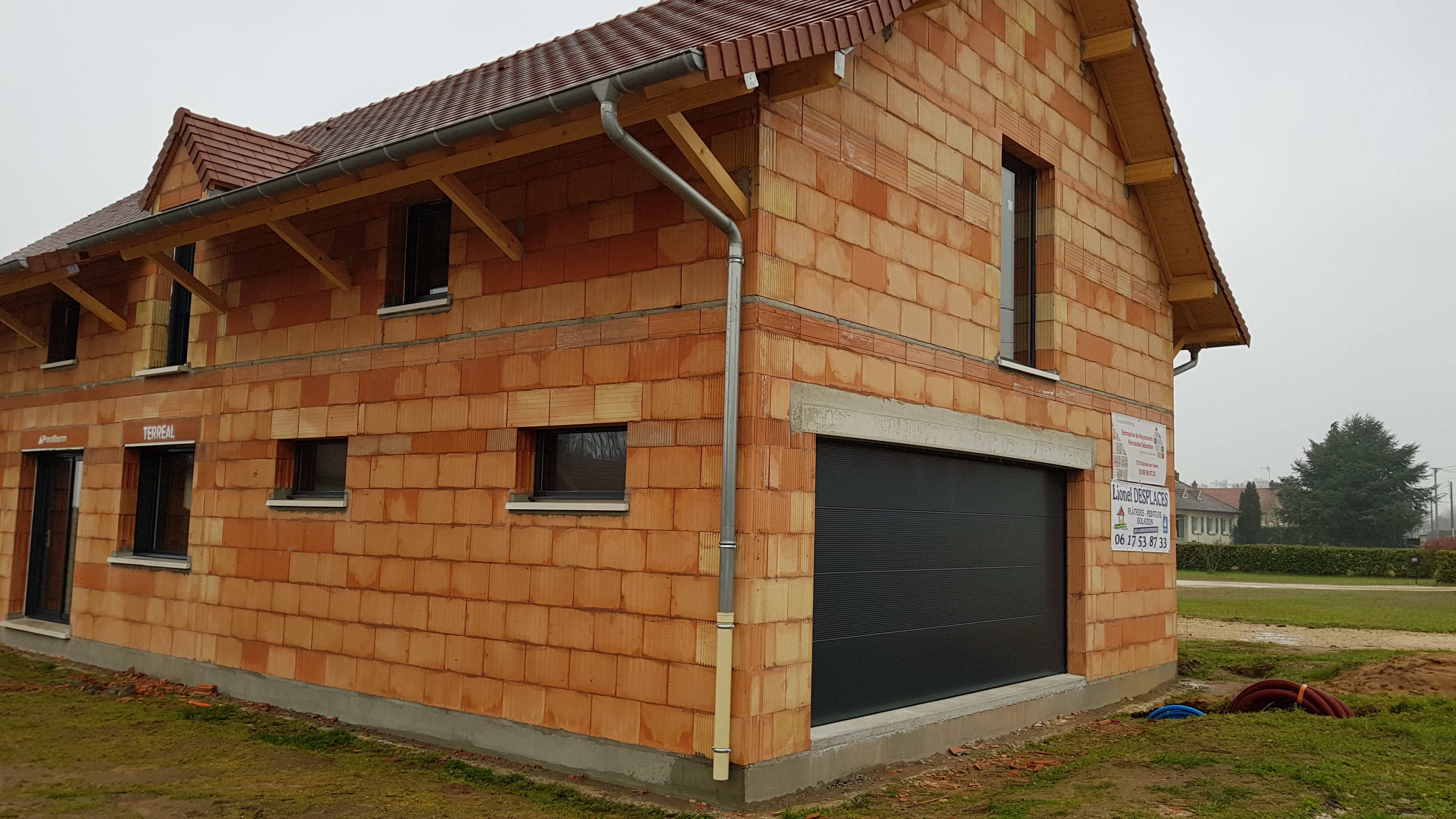

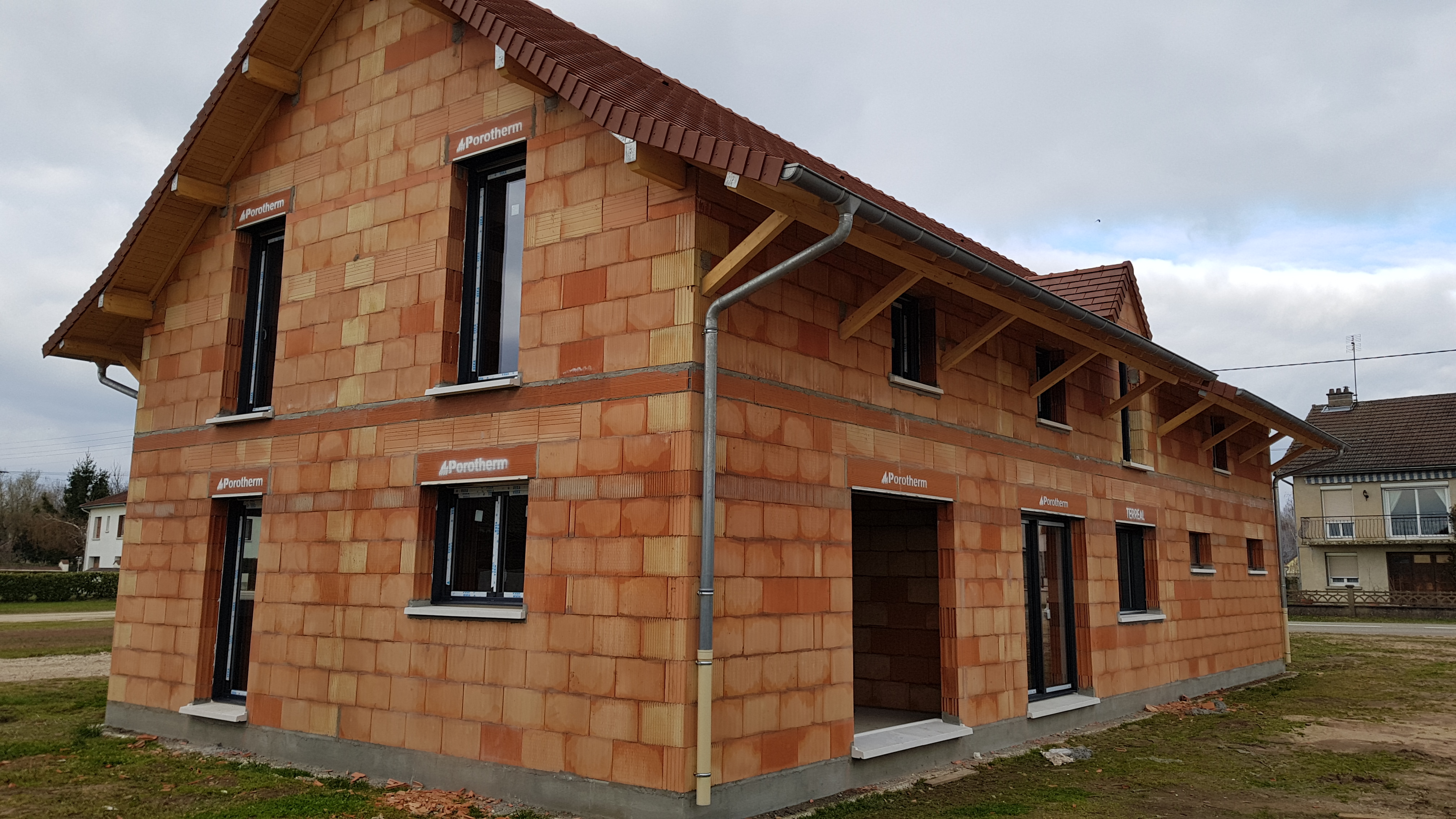

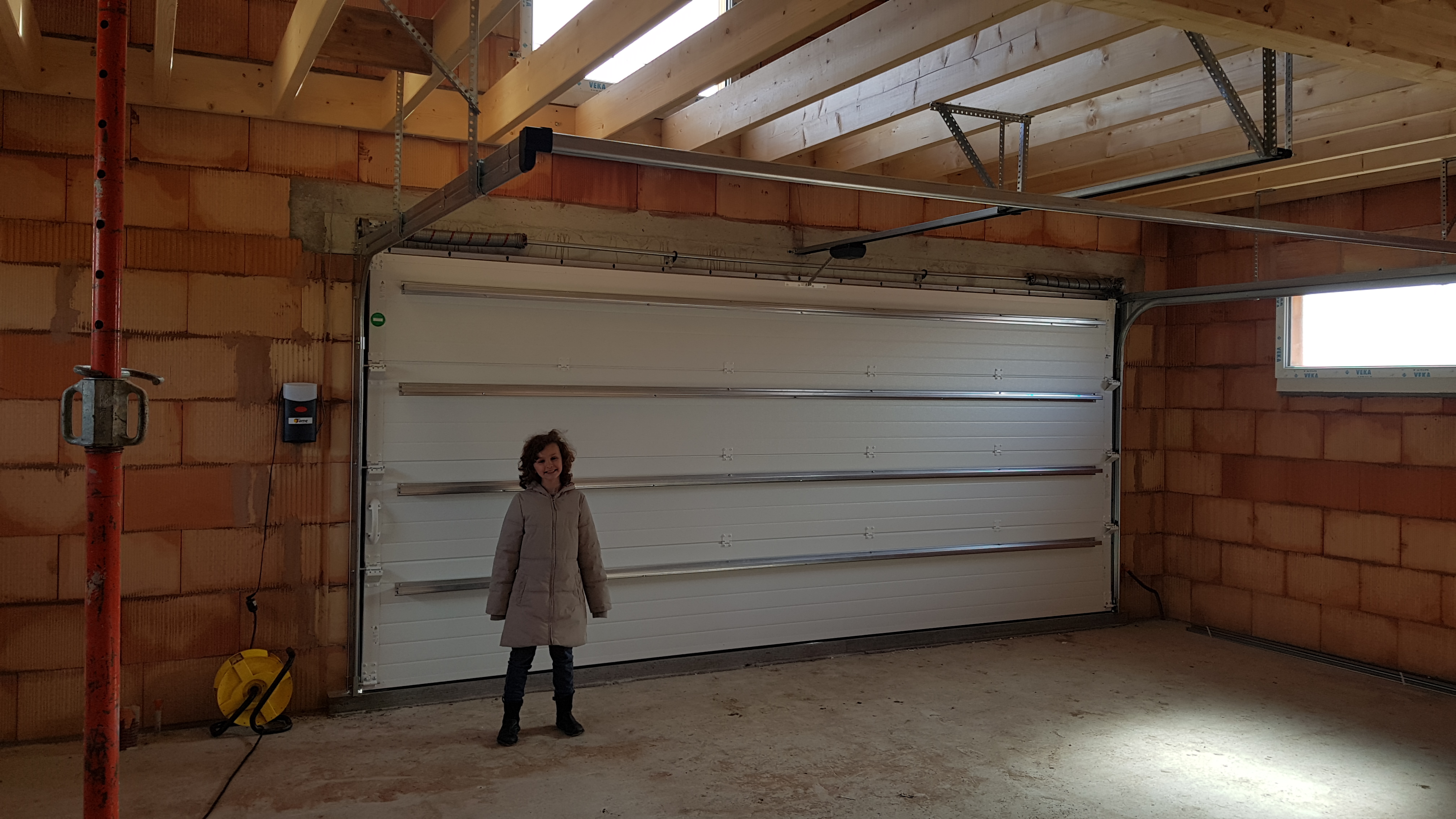

It will be half garage, half workshop. space for 2 cars and to be able to open the doors fully. The upstairs will be a man cave/cinema. An extravagance I know but this will be my last house. I've had compromises and loads of old houses so now I just want something not too big nor too small. 2600ft2 not including garage. all quality German kit inside. £300k including the land and fees. think we have built a bargain.

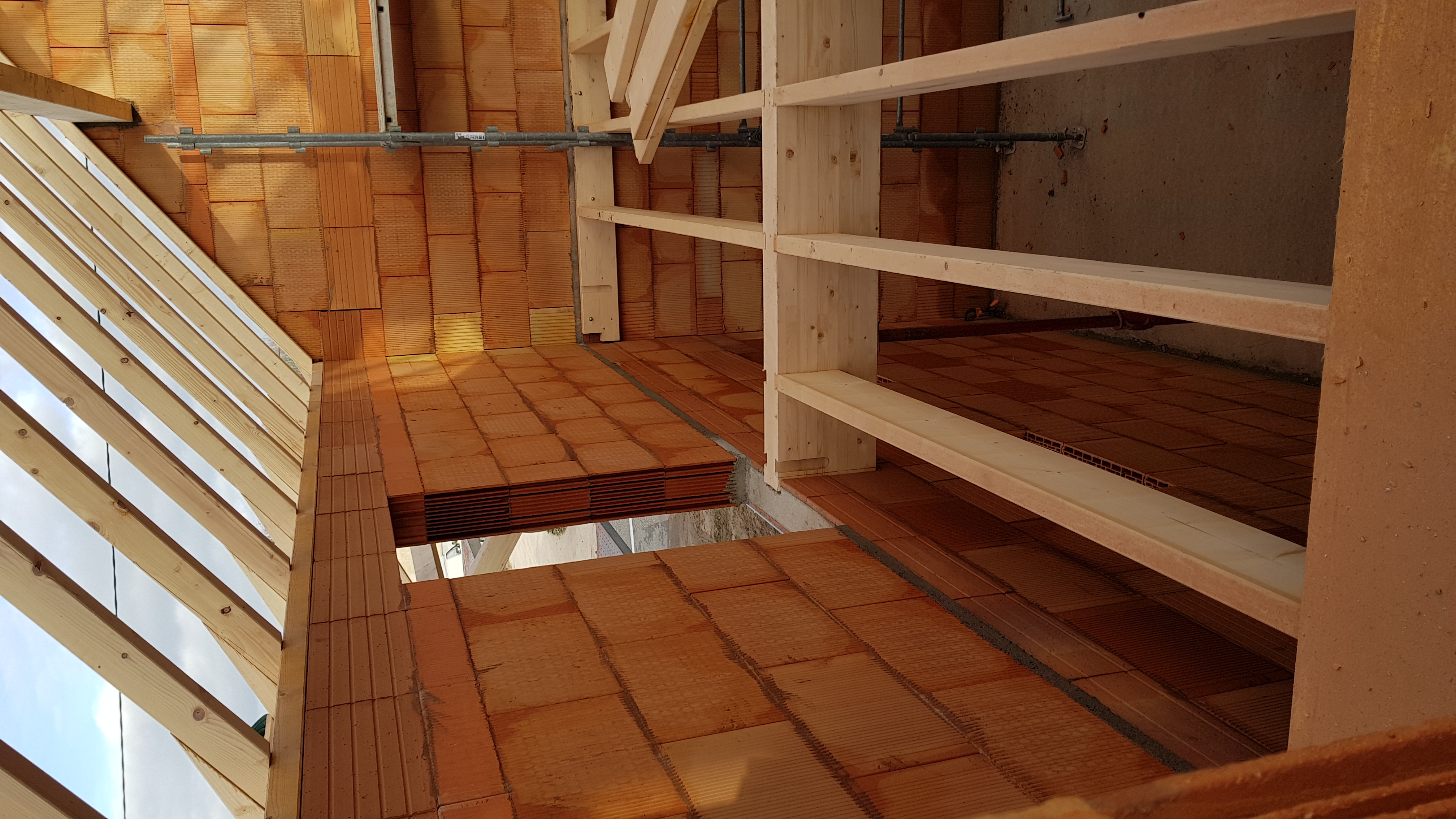

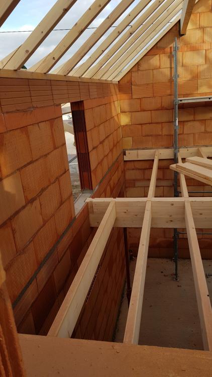

30cm of wood fibre blocks on the interior. Plaster board finish. outside will be rendered see examples. French doors ( they are not called that here) will slide into the walls to disappear The roof guys were great. all joints dovetails and longer ones were pinned with wood pegs.
Interesting point on the staggered joints. chipboard - I guess I have bad memories of chipboard furniture but I take your point on a smoother finish.

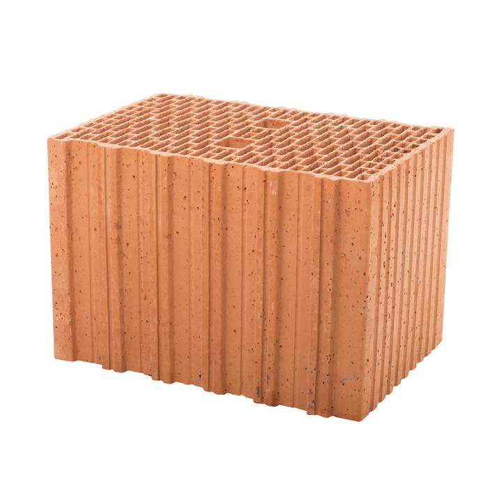

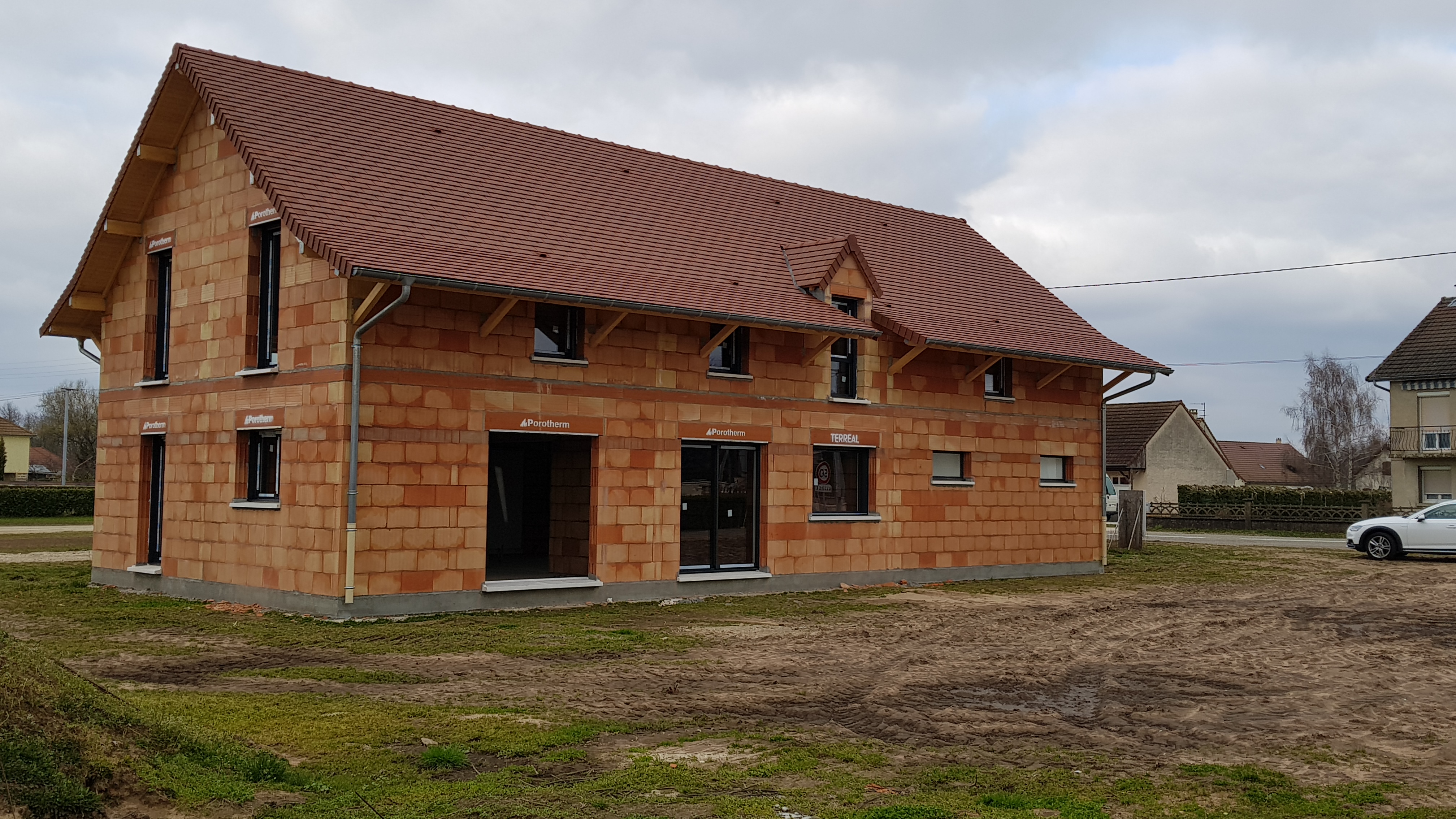

The walls are this https://wienerberger.co.uk/product-search/poroton-cellular-clay-block-t12-365?wb_condition=ProductType:1366306245287 The exterior will be rendered- the interior will be 30cm of wood fibre insulation. why this you ask. it cuts down noise, it has no chemical vapours coming off it, it has about a 12 hour delay in transfer so it can cope with the cycle of hot and cold better. It's nice to work with. For me it's interesting to see these methods. she was insistent on this and I now take my hat off to her. Yes they hammered them in tight. the roof joists are similar and they them drove in oak pegs. she went big on spec with laminated beams etc. and she calls me the one who has to have the best. Was pleased with all the trades but the UK health and safety would not have liked it. all I can say is that gloves and hard hats can't sell much over here. The beam walking whilst throwing roof tiles was better than going to the circus- and no safety net....

Thanks that the maker. on that site here is the link to the product https://wienerberger.co.uk/product-search/poroton-cellular-clay-block-t12-365?wb_condition=ProductType:1366306245287 The builder laid it with a brown glue and tool to roll it on. easier to lay but you need to keep tight with the level. He spent a lot of time checking that. I'd say it could catch out an unwary amateur!

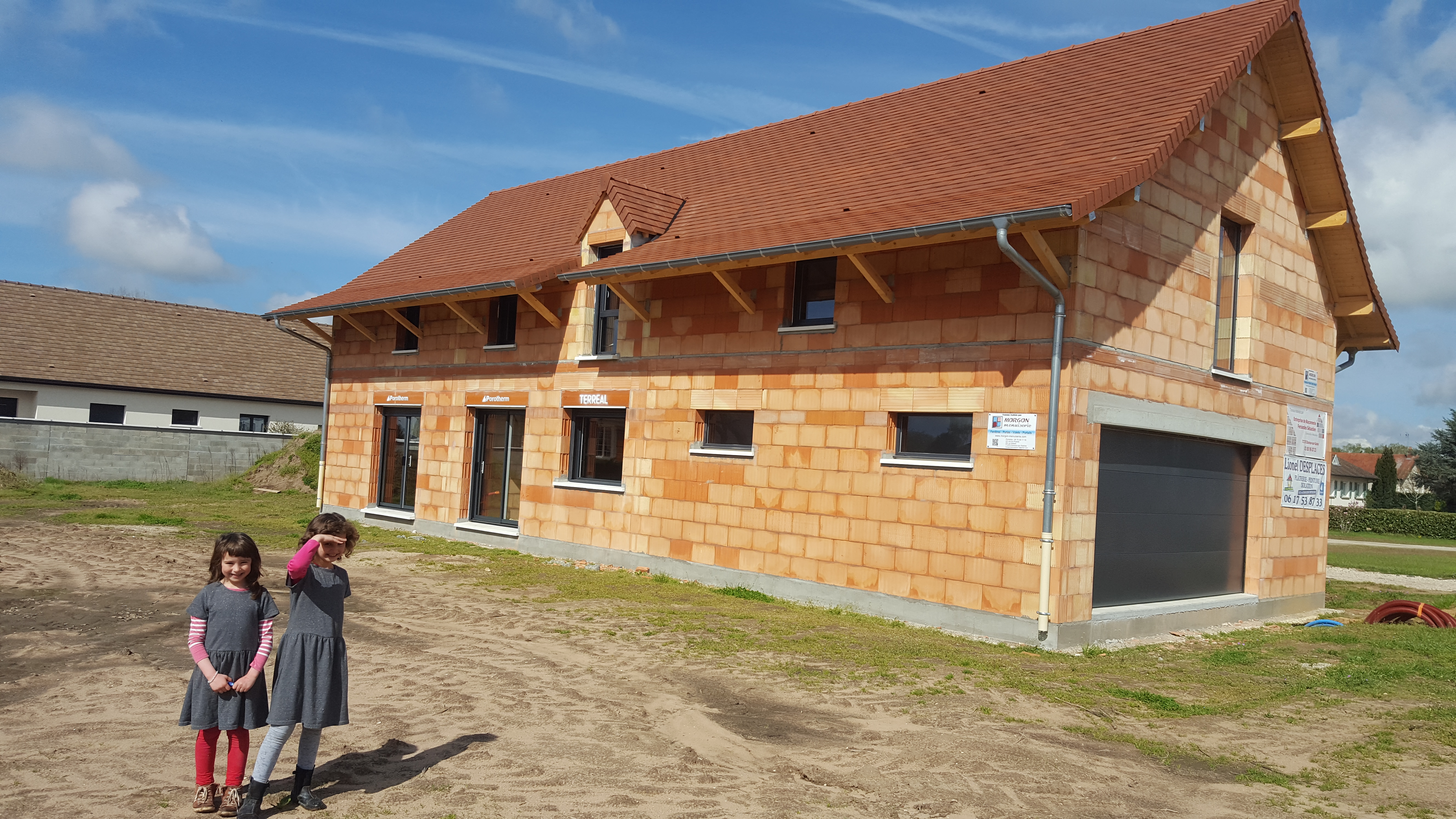

Hello to everybody. My girlfriend is having built her own home she designed. 230m2 of living space plus large double garage etc. 4 bedrooms, 2 bathrooms, wc, kitchen, living room, office, utility room, cinema/activity room. The house is in France and is on a plot of 1300m2. The house is going to be complete in September. She is using individual trades and she manages the project. There have been no problems and it will be on or just under budget. She is using a brick construction ( lots of holes in it but don't know the name in English) with wood fibre insulation. Under Floor heating by town gas. All German materials for kitchen, bathrooms, boiler, windows etc Estimated energy (hard and electricty) costs per annum €500 Land cost €45,000 including fees. Build cost: €300,000 I joined the forum to ask a few questions and read up on theories and practise. Feel free to chat. Mark
My girlfriend is having her new home built for her - individual trades. See photo. House is in France. All is going well. Over size is 230m2 plus a large garage. It has 4 bedrooms, 2 bathrooms, wc, utility room, upstairs and downstairs living room, kitchen and large play room/cinema. On a plot of 1300m2 Joined the forum to ask a couple of questions.
