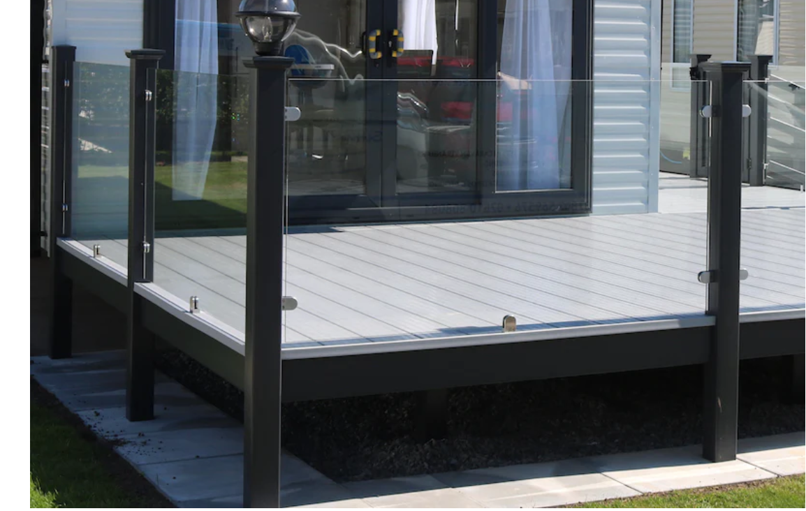

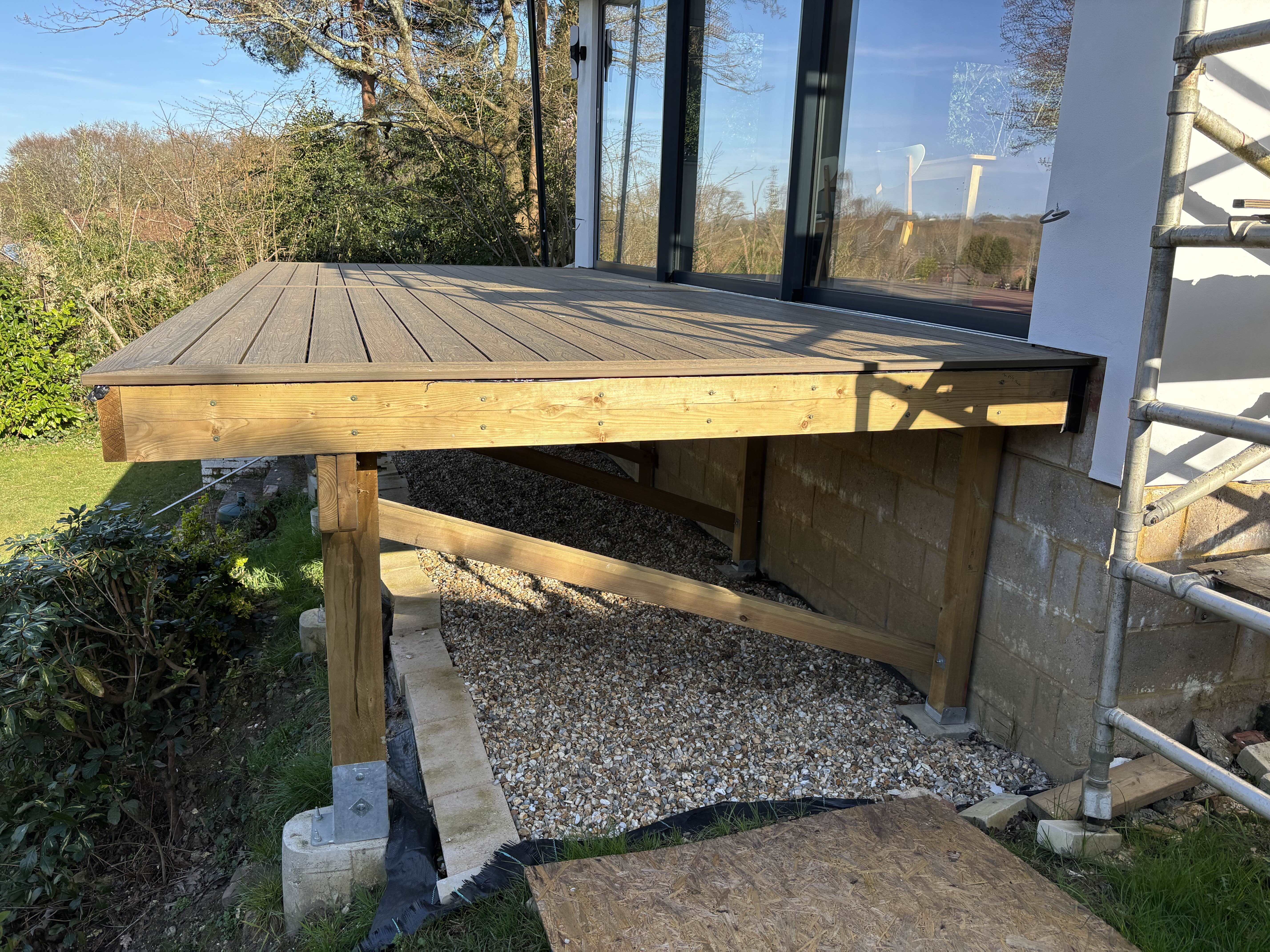

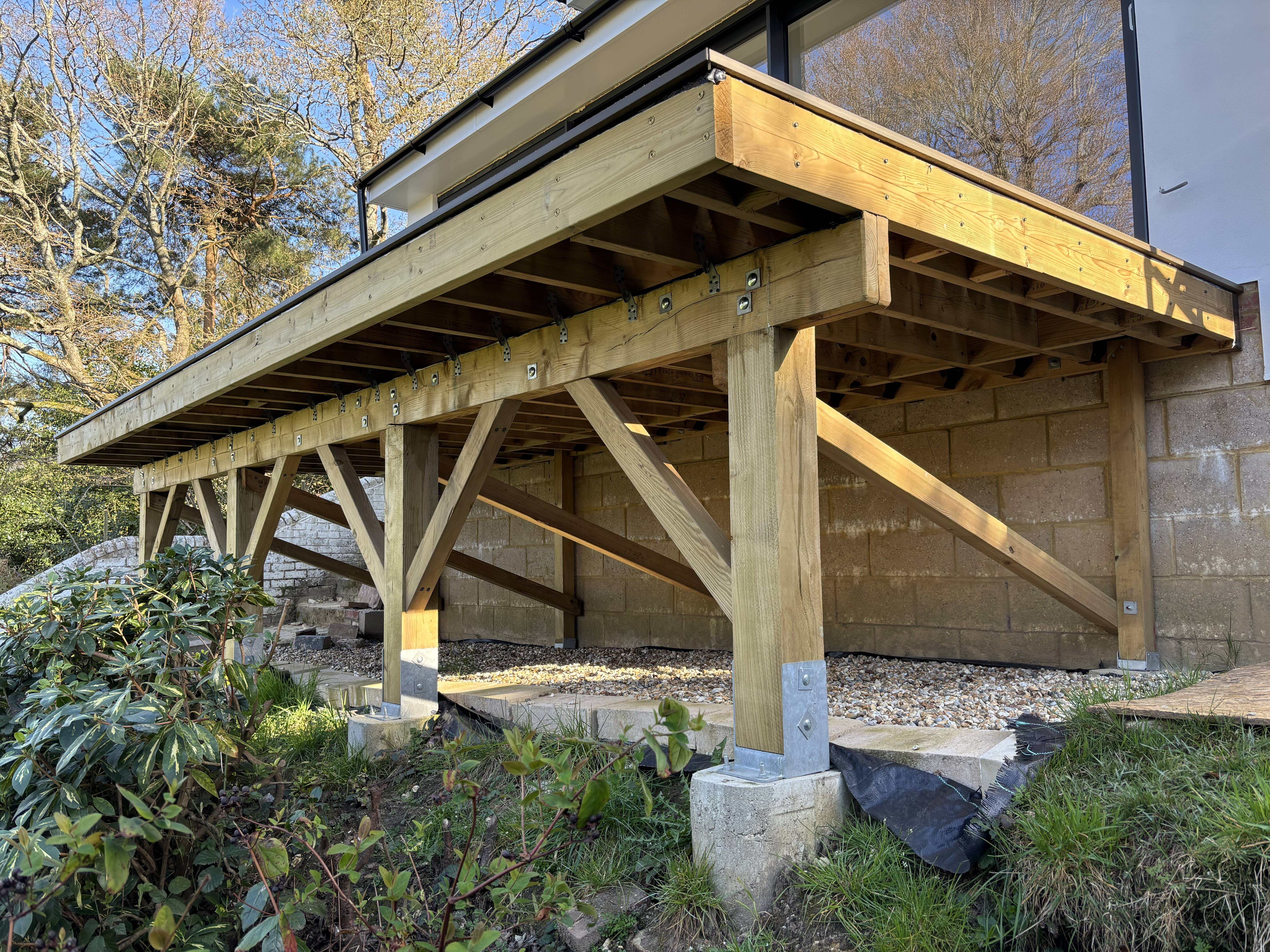

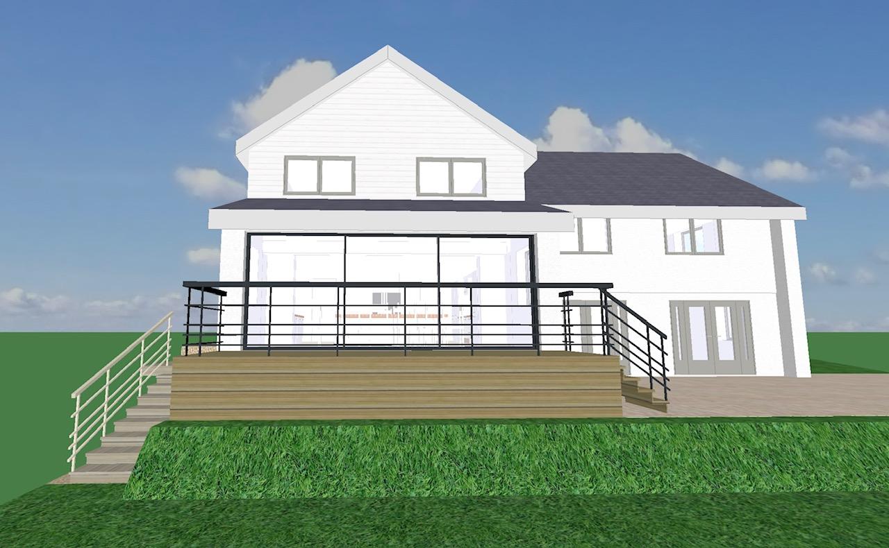

Well, in the end, I built this out of timber with composite decking. The footings also tie in horizontally with the building footings. Next question. I'm looking to do some kind of DIY glass balustrade. Something like shown below but with a handrail (drop>600mm). ie. timber posts (fixed properly in the frame), with stainless steel brackets. Anyone done this?- 33 replies

You may well be right! I'm a chartered engineer myself so I'm generally happy with the numbers and I've had mixed success with structural engineers in the past. With a timber build I'm happy all the information is out there eg. The TDCA Code of Practice - Raised timber decks is pretty comprehensive. Yes, no timber is the ground thanks! It's just the alternatives I'm looking at. No doubt I'll just end up with 150mm timber posts (probably oak) on steel brackets in concrete with a standard timber frame above with lots of cross bracing. I will ask my local SE though to see what they say. Different view points are always appreciated though!- 33 replies

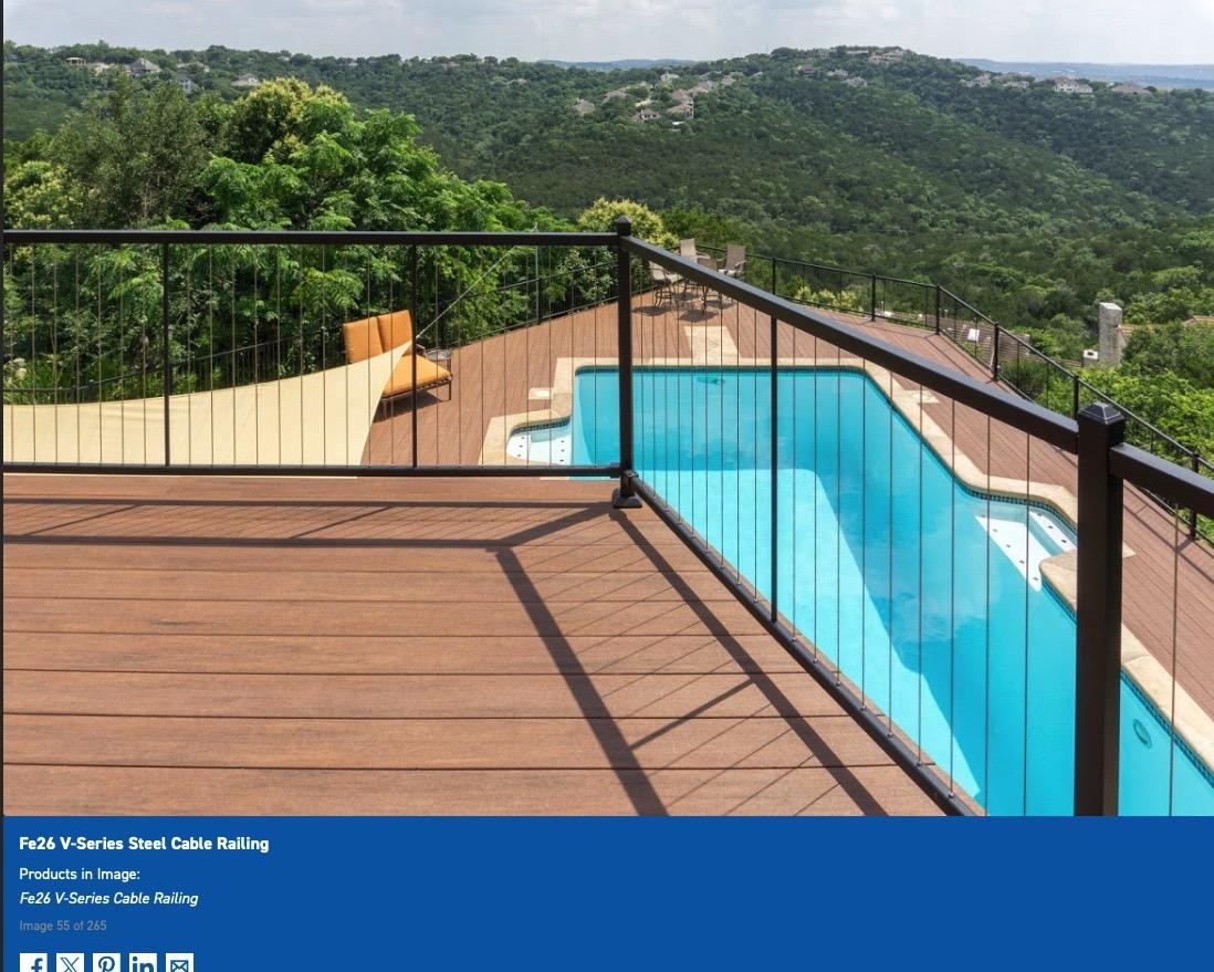

How did you attach your balustrade? Seems that there are lots of ways to do it and some are a bit dodgy for raised decks. I'm after this style of rail below but not sure if it's acceptable just to screw down into the frame at the bottom of those posts. The second half of this video shows some common issues:- 33 replies

I'm going round in circles with this! I've contacted two manufacturers of plastic posts. One says you can't use their posts in raised decks over 1m and the other says you can with diagonal bracing. I just don't see any evidence of anybody using it which puts me right off. The other issue that had come up is the balustrade. A manufacturer advised it may be better to fix into steel at that height. So, I've started looking at steel frames as you say Crispy. This is all turning into a massive time waster! I can see why the pros just concrete timber in the ground and let the home owner worry about it in a few years!- 33 replies

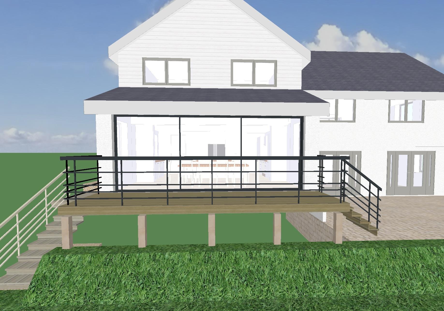

The underneath is going to be open like below with a weed barrier and gravel directly under the deck. Yes, the maintenance of the wood is a concern. I’ve just seen you can get 100mm square plastic posts so maybe they are the answer after all! That way I’d be able to dig footings to be level with the lower level of ground and simply concrete those posts in therefore eliminating any issues with the slope.- 33 replies

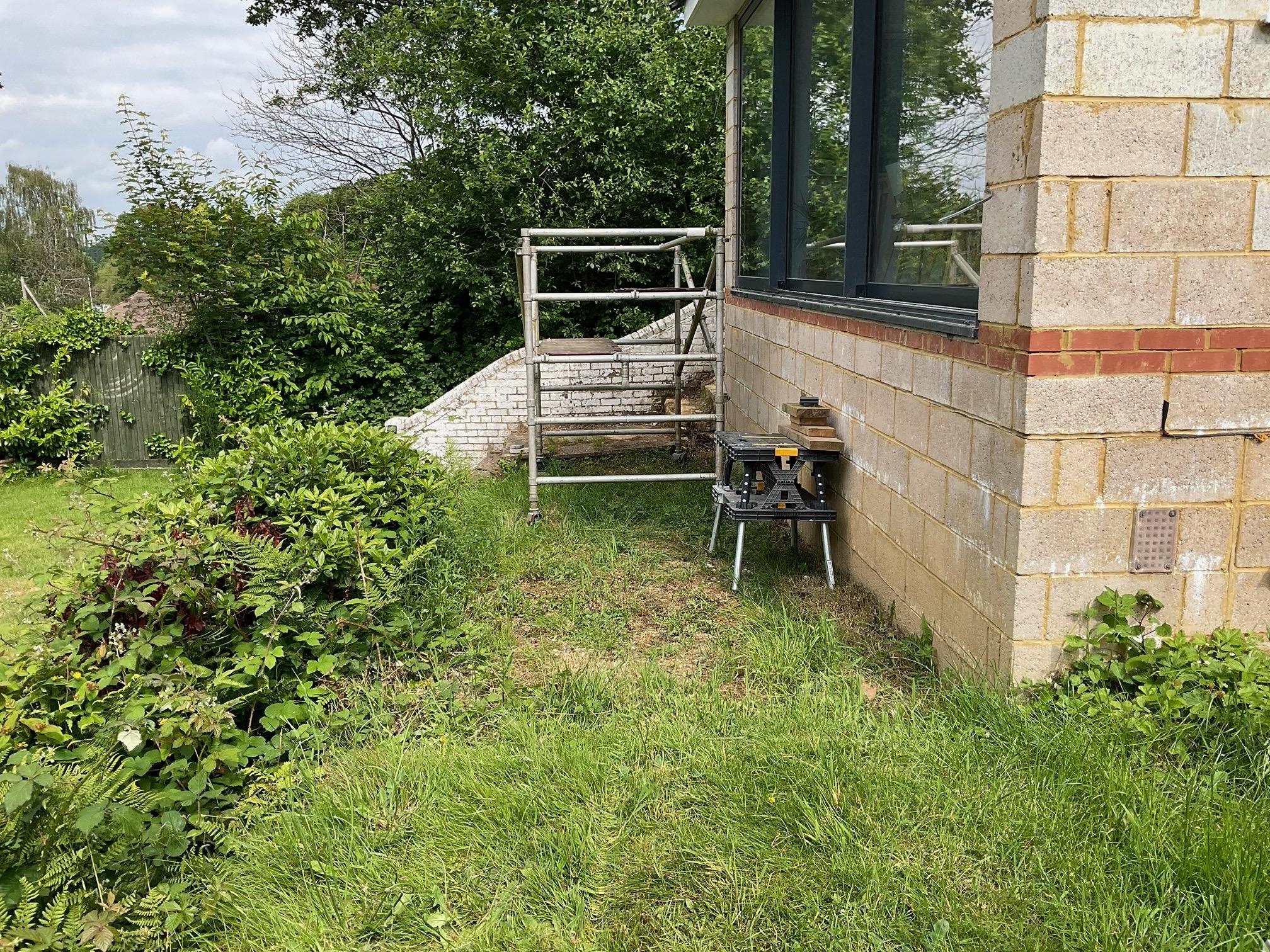

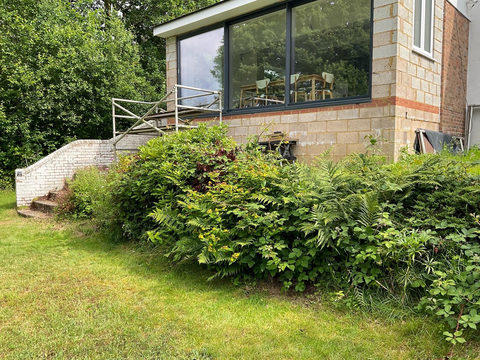

Here are some photos just to give some perspective. Vertical supporting posts would be around left hand side of that scaffolding.- 33 replies

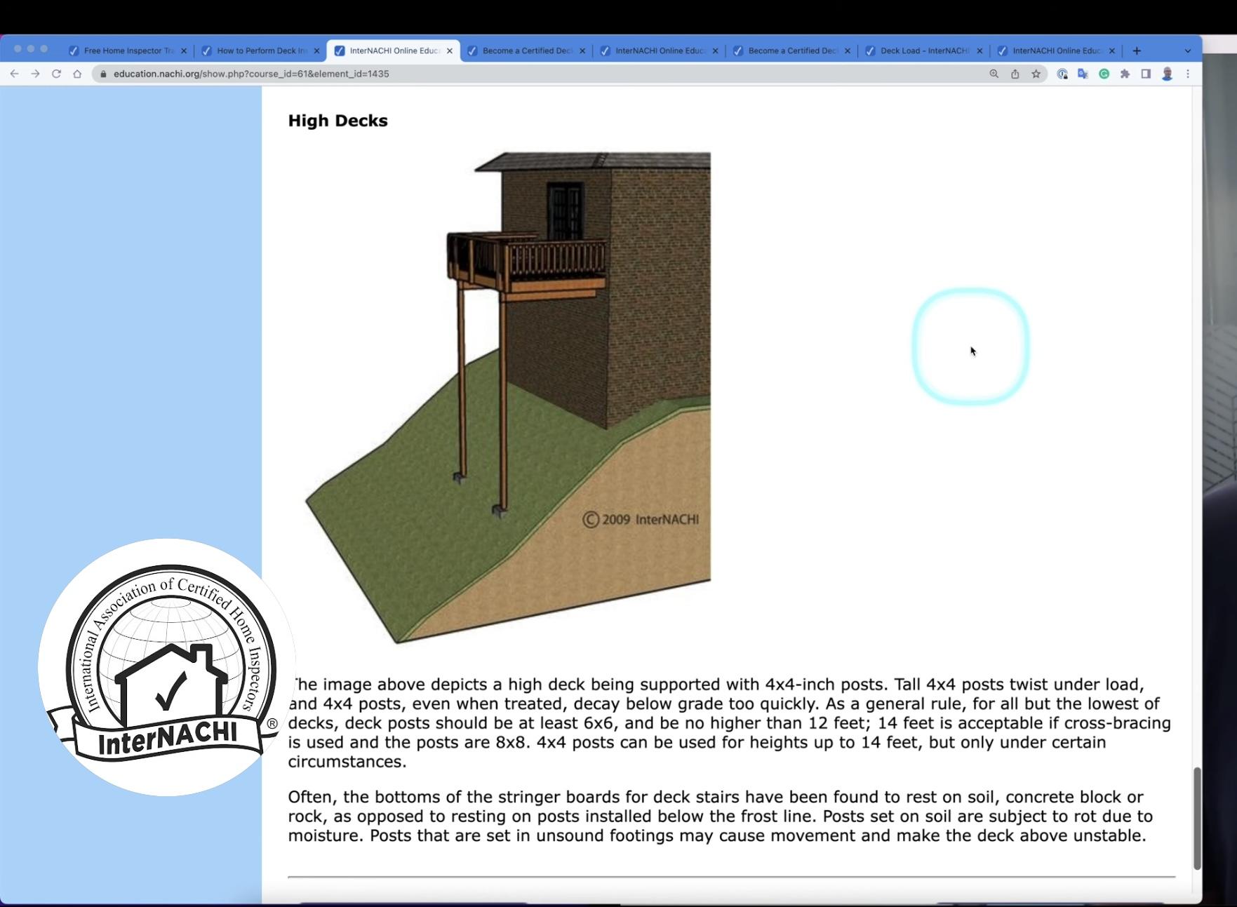

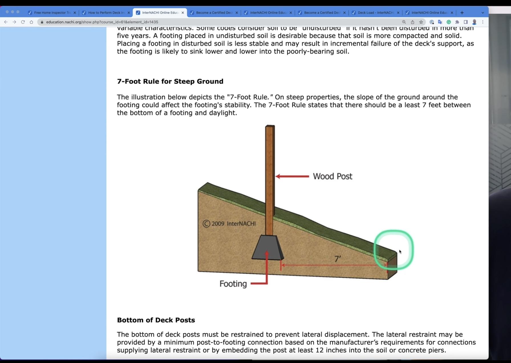

I’ve no doubt it’s a good job! I’d be interested in any photos! I would like to find some info that would have these as part of an official spec. The Timber Decking and Cladding Association https://www.tdca.org.uk say 140mm posts. If I could find a spec for 100mm I’d do that as they are obviously much easier to come by.- 33 replies

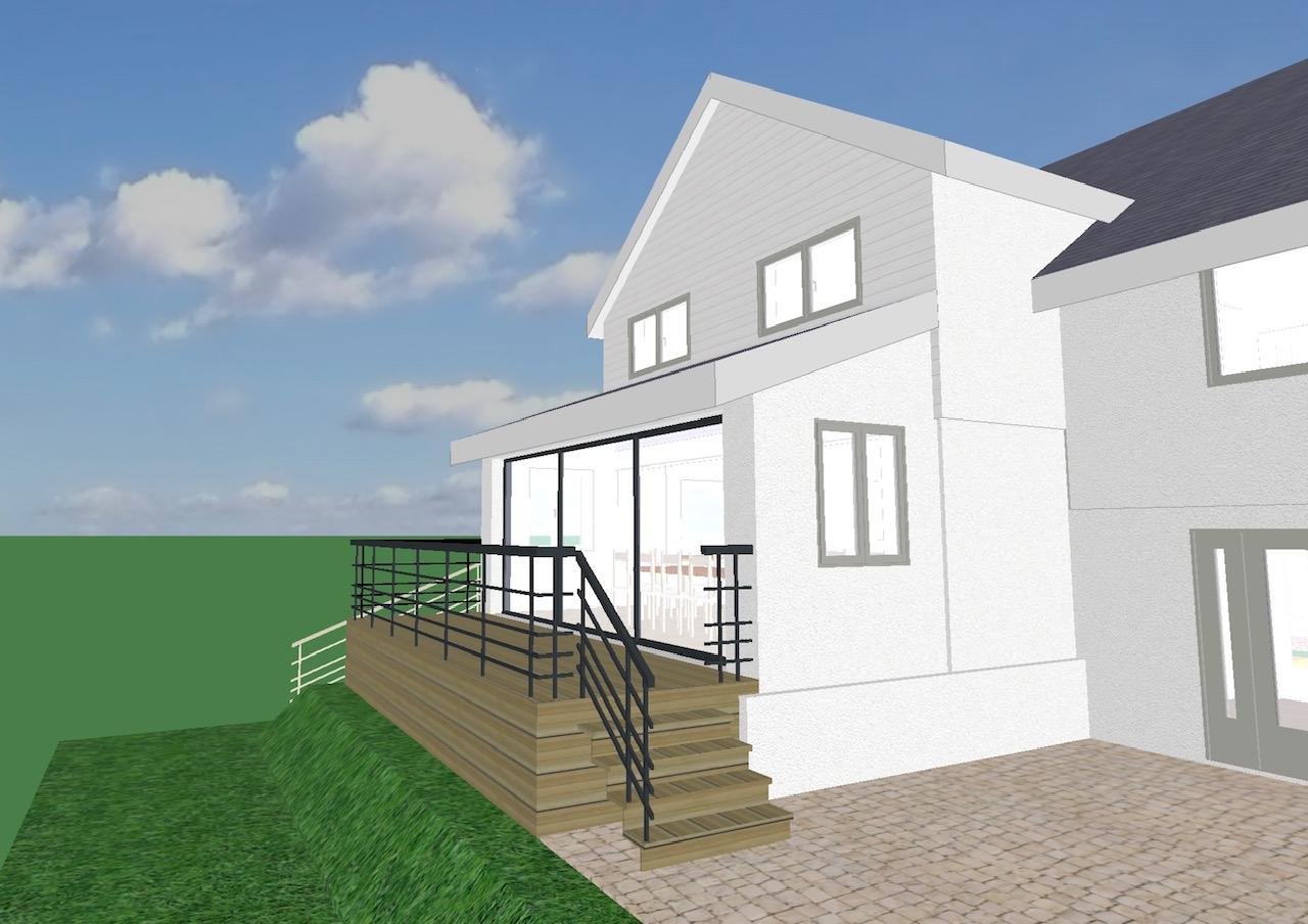

Hello, I’m designing a 6m by 2.4m deck which will be fixed via a ledger board to my house along the 6m length. The other 6m side will be supported by a beam which will be fixed to posts. What posts are best? I definitely don’t want to put timber in the ground. I’m thinking 1. Plastic posts - but these only come 100mm square and I don’t see much evidence of anyone using them. 2. Timber posts 100mm but can’t see any where these are recommend for a deck raised above 600mm 3. Timber posts 140mm as recommended in “TDCA Code of Practice Raised Timber Deck Structures on New Homes”, which is a great guide! The timber posts above to be fixed to a steel bracket with a concrete footing formed from some kid of tube (as in Quickcrete style in the USA). For the 100mm posts I don’t see any specs for spacing where as for the 140mm posts the TDCA guide has good info. Any thoughts?

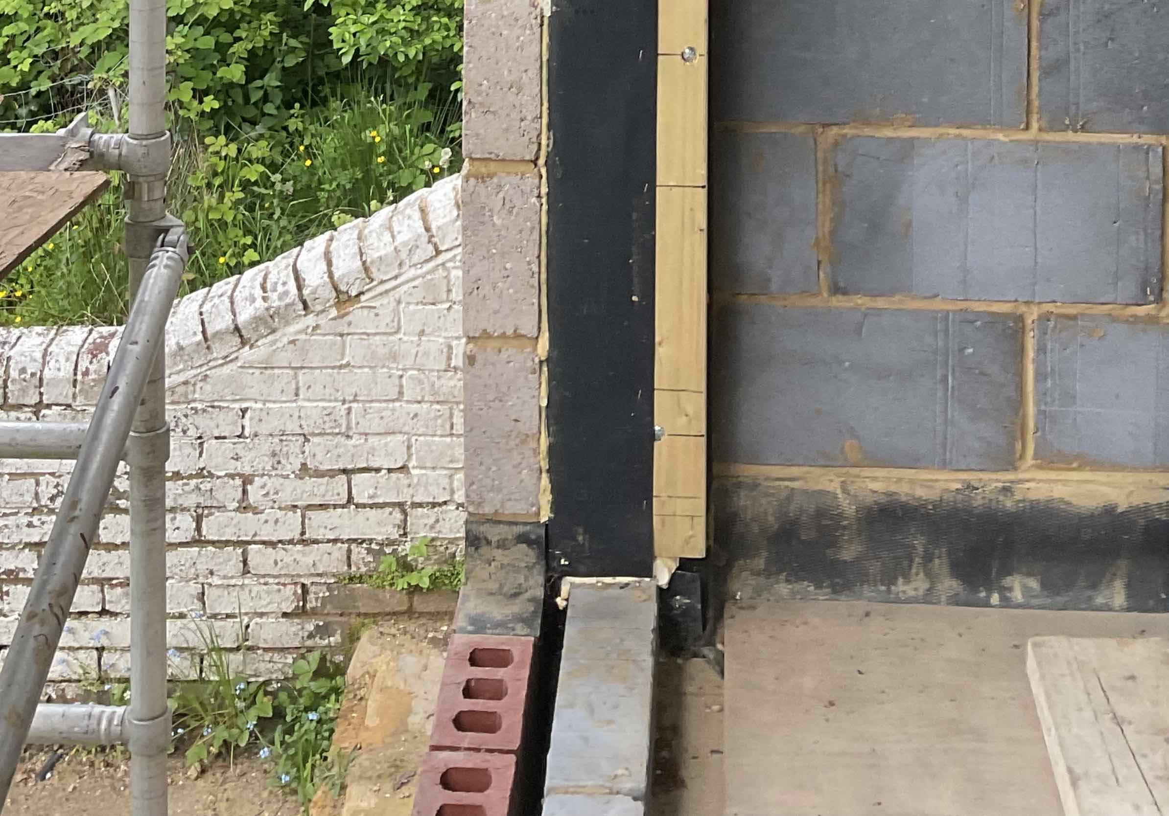

I left a 10mm gap at the end of the beams to stuff a bit of foam down but I doubt it will do much good! I wish I was insulating externally but I'm not. To be honest, on my next project I'm knocking whatever it is down and starting again otherwise everything is a compromise! -

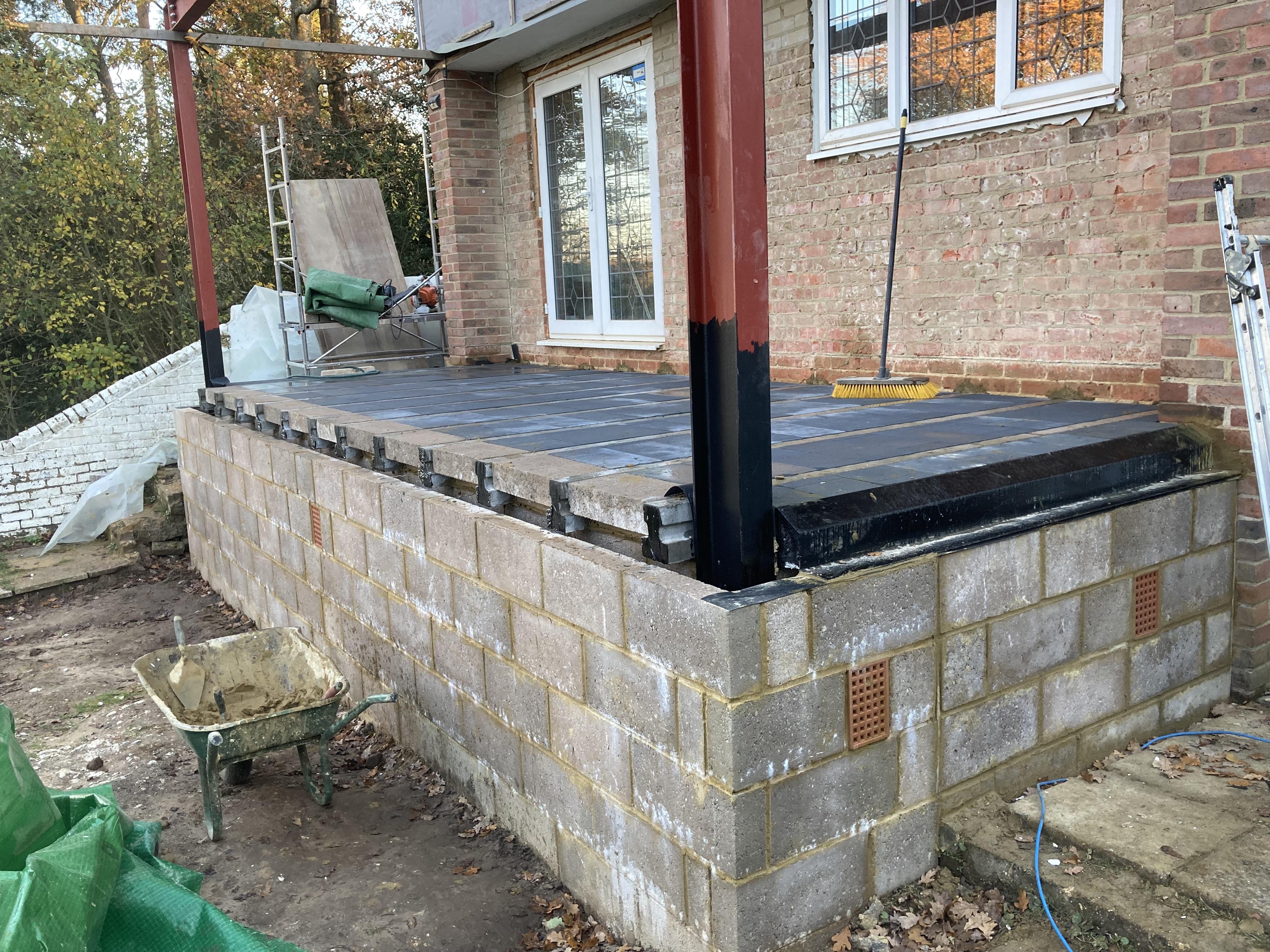

The wall cavities are 100mm with full fill rock wool. I'm doing internal PIR on the walls as well. For the threshold I bridged the cavity with the beam and block (with a dense block). The gap you see below I'm going to fill with insulation/concrete. Then put either 50mm deep x 250mm wide of Compacfoam/ Bosig Phonotherm/Thermalite (I haven't decided how yet) on top. The triple track will sit on that but set back from the front to end up close to the back edge. At least that's todays plan! -

Yes, it's expensive. I'm wondering if I should just cut some aircrete blocks down and use them as the 50mm lift I need instead. A lot cheaper! -
